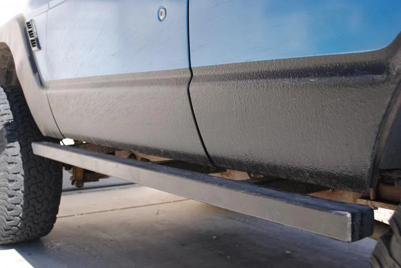

I'm really liking the monstaliner. Paint scratches a LOT easier than the liner, and there have not been any hood heat problems. The black is really UV stable here in Vegas. And I almost never store the LC in the shade. So it sees direct sun all day long.

Been beat on in the vegas sun since I put it on.
No discernable fading at all. It's stuck to the paint better than any other spray or roll on I have used (it seems to stick better than the alphaliner that I had done to my Superduties bed as well.)
attachment.php
