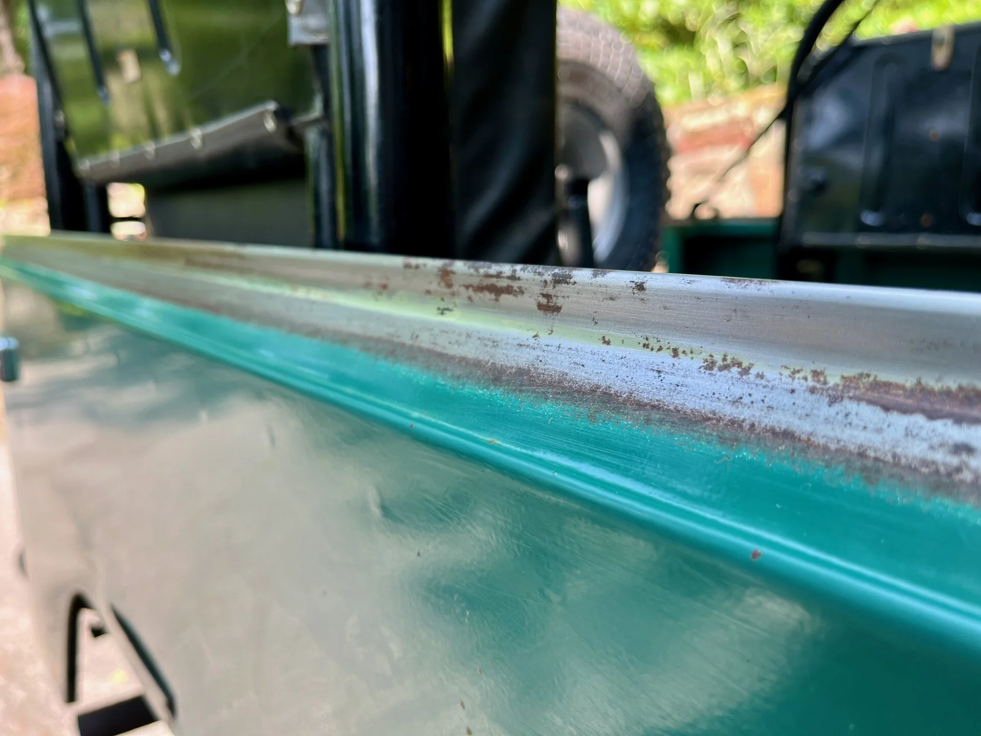

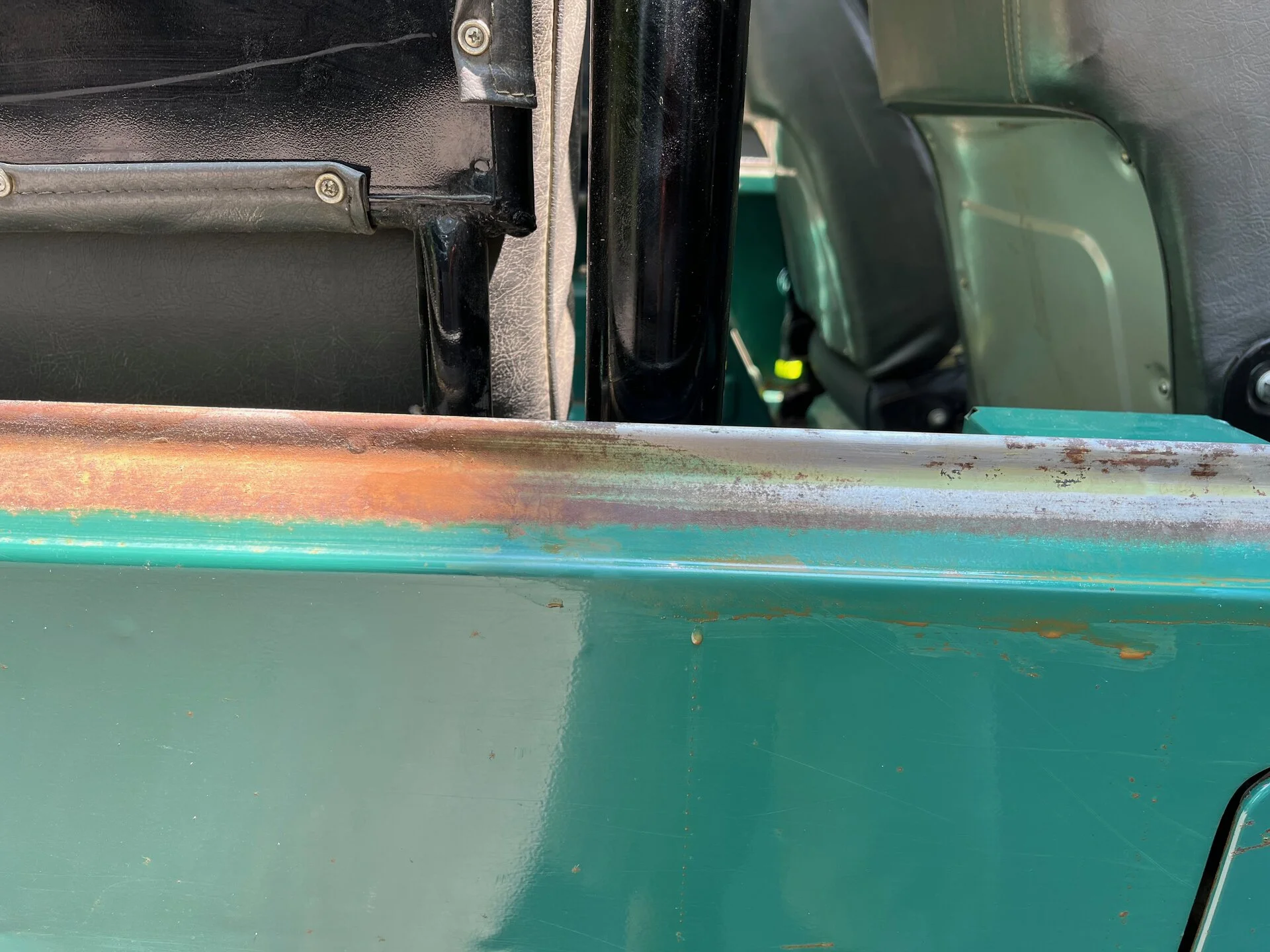

I also scrubbed surface rust on the rear quarters and door frames today. It was honestly pretty effective if tedious.
Got the remainder of the gasket leftovers off as well. Then waxed those areas to seal them up. All cleaned up well. It'll be ready when the hardtop repairs are complete.

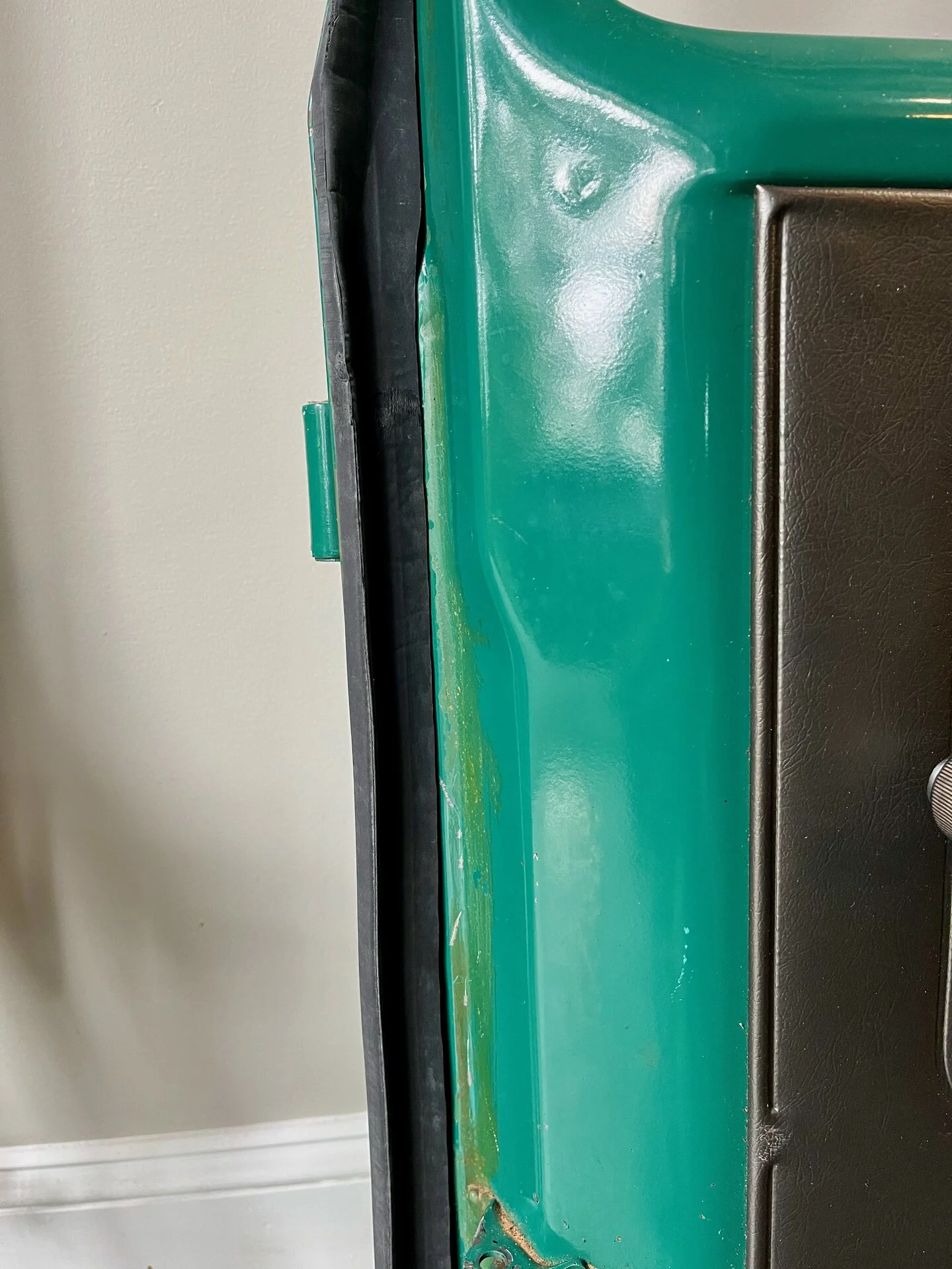

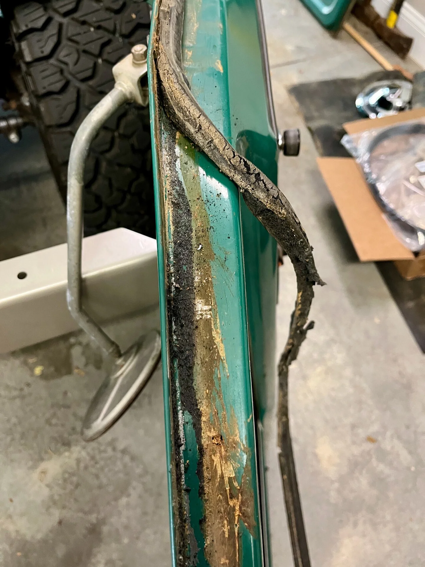

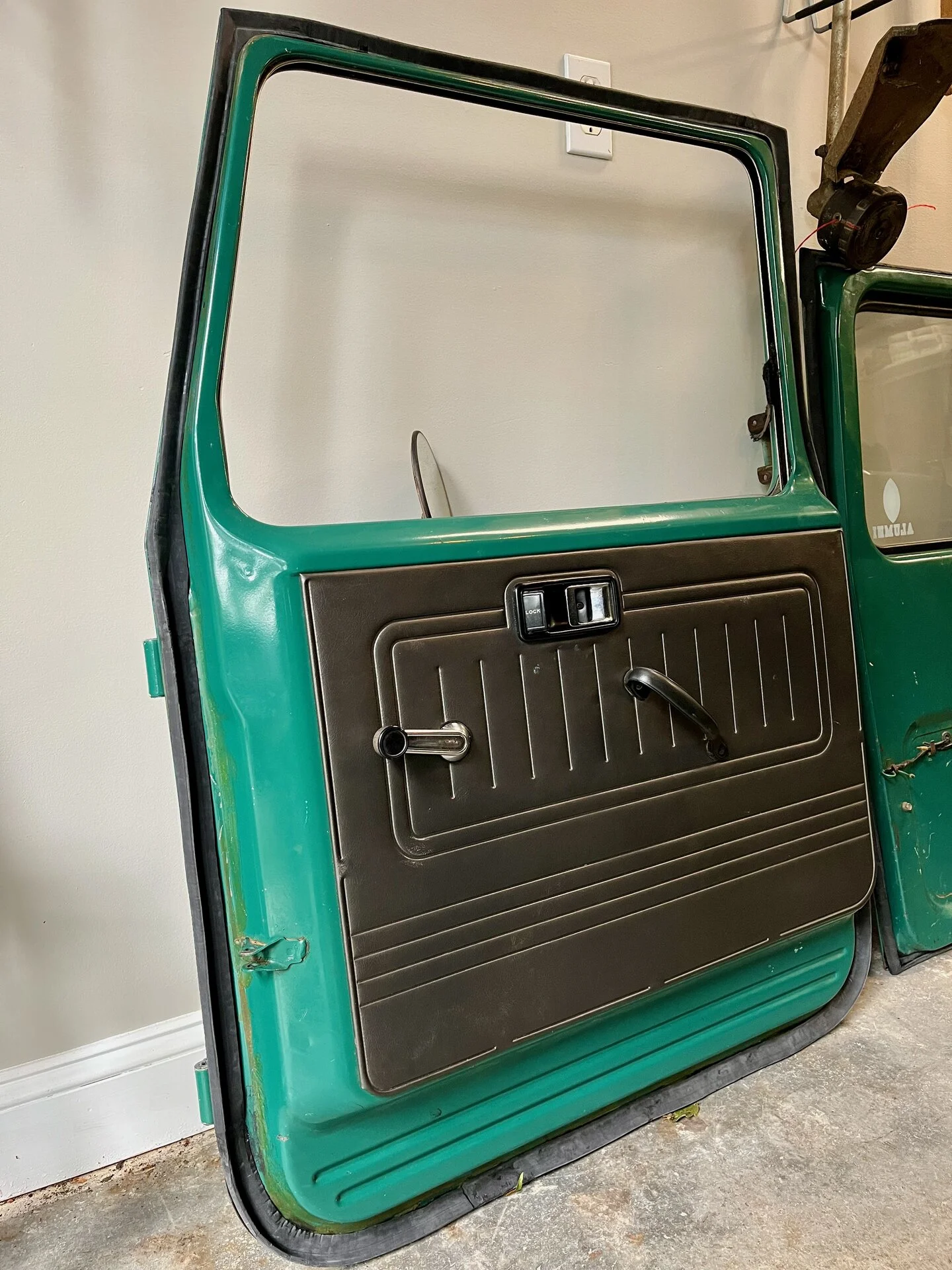

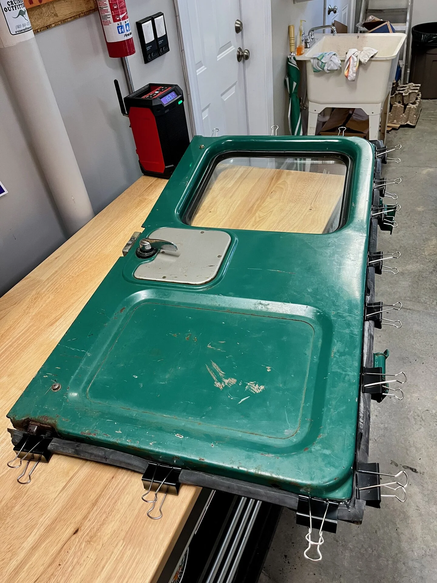

Replaced the weather stripping on all the doors. It was time. Some of it peeled right off, some not so much. I used a small putty knife and 3M general purpose adhesive cleaner. Tedious elbow grease work but goes pretty fast.
I used OEM seals and black 3M weatherstrip adhesive. It took a full tube to do four doors. I put the seals in place for each door with binder clips and then worked my way around with the adhesive, removing and replacing clips. The orientation of the seals sorts itself out - they only go on one way. The rear doors are unique and it's obvious. The front doors are basically the same. The bags for the seals are labeled left and right and it's easy to translate that to DS and PS. I had some rot at the bottom of one rear door so cleaned that up and hit it with some Rust Bullet before the seals went on.
The adhesive starts to tack up pretty quickly in 80 degree weather and I just rotated the clips around to spots that weren't adhering for 30 minutes or so and by then, the seals had settled right in. After an hour or so, you can move on to the next door.
They're not perfect but I'm sure when I get the hardtop back on, will make a big difference - especially with all new hardtop seals as well.

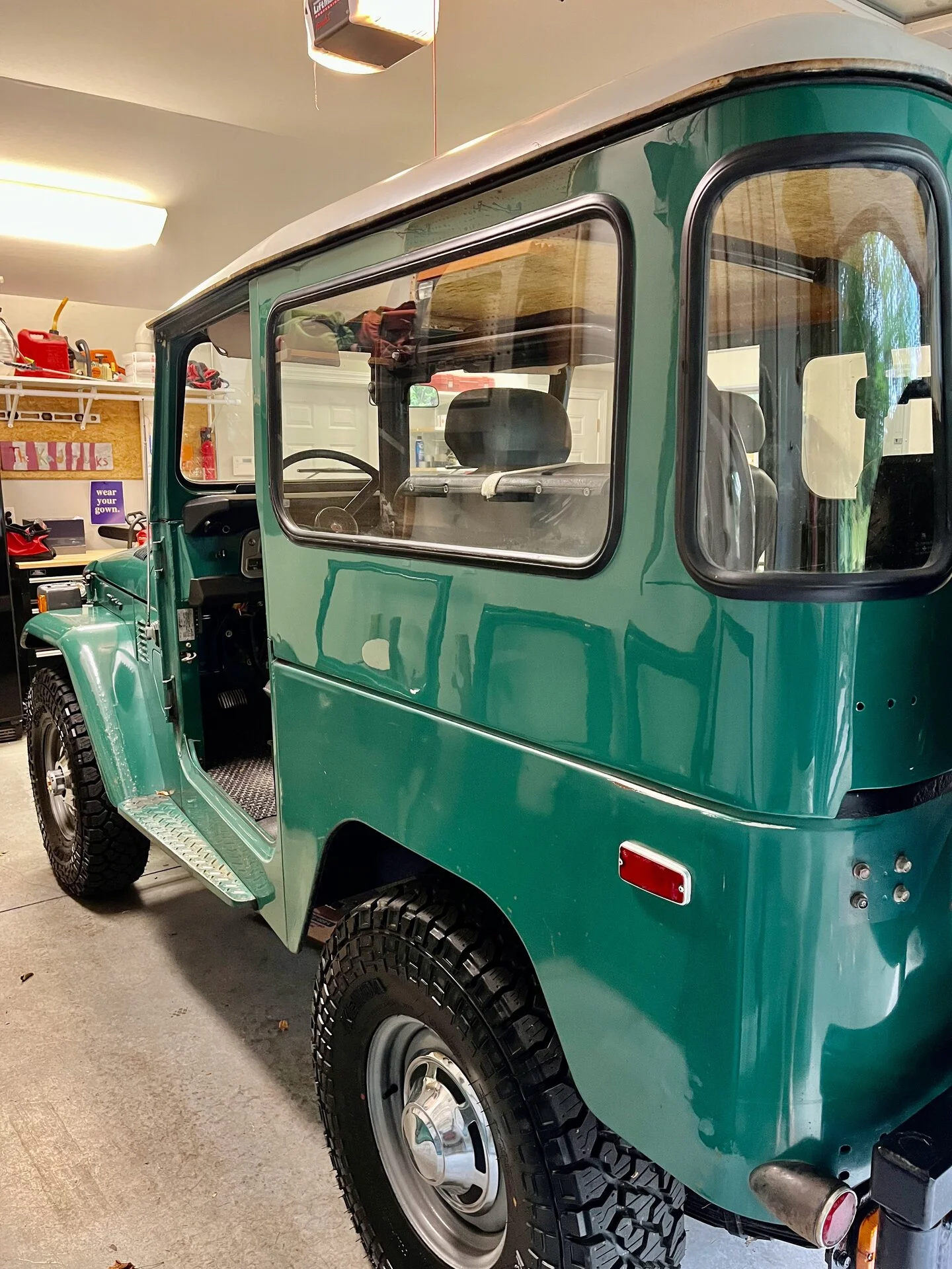

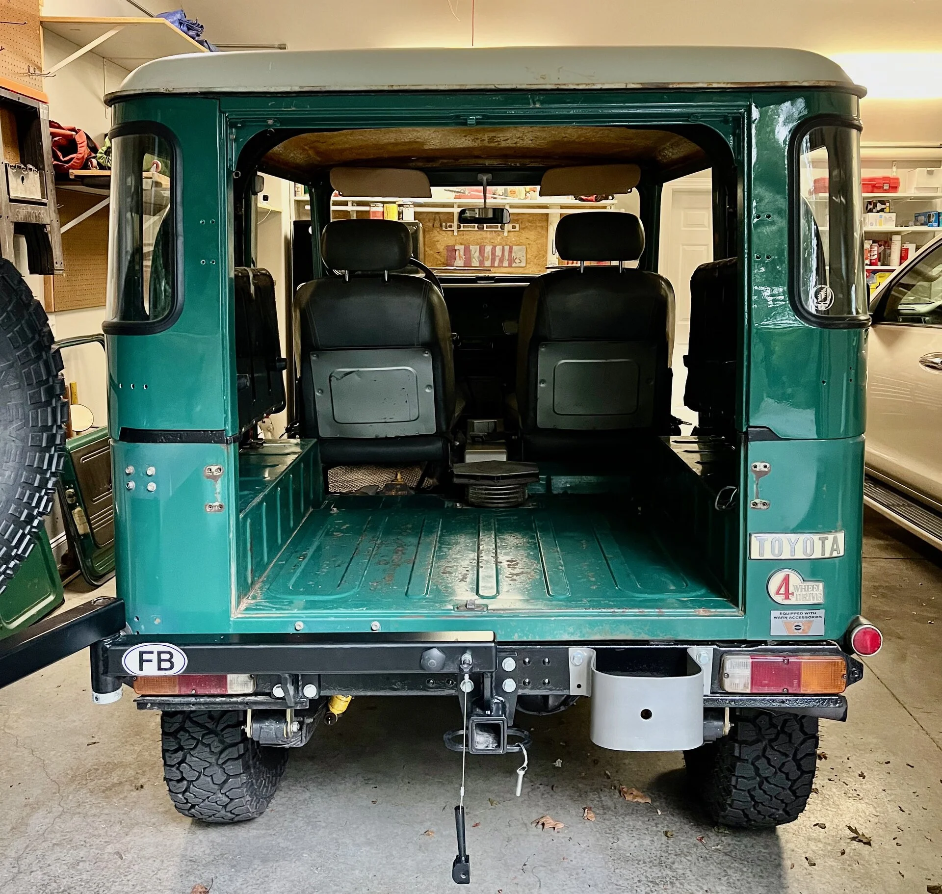

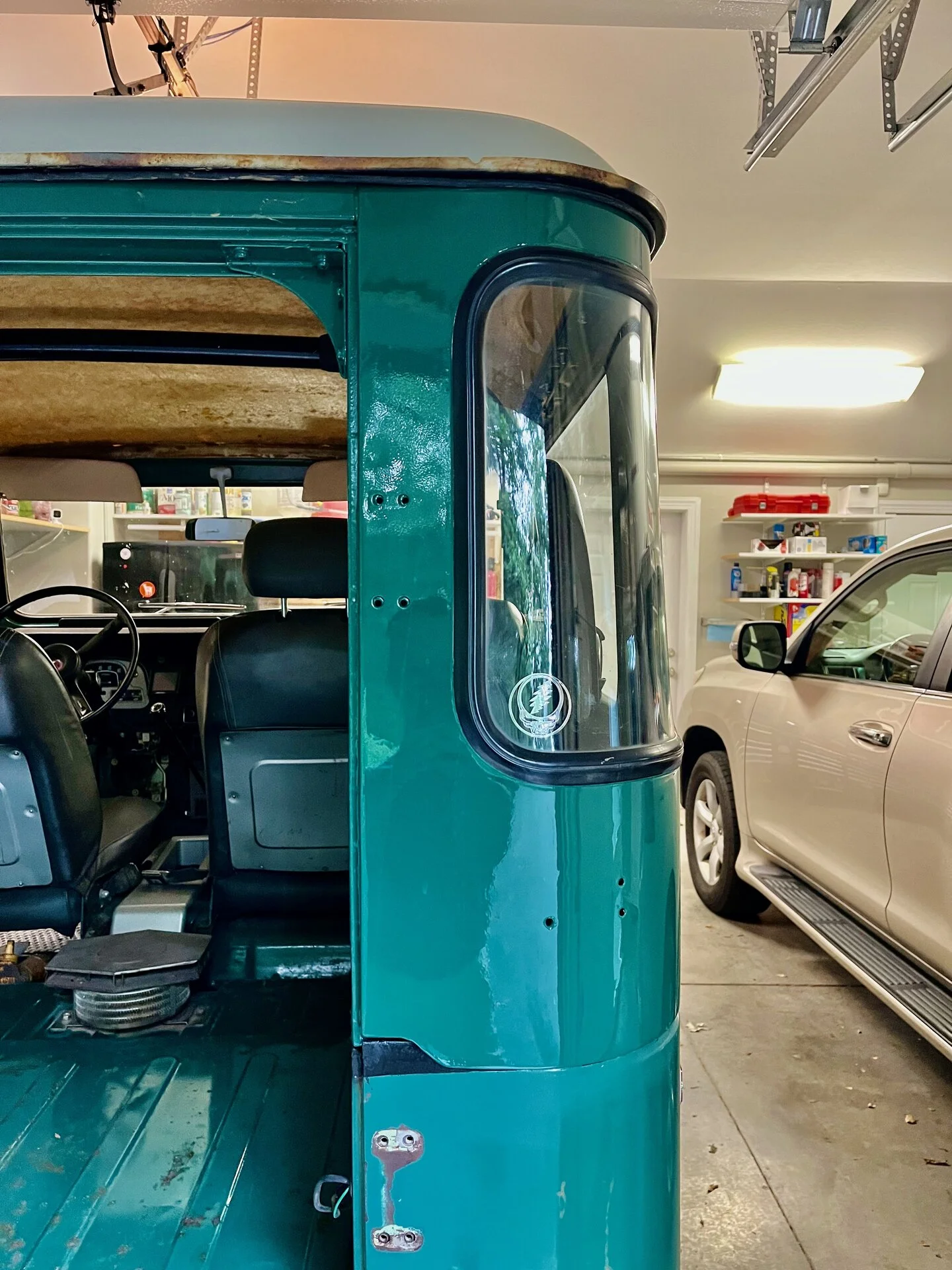

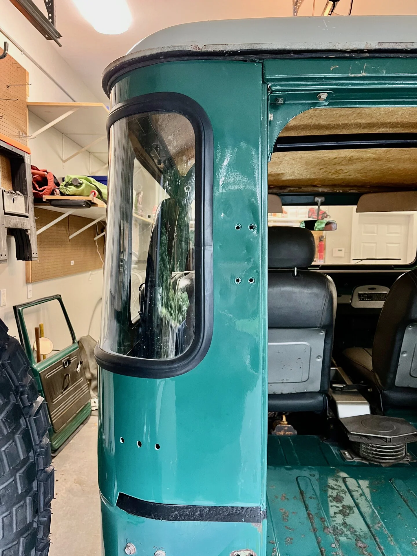

Back from the body shop. Rust on the hardtop repaired, new seals installed between the cap and the sides and the sides and the body. The seal for the DS rear window is new too. Left the body alone. I don't want to mess with the original paint until it's truly necessary. This truck is never going to be perfect but I'm trying to be a good steward. It's a pretty sweet old rig.
I think the paint shop did a really good job matching the faded factory green.
Full disclosure: I did not apply the tire butter. Body shop detail guy thought that would be a good idea. o_O

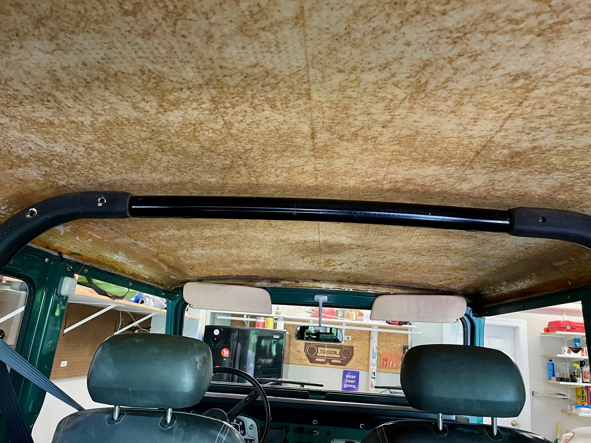

Next up: replace the headliner and tighten the bolts on the oil pan.

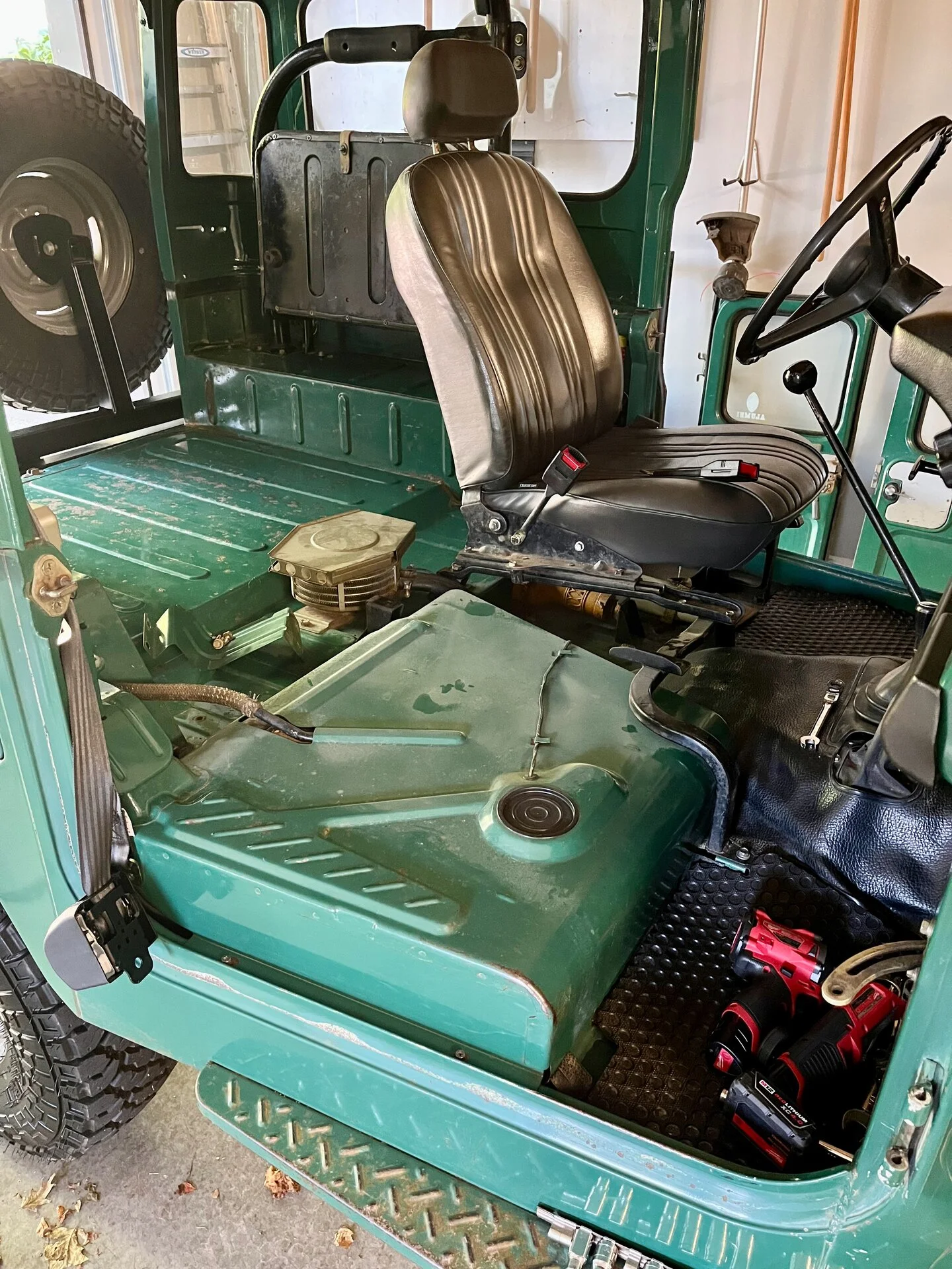

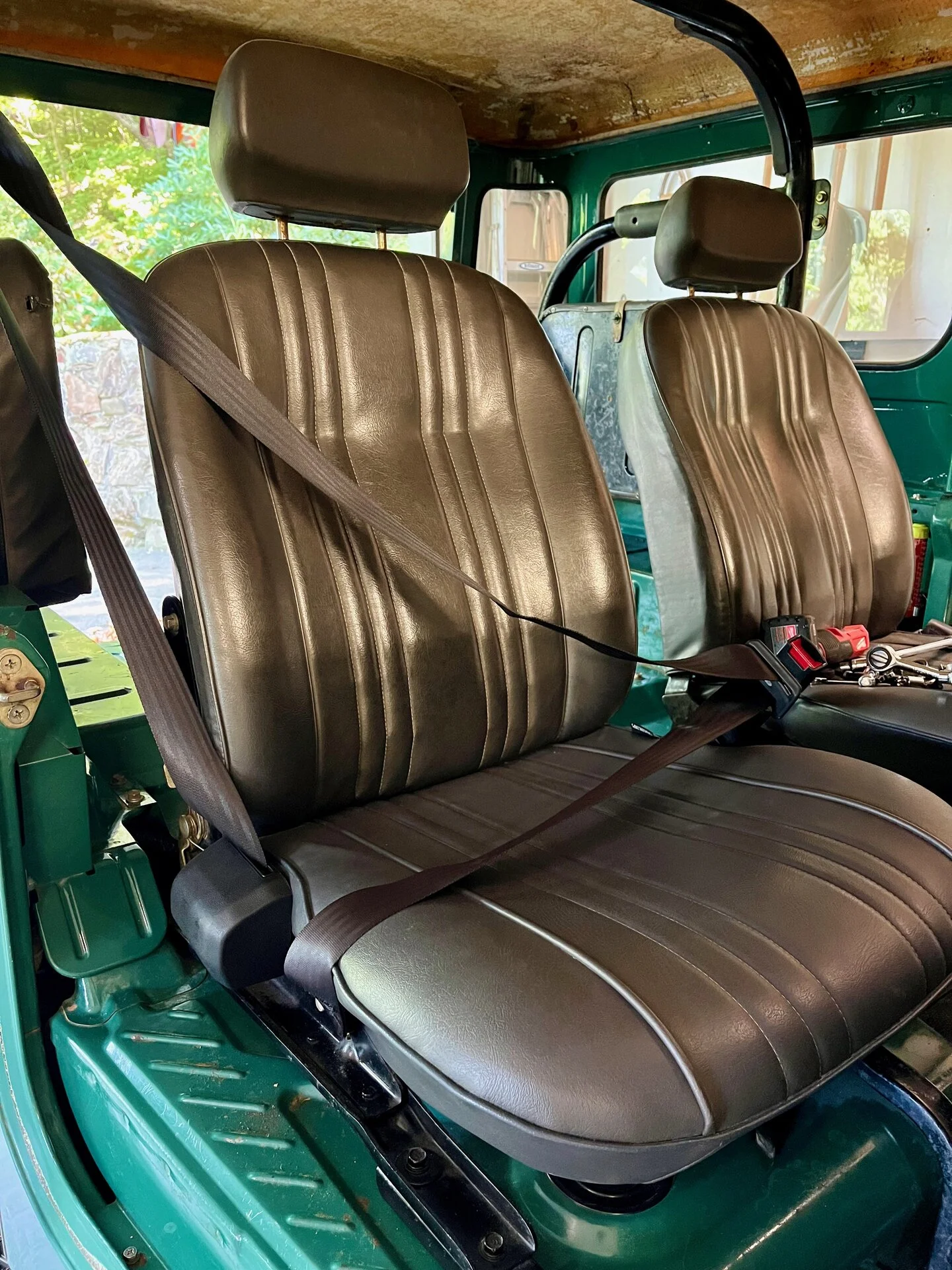

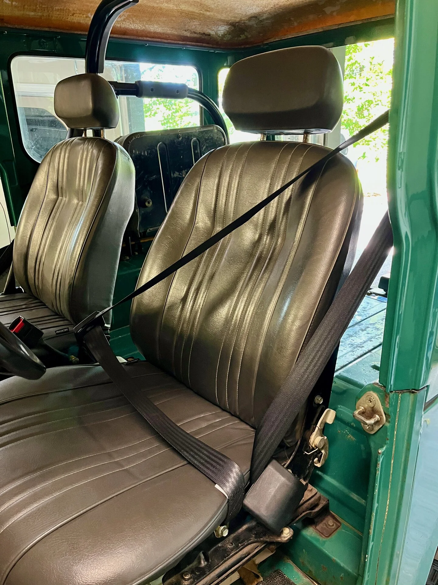

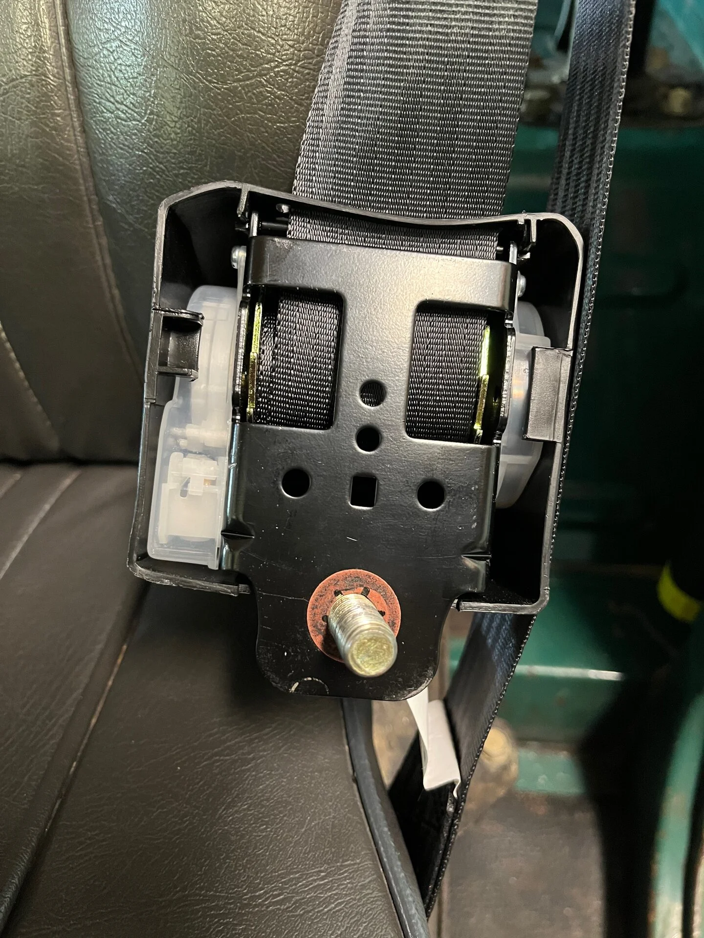

Installed CCOT three-point seatbelts this weekend.
Pretty major improvement related to safety.

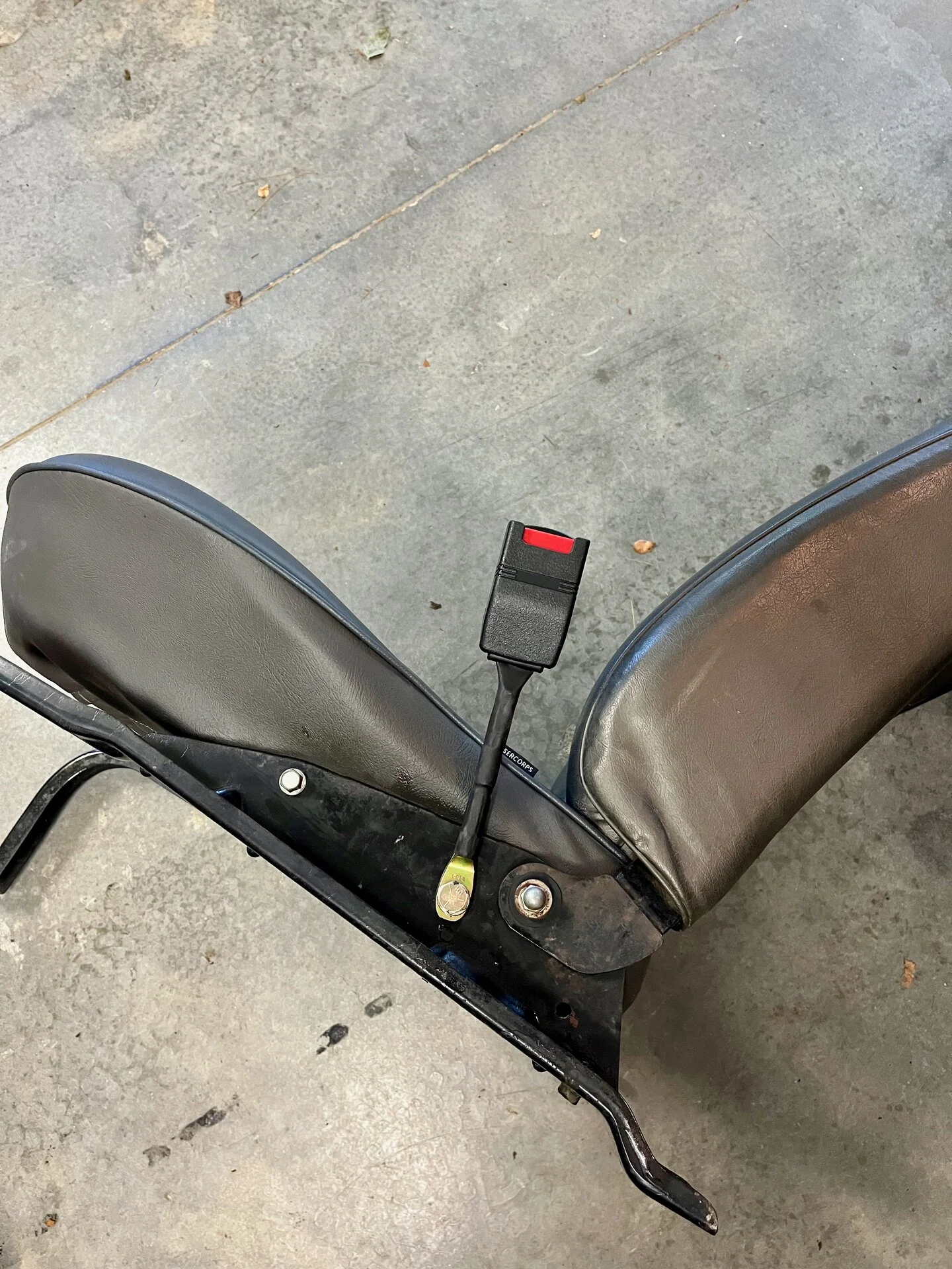

Bunged up the female threads on one of the posts which resulted in learning how to pull the seat (and not necessary - the center console).
Impact wrench made easy work of it once the seat was out of the truck. Took ten minutes to remove the seat and then reinstall it.

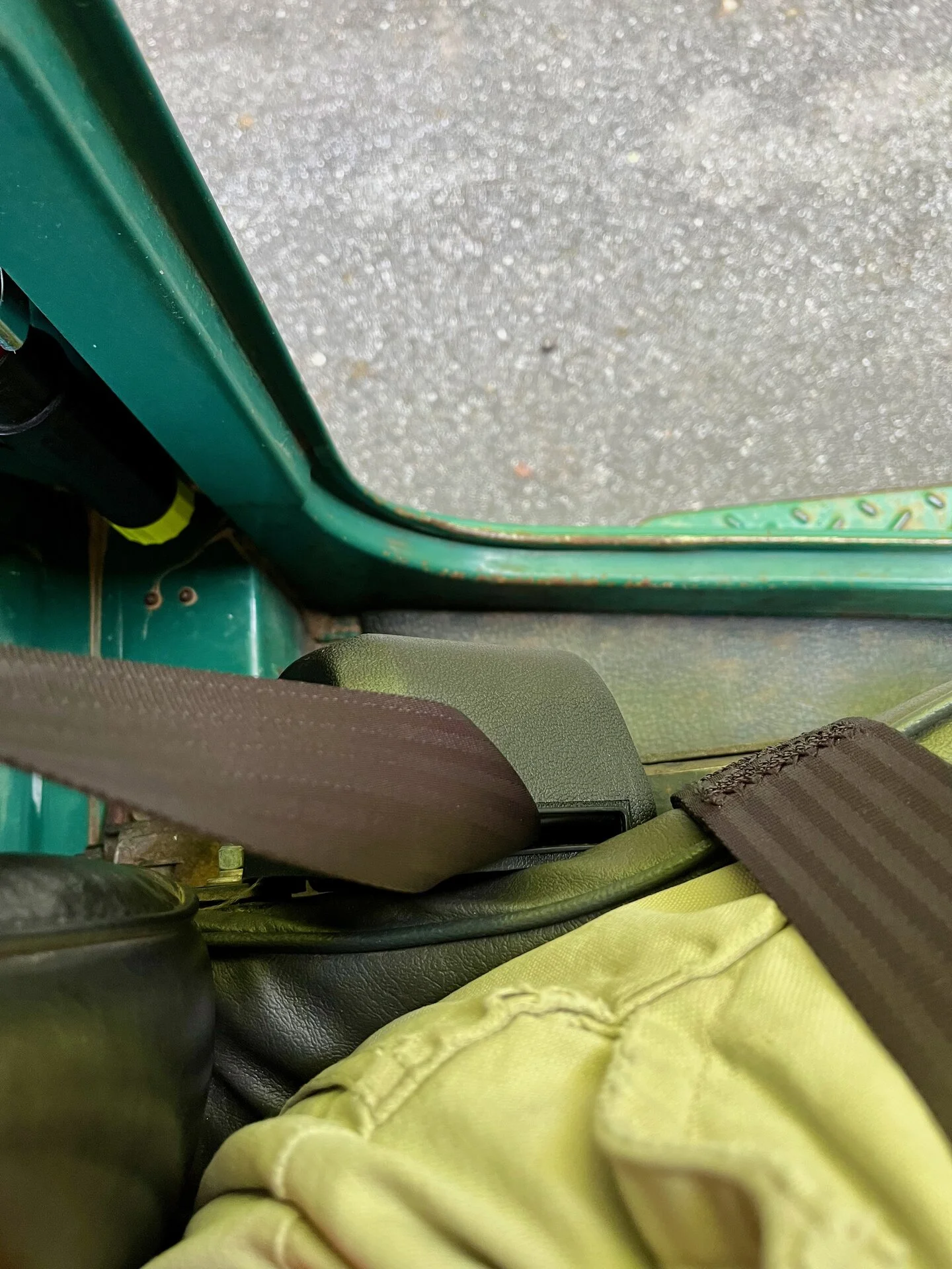

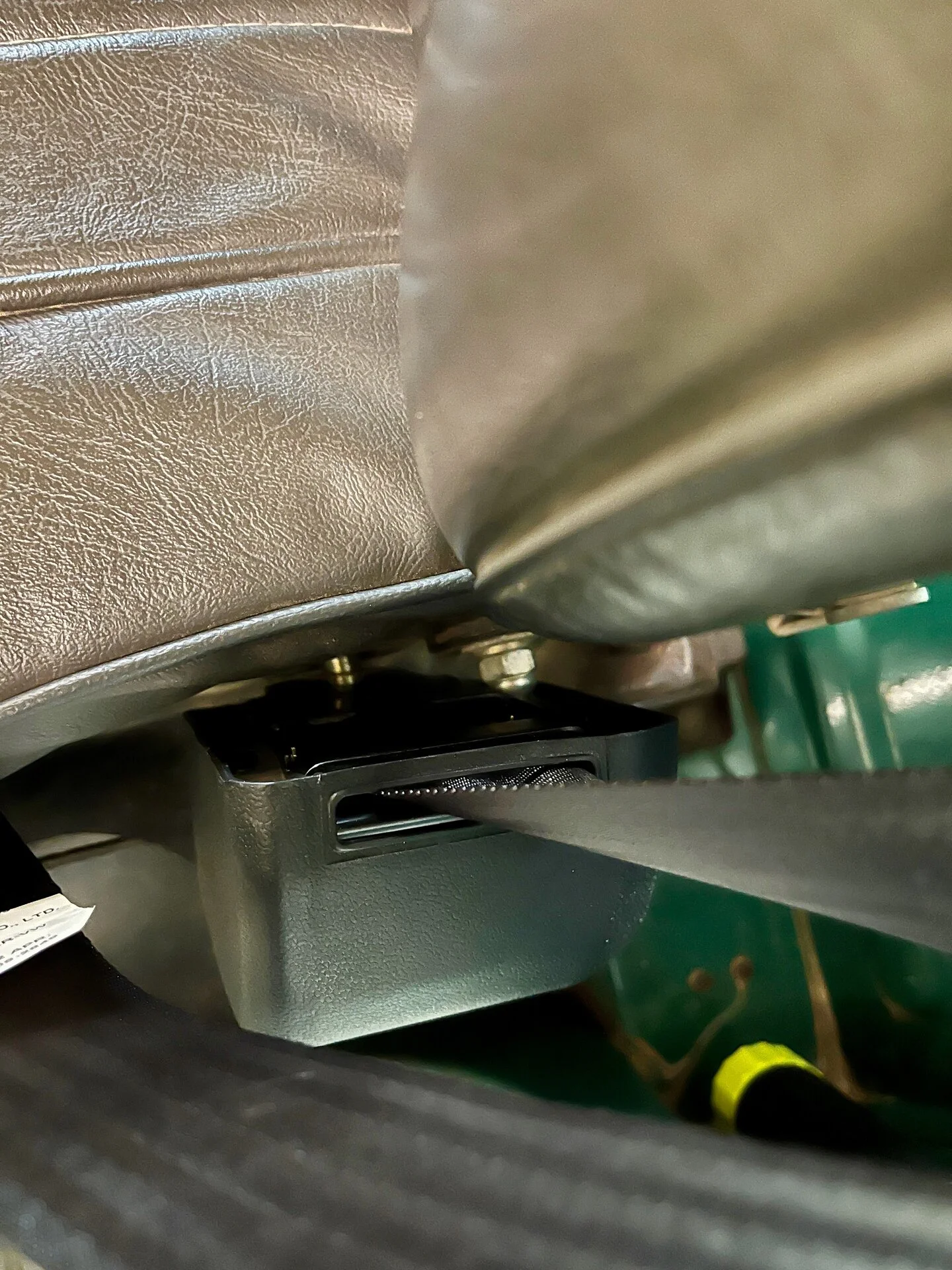

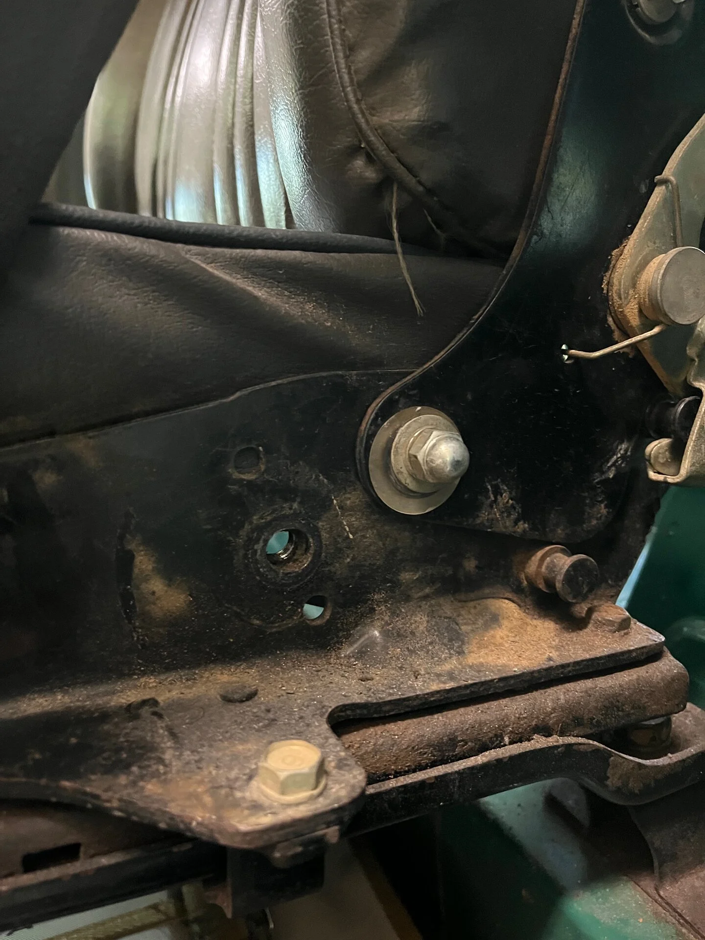

The seatbelts function well but the retractor is forced to operate at an angle that makes it uncooperative. You have to futz with it for it to reel out the belt. Ideally it would be at this angle but that bolt head is in the way.
So it has to be at an angle which causes the belt to bind.
Here's another look at that bolt head.
I was thinking maybe the seatbelts are driver and passenger side specific but they appear to be identical and the bolt is centered in the mechanism.
I may switch them from side to side when I have some time. Could be the fitment varies from vehicle to vehicle - that bolt in the seat back may have varied in location? I don't know. Not a big deal but would be nice if they worked correctly with less effort.
I had hoped to retain the factory post with the Toyota logo on it but it's not compatible with the seatbelt. Won't click tight.
