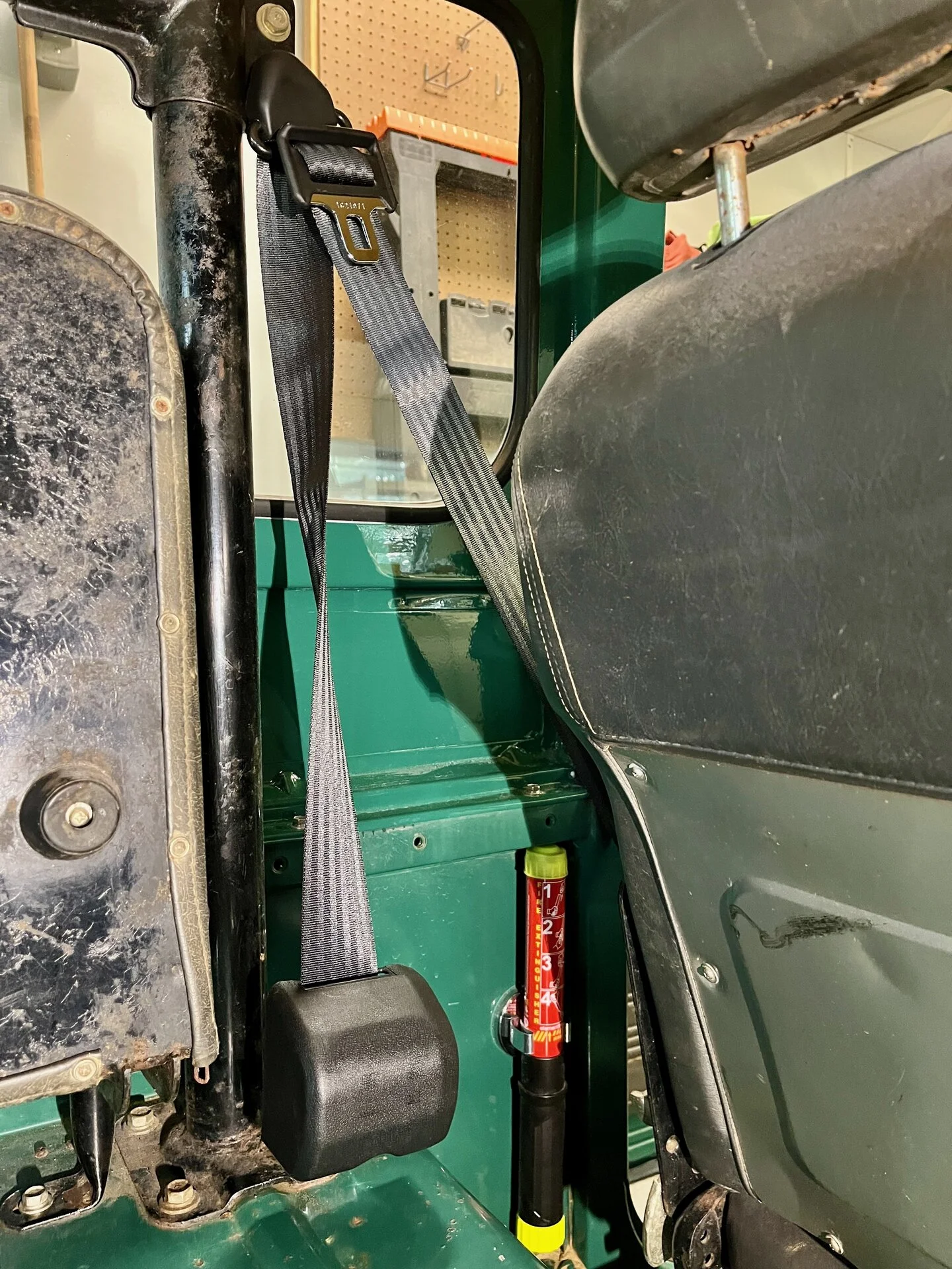

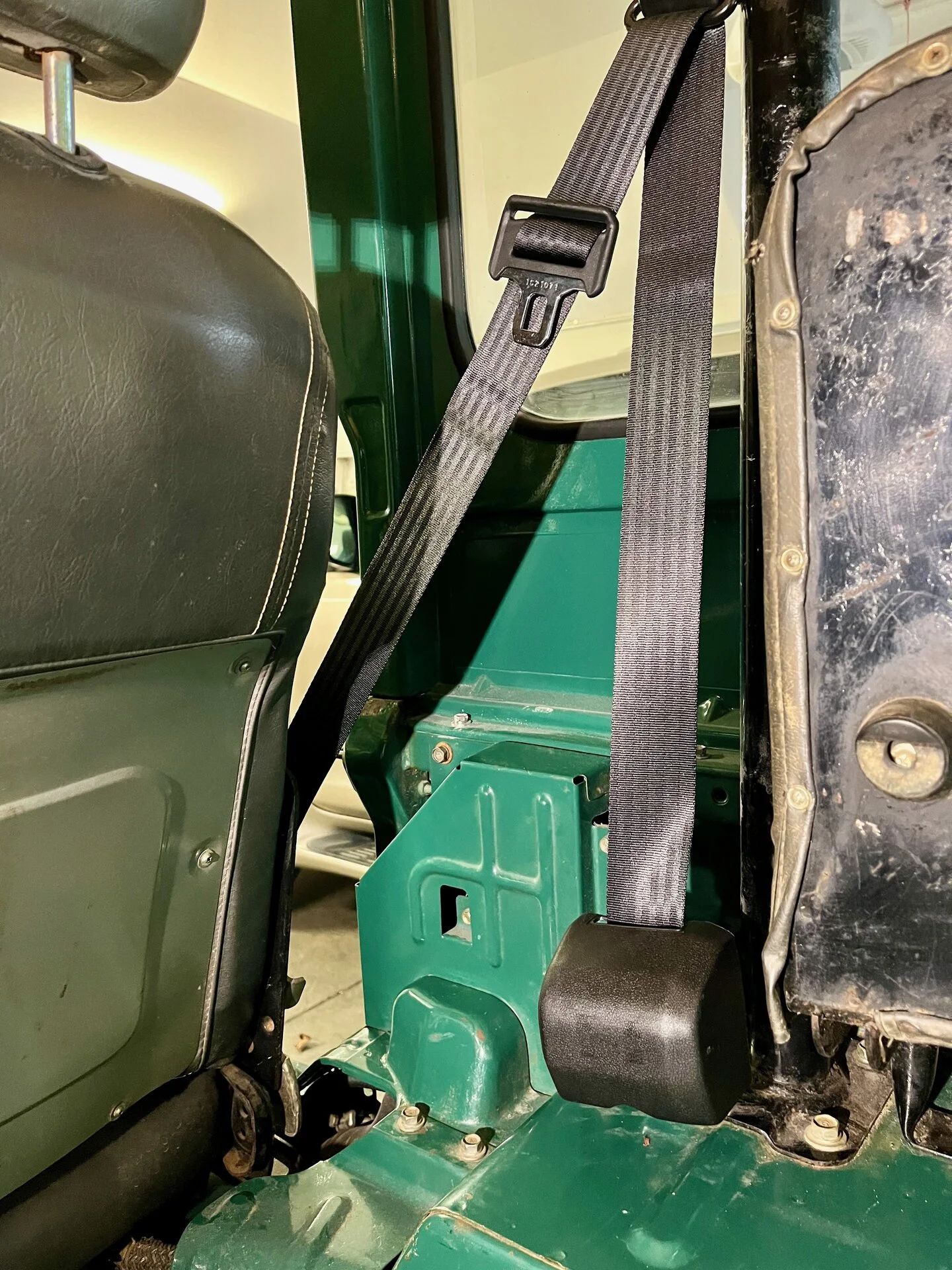

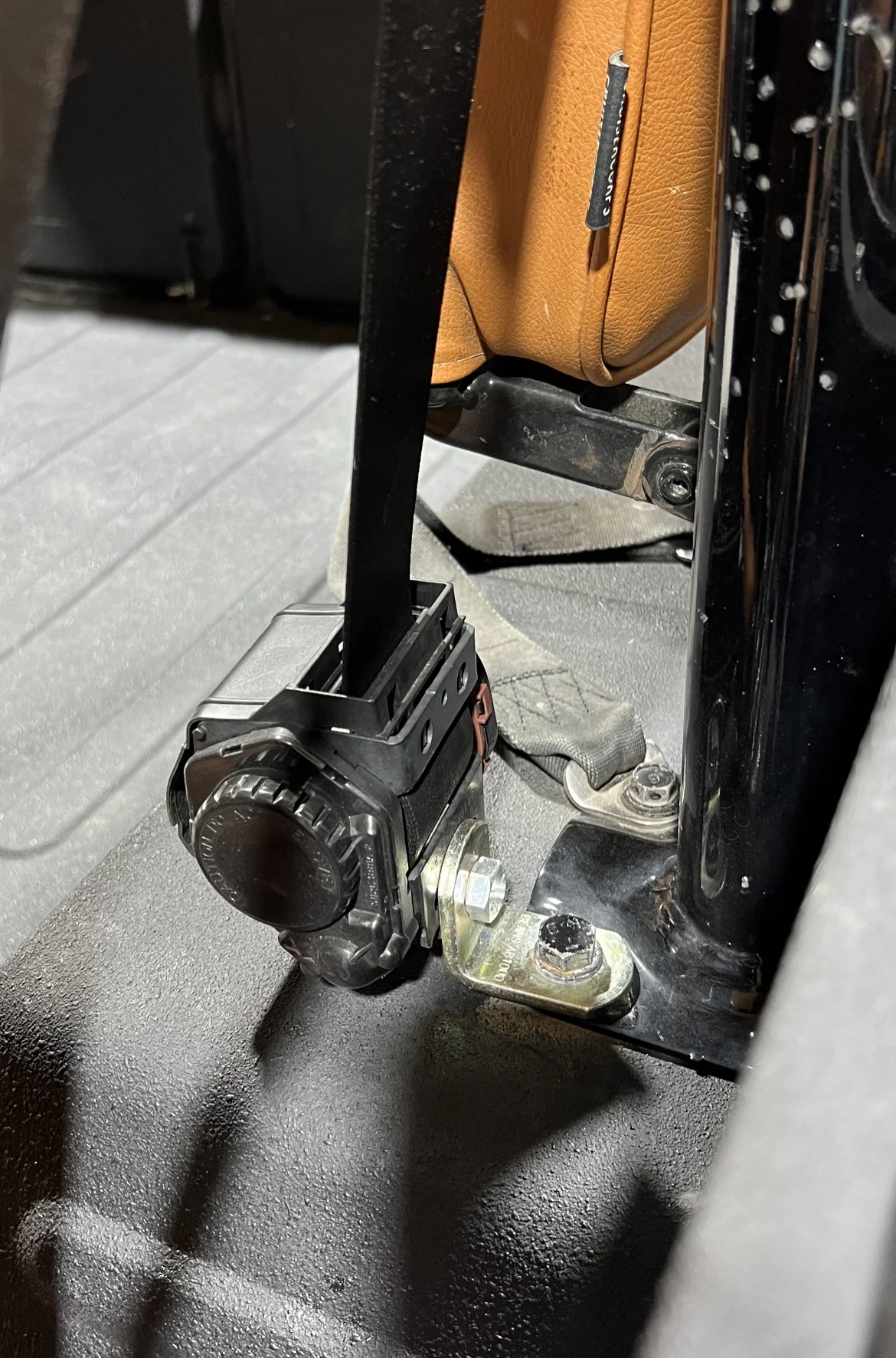

On the seatbelt retractor. CCOT likely sent you a small 90* bracket. You mount that to the fender at the roll bar. The retractors have to be straight up to flow freely. You have them thinking you are turning over.
That should keep it better aligned with top bracket which is mounted on the upper roll bar bracket and should operate smoothly.
If they are or become finicky/takes a few pulls to release so you can buckle the seat belt, it possibly has a piece inside that has broken loose, eventually the retractor will seize up. Mine did that a couple months ago and CCOT sent me a replacement after I described what is happening on a set I had purchased in January.
Honestly - I think I just have the retractors installed in the wrong place. My assumption that they went in the same place as the lap belts is clearly faulty. I'll get them swapped out in the next couple of days and I think the problem will solve itself. Clearly I'm a guy who could benefit from instructions. :doh:
Exactly! If you order both front and back you get a box of parts, nothing else!!!
I cheated and looked at a newer 40 that has the retractor mounted on the roll bar and best guessed from there!!!!!
So part of my dilemma here is whether to do things incorrectly the first time and then be told how to do it right or to ask how to do it in advance. :rolleyes:

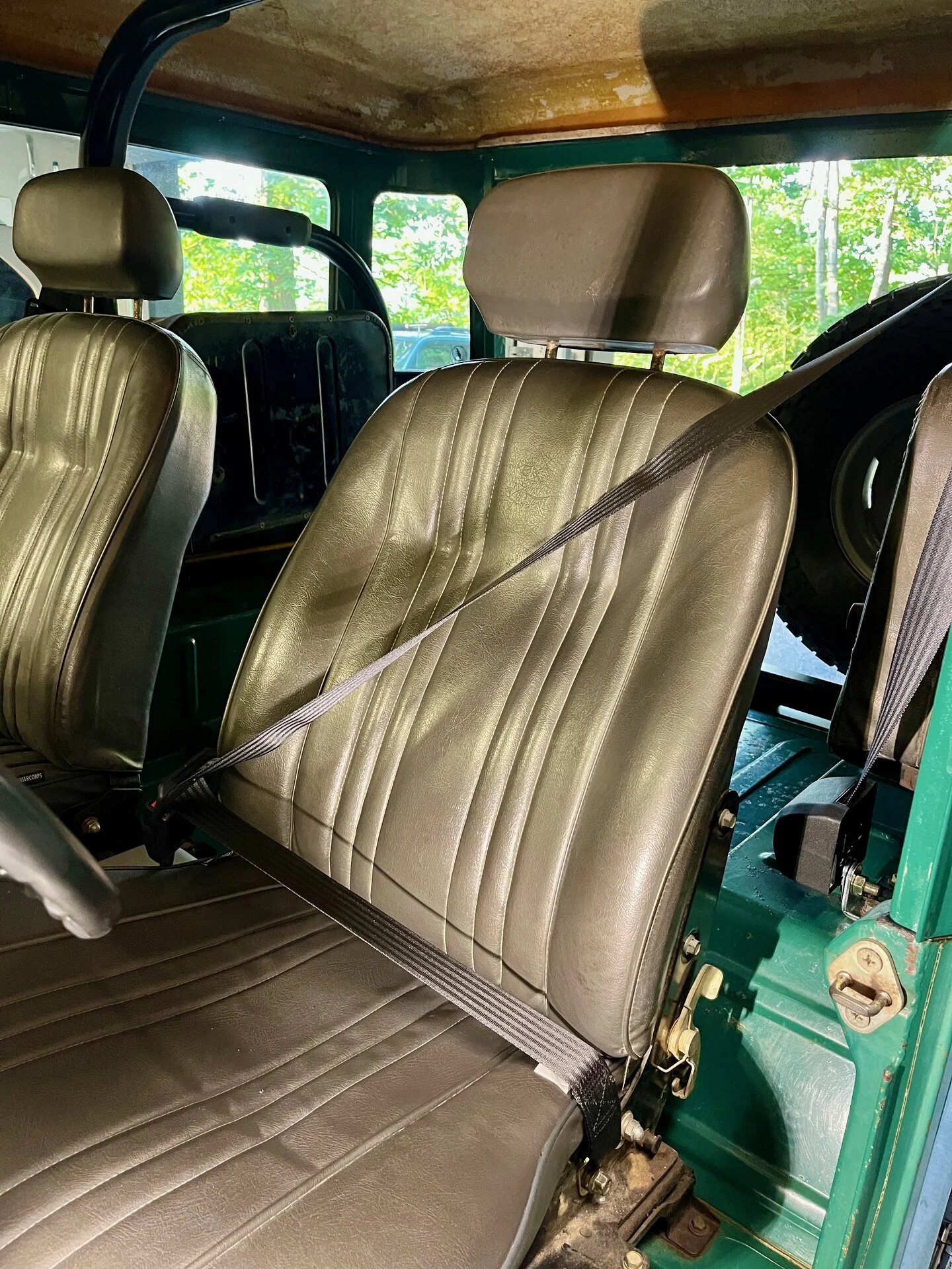

Relocated the retractors to a much more logical location using the L brackets in the kit. I also relocated the lap belt to the most rear bolt position.
They function perfectly now.
FWIW, this job would take a normal person maybe 30 minutes. Super easy, even if you do it wrong and do it over.

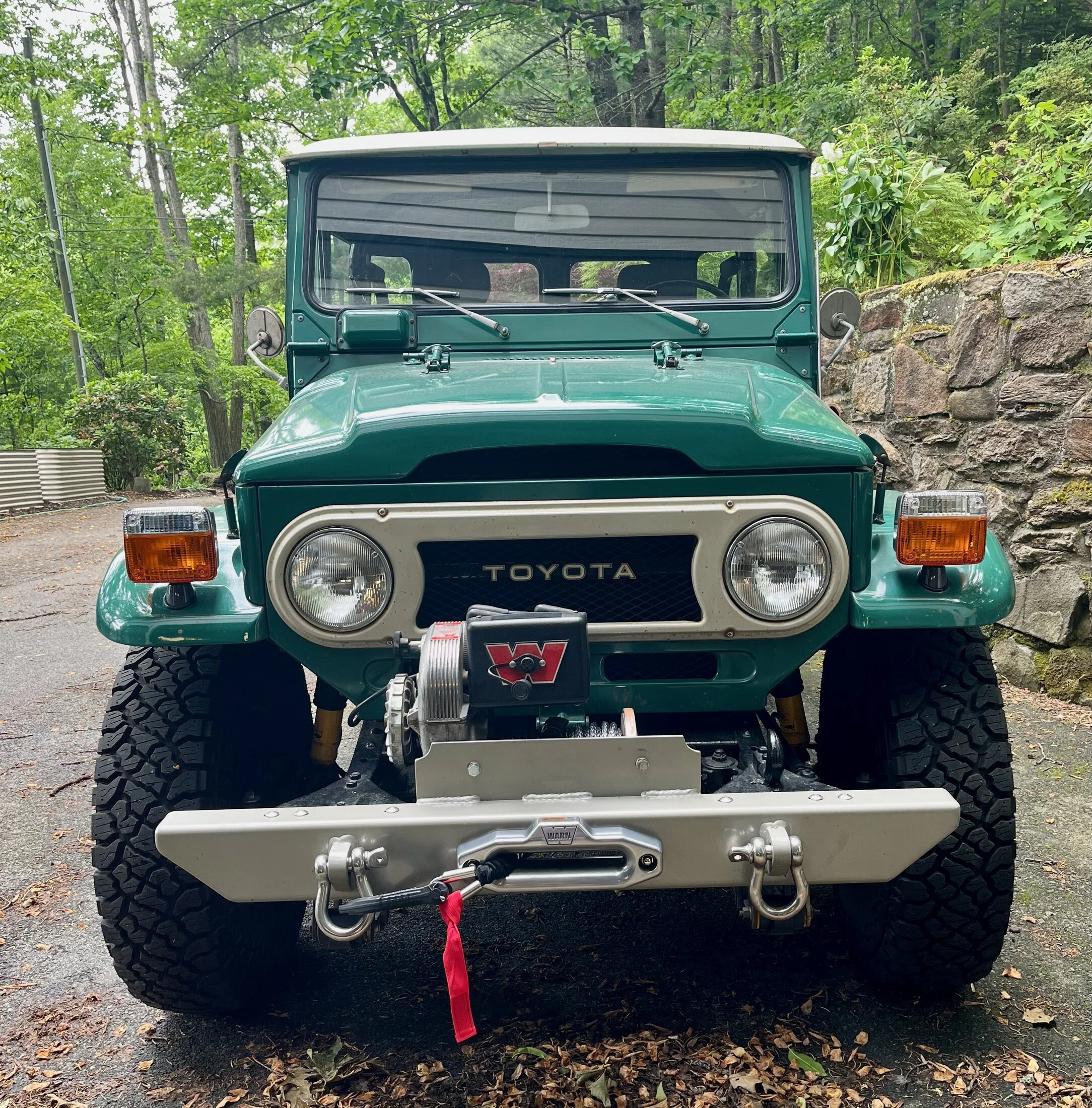

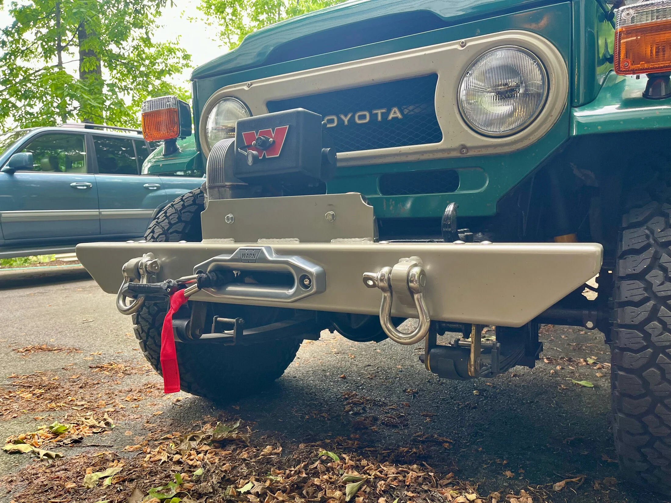

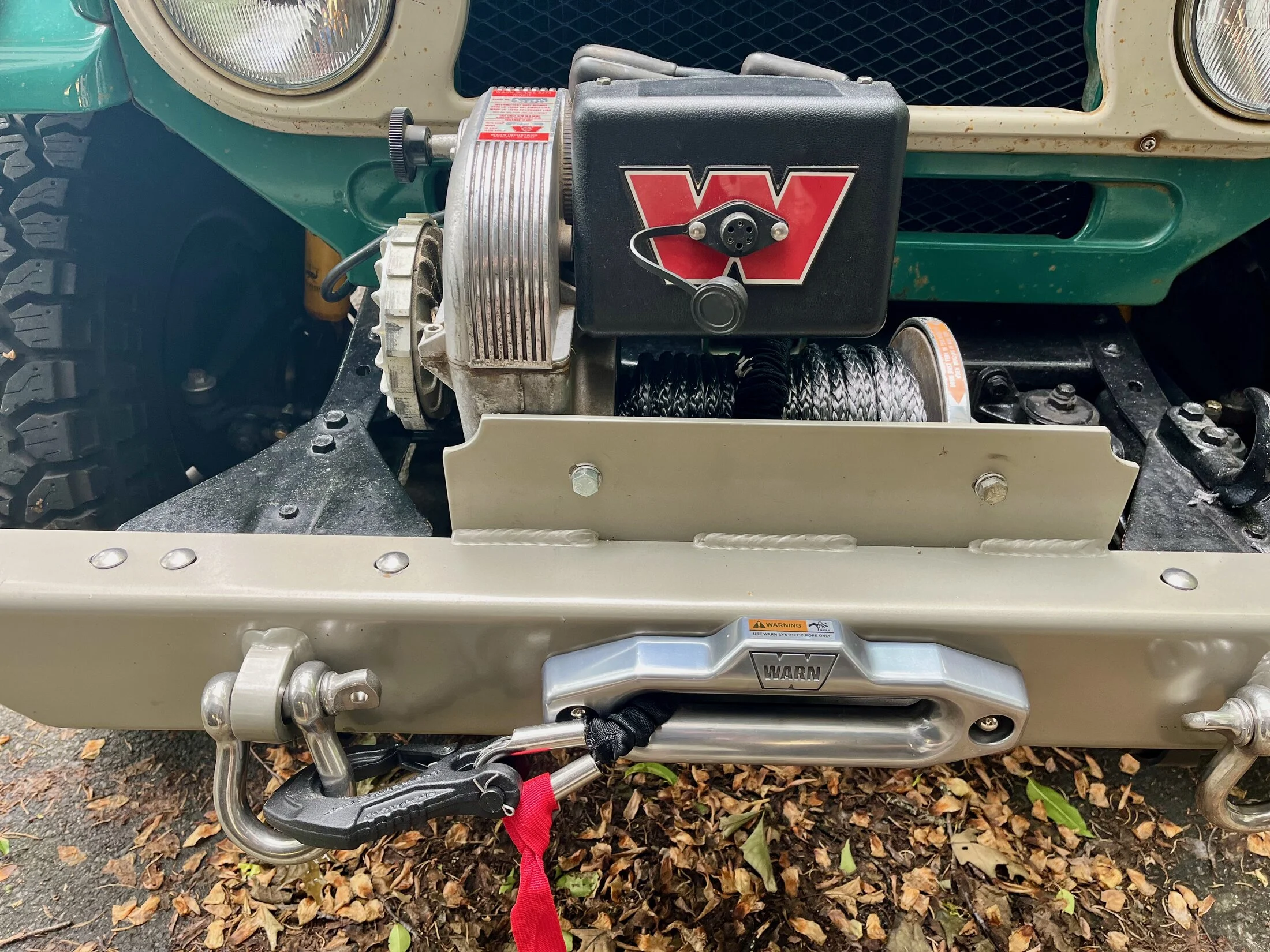

I also traded some parts I didn't need to Nolen and got a winch mount bumper in return. So when you have a winch mount bumper, you need a winch, right.
I found a used/rebuilt Warn 8274 in north Mississippi so picked it up while driving to Jackson. I didn't want a shiny new winch on this Cruiser so it worked out perfectly. Plus I spent a fourth of full retail.
Seems right at home on the truck. I'll never use it but at least it looks like I mean business. ;)

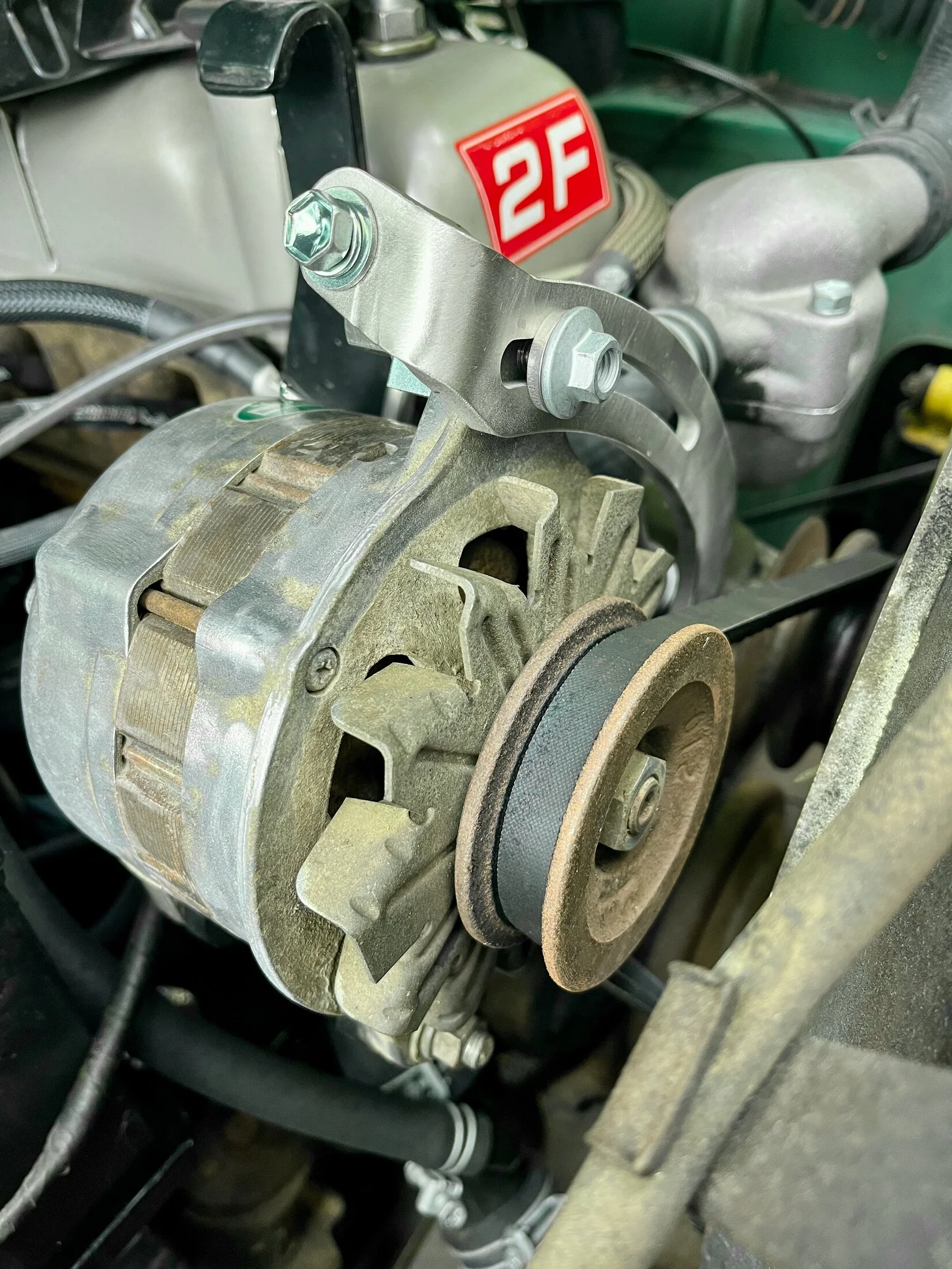

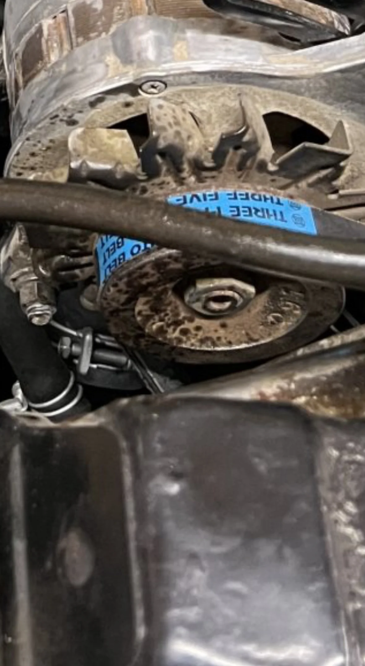

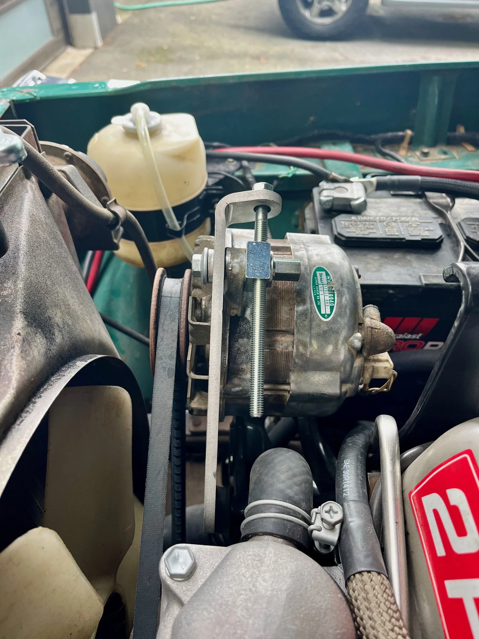

That Belt is too small for the pulley. Should be a 17mm wide.
I’m not sure how that belt arrived on the scene. This is what was on it
