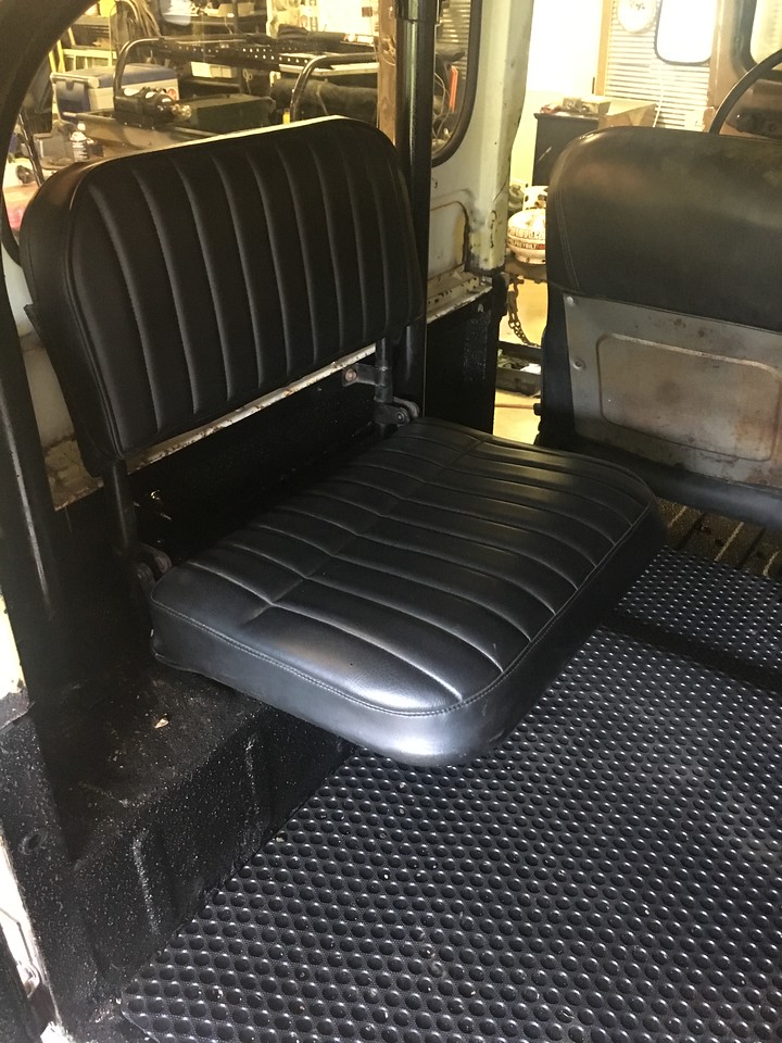

I cleaned up all the parts and installed a beautiful used jump seat I was able to pick up locally. (still need a second one)

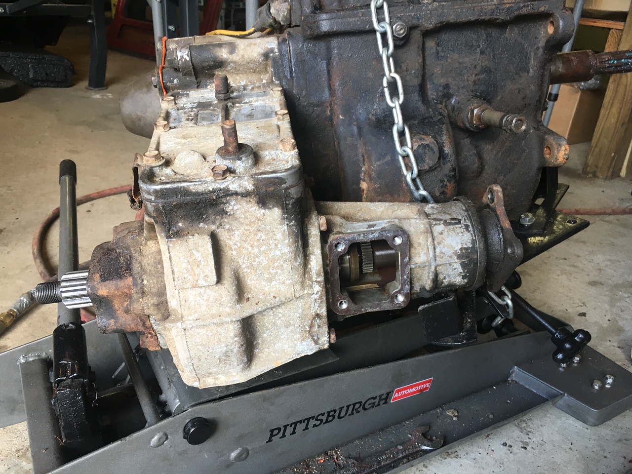

The new tranny/transfer setup I got is very clean inside. Shifts great.

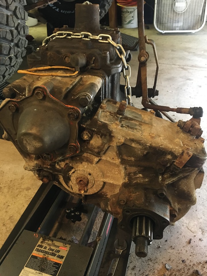

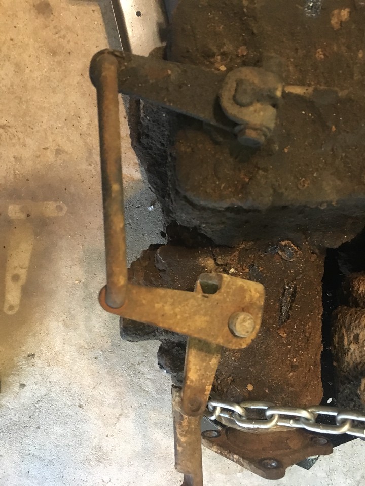

Turns out the shifter setup is different and the new shifter hits the tub. We tried to get it in the truck with no luck. Had to drop it back out.
Below is the 74 setup
We tried to get the 74 to fit on this later transfer but the shift fork was gummed up and it would not shift smooth enough so we are going back with the later shifter and Ill deal with clearancing the tub

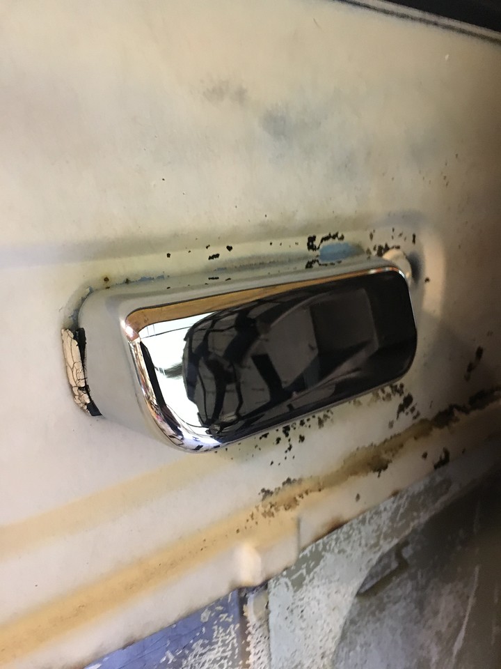

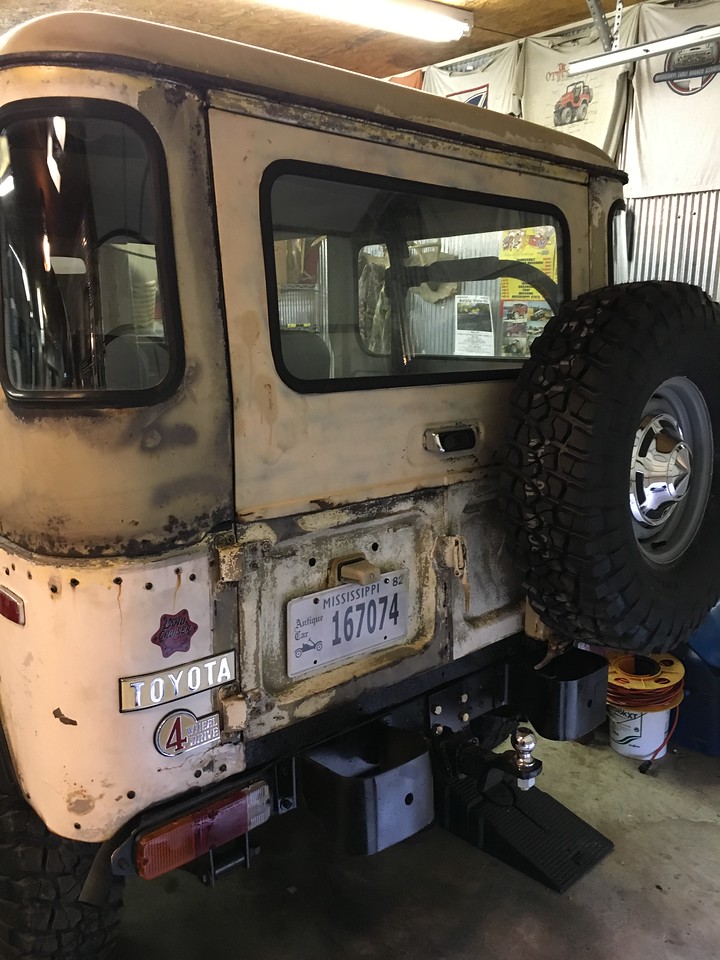

Removed the lift gate from the donor 72 this am and will replace the handle with a New Old Stock one that @Racer65 sold me.
I'm stoked all of the hardware is here for the OEM struts. They even work.

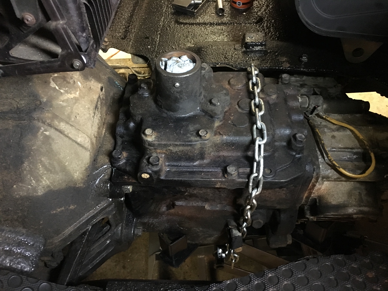

I had an epic morning and headed home to hammer on the Cruiser. My friend Lou was coming out to help me stab the tranny after 3:30 but I wanted to take a shot at it before he got there on fresh muscles and a fresh steady spot on the tranny jack.
Sure enough, it snicked right in after about 30 minutes of careful solo adjustments with the tranny jack. So awesome. What a great feeling.

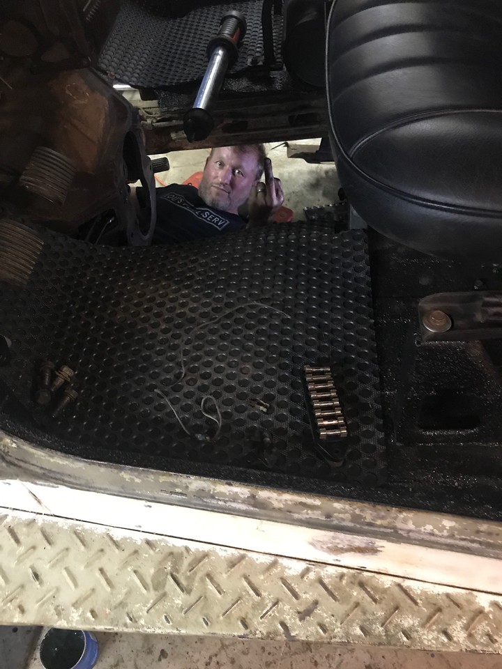

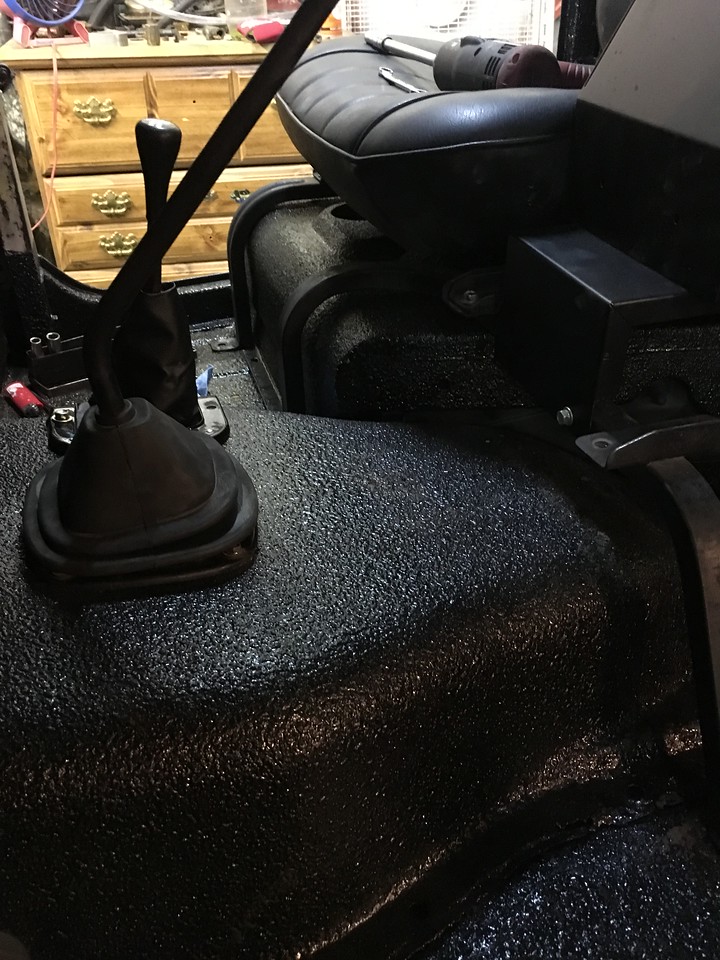

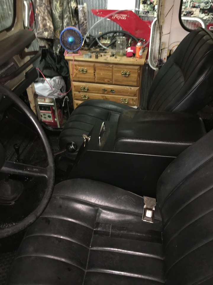

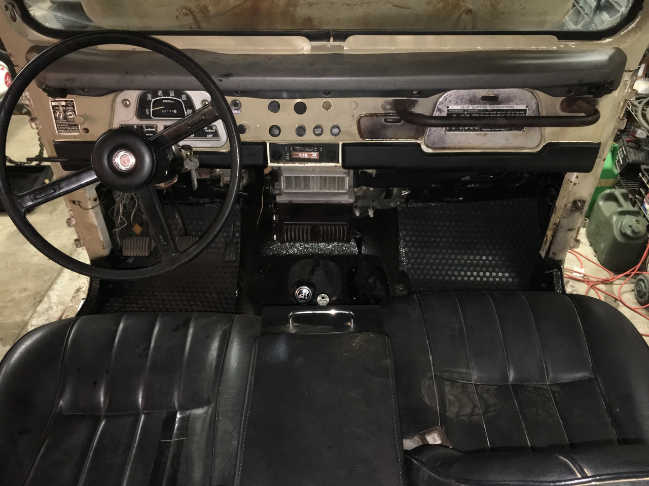

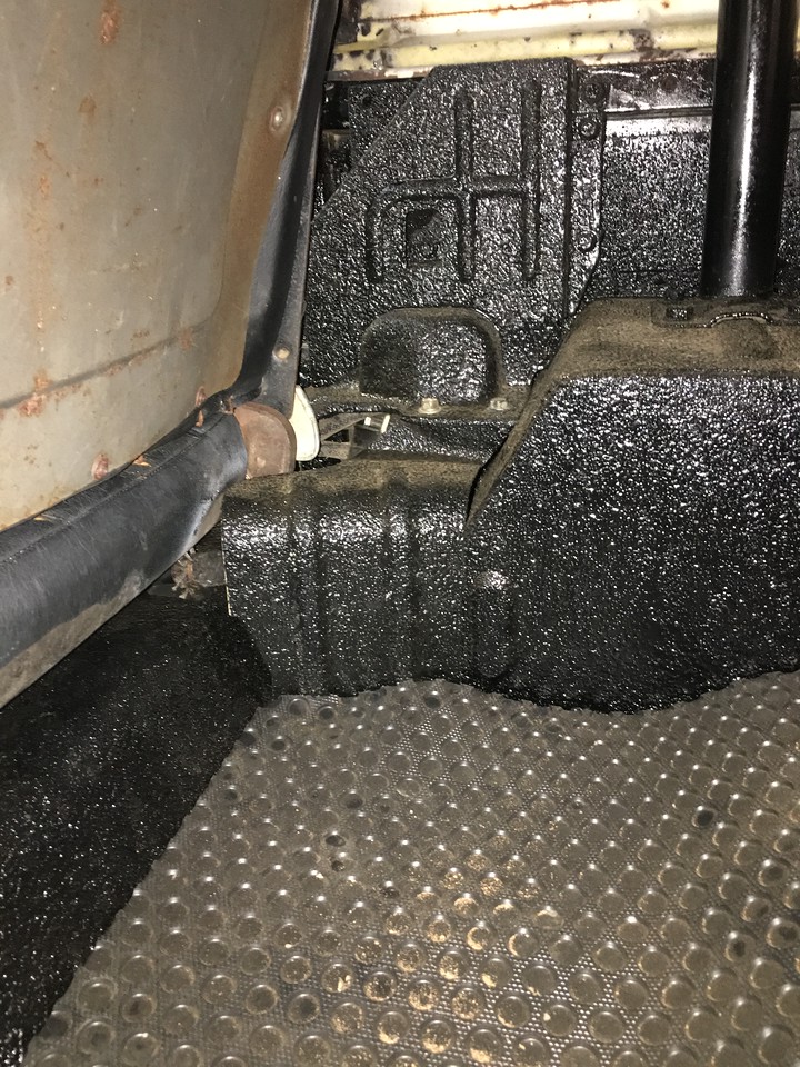

After I got the transmission in I decided to get the interior in. This is a LOT of work and I am damn glad I had not done this before I found out it needed a transfer case replacement.
Everything has to come out to get the tranny hump in except the fuel tank and that is a close call. I got it in and installed the Tuffy Console before I put the drivers seat in. It is a tight fit but it really really is a superb upgrade for an arm rest and one place that is secure in a vehicle with no real locks.
I really like the fit of the @Cruiser Corps mats front and rear. Nice job guys.
New OEM shift boots from @beno
So happy to see this all back together......

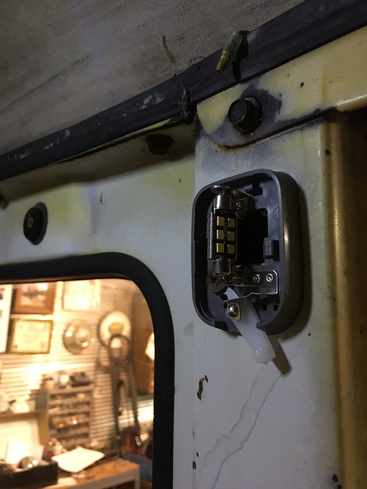

Lou showed up and took over the job of placing the OEM handle in the lift gate while I buttoned up the interior.
Had to tap one bolt for the shocks to hold it up, but everything bolted up nicely with this donor lift gate from the parts 40 I bought

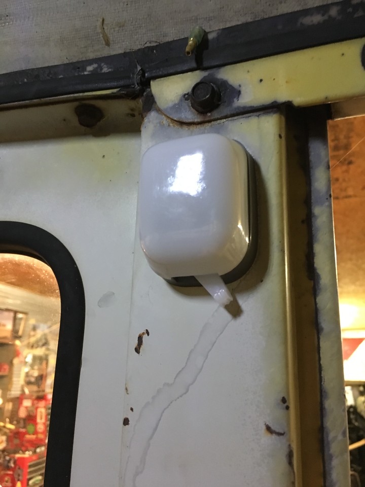

Also added a new interior light with LED bulb
