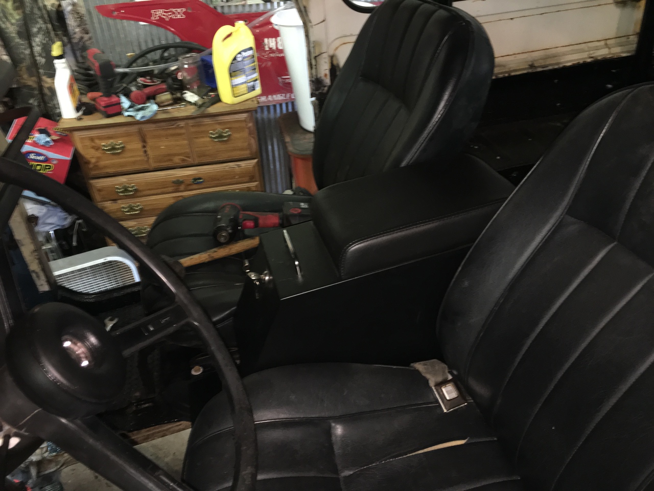

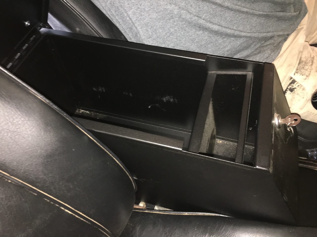

I put the seats in thinking the owner would be coming back to drive it yesterday, Lou also had a brand new Tuffy console that would not work in his truck. He sold it to this project for 50 cents on the dollar. This will give Brian a place to lock up his things when he stops off at some fine Delta eateries......Thanks @under_psi we will bring him to Lou's on his next trip and he can sample some of your fine dining.....
I'm really bummed this driver seat has one tear. The rest of both seats are almost perfect.

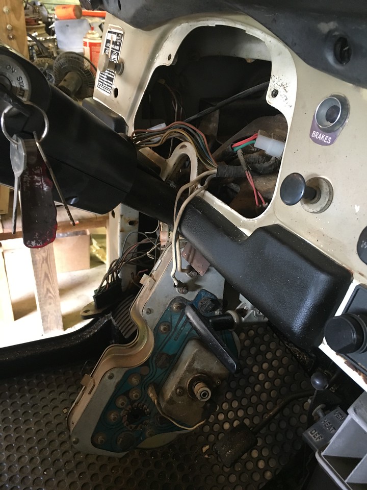

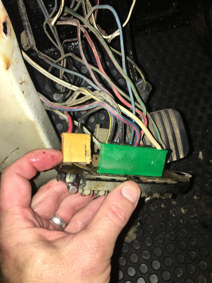

The electrical system seemed good but I have no headlights. I reached under the dash to check fuses and the fuse box fell apart. Dammit.
I look on @Racer65 site and he was sold out of fuse boxes and was so sad to see him sold out. I Hail Mary'ed him to see if he had one.....and he did!! I ordered up one......also some of his cool LED headlights for those dark Delta nights and a lift gate handle.....
In the mean time I pulled as much stuff as I could without pulling the heater and cleaned up all the weird wiring. Hopefully I can plug in the new fusebox and this thing will be "wired" If not, it will be close.

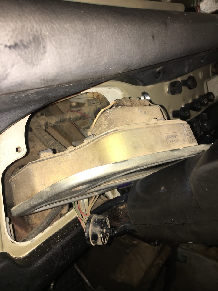

The speedo was not working but it is new so it wasn't a problem at the cluster.......
I traced the speedo cable into the transfer case and it wasn't spinning in the speedo housing on the Tcase.

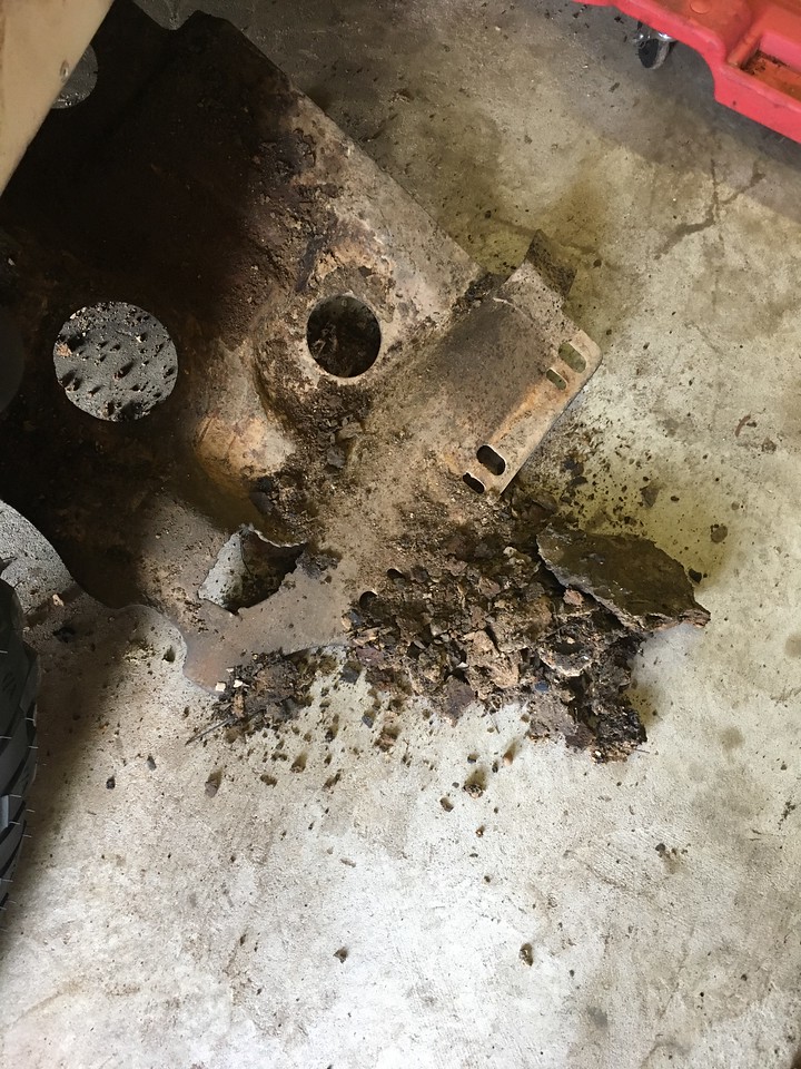

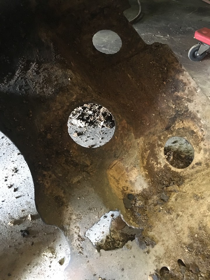

I decided to pull the NASTY skid plate off and just clean up and possible pull the speedo tail housing and just get a new one from @Mudrak like I did on my Pig.
I think there was 20# of mud on top of the skid......

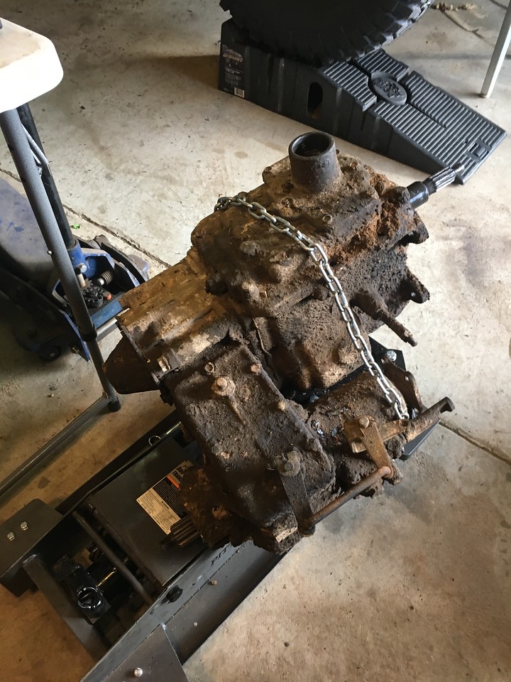

I reached up and checked the rear driveshaft......solid. Joints tights. Good.
I reached up and checked the front driveshaft....joints.....solid. Tight.

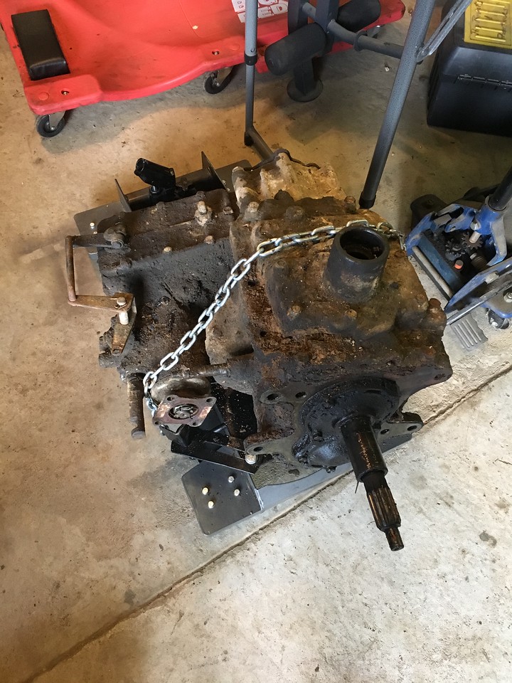

Front output.....loose. s***! Pulled the shaft. Nut is tight. Bearing is shot. DAMMIT! The transfer case was difficult to shift but I had gotten it to shift so I thought it was OK.
I wanted to change the clutch out while I had the tranny cover off so I was going to pull this down, but now I have to find a 4 speed case. And of course, thats on me. It was busted when I sold it.
This dirty ass thing was driving me crazy anyway.
Dang, that blows. You gonna buy a new used one, send it to Georg, or try and do a rebuild yourself?
Before you toss it, fill it up with some deisel and ATF and let it sit for a few days; rig up a way to get it spinning with a heavy drill or something else. The deisel and ATF have tons of detergents in them that ought to clea the s*** out of that t case. You might get lucky and only have to replace a bearing or two.
It's worth a shot to save you a ton of time and money.
I'm going to find a good 4 speed case. If that's not quick and cheap I'm going to convert one of the 3 3-speed cases I have to 4 speed with $200 in bearings from @cruiseroutfit
