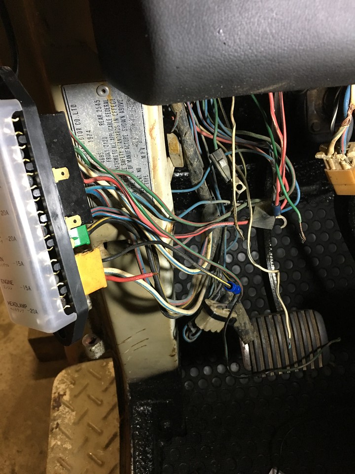

The heater blower is not working. I suspect wiring, not the blower.

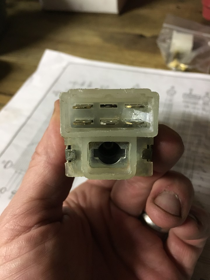

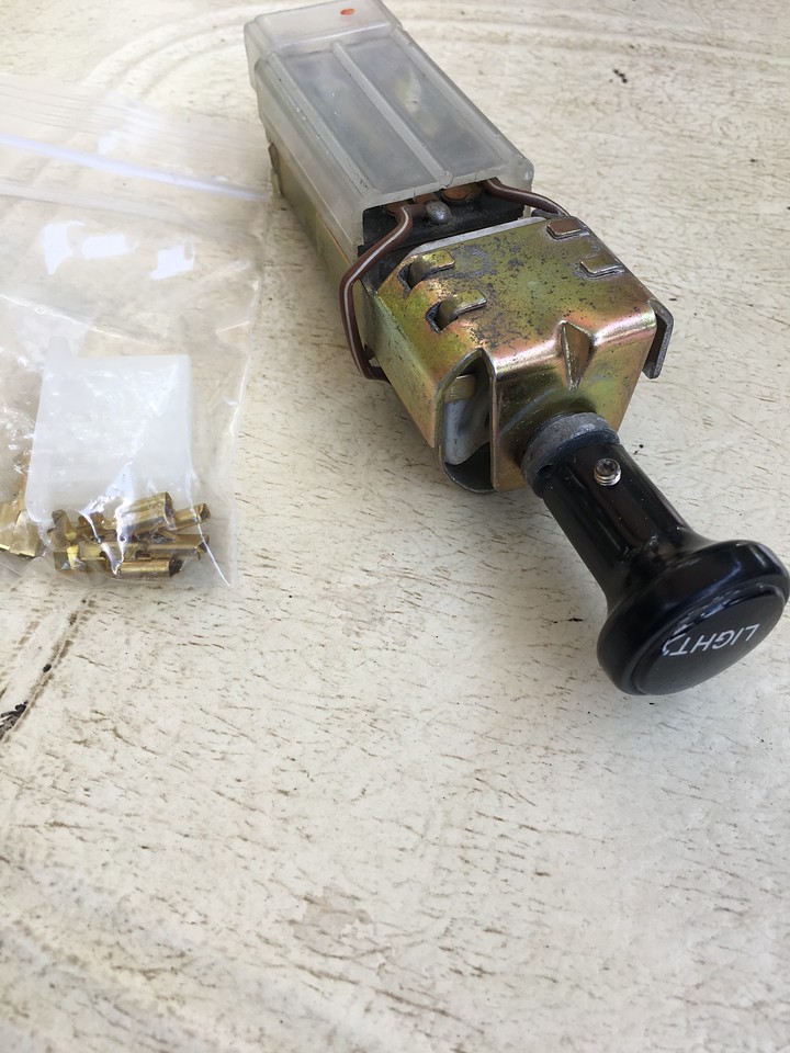

The headlights are not working. Again, I know its wiring as I ripped out the POS aftermarket headlight switch and I am going to sort through this nonsense to hook up an OEM lightswitch.

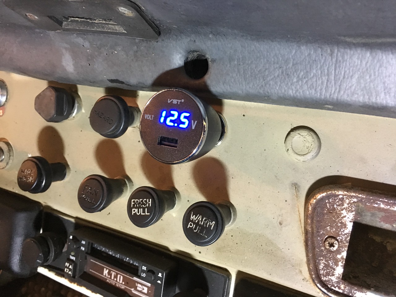

But since that scared me I just hooked up some new wires and a new 12v outlet first
Of course I have no idea which wire goes where on this OEM switch. Anyone know? My wiring diagram calls for a different look than this.

I'm not as worried about dimmer as much as on and off.
I have an earlier switch that the diagram matches up better with.
On Patina I put the lights on an on off switch. Hopefully I can make this happen without too much hassle.
I know a guy who can rebuild switches around here....
