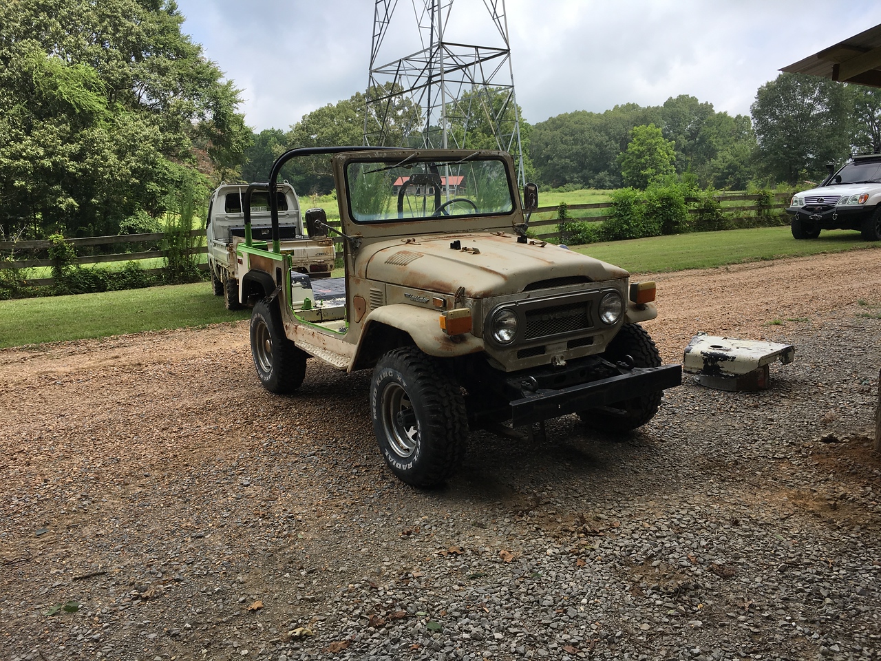

A few weeks ago a friend of mine told me about a guy at a gun store that has a couple of FJ40 doors in the back corner. He asked about them and the guy said he had a Land Cruiser than he bought in 2004 and was looking to sell it.
I rode over one day after work......he was about 40 miles from my house and on my work route, and talked to the guy.....
He's no Cruiser guy. Bought it because it looked good. Told me he was big into military stuff and had a Willy's Jeep and a Toyota Jeep. Both painted desert tan. Not a good paint job according to him (and according to the fairly rust free doors that had the gaskets painted over) in his shop.
I asked if I could go look at it and he gave me directions to his house and I took off.

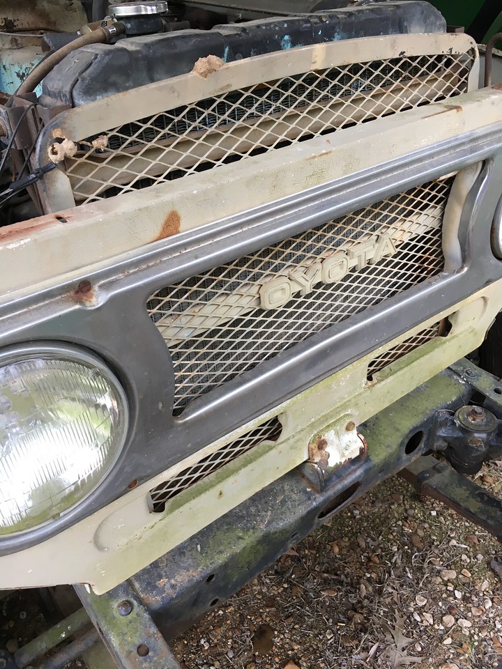

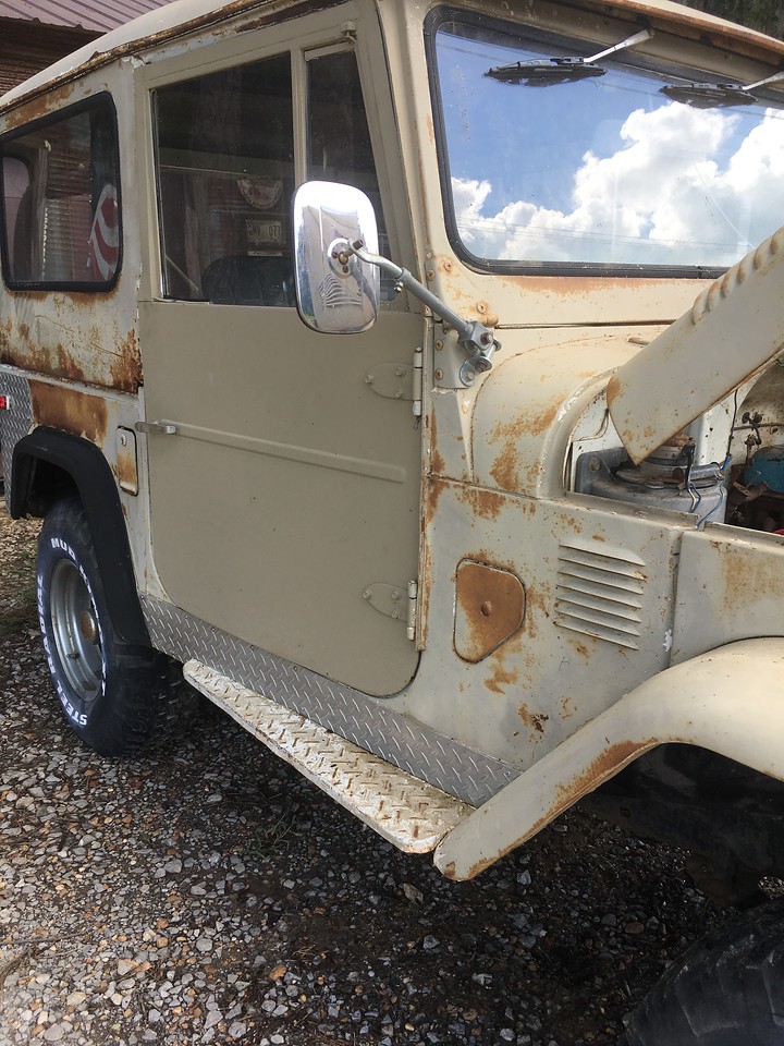

Diamond plate. God I hate it. I almost walked away but then I looked a bit closer.........

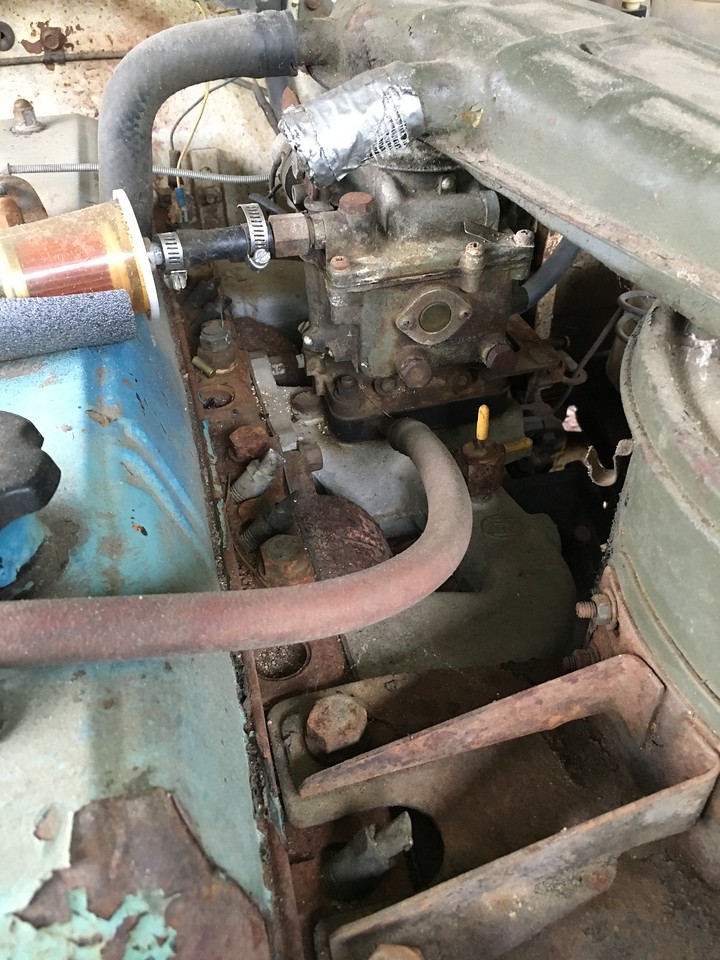

Hmmmm.....still has the Aisin carburetor. That's a good sign.
Would it be a non-Cruiser guy's truck if the bezel was correct?

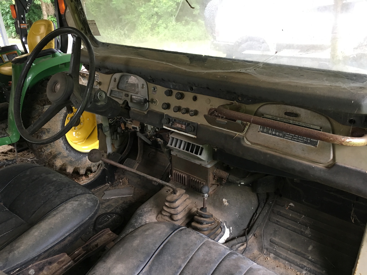

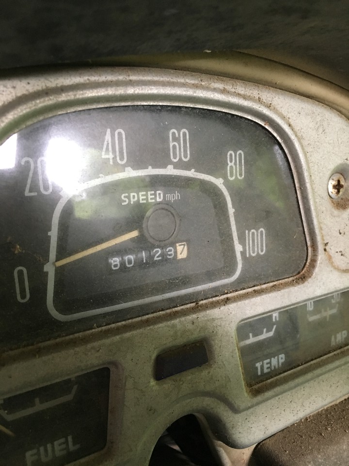

80,000? 180,000? 280,000? All wear points tell me the former..........
Pretty complete and unmolested........OEM white peeking out.
The rust is not alarming. Other than the surface rust and what I can tell from looking in the wheel wells, I think its pretty solid.

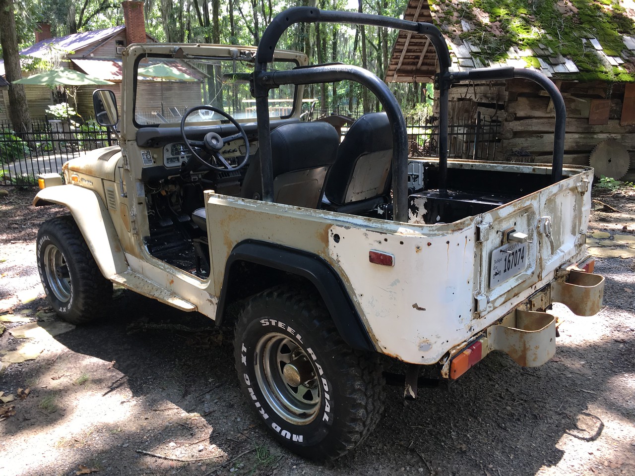

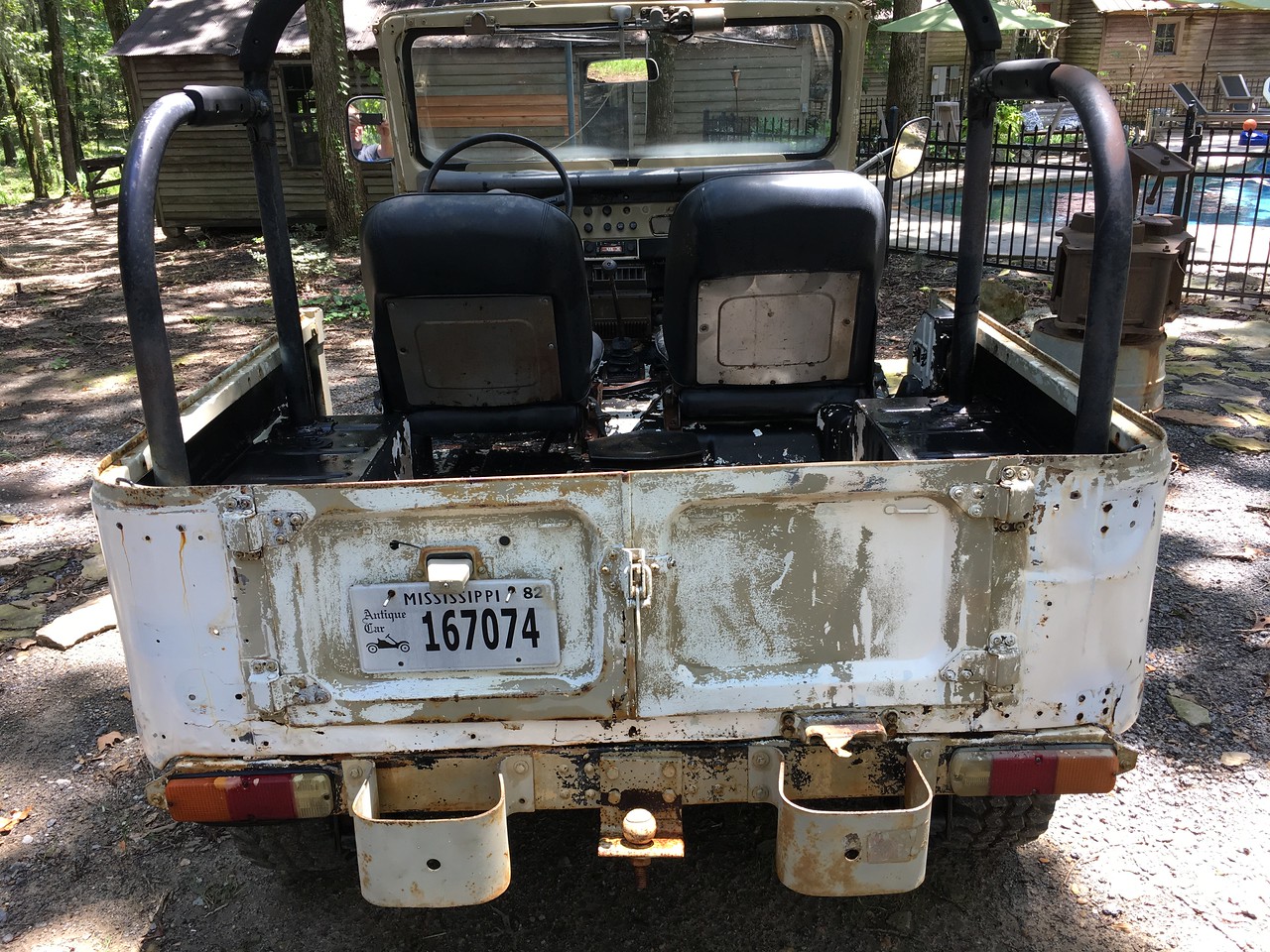

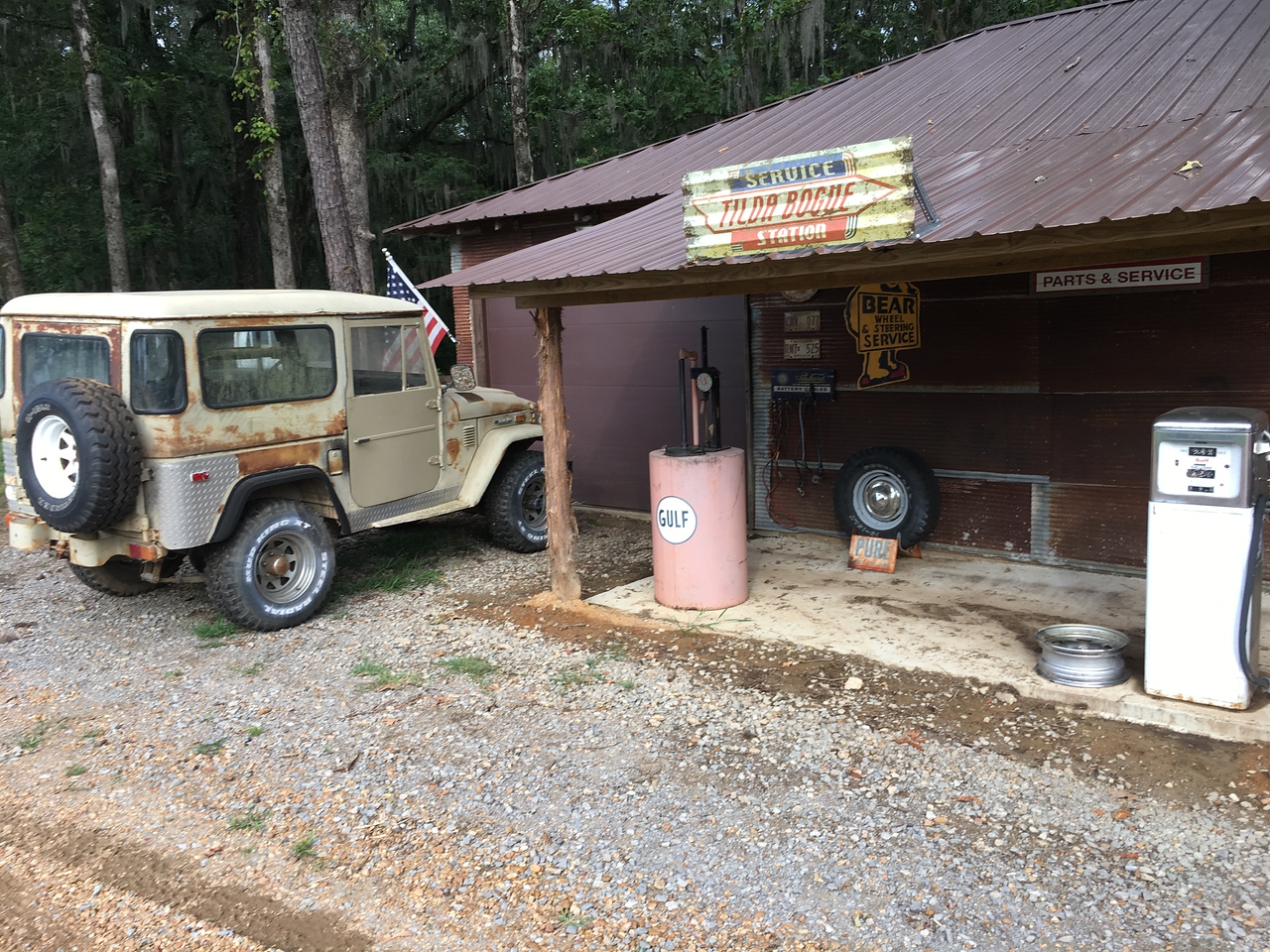

Fast forward 2 weeks and as he promised I was able to drive the FJ-40 on to my trailer and bring it home 40 miles to the east of where this thing has lived, more or less, since 1974. He bought it from the original owner who used it on his hunting property.
UZJ100 tow vehicle. Works great for short hauls.
Unloaded and ready for a bath and inspection

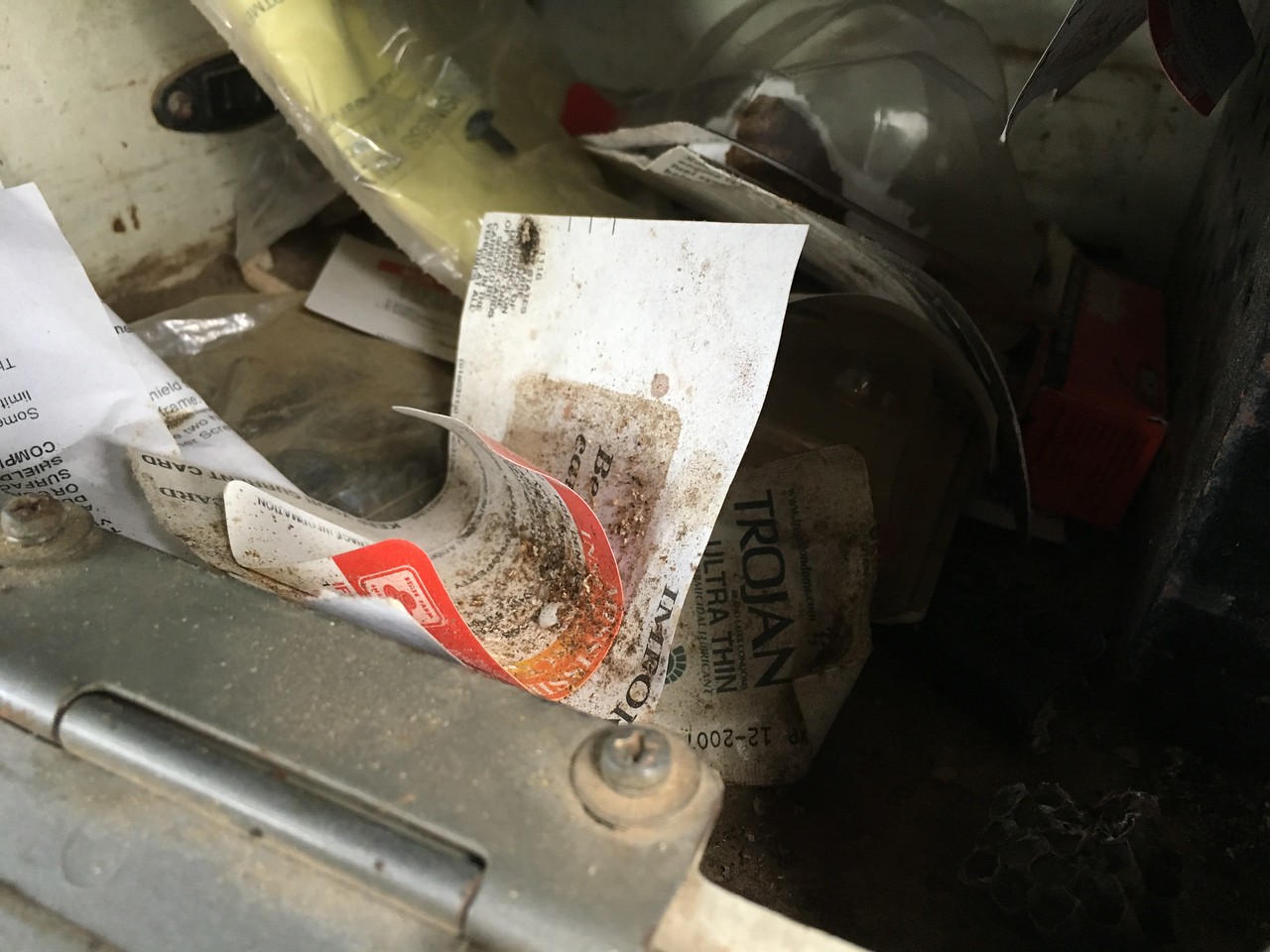

Anyone that has rescued and rehabbed as many Land Cruisers as I have.....this is the best part. Uncovering the contents of the glove box. 3 Trojans. I am assuming the PO got through 3 of a sixer. Good on him.
A closer look at the motor......not terrible. Some unknown electronic ignition and a electric fuel pump were added.

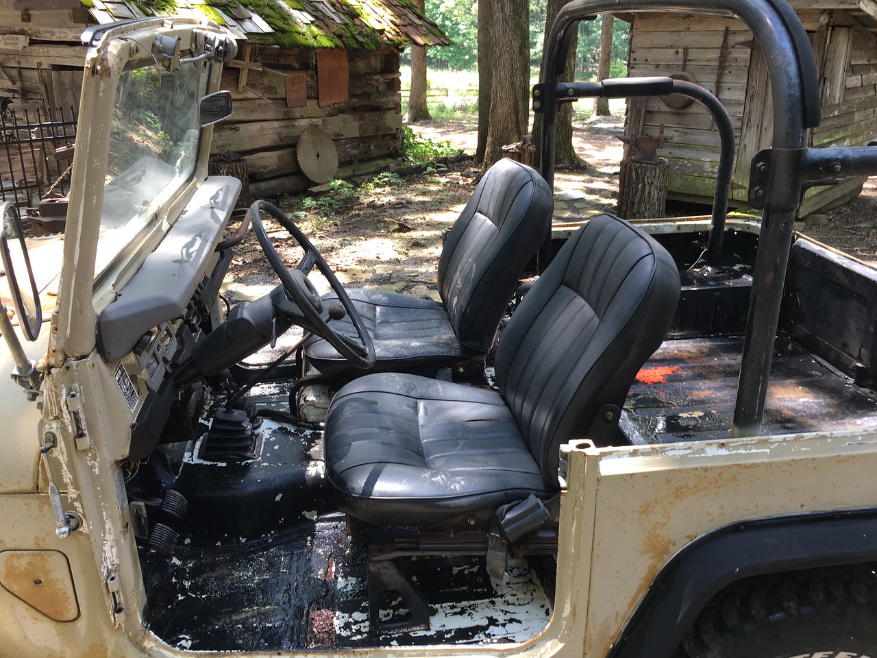

Jump seats are MIA but the OEM seats looked and felt real nice. Sadly there is one tear in the drivers seat or they would be good to go

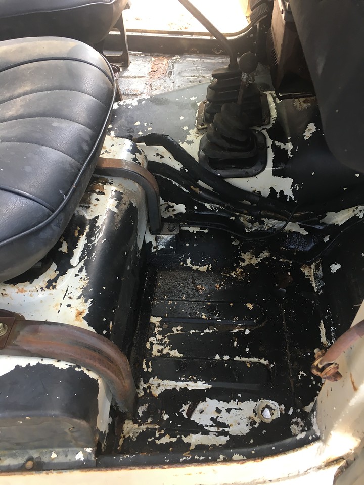

More OEM white.......this floor looks good.

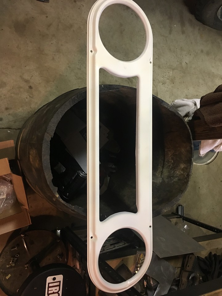

I fix the bezel first.....
Peek under the diamond plate and sho nuff....that was just added for "looks"
Ole girl looks nice.

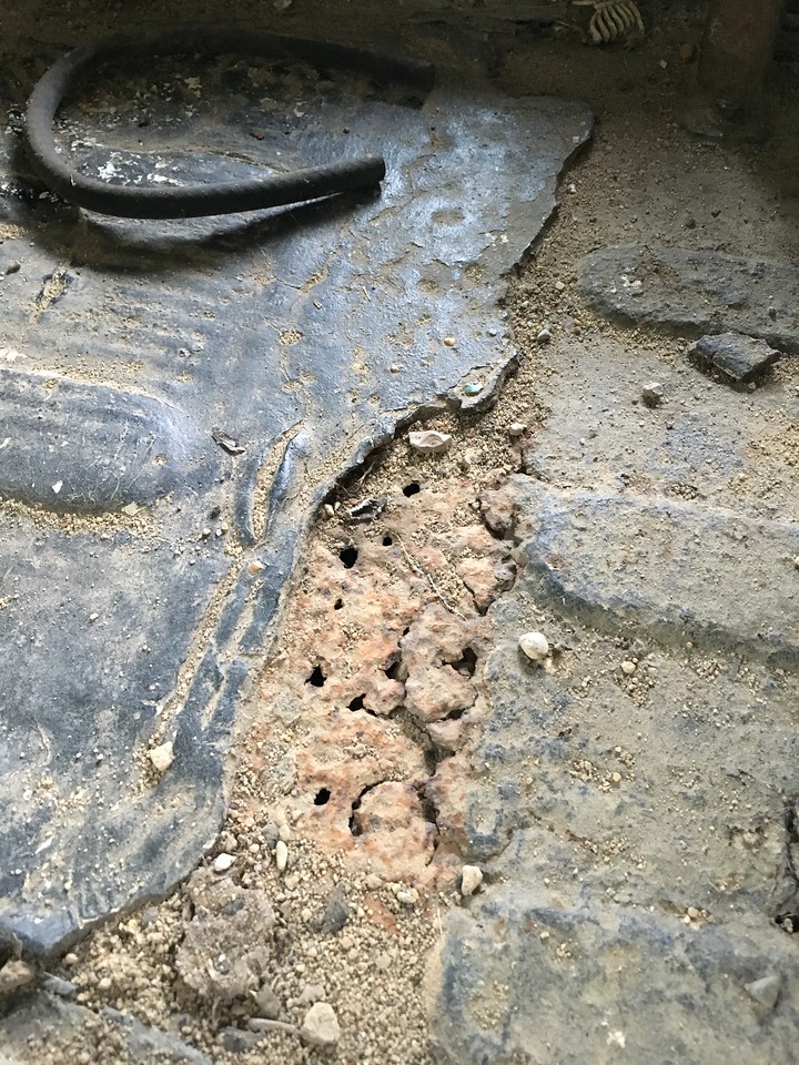

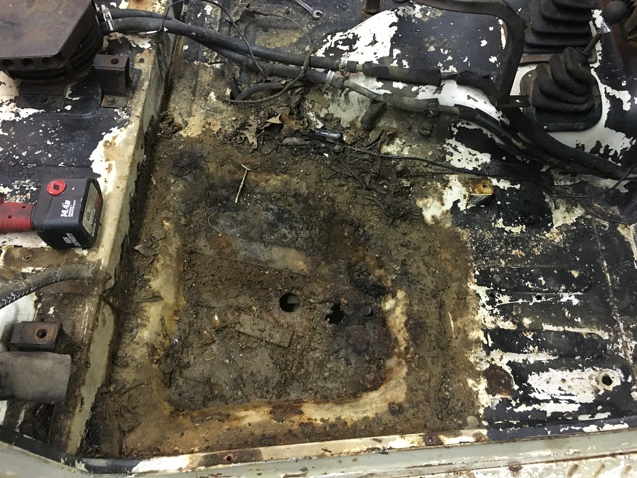

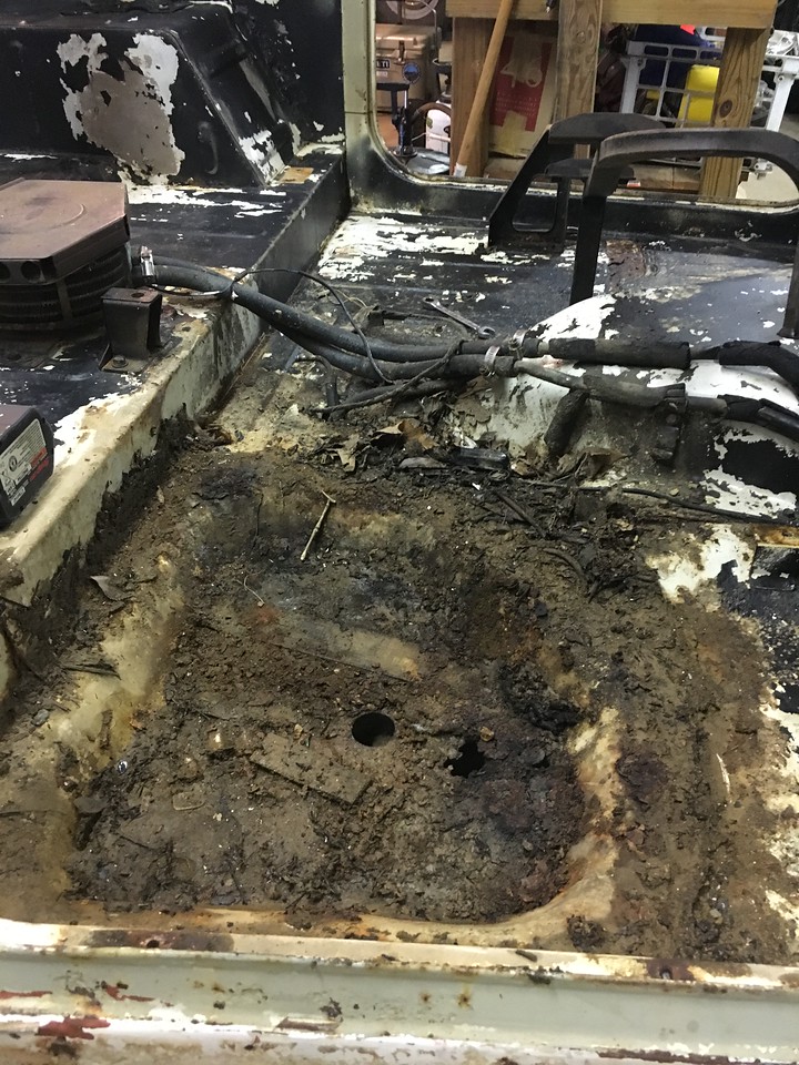

First thing first, is to tear out the interior so I can get to the fuel tank. From below I can see holes in the floor so I know the tank needs to come out at a minimum.

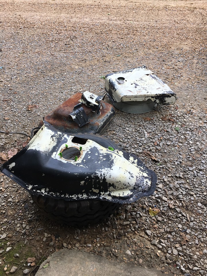

Years of sitting with the top off and crap getting under the tank and this is what happens.
Nasty. Actually, nasty as fxxx. I took one look at the tank and added a new OEM one to my already massive order with @beno
I truly believe the only way to get these things running right is to start over with new parts after they sit up for years with bad gas.

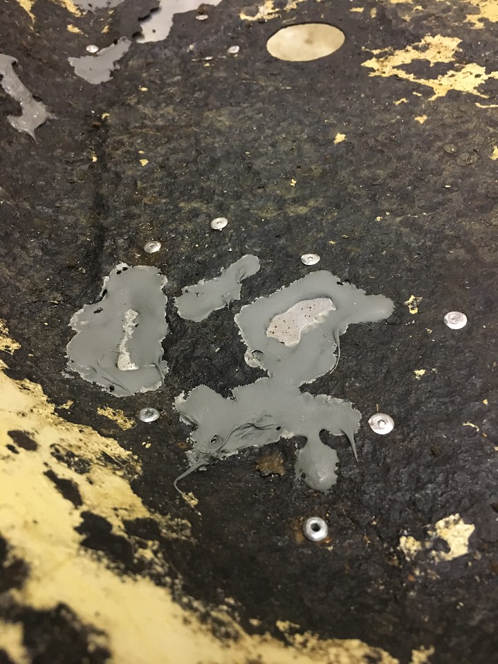

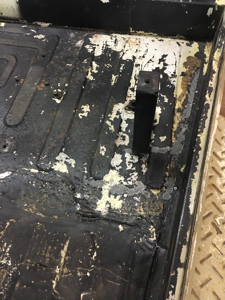

After discussing my thoughts on this truck with the owner, I decided to do some small metal patches and use filler like I did on Project Patina. It has held up really well and I know how to do it.
My friends hate on me for the rivets but it works. Also, if the owner ever decides to have new metal welded in there is no lost work.

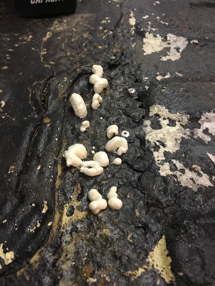

Trapped mud is what kills these things (and the stupid glue Mr Toyota used) on the floors. I use a minimal expanding auto grade foam to fill in all the gaps caused by rot and to keep mud from getting trapped in there. My 2016 4Runner has in in a lot of cavities and I think it is the poo.
Drivers side had a bunch of pinholes. I moved one patch from the top that the PO made to the bottom and used some liquid metal to fill in the gaps.
The black color of all the rust is due to a liberal treatment with some really great Rust Converter I use. I am 5 cans into it so far......

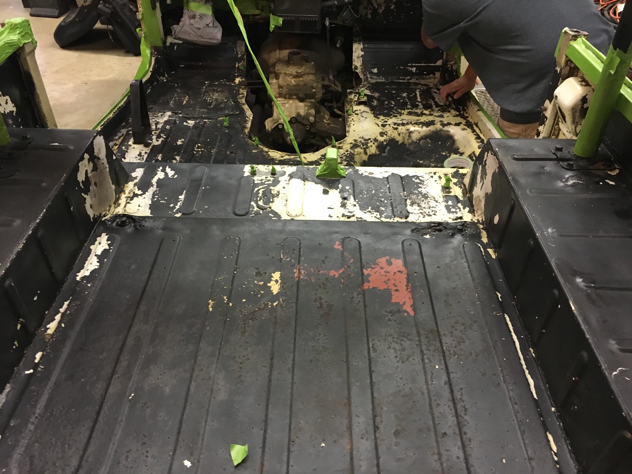

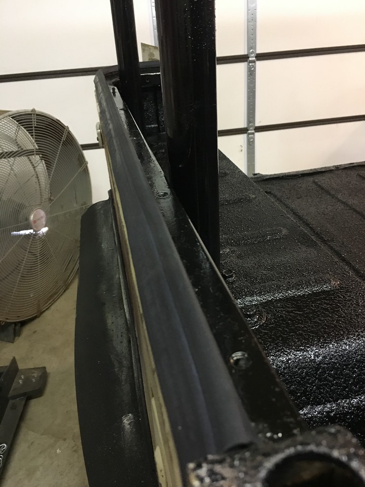

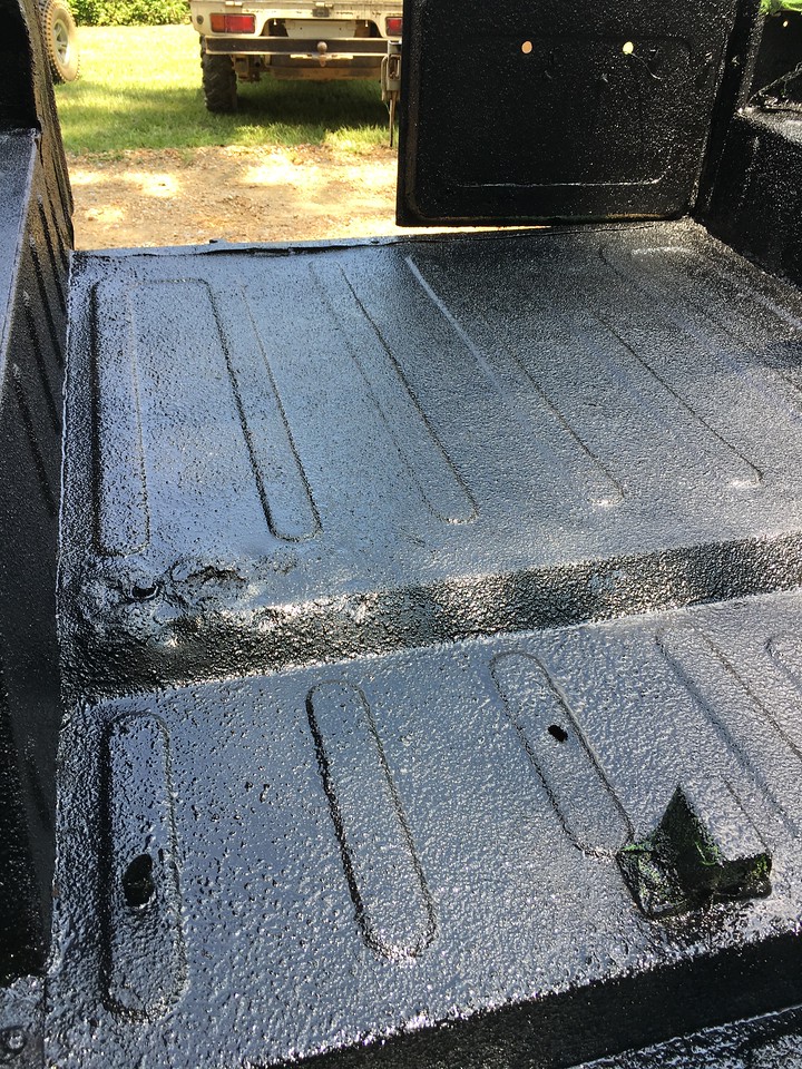

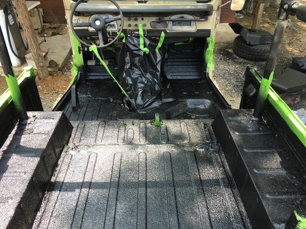

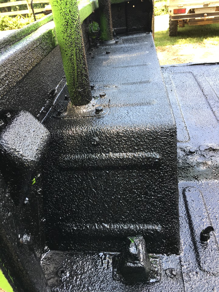

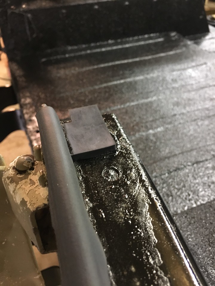

This morning I finalized the prep on the floors. I scuffed and sanded and wiped it down with acetone and water. Let it dry and then my buddy Louis @under_psi brought up a couple of gallons of bedliner, a $27 Harbor Freight spray gun and some masking tape and we went to town on this bitch.
I had never used a spray gun with bedliner but Lou was an old pro. The only bad deal was that my air compressor does not have a regulator so we were pumping out bedliner at 100PSI and not 40 PSI so we had a lot of cleanup to deal with.
I took a break for lunch and Lou headed back home. I went back out and worked it over with a couple of cans of black spray paint. I had covered all the metal with the rust stuff and it was time for paint on the roll bars, frame, springs and bumpers.

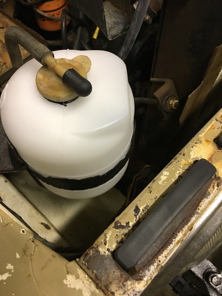

Some of the first parts to arrive were body to hard top gaskets from @Racer65, hood bumps and a overflow bottle. As luck would have it, I had a rough but able holder for the overflow bottle and a cap.

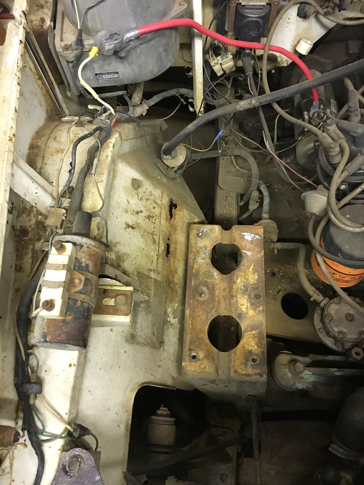

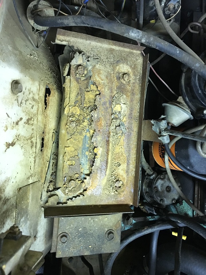

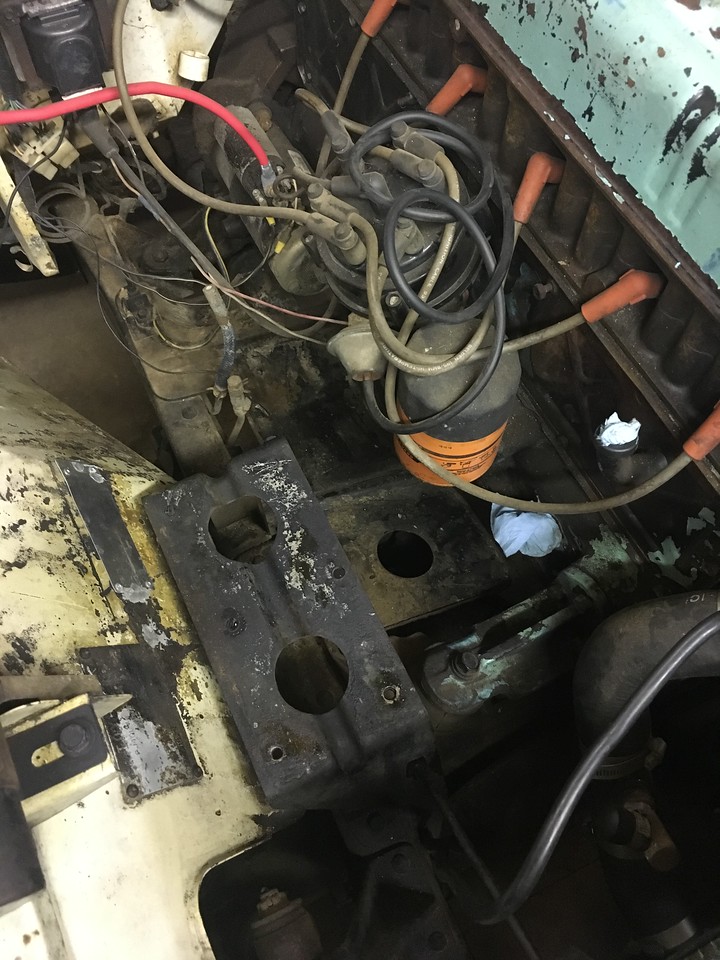

The motor on this truck is leak free and the hood area is amazingly unmolested. I pulled the battery out and got my first surprise. For some reason someone at some time put a huge ass 3/16 plate on the OEM battery holder and then put the OEM holder onto the tray. Of course the bolts were rusted tight and stripped so I had to cut it out of there.
Out with the old....I will replace it with this holder after I clean up the fender area and yank the electric fuel pump out and replace the mechanical pump with an OEM one from @beno

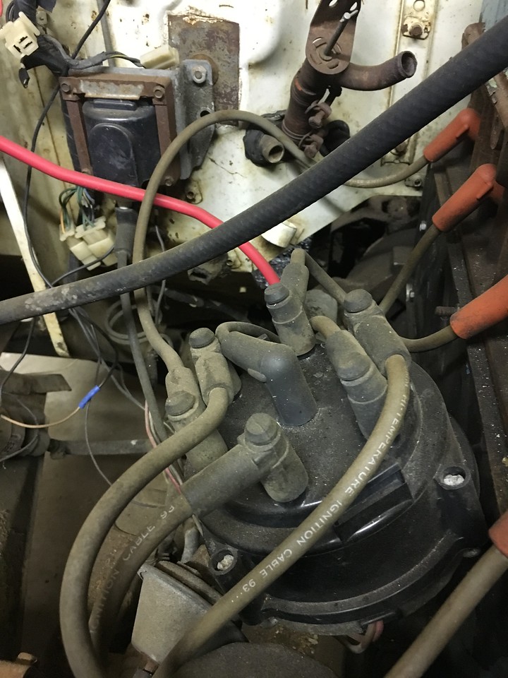

This truck has a electronic ignition and distributor on it. Not sure the brand but it stays.
I have to patch that fender hole. I could not see it when the battery was in there. No big deal.
Anyone know the brand of this distributor?

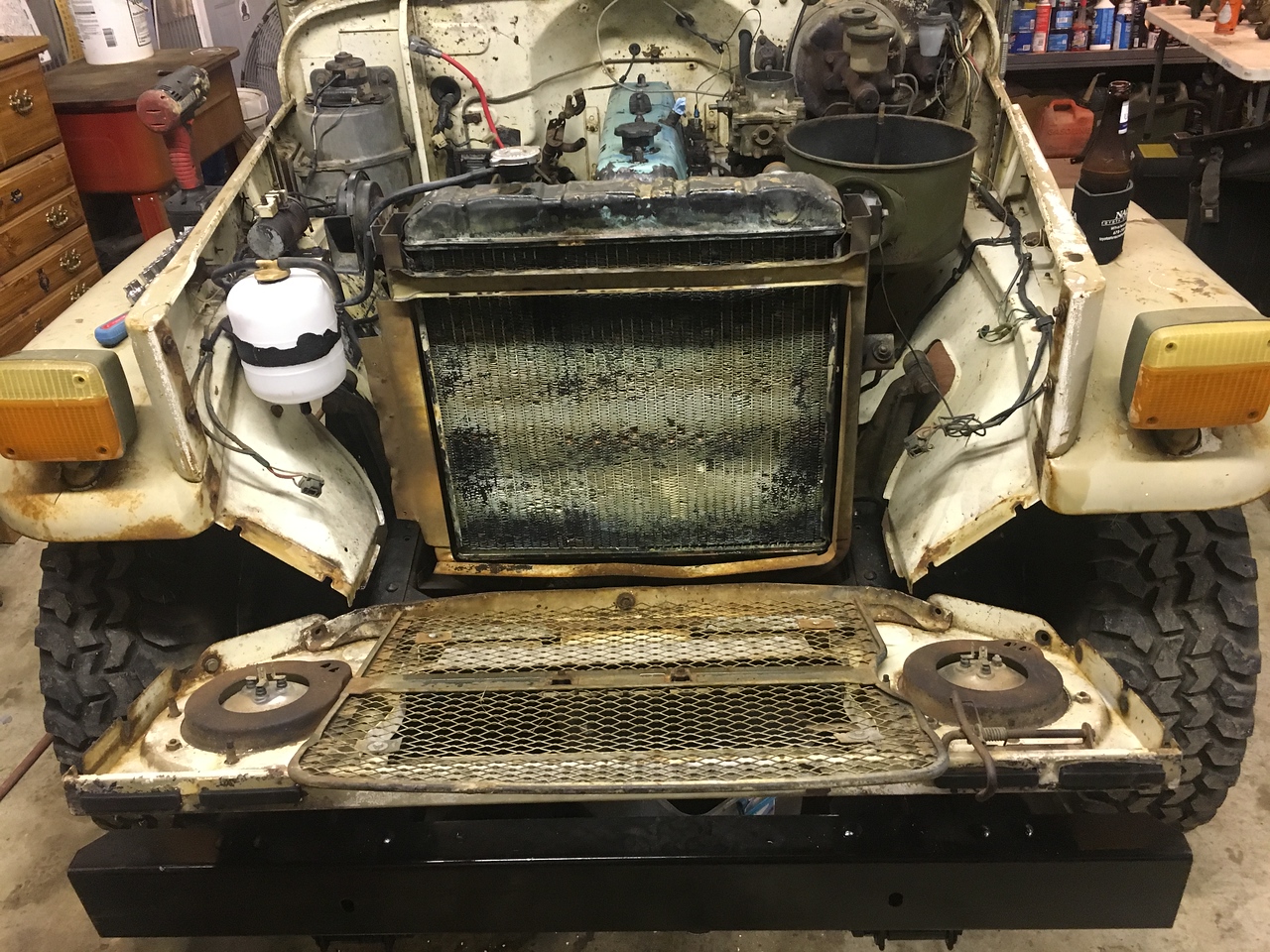

I got a little time on the 40 today after work. Sadly, only one box of goodies arrived in the mail. @Cruiser Corps got me the corner badges and gaskets. I spent more time digging around for the tiny 6mm nuts since they never come with any. I really, really need to buy a bag of them

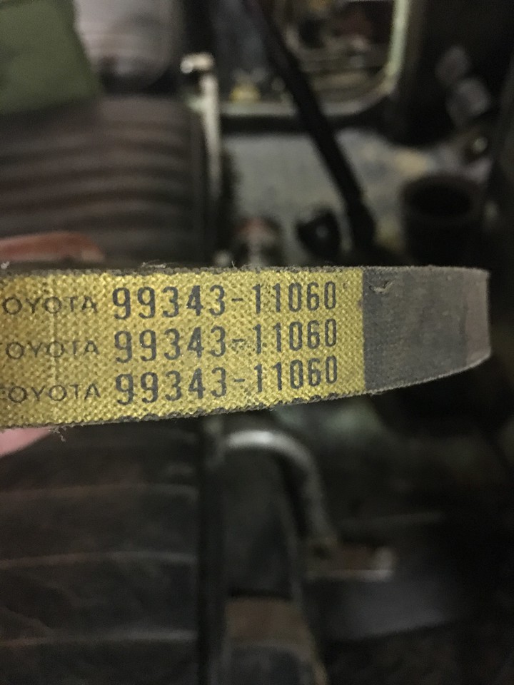

Since I have tons of parts on order to rehab the engine bay, I decided to go ahead and pull all the hoses and the one belt. The PO has a tiny thin belt on that barely worked. I dug around in my stash and found the right one (used) and made sure @beno is sending me the correct one.
I got the electric fuel pump out and then the old manual pump. I have a new Manual pump, OEM toyota oil filter and PCV and bushing ordered. As you can see by the coloring on all the metal, the rust protection has set up nicely. I also patched the fender.
I drained the radiator and flushed it. I think it is good. I am trying not to have to buy one. I never really got the truck hot so I can't tell if it has any pinholes but I got the water and crap out of it. It is truly amazing to me that people run straight water in their trucks. It freezes here. Stupid.
As you can see on the thermostat housing, they have done some nasty home-brew on the bolts holding them together. The one that is still in the housing feels like it is going to snap. Of course it is the one that does not pass through. I went to my F engine I pulled out of Project Patina and sure enough, that one is good so I pulled it and will clean it up good and put it on this truck and kill the booty fab. Thermostat, O Ring and hoses on the way via @beno

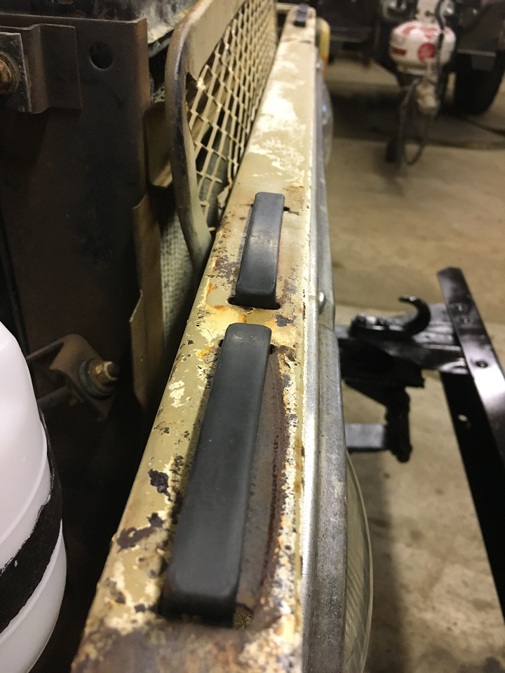

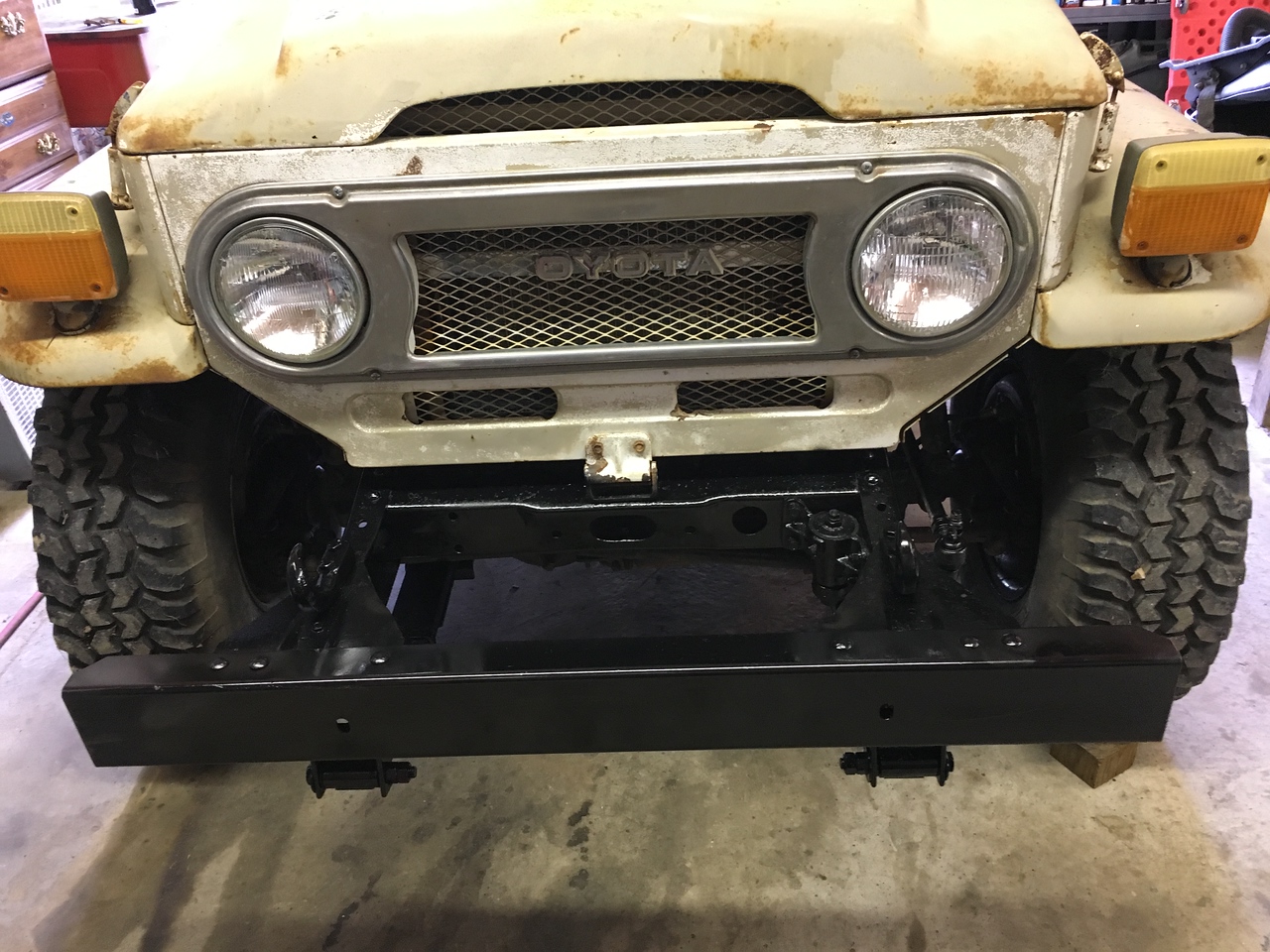

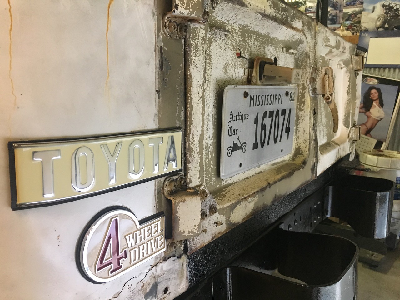

The overstay on the radiator and the non-black mesh, OYOTA emblem......and especially the chrome bezel were killing me so I cracked open the bib and went to work with rust converter and paint
Correct to color bezel......
Rust Converter applied. Radiator painted. Waiting on my new TOYOTA emblem from the Turk and will put it all back
