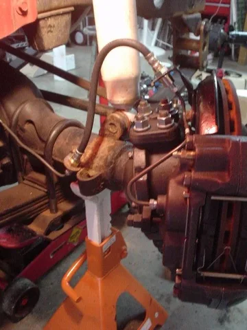

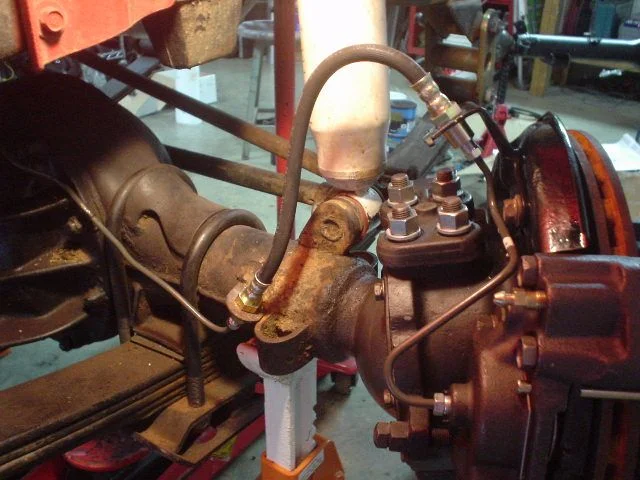

Here is the set up i ended up with as far as brake lines go.
Soft lines are custom and only cost me $25 for the pair made locally. I use the hard lines I mentioned above at the caliper and the stock '71 40 lines on the axle.

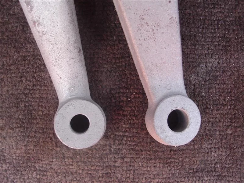

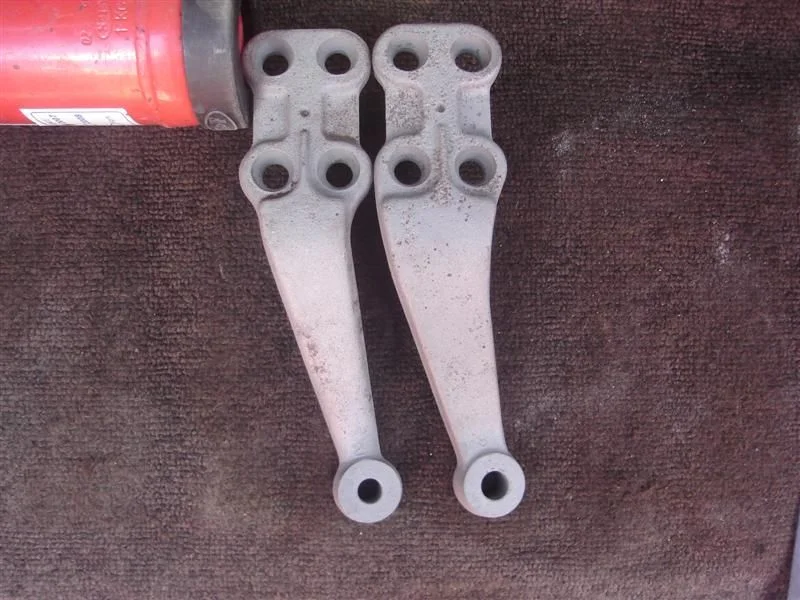

Thanks!... The left arm in the picture is of FJ40, and the right maybe of FJ60.
I can use FJ80 tie rod end to connect draglink to passenger FJ60 tie rod ?... I find more streng steering whitout lift for this FJ40.

Bearings: The knuckle (trunnion) bearings are the EXACT same from the Landcruser & minitruck, so use either though you should absolutely plan on new ones unless you've rebuilt your axle recently.
Steering Solutions: The taper of the mini-truck OR FJ60/62 steering arms is BIGGER than the standard E-84' FJ40/55 tie rod ends. So, you have three options really...
1. Run the FJ60/Minitruck arms (modified minitruck ones as seen in this thread)... AND build a new tie rod with the bigger tie rod ends.
2. Tapered spacers (or the infamous starter bushing). This simply occupies the extra space of the tie rod taper. Its a quick, dirty & cheap fix... but I don't like it for longevity and durability reasons.
3. My personal favorite is using the OEM steering arms from a ~79' - 84' FJ40, they not only have the correct knuckle patter (the big one) but it also has the standard FJ40 tie rod taper dimensions :cool:
