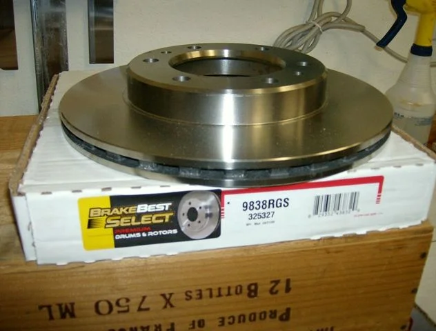

Next Item - I had two different rotor's on the donor axle. One is ~ 2X thickness of the other and had a scalloped edge that holds the hub. I assume that one was OEM and the thin one is after market.
I just picked up after market rotor's from Checker and they are really thin. Can comments or concerns about running the after market rotors or should I try and find OEM?

Morning,
The donor axle ( '86 FJ60) came equiped with mis matched rotors ( see pics 1&2). One is very thick and has scalloped pattern where hub goes. the other is very thin and round opening. The two new , matched rotors, are thin and have round opening. I bought them as front rotor's for '86 LC

Post up pictures of this axle. If you have non-vented rotors, those are stock mini truck and I would return them for vented LC rotors. There are also two different types and you want to make sure you get what matches your hubs.
