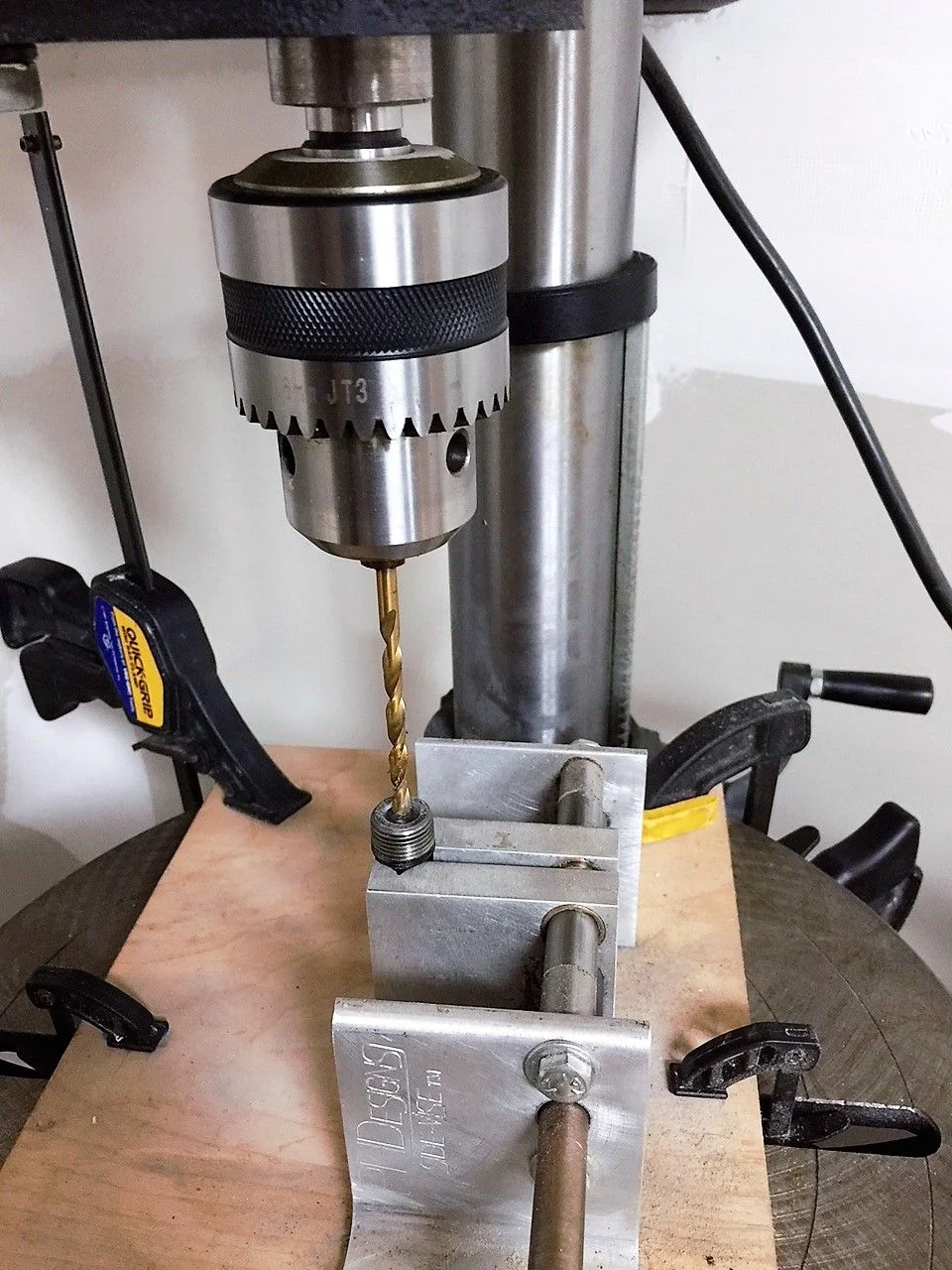

Center punched to guide the drill bit (13/64th bit)
full
Used a little jig to hold the plug for drilling
full
Used a 13/64 drill bit
full
Successfully drilled plug
full

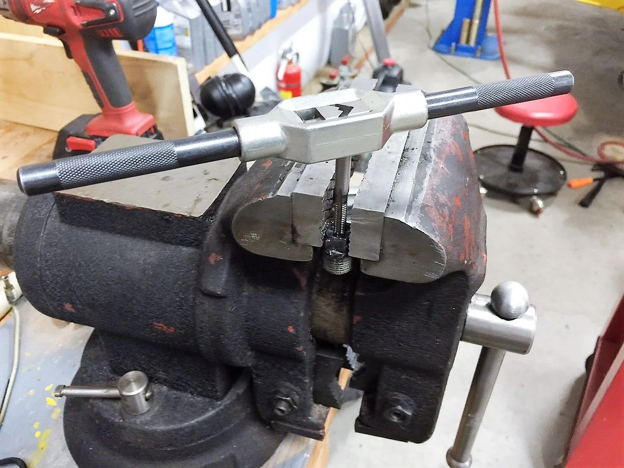

Next to tap the hole, used a 6mm X 1.00 tap
full
Tapped the Zerk fitting hole while using plenty of cutting oil
full

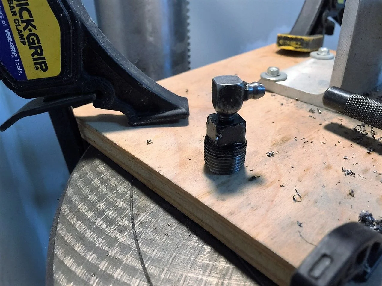

Zerk fitting installed
full
full
A little paint and ready to install
full
One more pic of Zerk installed on knuckle
full

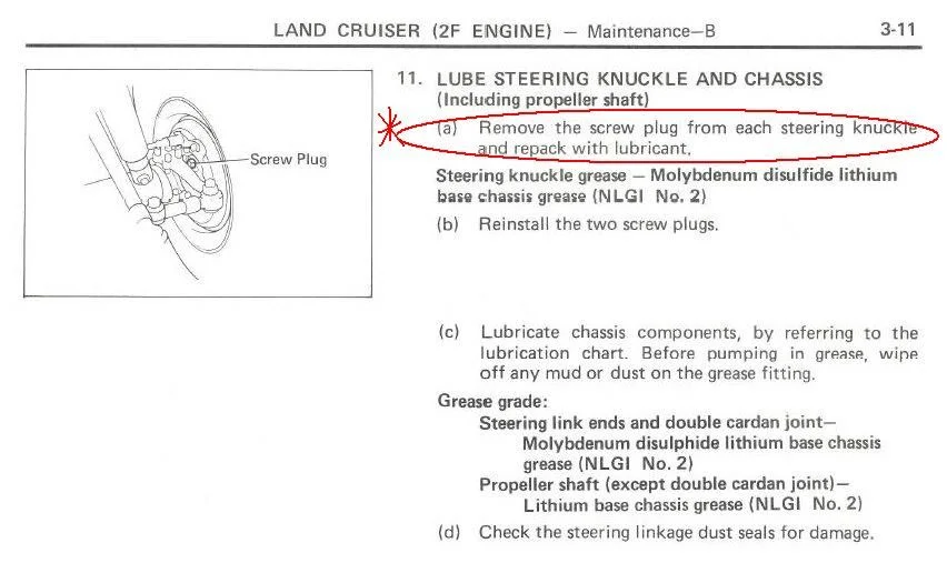

Dave,
The Zerk fittings need to be used with caution when lubricating so the knuckle is not overcharged with grease to the point of blowing seals, the purpose of the Zerk is for ease of greasing the steering knuckle with out having to remove the knuckle plug. The knuckles need to be well lubricated in order to reduce friction and to avoid premature wear of the trunnion bearings and the birfields (Constant Velocity joints), so filling the knuckle cavity with grease is a no brainer as preventative maintenance, but you need to know when to stop pumping grease in the cavity.
I agree Zerks are not bullet proof, I've had quite a few break during normal greasing for no apparent reason, so always exercise caution when greasing joints.
Got this from Tom @lostmarbles regarding greasing of steering knuckles;
plug-jpg.1129346

Dave,

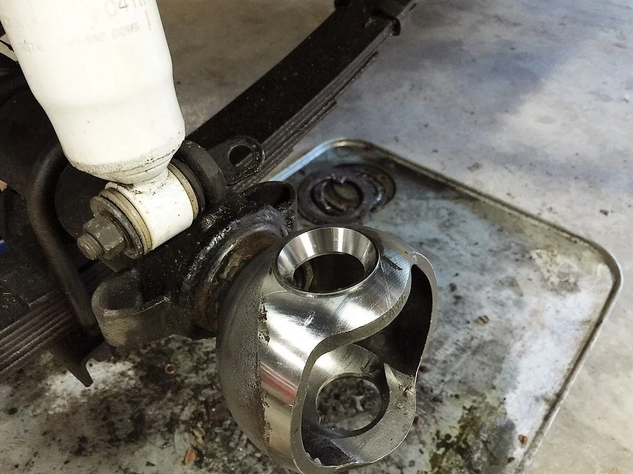

I'm finally starting the re-installation of the steering knuckles.
First Installed the Marlin oil seal with lots of multi use grease to ease the install
full
Next installed the upper and lower trunnion bearing races
full
Hammered bearing race in place
full
full
