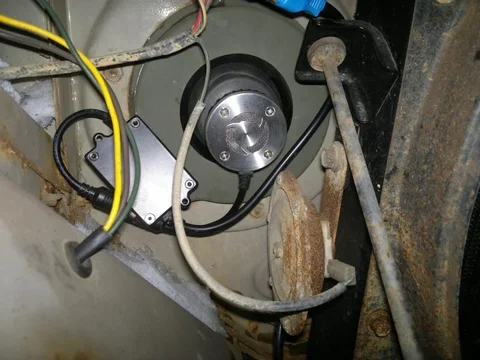

Boot and adapter ring when properly installed will look like this -
On the driver's side , it may be necessary on some Cruisers to loosen and rotate the horn out of the way to insert the bulb into the adapter ring/rubber boot . The wire coming from the bulb will start at about 4 o'clock position , push in tightly and rotate the bulb assembly/fan to the 6 o'clock position to lock it . The internal tabs inside the adapter ring are pretty precise , use some care here and you'll feel it drop into it's groove before locking . No gorilla grips here , gentle pressure is more than adequate .
Bulb installed -
You can see in the above pic how the wiring harness exits the bulb from the 6 o'clock position - this is locked into the adapter/housing . A gentle tug will verify it's locked in place . If you had to loosen the horn mount , don't forget to tighten it back down as that's how they get their ground .

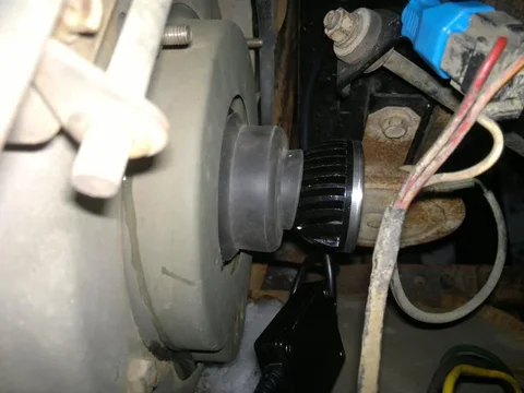

Here's a side view with the LED unit installed . They do protrude a bit but it really shouldn't interfere with most accessories - even on the passenger side in front of the overflow tank .

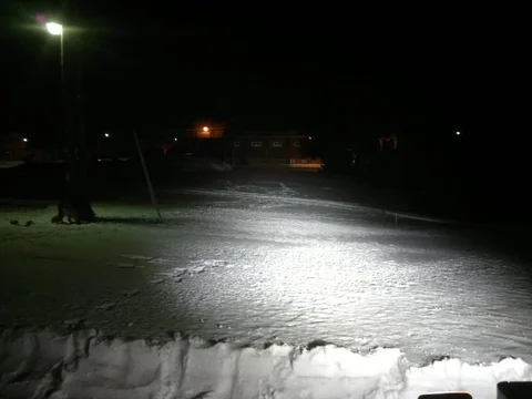

Just for giggles , here's a quick shot of the LED vs Sylvania Silverstar - LED is on driver's side . Quite a stark contrast in color temperature .

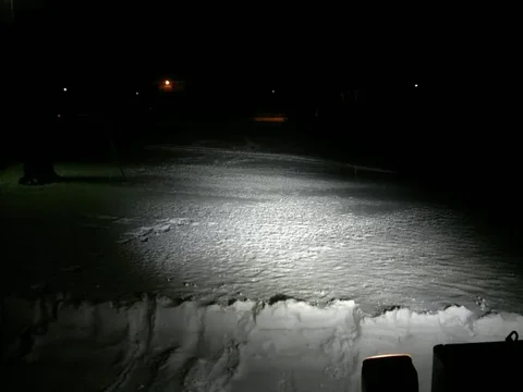

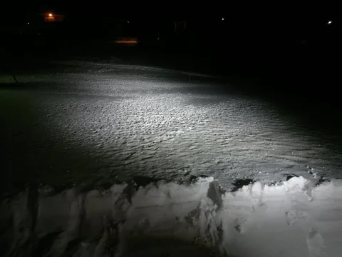

The stark difference in light color on the snow - you'll notice the much whiter light on the left and a much brighter pattern on the ground itself .
Here's both LED's on low beam , absolutely no adjustments have been made for aiming these lights compared to the halogen bulbs . I did have them set a bit low already and no change in height -
High beam - both LED's -

I spent a couple hours out tonight re-setting the alignment on the new LED units and just some overall driving tests , re-setting and such . Impressions are better than expected to be honest but there are some slight disappointments .
First , the good -
Very bright , especially out to the 25yd range .
Spread is good , a bit maybe on the tight side compared to most halogen equivalents .
Low beam does indeed stay on when brights are activated , unknown as this could change on a different vehicle since grounding could be a source for this . If ground is controlled or switched in any way , they may not light both elements on high . It is nice to keep that bright area just ahead of the vehicle when on high beam ....
Color temp is excellent , nice solid white light with no hint of blue - especially on snow or wet asphalt which is why I hate 6000k+ color temps . Just can't figure out why the industry drives this so hard when usable output on the pavement is diminished above 6000k .
The bad , or minus points as I call it as none of this is honestly a big deal or disappointment -
Not a great deal of spread without pushing the driver's side lamp into the other lane too far at close range . It's hard to photograph at night but that lack of spread creates a really bright center area with the light tapering off to the sides . Now I bring up this point since the IPF housings are designed to spread the light out while providing a very sharp cutoff line to prevent blinding oncoming traffic ....some of that is lost .
Not the greatest cutoff but overall a lot better than expected and far above any other designed "upgrade" I've tried to date . Pictures will show this below . Not really a big deal but that needs to be pointed out as some housings may make this worse .

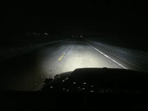

Anyway - here's some shots , all taken with engine @ idle , heater on low , 1/2 tank of fuel and no weight so they are set a bit low .
First , @25yds -

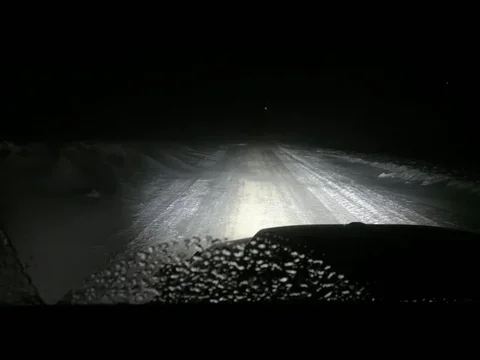

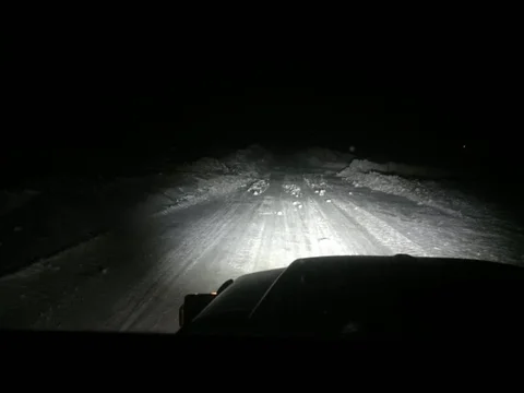

Low beam , gravel road in this lovely 35mph+ winds and blowing snow -

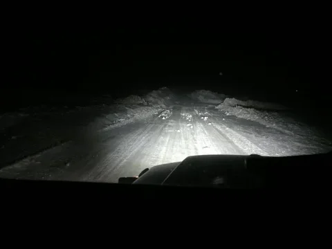

High beam , same spot on road -

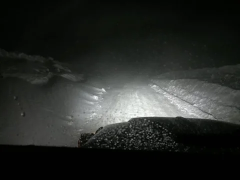

Low beam , serious whiteout conditions -

Open highway , low beam -
Overall , quite impressed . Nicest part is letting the engine idle at a stop and not seeing any dropoff in light output . When the engine is brought off-idle it makes no difference to the lights at all . Even with the heater running on full blast and my PIAA 520 85w fog lamps running the amp gauge down to -20a the headlights remain at full bright despite the fogs almost being so dim they don't show up .
One thing to note - there isn't a "normal" difference between low beam and high beam . It is only a slight increase in height and this is probably due to the IPF's cutoff in the housing's lens . I would expect some of the other housings out there to react differently . With that said , the high beam still provides a good usable light that will illuminate signs easily out to 1,000ft mark . Not worth trying to capture on a camera so I didn't shoot that part .
I do like the light concentration in the snow conditions and they should perform quite well in fog . We're due to have some pretty high temperature swings in the next couple weeks so I'll keep updating this thread and try to gauge in pics how they are working .
