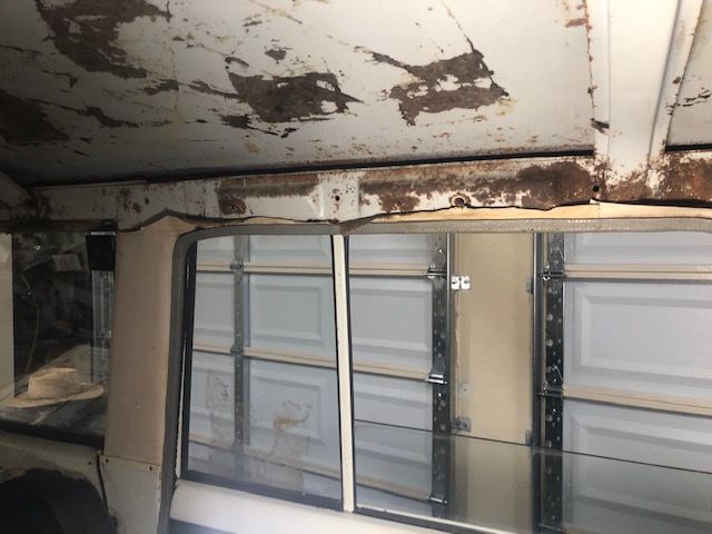

So Steve is in garage, carb just rebuilt, fuel tank rust next(as soon as back gets better. But first mouse urine smell in Steve and garage has wifey not happy. So im thinking wire wheel removal of rust, then Por15. any thoughts?, I know some guys prefer an Eastwood product?
Since you have the headliner out, get something with a spray tube and spray the crap down in the gutter area. Then spray it down the pillars. I did use Eastwood internal frame spray. Spray some kind of rust converter at the least.
Yep, when I saw this I wondered how far it had gone and what to do. The search begins. Thanks for the input
I like Corroseal since it's water based and doesn't need to be top coated. I plan on using it in every cavity I can get it into. There are many good rust converter products out there but most need something else on top to be effective.

Second on the Corroseal. We use it extensively up here in the land of salt and winter misery. Pro-Tip: Don't use one of those sponge type brushes to apply. They melt into a purple goo that is really tough to get off.

$30 a gallon on Amazon. Works great.
Found a small space on drivers floor with rust through, missed that on inspection, pto winch blinded me! oh well, not sure i would be paying my dues if there wasnt some rust.
So im thinking Por15 on floors after repairs, also need to get something down pillars to stop any rust there-thoughts welcome

But first mouse pee smell is gagging me, starting on thatView attachment 2530308

I used POR15 on my Pig and the 3-step system takes a decent amount of pre-preparation. I used paint brush on any surfaces that were hidden like inside of the doors and body and sprayed outside panels. I used the POR15 topcoat primer and it works well, goes on thick, and dry sands well. (POR 15 doesn't play well with other primers apparently unless you light sand it first or spray while still tacky). Make sure and buy the POR SOLVENT if you go this route.
I tried to pull a POR 15 soaked sponge on wire through body pillars with limited success. Also tried POR 15 in those cheap aerosol paint sprayers and flooded inside the roofline. It was pouring out all the lower seams but probably only got 60% of the surface. Opted to go with perforated headliner so breathes and doesn't trap moisture.
Don't get POR 15 on your skin as once dry it doesn't come off. Wish Patina look would have been the rage back when I started.
