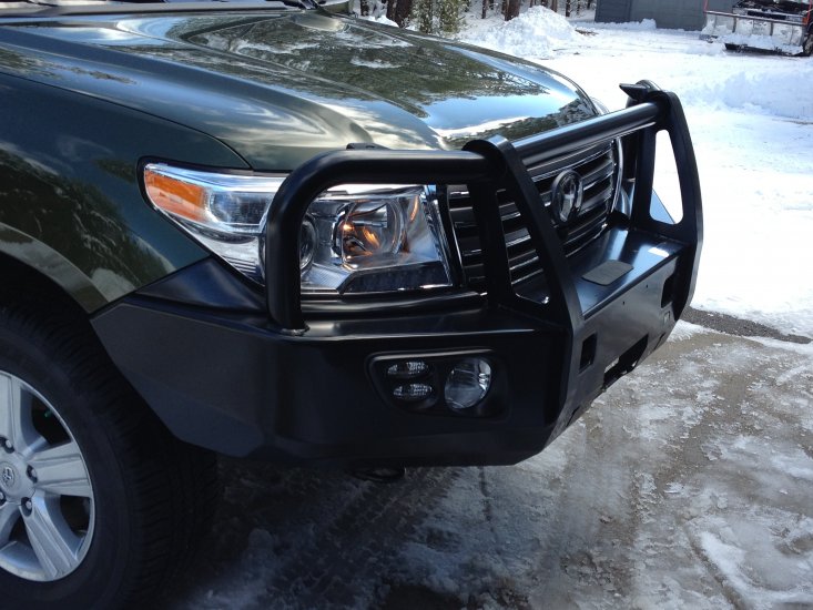

I called LT today at Metal Tech (he sounded less sad today), and placed an order for the Foam Cell Pros with the C-rate springs on the front (for a bullbar). It should be here some time late next month. Cost was approximately $1400 shipped. I am looking forward to them.
I will probably buy the TJM T13 bullbar next month, and may too source it from Metal Tech, as they are now importers for TJM products.
Why the TJM bullbar over the ARB? The ARB protrudes too far forward and the TJM sits closer to the grille. The conventional mounting method of attaching a bullbar on a 200 requires you to destroy your factory bumper, cutting 80% of it off. The TJM solves this problem by providing you with their own proprietary bumper piece. You can remove your factory bumper, install the TJM plastic trim, and then attach the bullbar.
Notice the piece of black plastic trim just above the bullbar:
The plan will be to install a winch (obviously) and then I'd like a pair of Lighforce HID driving lights with Amber or Yellow covers. They look bad ass.
Word.
