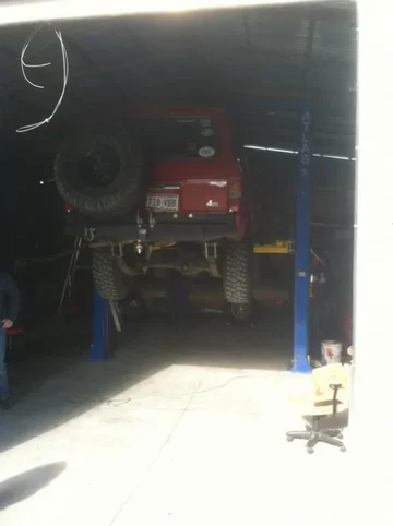

Got the truck up on the lift ( my dads Christmas present to himself )
Tires off, getting ready to drop axles

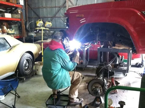

Mig
Working hard

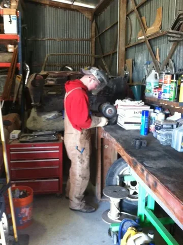

Grinding wheel action

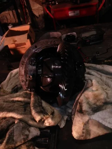

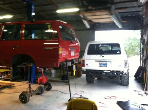

About to rob the rear axle with a Detroit locker from the parts rig. We bought it off a guy from mud a couple years ago. My dads planning on doing a body swap and making it into a clean stock rig.

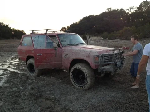

Here is a pic of the cruiser with the shackle reversal and 35s, I liked the setup but felt like it was time to go to the dark side and go SOA
Not afraid to get it dirty! And I'm sorry in advance for the cell phone pics, it all I can do right now.

Getting ready to do my 60 as soon as I get a garage built. See you put a Atlas lift in, you like it? Lots of pics now! :popcorn:
Oh ya man the lift is a dream! It makes a world of difference when working on the truck! It's really nice being able to work on the truck without rolling around on the ground and shuffling jack stands and stuff all over the place. Definitely recommend it! I will be home Friday from North Carolina so the pics and progress will start coming back as soon as I get home! Thanks for the interest man.
