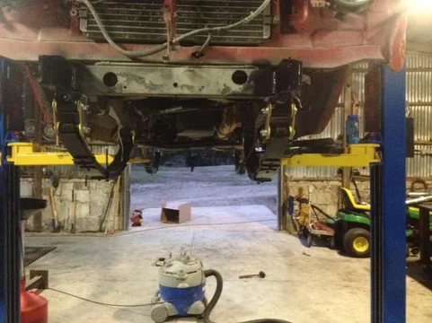

Had some extra time after school so I got some stuff done..

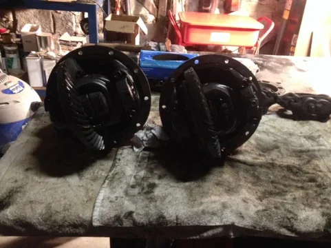

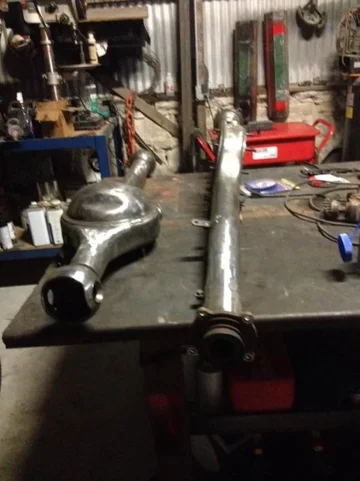

Started cleaning the axles

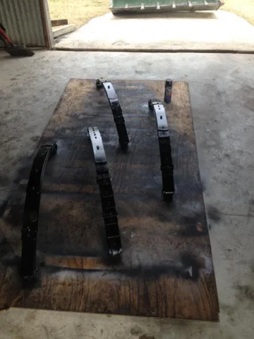

Took the add a leafs out of my old spring packs, still need to get two more for the front.

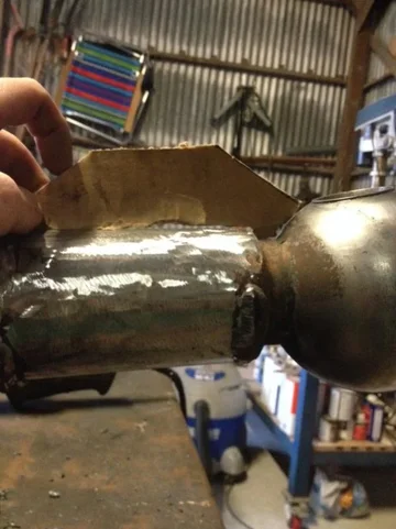

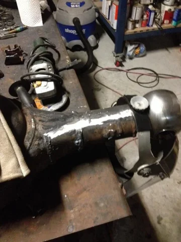

Are you going to do a C&T on the front axle? Got my front axle cleaned up the other day. Cut all the old perches and unneeded stuff off.
Yes I am. And I did too yesterday with the torch, now I'm having fun with the grinder.. Are you going the pipe cutter route or are you just going to use a grinder for the C&T?

Don't have a pipe cutter that big. Think that I will take my time and use a grinder and cut off wheel. Just gonna go slow and measure the depth of the cut frequently.

I was reading a SOA build thread the other day and he had a really good idea with the C&T. He used an angle grinder, but put some kind of paint on the blade so he could see the depth where he was at. Also he got a big hose clamp to secure on the tube so you make a nice even cut all the way around, kind of like a guide.

That is all fine and well, but as you grind, you will be wearing down the cut off wheel. You would have to keep making a mark for the depth of cut due to this. Like the idea of using a hose clamp to keep you in line all the way around the axle housing.

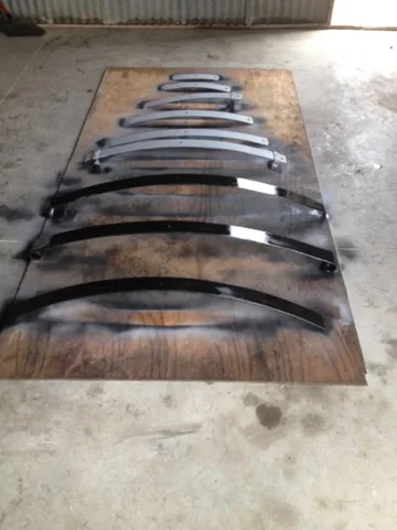

Got some work done today, cleaned my spring packs and put in the add a leafs and painted them!
Cleaned the axles, ya I know I got a little carried away with the grinder/ buffer but it's going to look good!

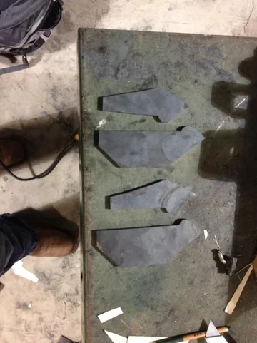

Going to make some knuckle gussets and shock hoops at school.

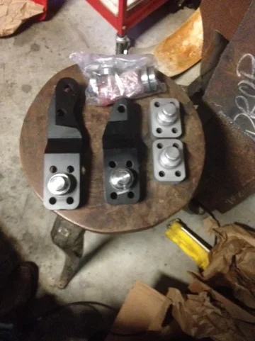

Received my marlin high steer kit! Thanks George! The plan is to hang the axles next weekend and do the cut and turn. Enjoy!

Made some knuckle gussets today.. scrap steel and about 2 hours on the band saw is all it took! Better than spending $50 bucks IMO!
