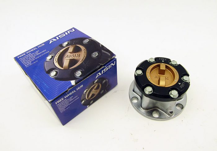

Aisin locking hubs are available from several sources for your 79. MAN A FRE has a set in stock manafrlv.com
Aisin Locking Hub for 1979-1990 Toyota Land Cruisers​
$139.99
Only 1 left in stock (can be backordered)
Part Type: Aisin Locking Hub
General Fitment: 1979-1990 Toyota Land cruisers (fits 40 series)
SKU: FHT-013
@Last Flight Out - the original hubs on your 1981 FJ40 would have been:
If you want something different, these are all a direct fit for you 1981
Red: AISIN Locking Hub - Fits Misc. 79-90 LC/4R/PU (Red) - https://cruiserteq.com/aisin-locking-hubs-fits-misc-79-90-lc-4r-pu-red/
Gold/Black: AISIN Locking Hub - Fits 1979-90 LC 6x/7x (G/B) - https://cruiserteq.com/aisin-locking-hubs-fits-1979-90-lc-6x-7x-g-b/
Gold/Silver: AISIN Locking Hub - Fits 1979-90 LC 6x/7x (Gold/Silver) - https://cruiserteq.com/aisin-locking-hubs-fits-1979-90-lc-6x-7x-gold-silver/
Grey: AISIN Locking Hub - Fits 1979/80 LC (and Later Models) (Grey) - https://cruiserteq.com/aisin-locking-hubs-fits-1979-80-lc-and-later-models-grey/
Orange :AISIN Locking Hub - Fits Misc. 79-90 LC/4R/PU (Orange) - https://cruiserteq.com/aisin-locking-hubs-fits-misc-79-90-lc-4r-pu-orange/
HD Black: AISIN (Heavy Duty) Locking Hub - Fits 79-95 Land Cruisers (short birf 80's) and 79-85 Pickups and 4Runners (HUBAISINHD) - https://cruiserteq.com/aisin-heavy-duty-locking-hub-fits-79-95-land-cruisers-short-birf-80s-and-79-85-pickups-and-4runners-hubaisinhd/
HD Red: AISIN (Heavy Duty) Locking Hub - Fits 1979 - 1995 Land Cruisers (short birf 80's) and 79-85 Pickup and 4Runner Applications (HUBAISINHDRED) - https://cruiserteq.com/aisin-heavy-duty-locking-hub-fits-1979-1995-land-cruisers-short-birf-80s-and-79-85-pickup-and-4runner-applications-hubaisinhdred/

I'm sure you could find Warns somewhere, but Aisin would have been fit on a '79 and they are much stronger.

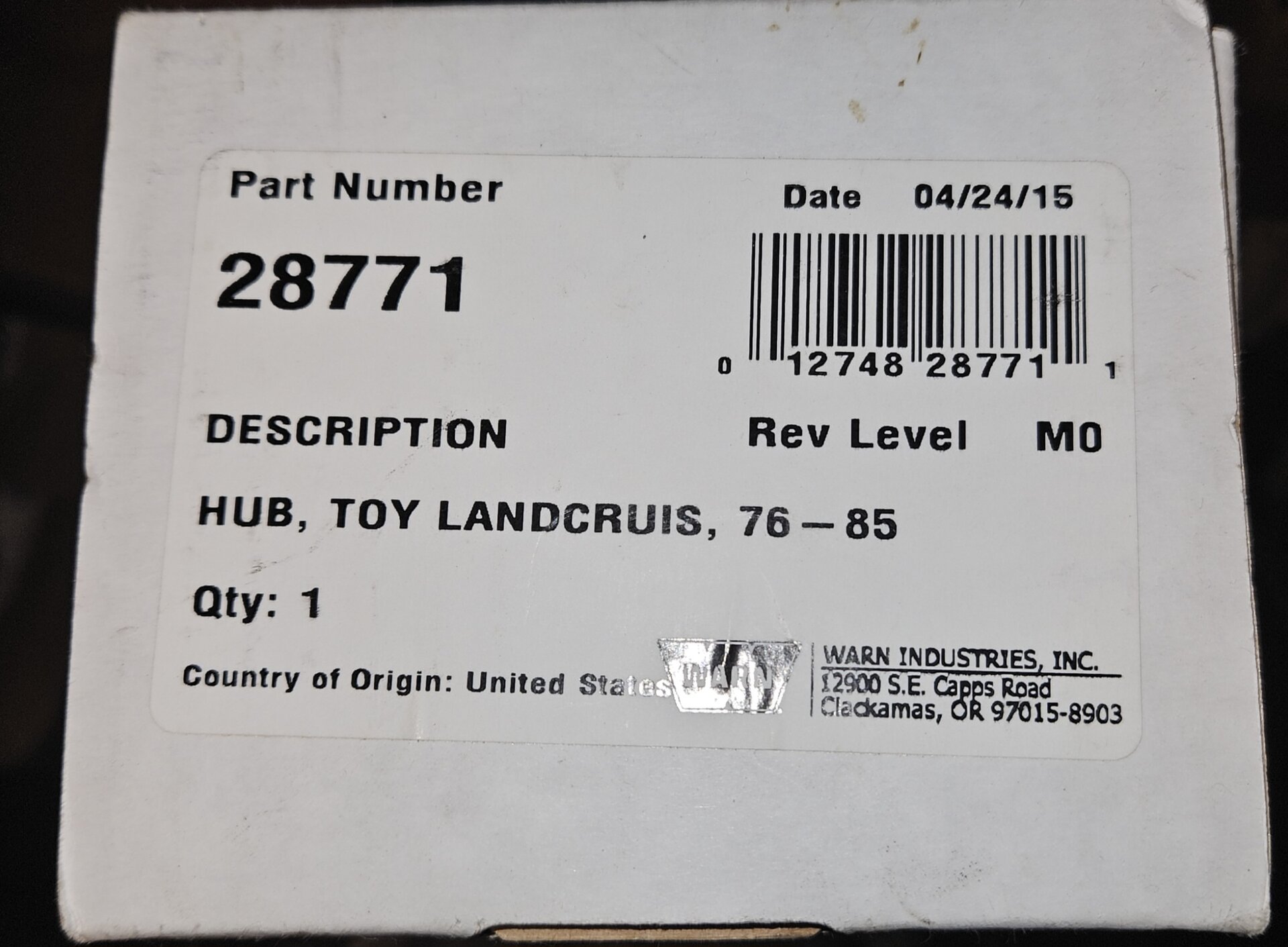

I have tried to look up as much as I could…but, once I get lost….I come to ask questions right here AND have never been steered in the wrong direction….but you advice is well received. I will pull these apart and check as best I can….there’s always return shipping 🤷🏼‍♂️
@bikersmurf thanks for the warn web site. I was reading several pages of the site yesterday and never found the page you sent me….
I can confirm these Warn Hubs from above fit on my 1/79 Disk Axle.
No idea if the Drum Axle would be different but Warn's website doesn't specify Disk or Drum.
Thanks @Shark56. confidence is high so I just placed an order… I hate returns but they are accepted if they don’t fit….funny thing they are twice the cost of the Aisin hubs but my my other Toyota I sold had Aisin hubs and they were a bit stiff for my old arthritic hands to spin. These Warn hubs always just twisted very easily.

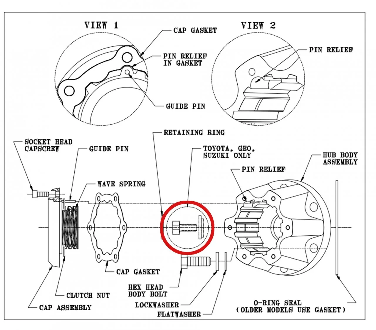

I find the 76-87 for the Land Cruiser interesting since the 76-78 Toyota used a longer Birfield. That at a minimum would require a spacer on the early 30 spline Birfield if that's possible. I also didn't realize the FJ62 required a different locking hub than the FJ60. Little research I see the same Birfield working from 1/79-3/92. This is on the 40 series and 60 series including the FJ62. FJ62 started 11/84 in most markets with a 3F carbureted engine. Didn't bother with 70 which probably used the same Birfield even longer.
I can't remember exactly, been 7 years or so since I was doing it, but I believe the longer Birf uses those shoulder washers you see in the picture of the Warn parts bag. That is what allowed the year range difference for the long Birf in 76-78.
