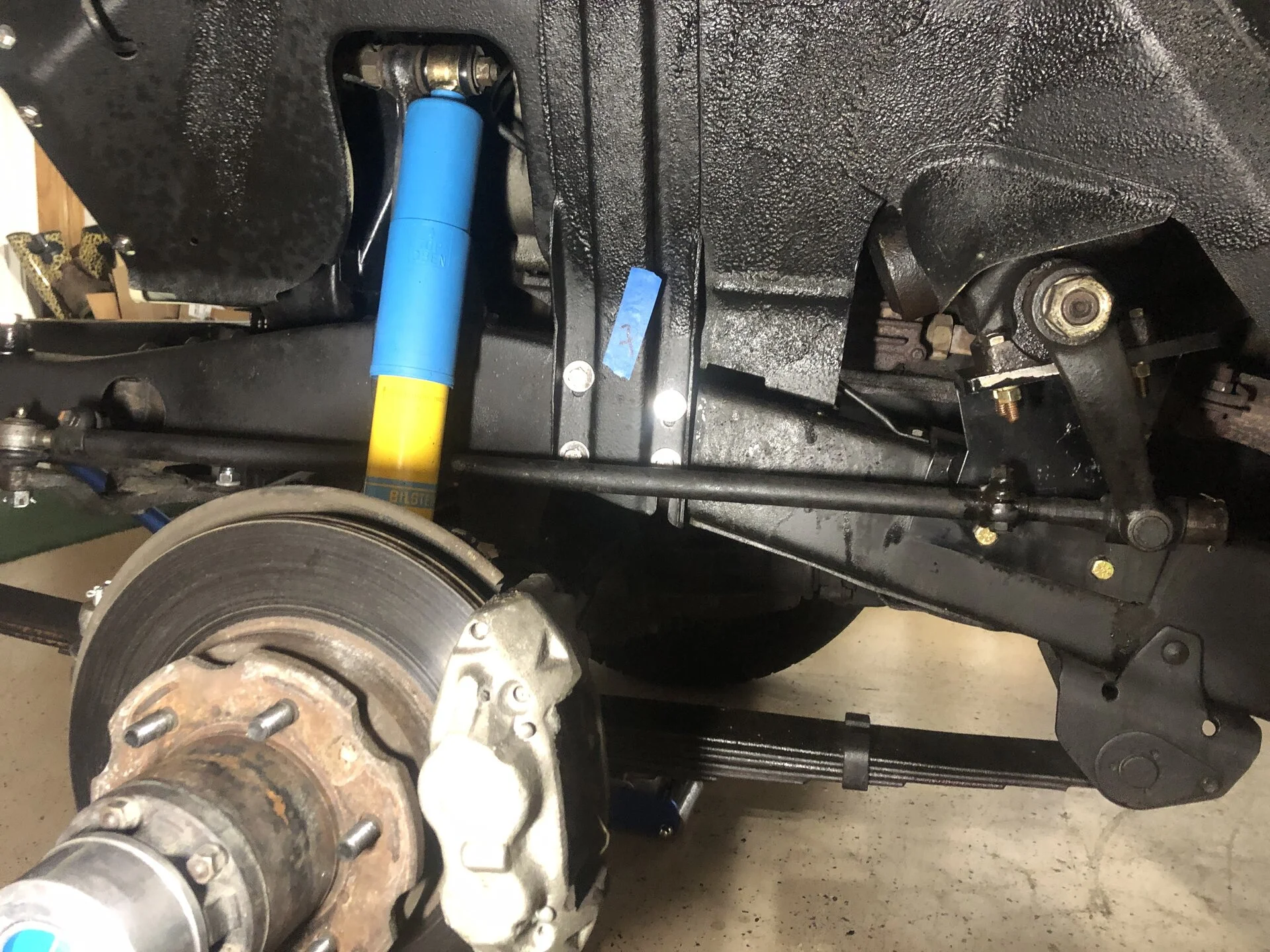

That doesn't look like a Toyota wheel hub. I've never seen a sleeve like cover that fits that close to the locking hub body except on a Dana 44 axle.
The white spoke white and chrome spoke bought have a collar the covers the hub except for the end. Semi floating and full floating had their own version of covers that were completely closed. These are for US 40 series and 60 series 8/80+.
^^^^^what living said, it's a black collar. Super winch lock outs are 2 piece similar to Warns. Dana 44's are internally splined the collar is part of the wheel hub itself, the rotor attached to it.
@Living in the Past I assume these are just covers as you stated above here is a couple shots when I did some maintenance last year. But I hope this is all stocks it up with just aftermarket hubs. Please let me know if you see anything odd.
Sweet looking 40! Lights aren't stock, but I bet you know that ;) those City racer head lights?
Got it. It just looked funny to me as almost all my 40 experience is pre-1978. And I had never seen that combo before.
TIL
