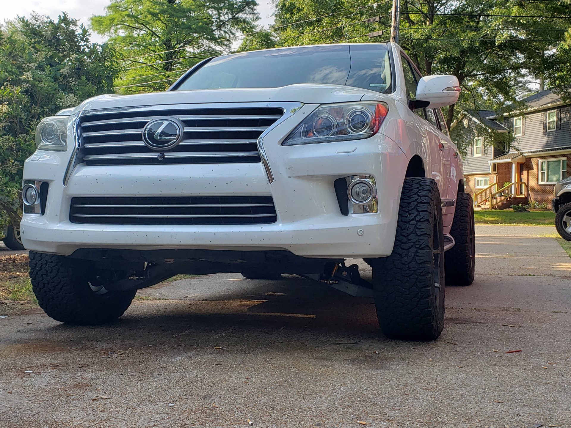

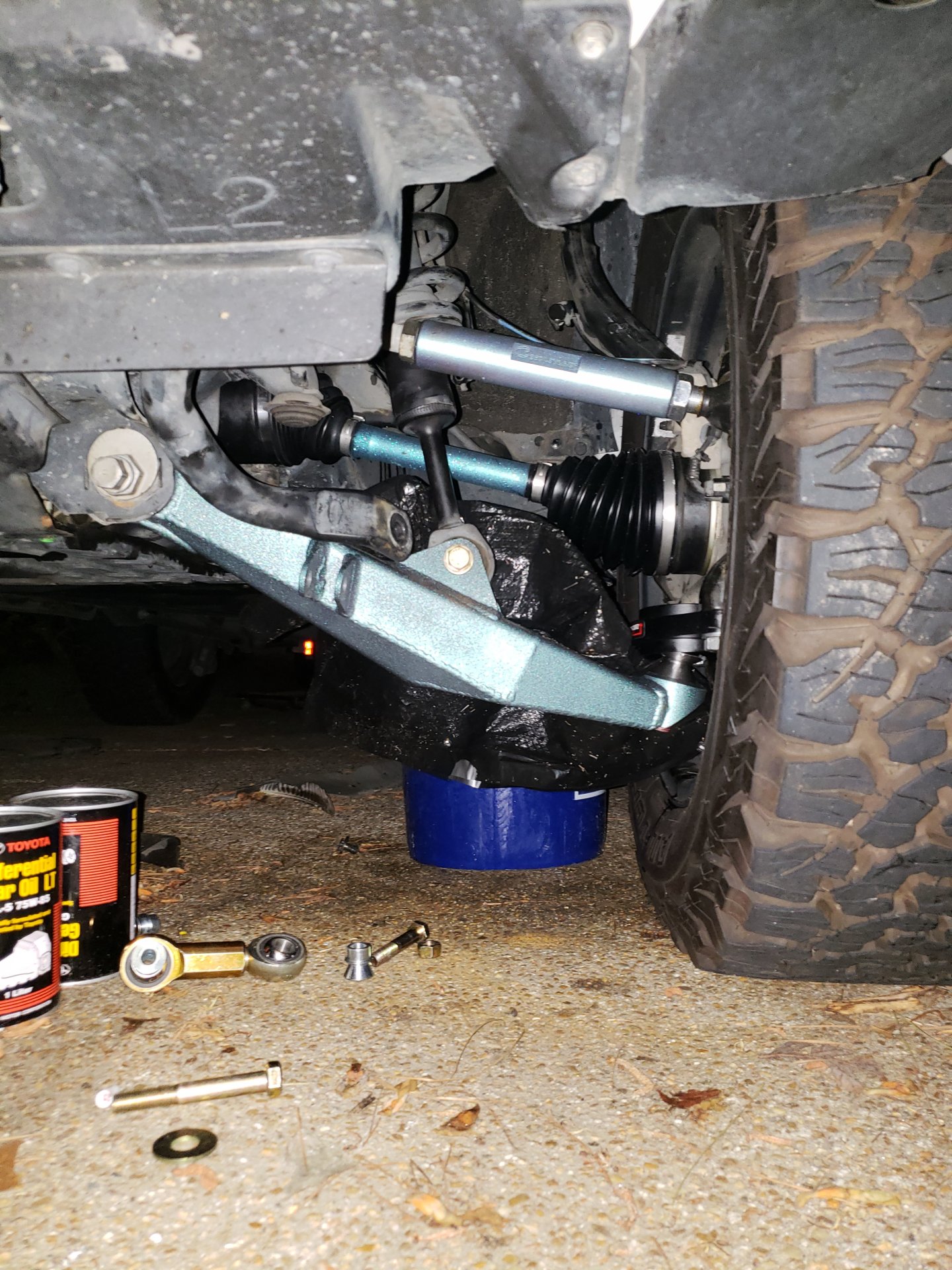

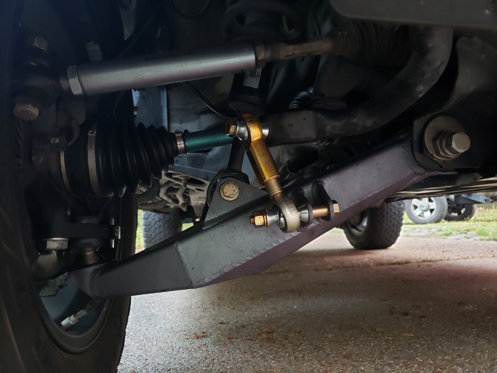

Been following mud for over 12 years now.... its my time to contribute... seeing all these guys doing junkyard tundra swaps made me know it was possible. So here it is!!!
Thread 'Long travel LX570' Long travel LX570 - https://forum.ih8mud.com/threads/long-travel-lx570.1253112/

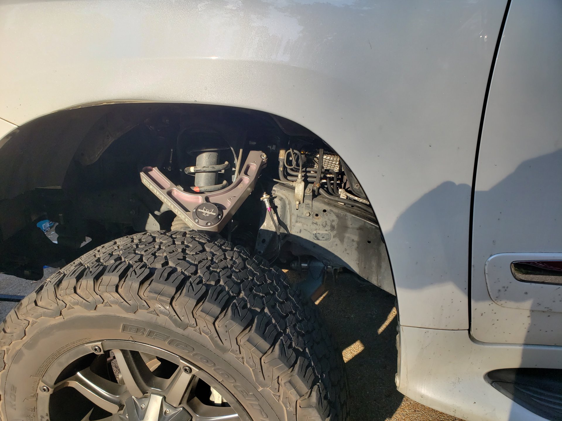

Nice, plans on how you will address tire rub at travel? Removing a bunch of fender?
Before the LT swap with minor trimming i was tucking 33.5s in low at full turn with zero rubbing. Now the arms have moved the tire forward 1+ in and out 4 in. So plenty of room at the body mount. But I was making contact at front bumper. Trimmed that temporarily till dissent off-road bumpers arrive next month. But now I make contact at top of wheel well when I run hard cause the tires stick out 4 in. I got rubber rash as seen in photo.... plan is to add strut spacer to move the shock down this move shocks range of motion to my ride height.... then add hydrolic bump stops....
Thanks. I’m planning on going more dedicated build with my white ‘13 LX as well in the next couple of years when I get my next truck (probably a cyber truck or Rivian?). I off road quite hard and often, will at least do a front number/Winch, for sure won’t go wider then the wheel wells, but May go up to 34 or 35’s.
