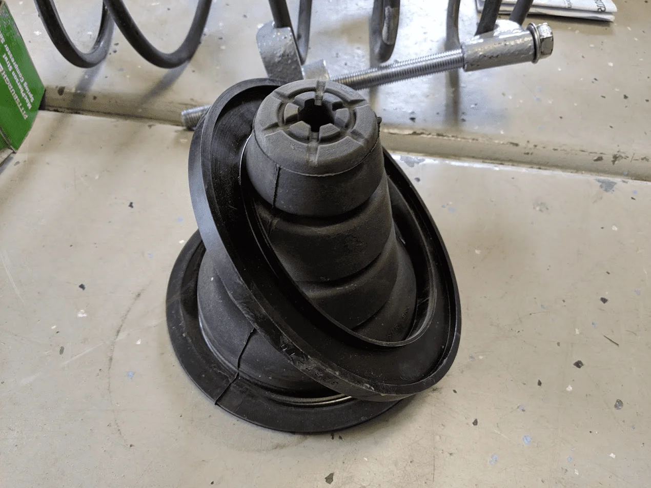

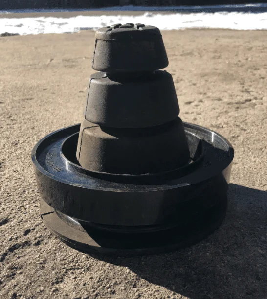

Do you happen to remember if the inner diameter on these was large enough to seat around the stock bump stop to sandwich it between the spring and bump stop vs. body amd bump stop? Thanks

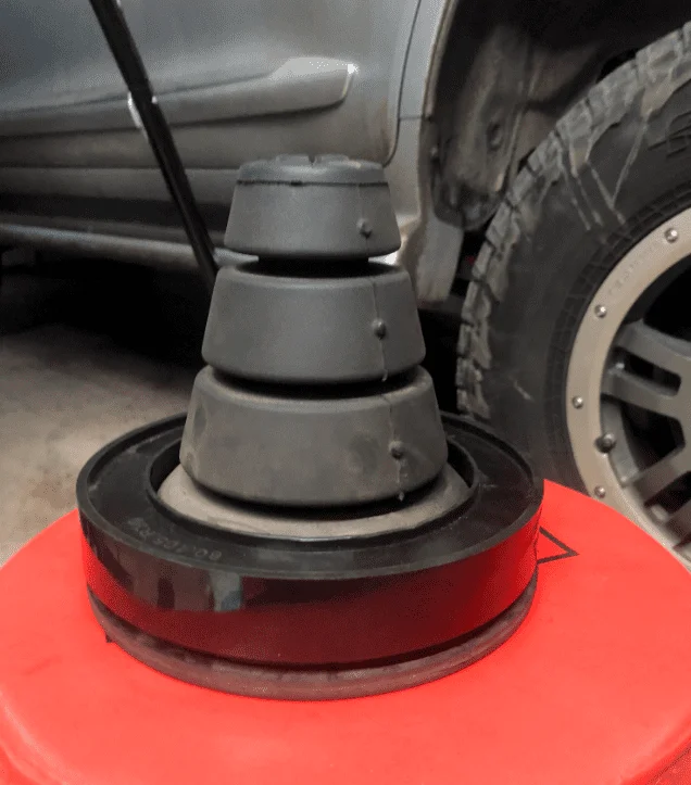

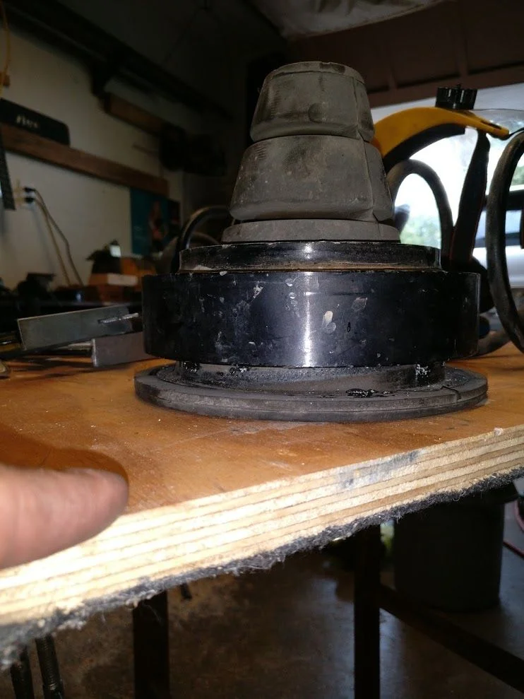

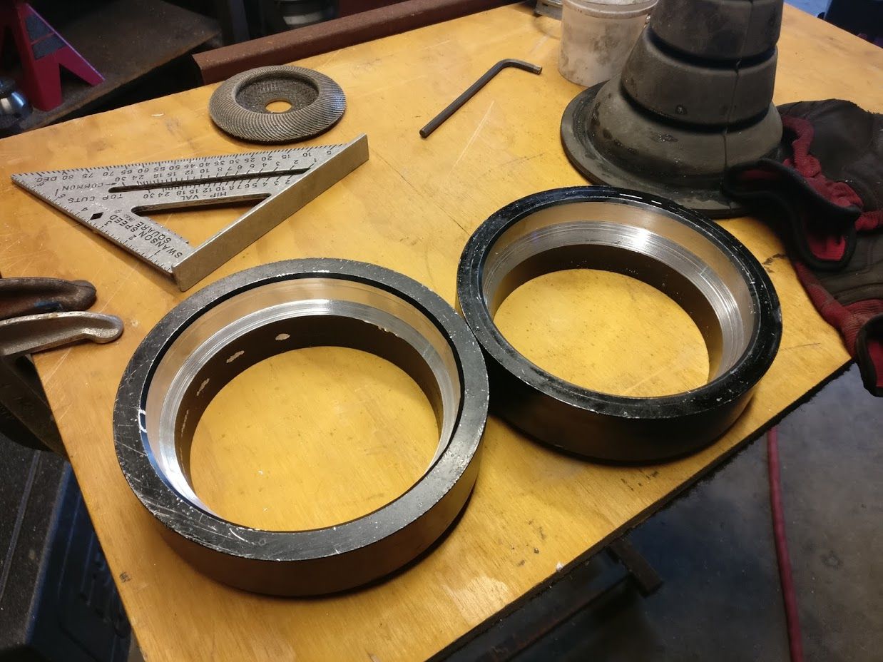

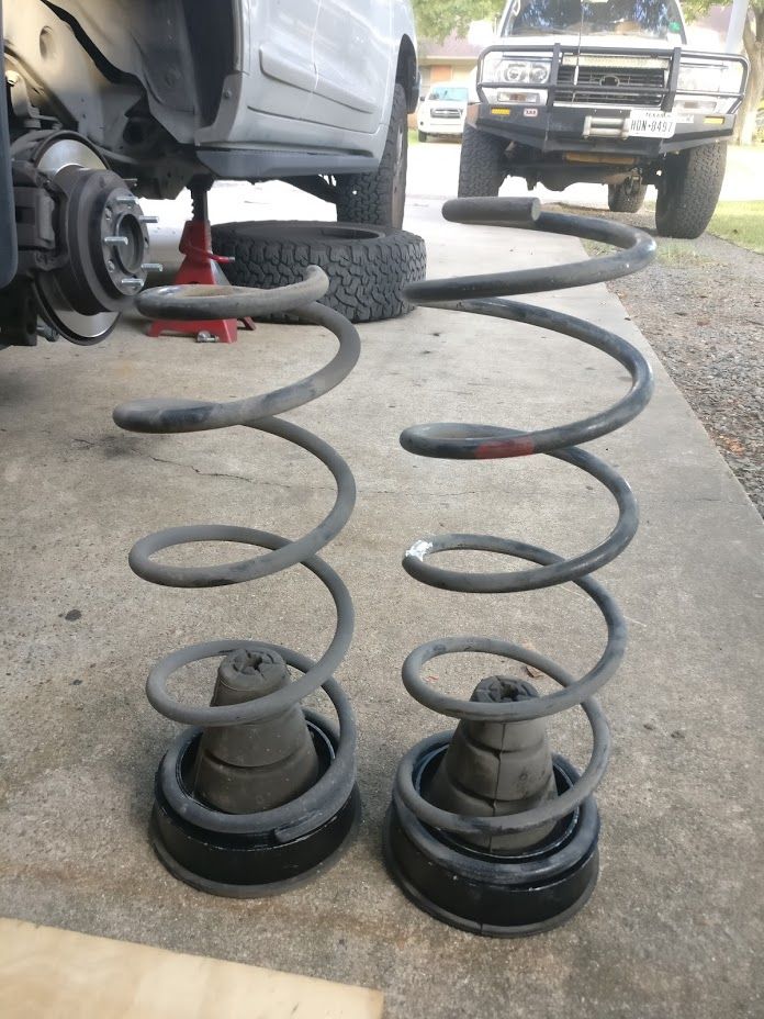

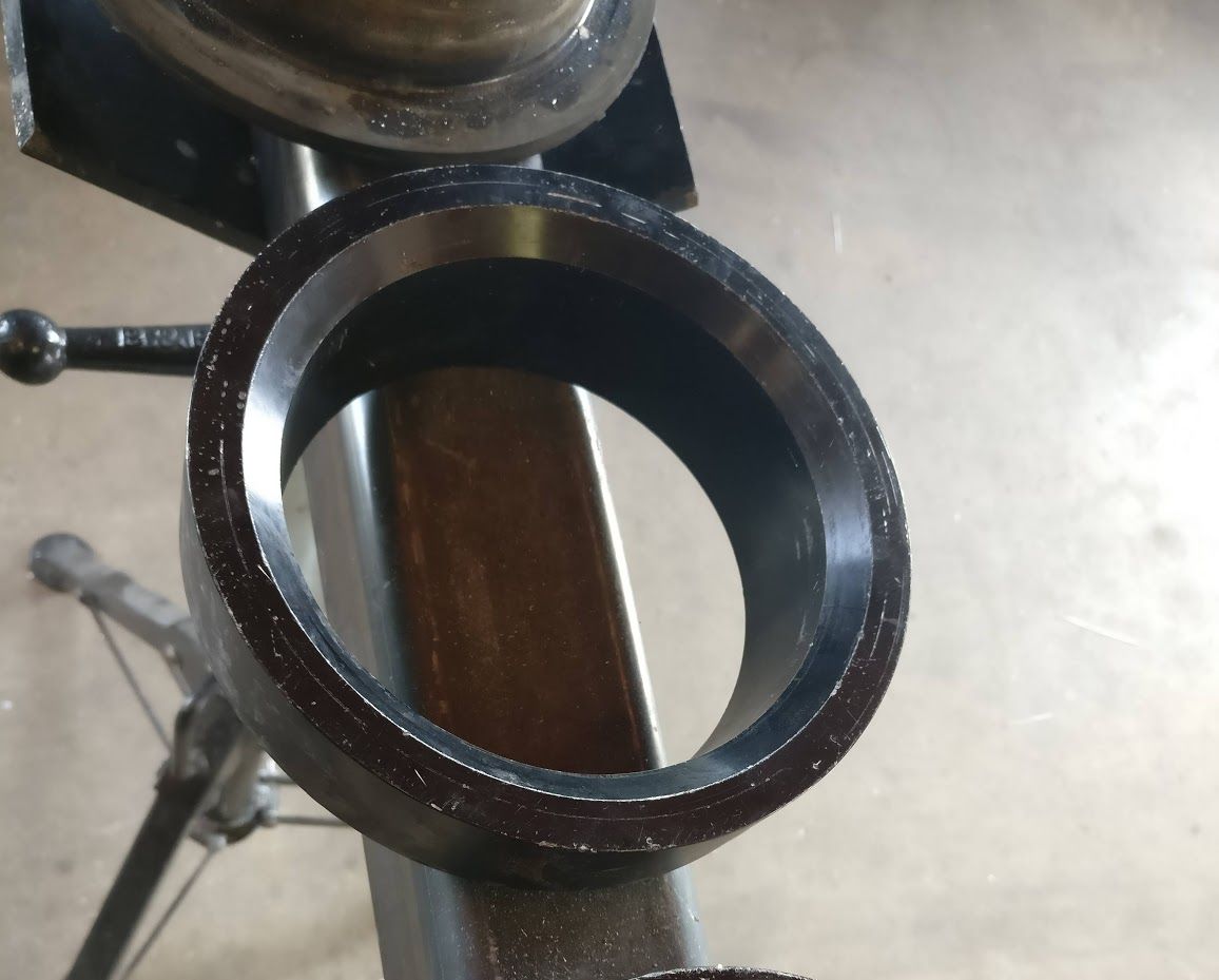

I had a pair of aluminum spacers laying around from my 80 that I tried to fit to the LX570, thinking it would be a quick and easy fit. Nope, like @Ali FJ80 stated, the ID of the spacers are too small to fit around the bump stop and would not sit flush. Ended up machining the ID to fit the taper of the bump stops.
What did that gain me? I don't know. I haven't put a bunch of weight in the rear to see if it made an ounce of difference or not. I did check with techstream afterwards and didn't see a great difference in pressures...

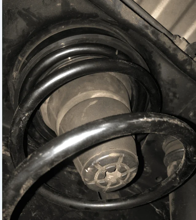

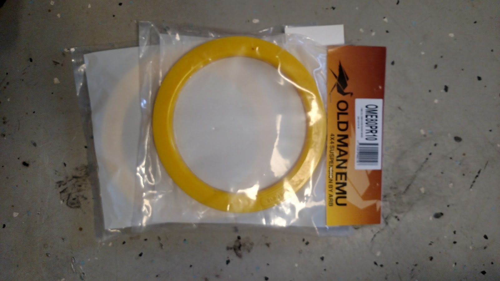

Is the method for this install to just compress the spring and slide the spacer in?I added a 10mm spacer to each spring at the rear axle. Intent is to add a bit more support to the AHC system, as I tow a heavy 27' Airstream travel trailer. This exact same mod could be done to an LC too, but will result in lifting ~1/2".
While the LX570 never asked for it, this is a well established mod carried over from the 100-series LX470. I had added spacers to my LX470, to bring AHC neutral calibration pressure back to stock and to support more load as I towed with that car also.
I'm not being as thorough here as I could hookup techstream to see where the pressures are. Note there is some mixed info in that the LX570 doesn't report pressures like the LX470 did.
The LX570 AHC seems far more robust. Where the LX470, once near payload capacity, will no longer lift to high position without additional mods like this, I've not found that upper limit on the LX570 yet.
Specifics: Old Man Emu 80/100/200 10mm coil spacers

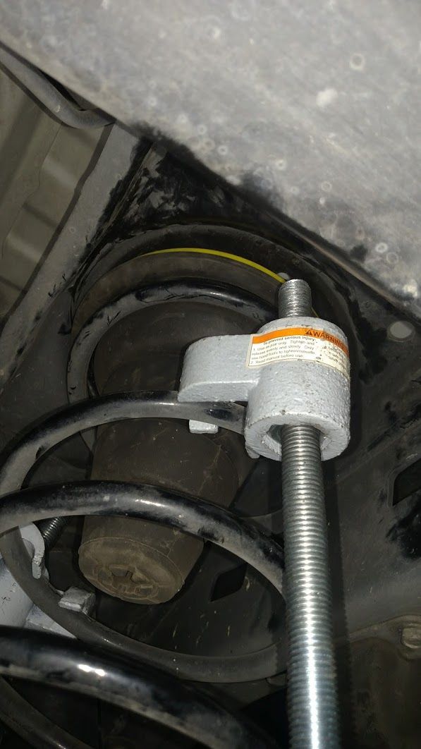

I installed the spacer between the chassis and coil seat. Traditionally, I'd install this between the seat and spring. But this was easier as the seat fit tightly in the spring. The chassis has a depression that it positively locate the spacer anyhow. It's a quick 30minute mod. Need spring compressors.

1. Compress the rear spring
2. Jack the body up
3. Insert the spacer
4. Lower the body back down
5. Uncompress the rear spring?

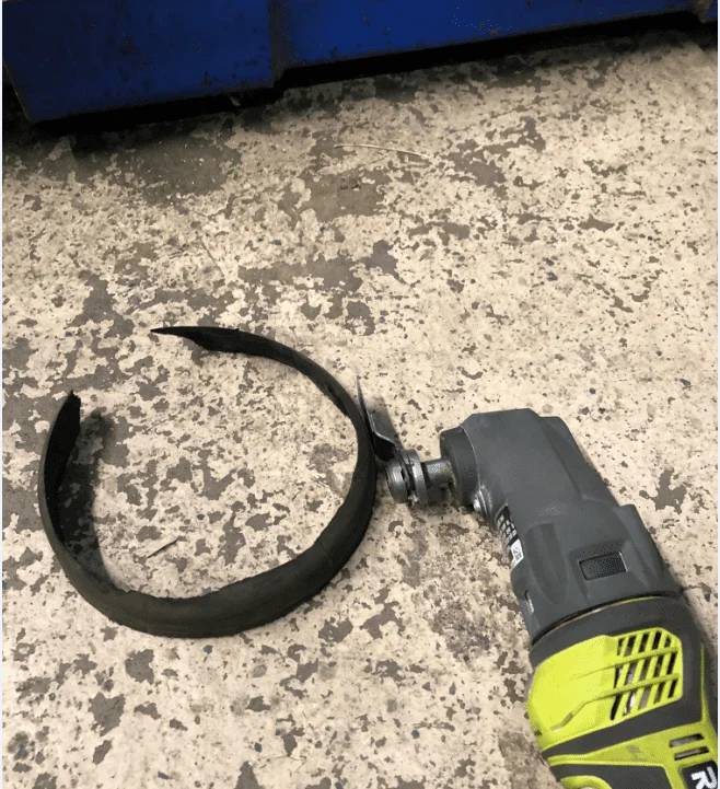

Thanks for the reply. I’ve measured the internal diameter again and agree it will require trimming of the bump stop.My general strategy is to add as much static spacer plus maybe 10mm more, to compensate for any sensor lift in the rear. So if you sensor lifted 30mm, than ~40mm should work great. I can't say if those spacers will work specifically, but should. It's possible they may need some clearance to fit around the jounce stop base. I used a router to do that on mine.
