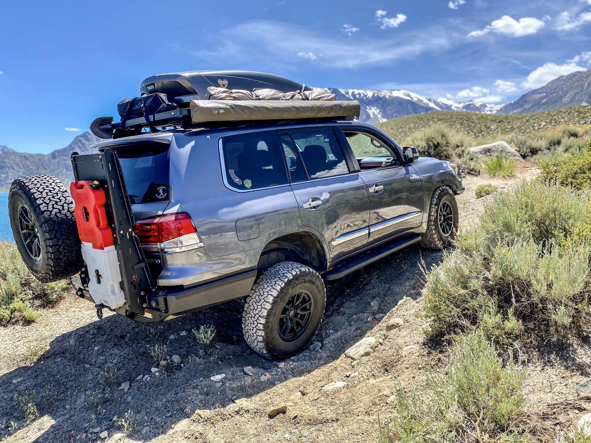

I have a 2013 LX with front and rear bumpers, swing outs, winch, roof rack, drawer system with fridge, sliders, etc, and I can confidently say that you do not need to think about spring spacers at this point. I have taken my truck on some pretty intense trails while fully loaded and I just completed a cross country trip with the family, dog, and an insane amount of stuff. AHC has never blinked at any of it. It still raises and lowers as normal and rides like a Lexus on the highway.
And since teckis300 posted a pic -

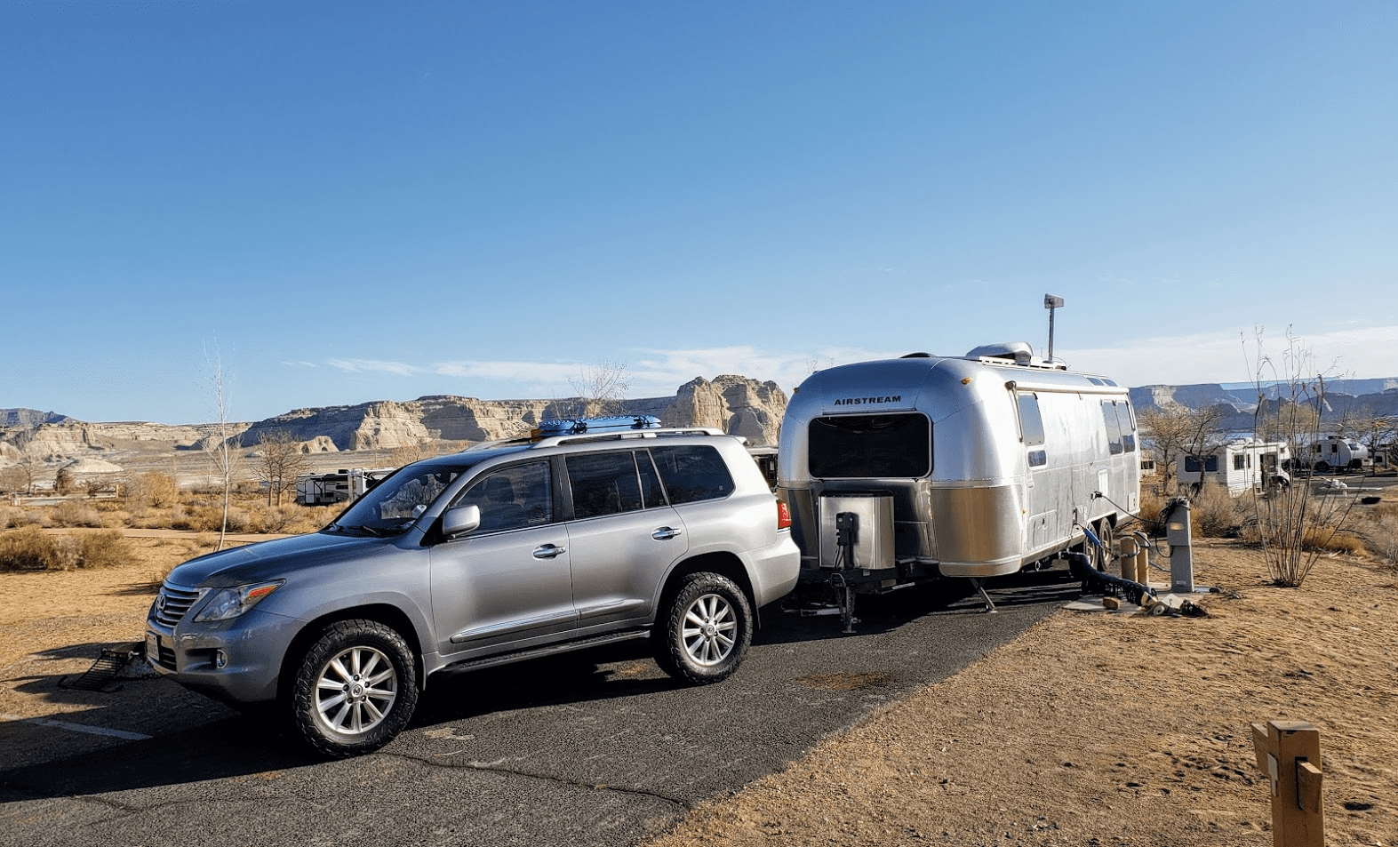

Might as well add a pic since I'm on a road trip now
I saw your pic from the lx thread and wondered if you had left the trailer at home. Looks like a great base camp.
Been fortunate to have such a base camp. Can't say I don't love it as it's a relaxing space to unwind, being a familiar and comfortable home away from home. A nice way to blend the two hobbies, and a solid partner to the LX. I'm still amazed that the LX can go from an incredibly competent tow vehicle for a larger travel trailer, to a flexy slinky off-road beast. I have a friend that has sought and purchased the same combined LX570 and AS 27FB rig last year, and I can't wait until we both roll out together after these covid times, perhaps later this year.
Sorry if this picture is off topic
Totally on topic because to have a base camp like that you probably want spring spacers 😂
