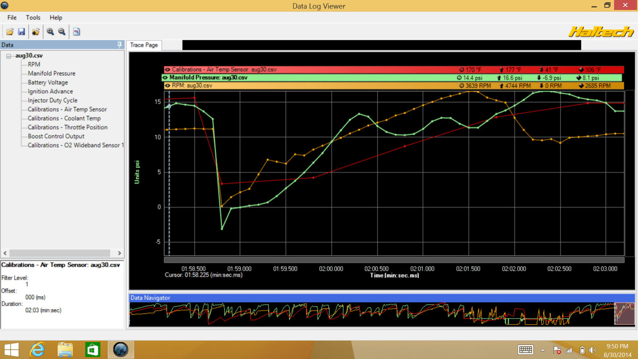

Wanted a place to track, pre and post water/meth injection.
If anyone is curious you can see on the pre, that I started out around 1500rpm and floored it. Truck pulls to around 4800rpm, boost fluctuating a little as the computer tries to keep it at my programmed limits. Boost peaks at 16.6psi. IAT's hit 170 degrees F. Like I said in another discussion, 170 is my breaking point. I am installing the larger IC as well as the water/meth. I would like to see 130 but we will see. This is not the end of the world and very rarely do I go foot to the floor anymore, but I do want to build the truck for all driving conditions.
Haha looks like the fluctuating boost wasn't the computer trying to adjust boost, it was me being too chicken s*** to hold my foot to the floor. lol. The light blue is the throttle position sensor. Shows I clearly let off while the truck was building more boost. Funny considering I have driven a lot of fast cars. Haha.
