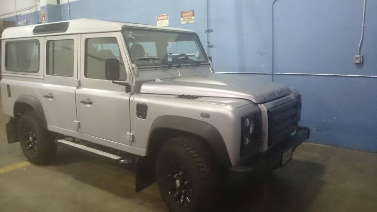

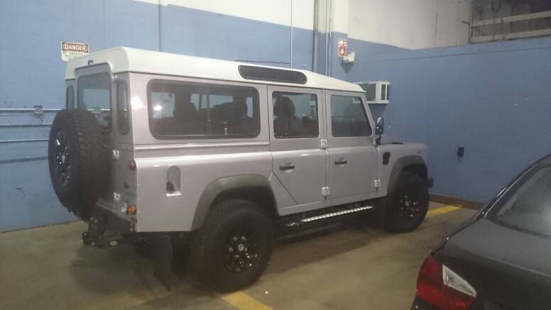

Haha yeah I have no idea how reliable these are. It was a manual, cloth interior, fold up 3rd row just like the 80, looked nice and this one has like 140 miles on it, driven straight up from Mexico.
