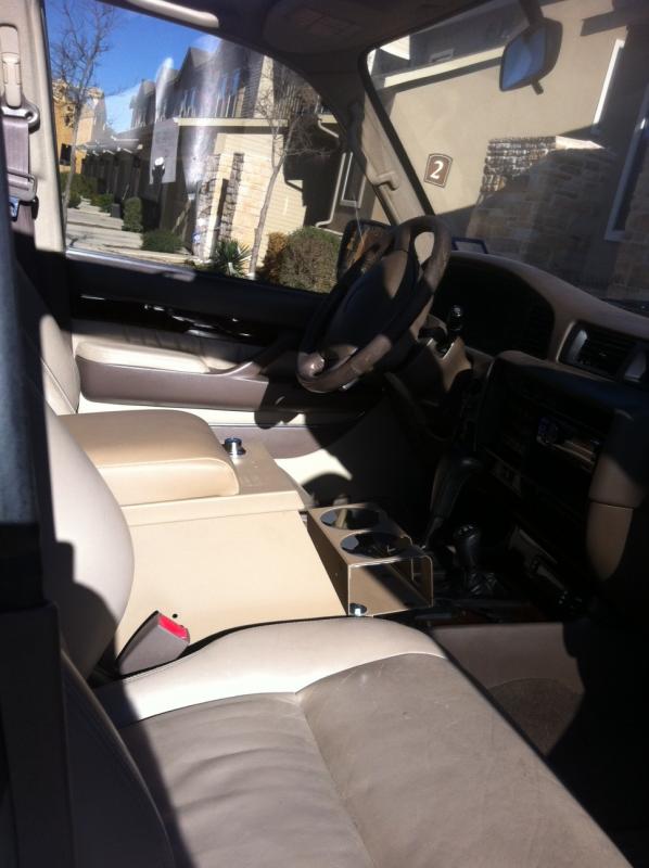

Right now I am doing the tuffy console and it isn't an exact match but I think it will work out ok. It is a tight fit and there really isn't much margin for error to get it to fit right and be able to fold the backseats, use the cup holders, etc.
