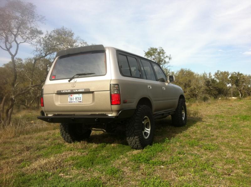

Very impressed with the quietness and comfort of this tire
Wow outstanding job thru and thru my friend. My wife has the lx and wants to move into a hundy so i might redo her whole rig. I have 350k on mine and she has half that. The spray liner on the side looks just totally kickass and thats coming from a 44 year old man. Your really puting some quality work into our 80 my friend. Stay frosty
Yeah I really like the size of these 35's but I only have a 2.5" lift. If I had anything bigger I would definitely want 37's. I think these are a really great tire for 80's. They fill a the gap between an A/T and a M/T. In a quiet truck I notice just the smallest increase of noise over the Open Country A/T's but with the stereo on or even carrying on a conversation the difference isn't noticeable. Since this is more of a back country truck than a rock garden truck these will be perfect for my needs.
Thanks Crow, that is nice to hear!
It is the funniest thing when people realized it is line-x on the side of the truck, everyone asks to touch it. I even had a girl at the drive through ask if she could and then she leaned out and rubbed the truck. ha.
Both the tire shop and the Line-x dealer questioned me when I called them to get quotes and I told them I had a Lexus, even though it is the exact same truck as a Land Cruiser. I find that to be the funniest thing. I was at the Line-x shop when the guy was suiting up and he had to call his friend at their other shop to tell him that he was getting ready to spray line-x all over the side of a Lexus.
All in all though I am very happy with the truck and how everything has turned out.

Bumper is here!
Looks good, only spot I am not thrilled with is that I ordered a bumper without swingouts and I was expecting a clean bumper, but it looks like a regular dual swing out shell, that has some cheesy plugs put in it that don't even fill the holes.... I guess it gives me the option down the road to possible grind them out and weld in spindles and have the bumper re-powder coated. Options are good, just not what I expected. :)

Paint is dry, bumper is on. I need to get 2 more bolts, of the 6 used on the hitch 4 of them were long shouldered bolts that had stacked spacers under them.
Thanks Luke!
truck looks great! Great bumper choices
Outstanding! Looks great with the sliders too. Nice job again Ryan!!

Those 35s look great. Im liking the mild lift/35s/no flares look on these trucks.
I think you are definitely right 50,000cst is way to heavy to use straight. I only added 4ml of 50,000 cst to the OEM fluid which everyone is saying is about 30ml of 3,000cst. So the mix should put the total of 34ml at around 8,500cst stiffer than OEM blue clutch but still considerably under what a lot of people are using.
Thanks I really like how the truck looks and like everyone says it is amazing how the 80 just swallows up tires. I had the spare standing up in my garage when my friend came to help do the 4x4labs bumper and he laughed at me, asking if I got the wrong tire. I was like what do you mean?? He said there is no way that is the same size as what is one my truck, I had to roll it over to the 80 to prove it. Ha
