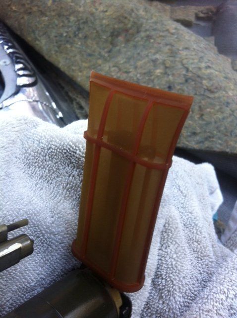

Fuel Sock PM
Nothing too exciting here just wanted to do the Fuel Sock PM since I have seen some pretty nasty ones in the past and I already had the interior out.
Cracking the Banjo bolt cost me a little fuel, but it helped clean the cover up so I won't complain. ha.

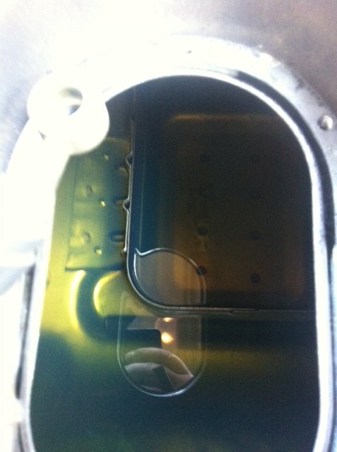

Inside the tank
It looks like maybe someone already beat me to it?? The sock looked to be in great condition.
Inside of the tank was crystal clear.
I went ahead and changed the sock, rubber clip on the bottom and the gasket on the lid.

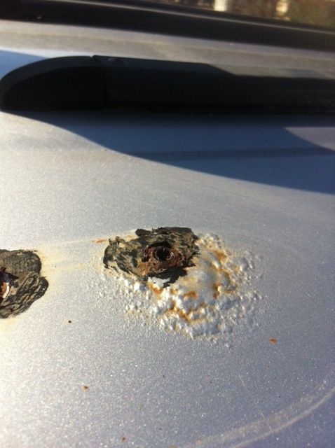

Roof Rack
Anyone want a roof rack?? Free.
I wouldn't recommend it. I didn't expect much of anything under there since this is a Texas truck but I found enough to make me recommend to anyone that they pull their stock rack. Couple of the inserts just spun so the screws had to be drilled out. I really only have 1 bad spot of rust. I will sand it down and hit it with extenze rust neutralizer before I have the line-x sprayed.

Definitely check under that rack! The rest of my LX is spotless, but under those rack feet you can see the mess they left. If I didn't pull it off and waited until it started to show signs it would have been too late.
