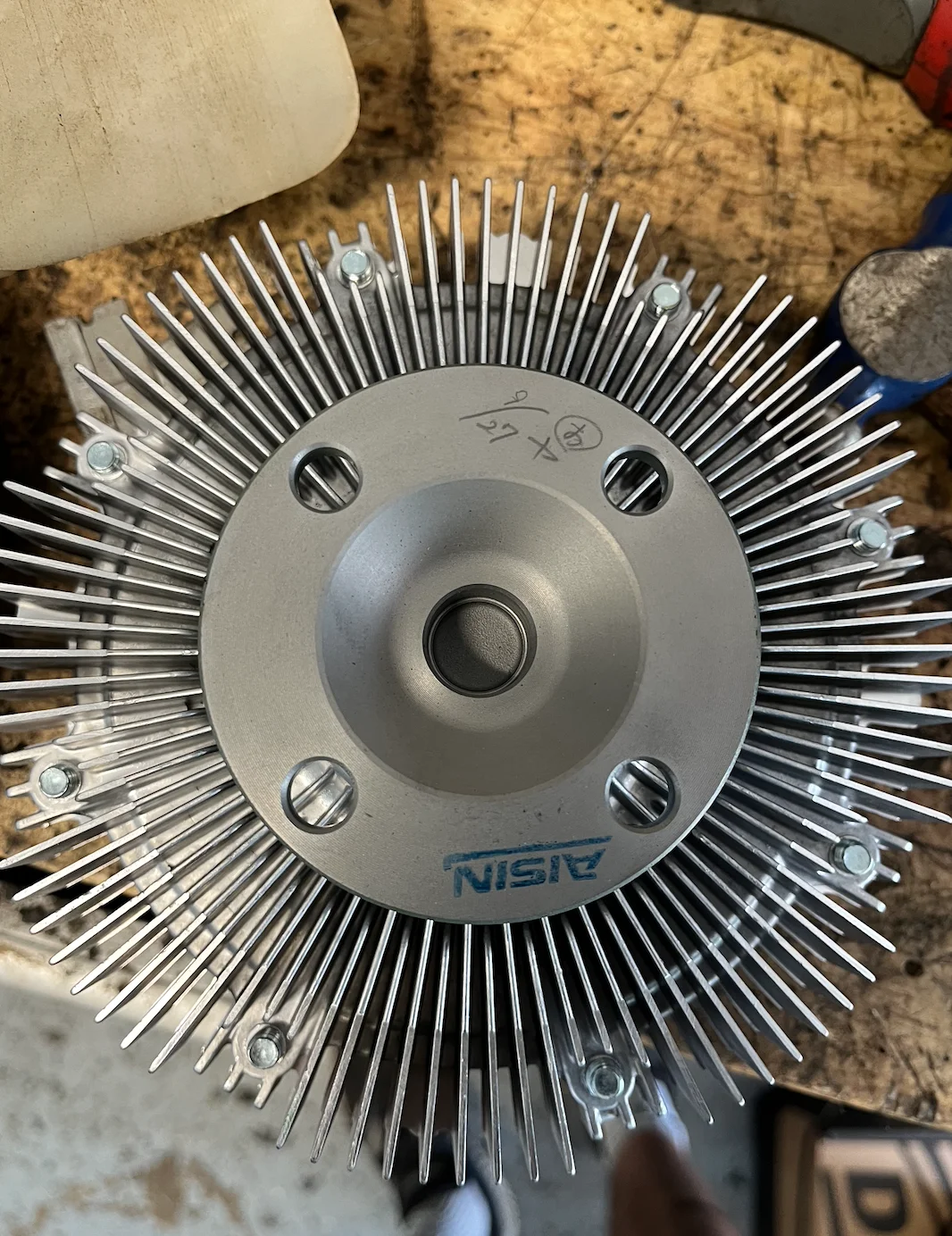

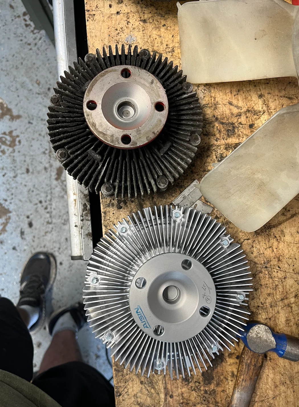

Cooling related items. The fan clutch was weak, so upgraded to an aisin aqua clutch. New unit has some hand written notations. This was the first time I have seen this on any aisin product.
  • Aisin Fan Clutch: FCT-049
  • 4x Fan clutch nuts: 90179-08123

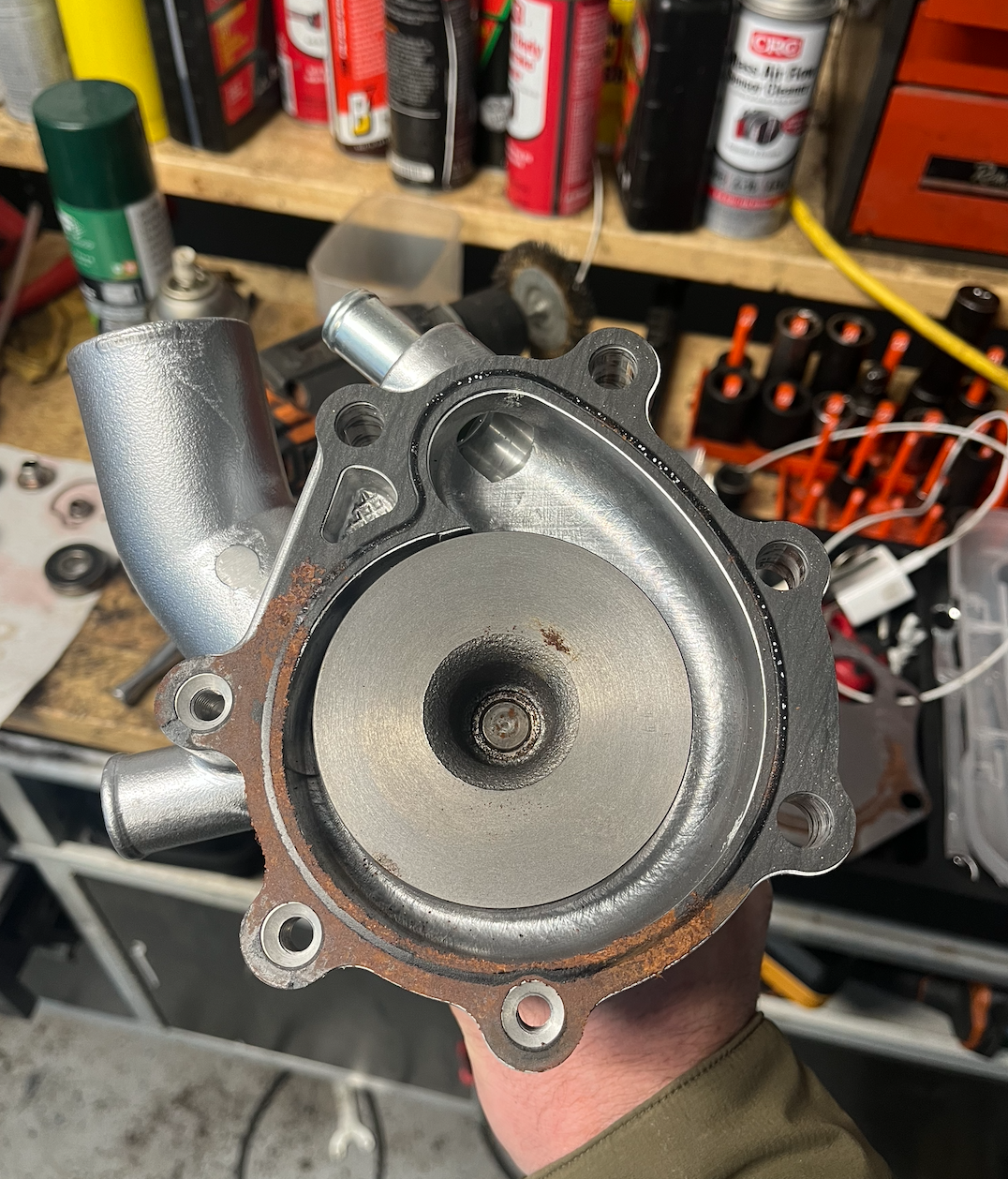

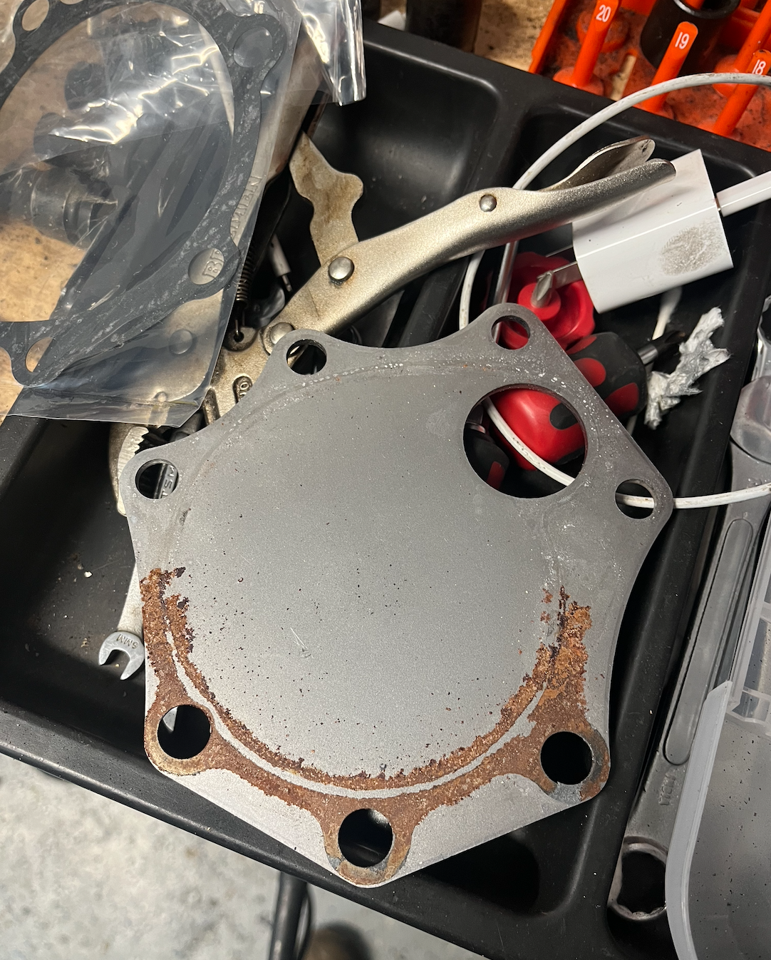

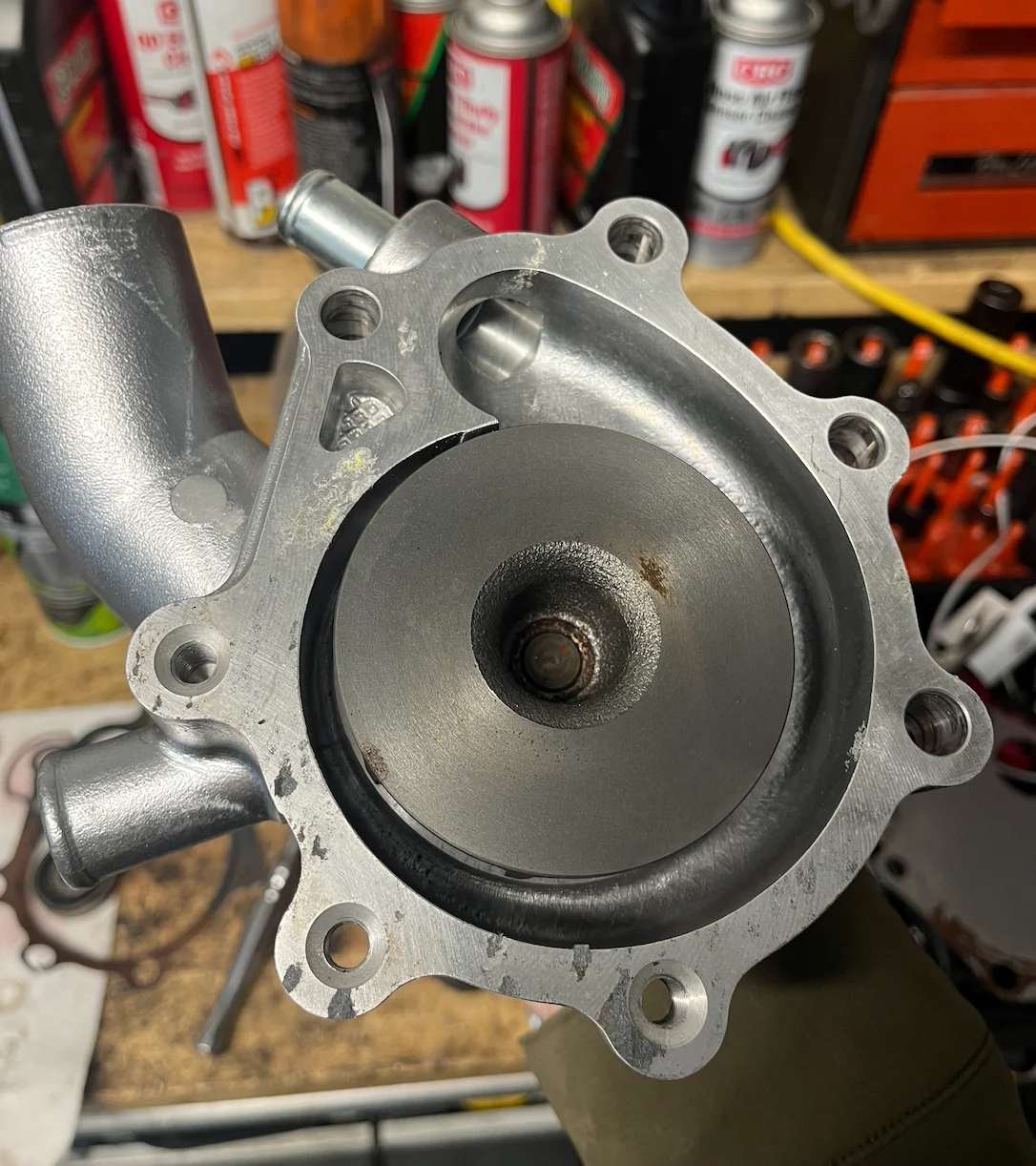

Also have a new Aisin water pump going in. I decided to open it up for visual inspection, and corrosion was found. Cleaned it up, and resealed it using the factory provided gasket.
  • Water pump: AISIN WPT-028
  • Water pump bolts: 4x 90119-A0139
Old v new fan clutch:
Water pump corrosion on aisin unit:
Where did you buy/find the pre-rusty water pump? It was obviously not stored well over the years.
I know that Land Cruisers 'want to rust' - but sheesh - this part is getting a head start on the rusting process ;-)
I know that Land Cruisers 'want to rust' - but sheesh - this part is getting a head start on the rusting process ;)
Rock auto Denso.

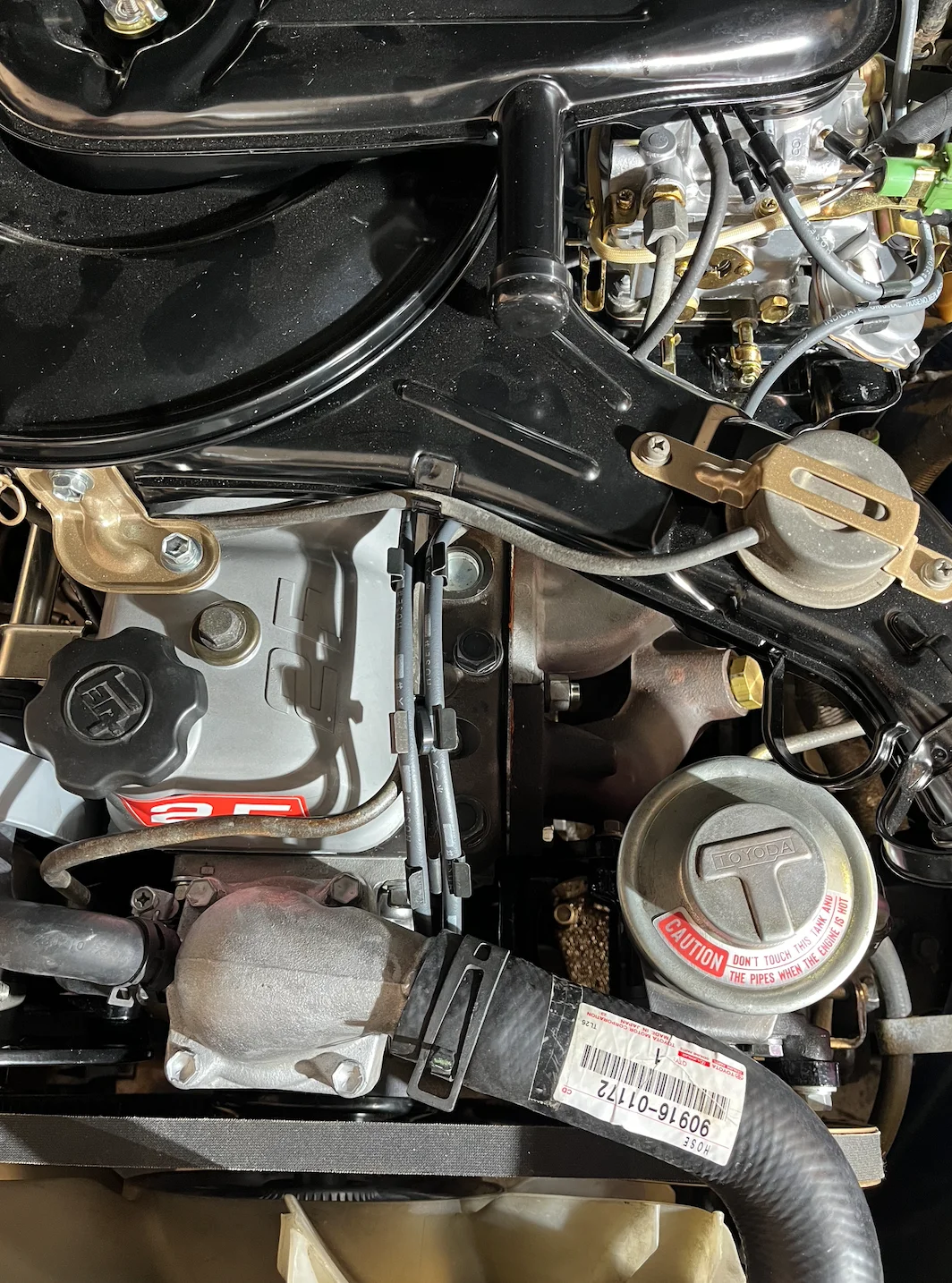

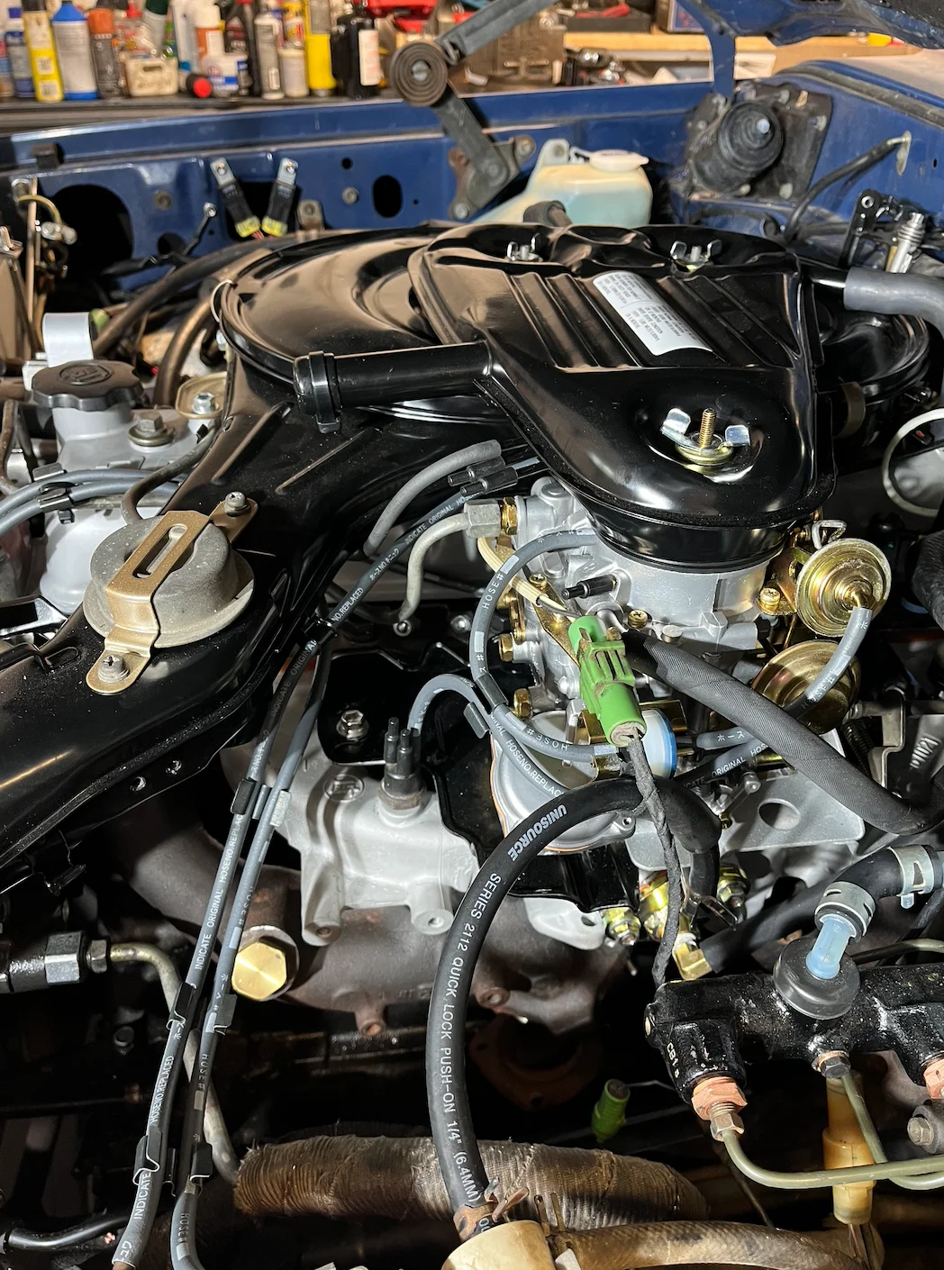

Lou is progressing well. She is ready to fire up after a major engine bay refresh. Next step is get her to the exhaust shop for a full stainless system. Here are some photos of the engine bay:

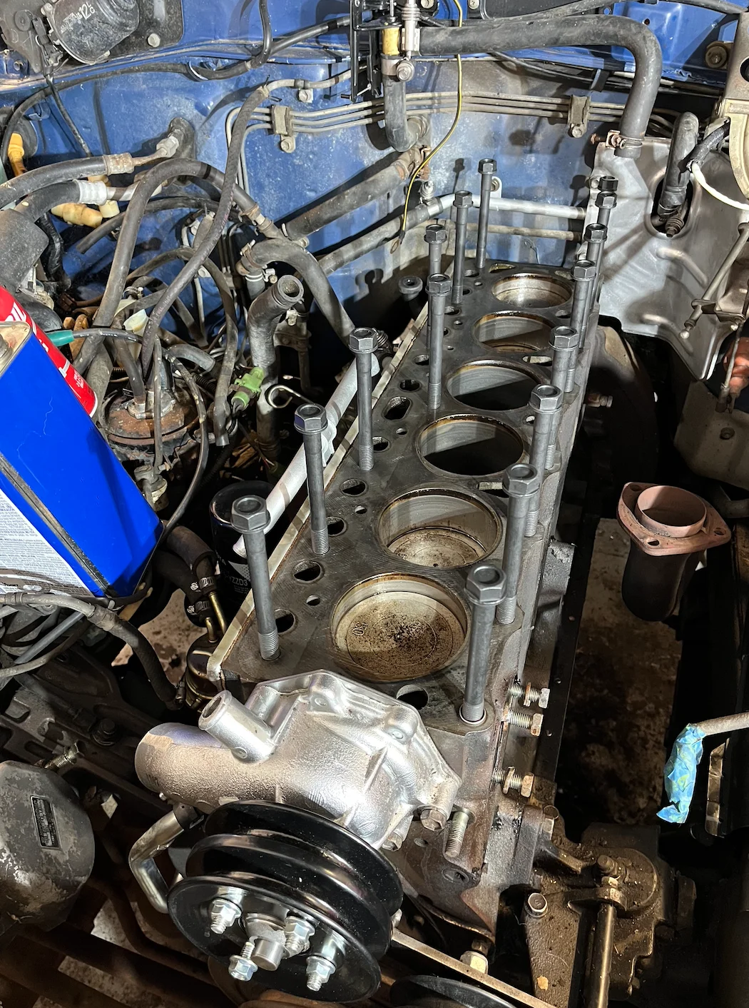

Assembly of the engine took way longer than expected due to the cracked head situation. Took 2 months to track down the head, and 4 more weeks at the machine shop.

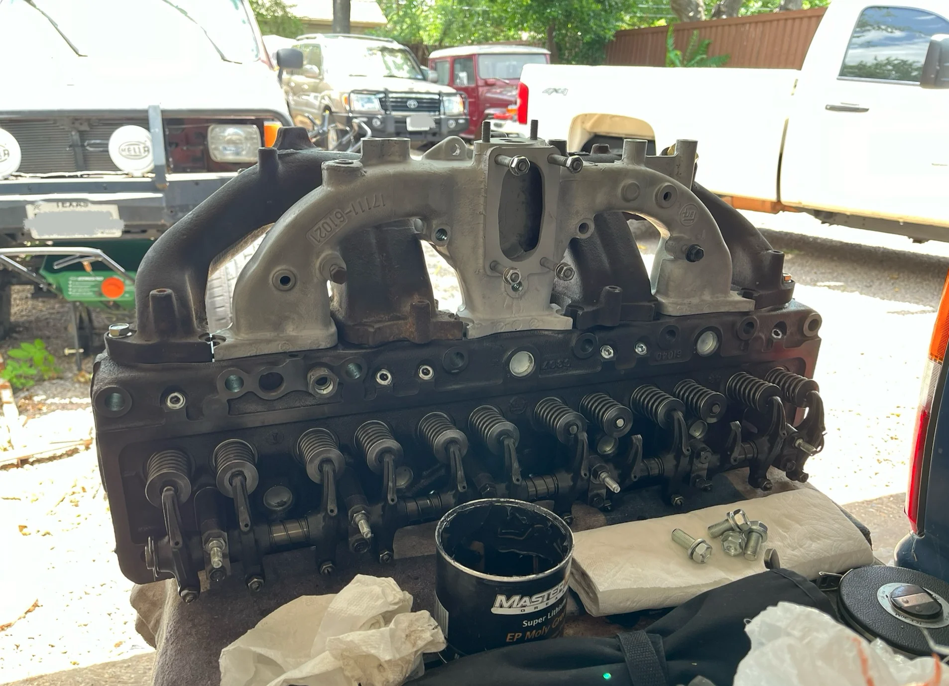

Even though the head I bought was "rebuilt", it was missing some details. Exhaust threads were grabby, and one completely stripped. Thread-sert to the rescue. Exhaust valves also needed to be redone.
Then came the mock up and fitment of the 3FE exhaust manifold. This required trimming, shimming, and grinding. I used @Godwin thread as a guide.
New Head bolts used. Threads were chased and cleaned... Rinse and repeat. So much junk came out of the threads.
Mock up of 3FE exhaust manifold:
New OEM head bolts mocked up:
Everything mounted:

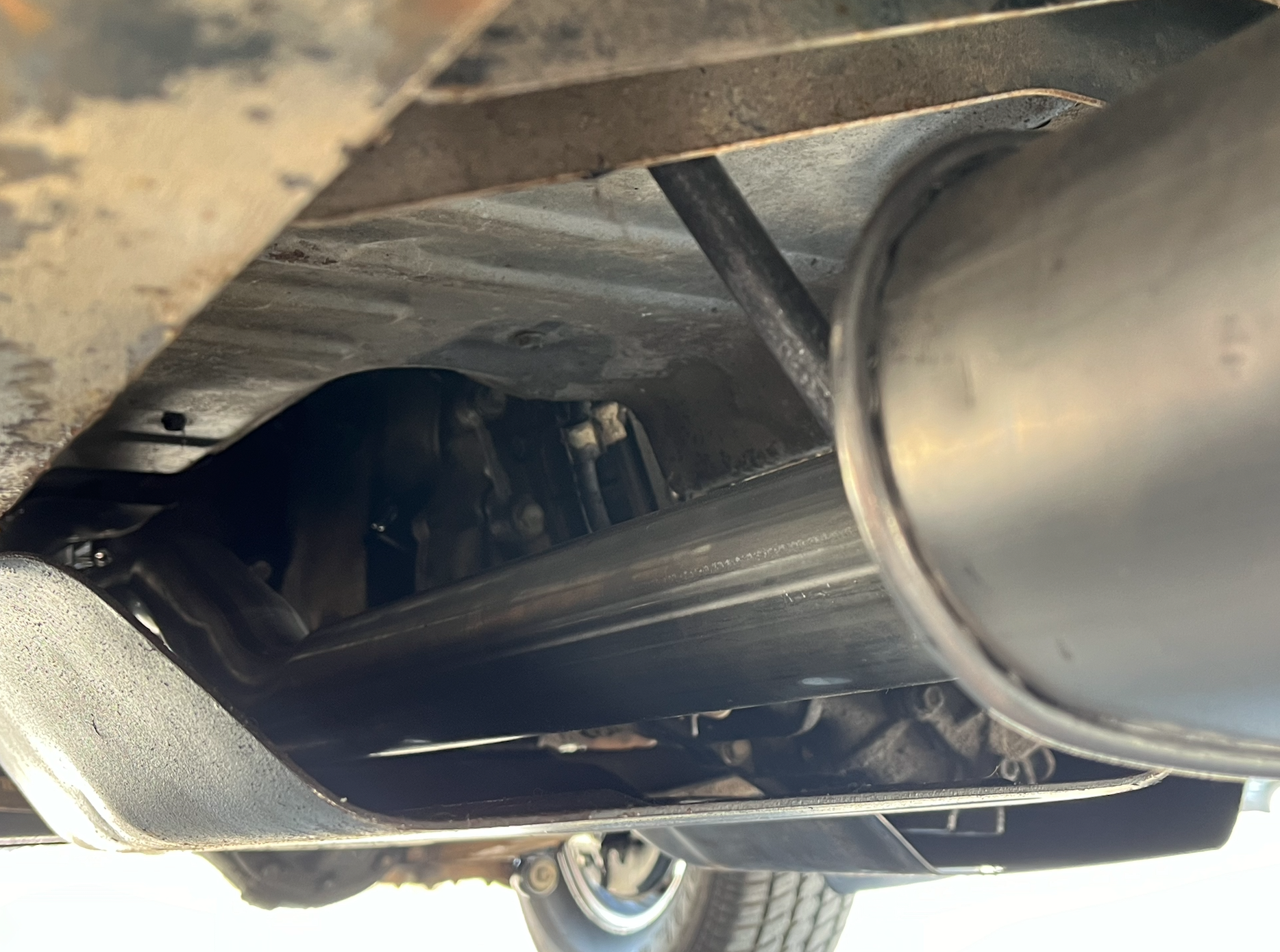

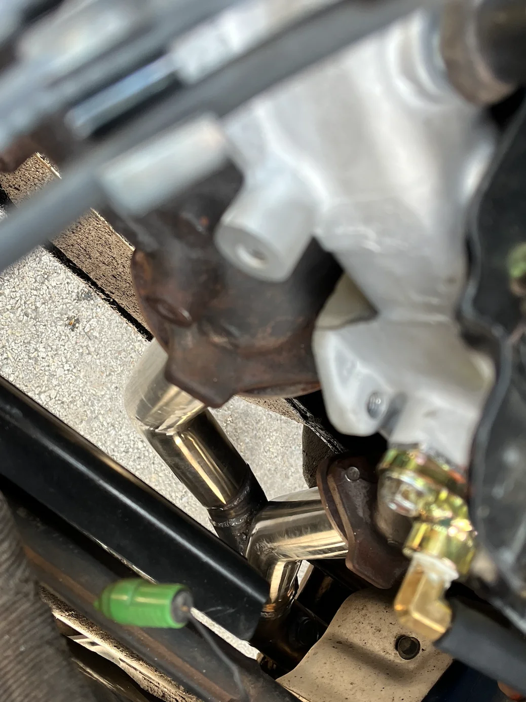

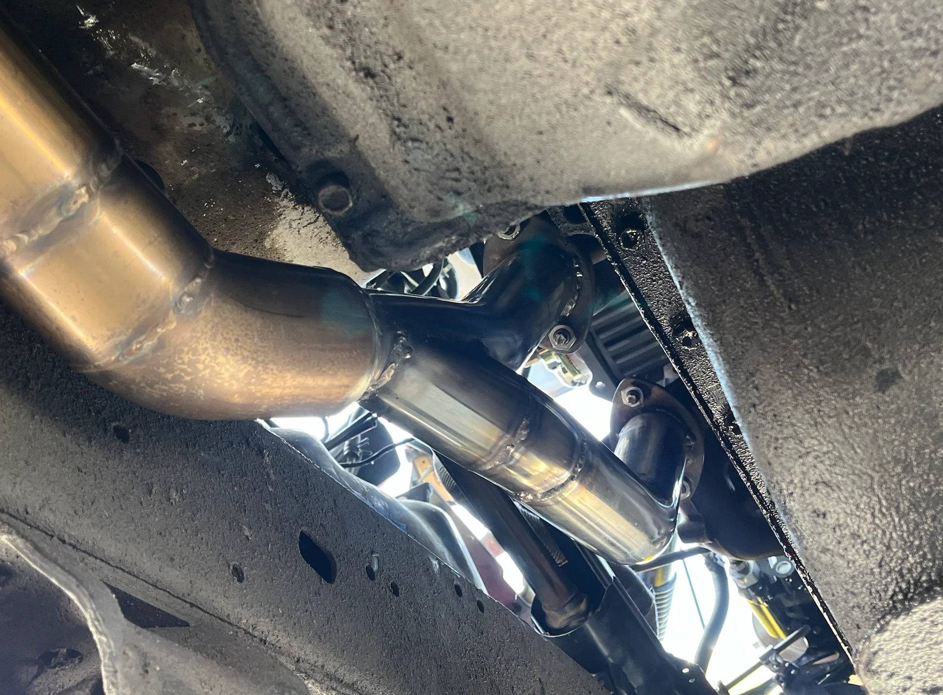

Lou got full custom stainless exhaust. TIG welded, Mandrel bent, reverse welded V bands. Stainless muffler. Utilizing all factory mounting points and isolators. Incredible work by a local legend from the LS crowd.
Here are some photos:

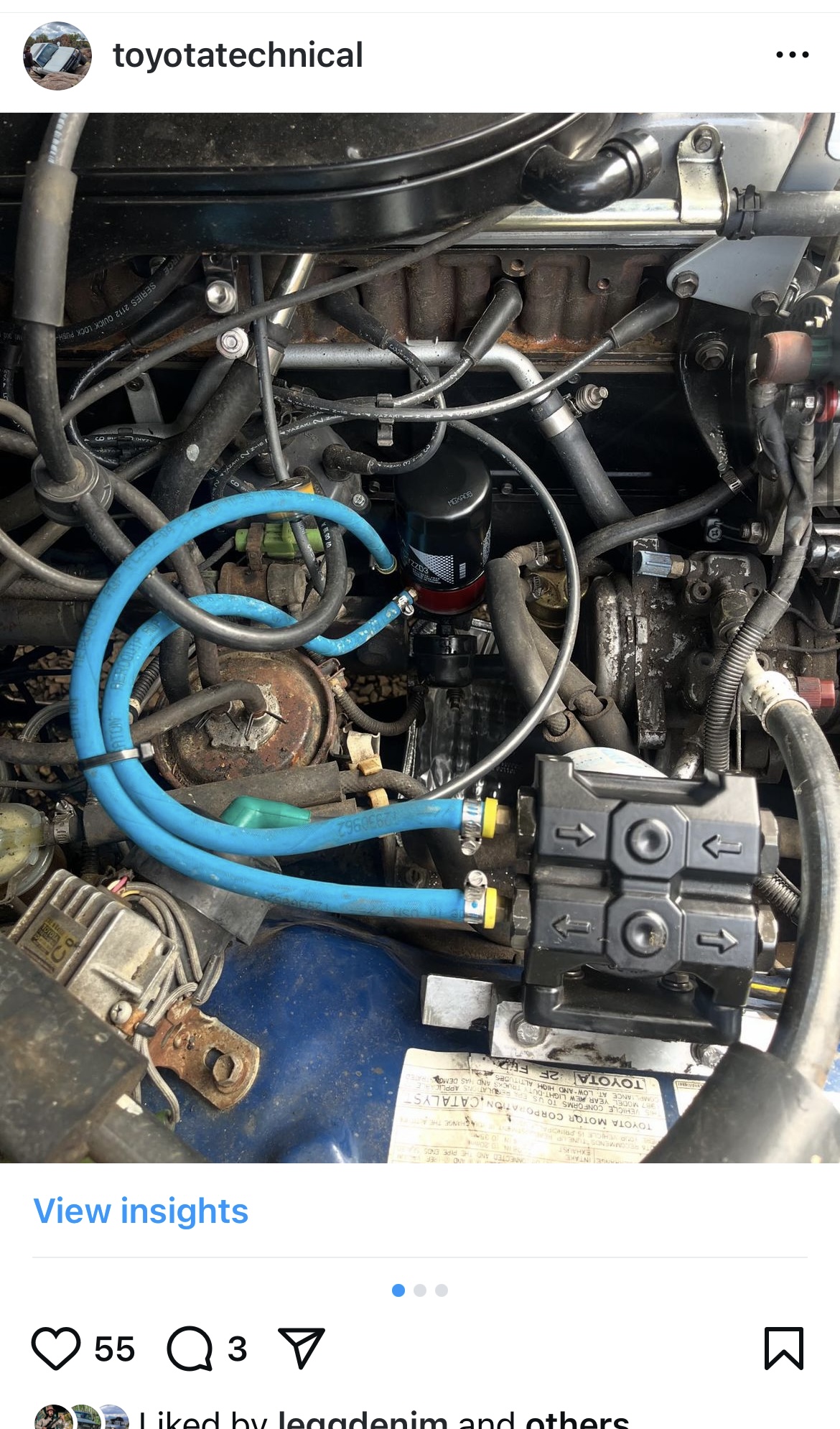

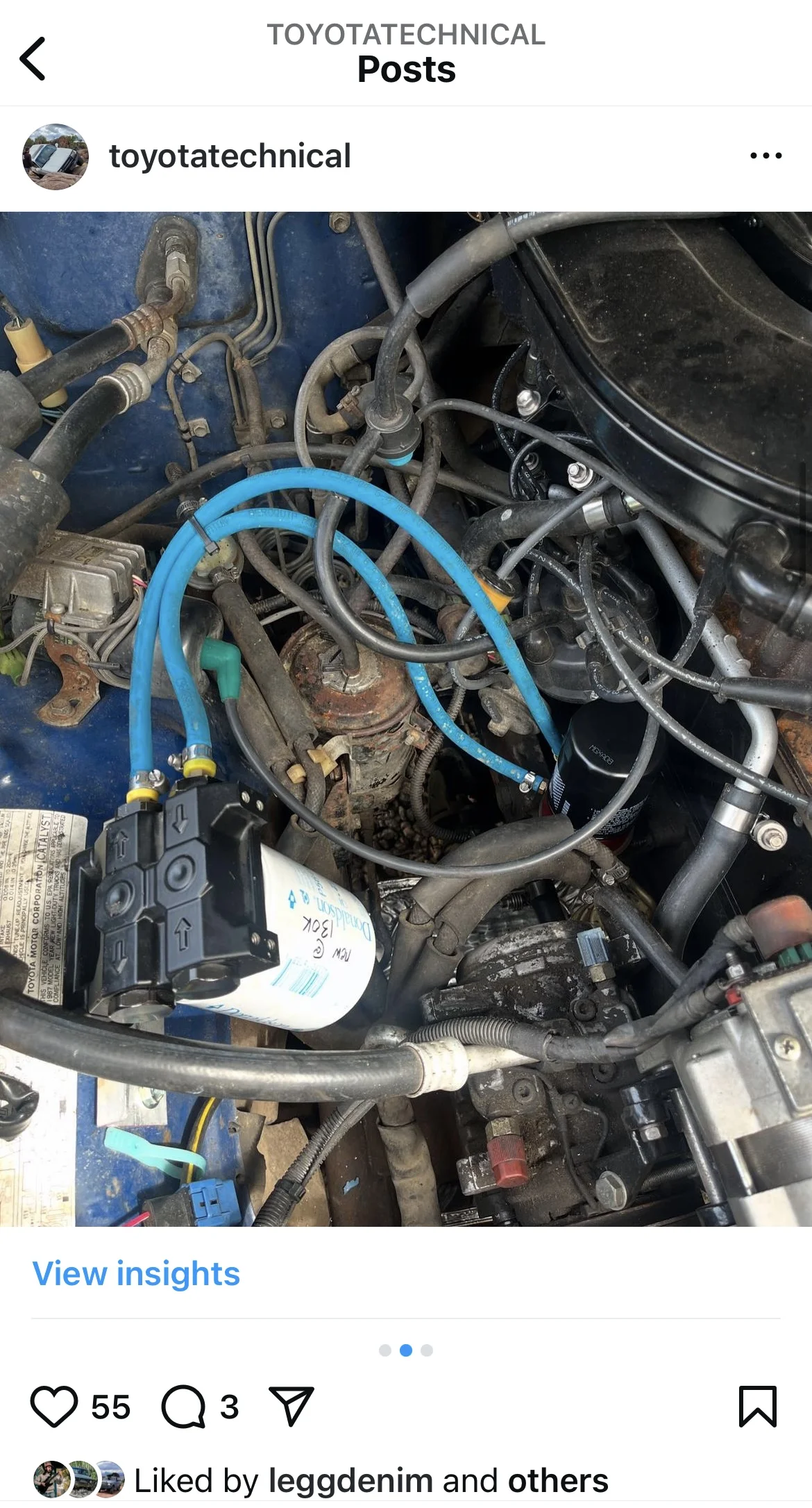

Bypass oil filter also installed - providing 4 micron filtration. Little did I know, this would be the worst decision of my "car related" life.
Here it is hooked up, idle leak tested, and test driven around for a few miles.

Then the nightmare started...
Disclaimer, I am still pissed about the situation. Trying my best to be professional and give "this company" a chance to make it right before I go nuke mode.

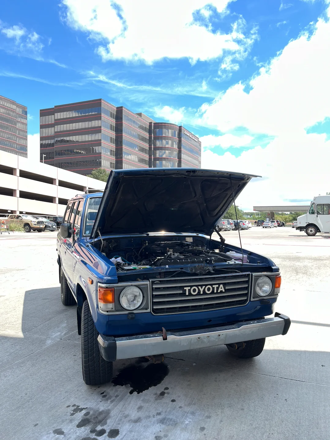

I hop in Lou to head to the store. About 15 minutes into the drive, I look down and Oil pressure is at ZERO. I throw her into neutral, and shut off the engine. I coast into the shipping and receiving bay of Costco. At this point, I am optimistic because I am a religious gauge watcher. I check gauges every minute or so while driving.
I get out, pop the hood, and oil is Everywhere. F*%^! The oil filter & bypass filter adapter assembly is flopping around - disconnected from the motor. Black oil is everywhere.
What the F happened? I start investigating, and the threaded Bypass oil filter adapter stripped. This blew both the primary and the secondary filter off, leaving the motor with no oil filter.
I separate the stock D3 Filter from the bypass assembly and reattach it to the factory oil filter mount location - It locks up solid, confirming the factory threads are good and undamaged.
I head into Costco to purchase oil, and head back out. The ultimate question... how much oil will it take? Well, it took a full 7.5Q. Not good...
Costco security is now telling me to move the cruiser or it's going to get towed. I am blocking one of their delivery bays. I fire her up, and Oil pressure instantly returns to "normal", slightly lower than before, but motor sounds solid. No knocking or obvious indication that damage has occurred.
