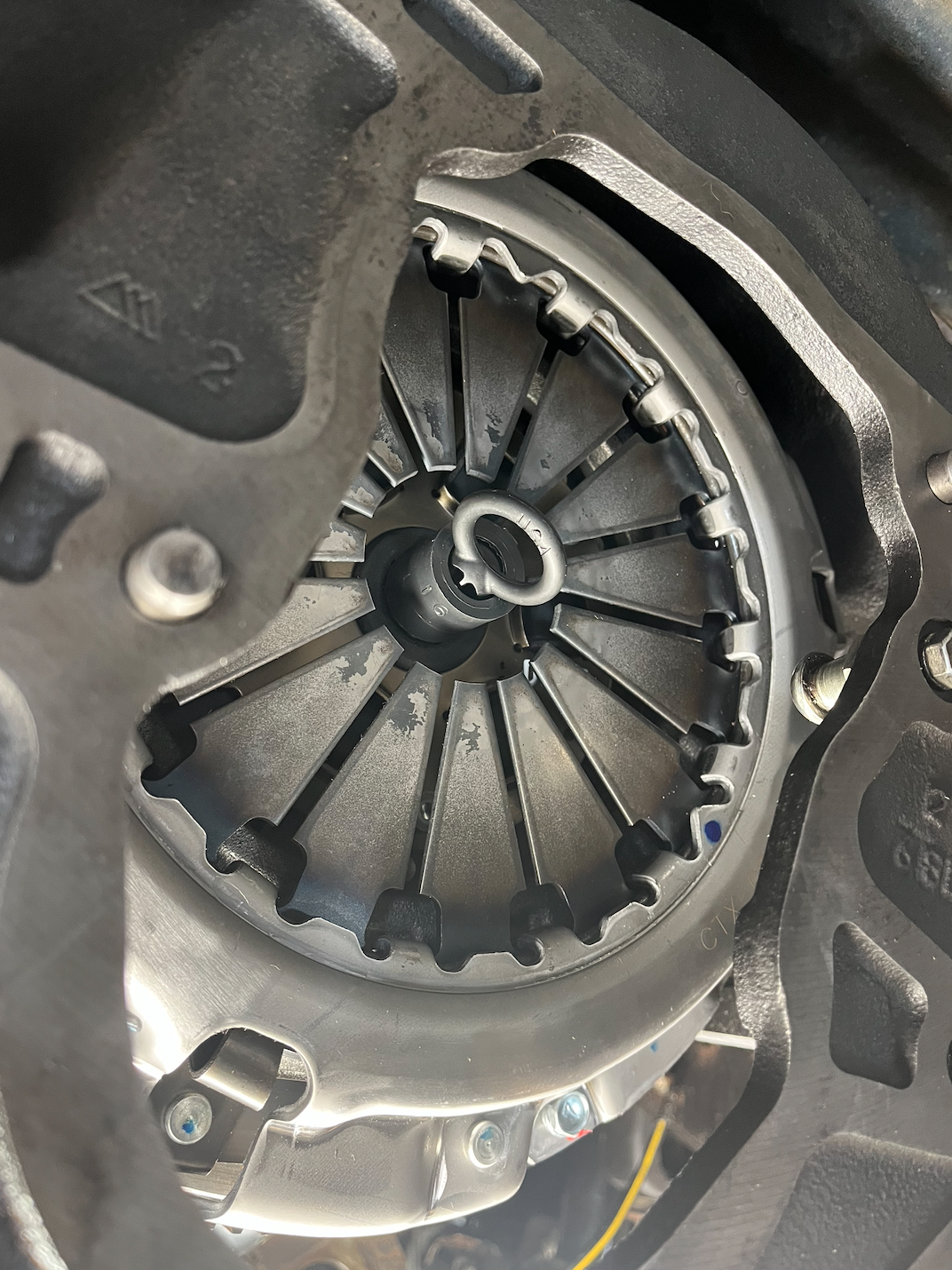

Some photos of the H55 Swap and clutch related items:
Old v New pilot bearing. The old bearing was near failure. Very grabby. Went with Nachi 6202-2RS2. Next time I will go with a Nachi 5202Z.
Pilot bearing installed with view of new rear main seal:
New Hardware for everything. torqued to spec. Locktited and witness marked:

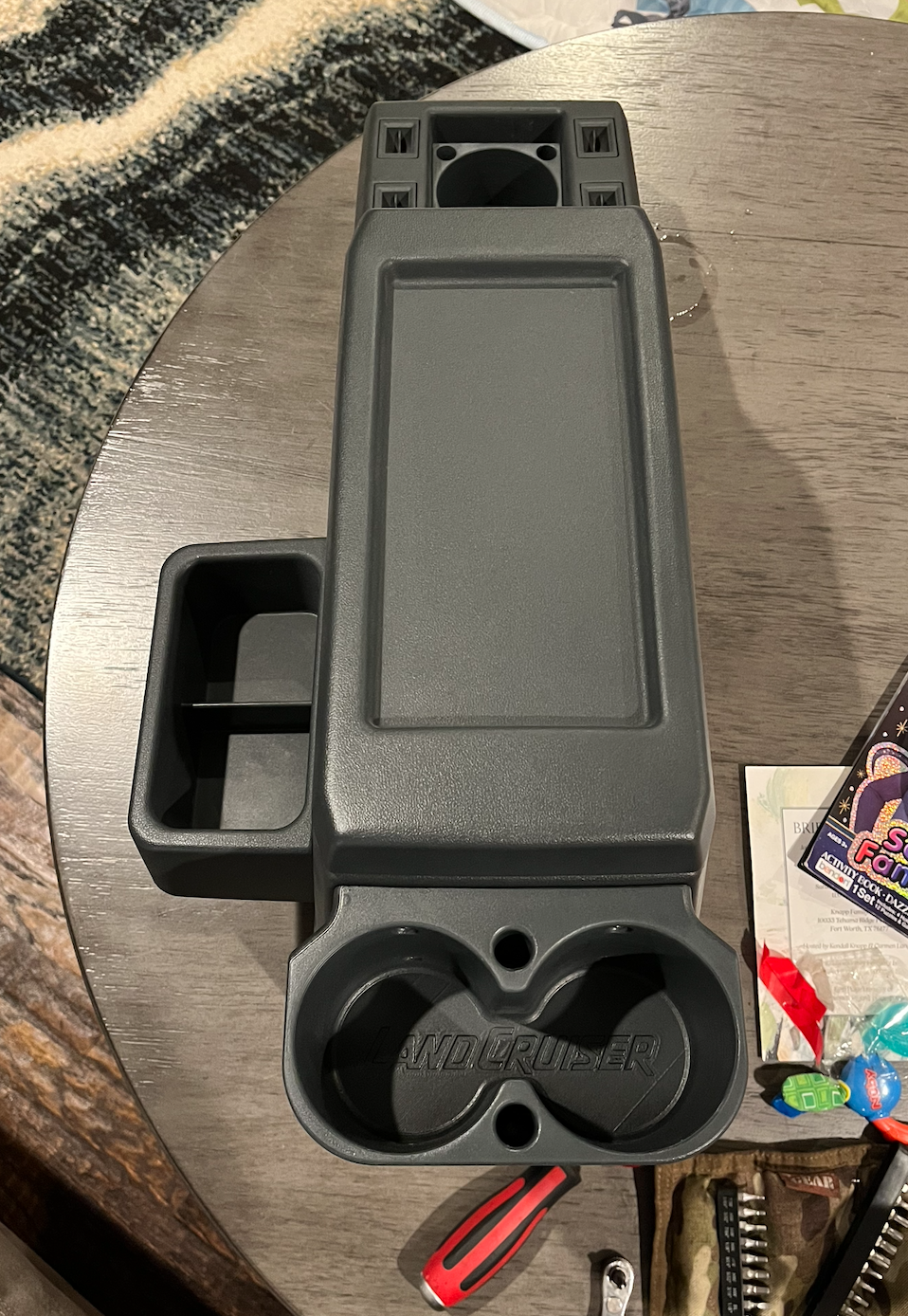

Did some interior work per the wife's request... Cup holders are needed.

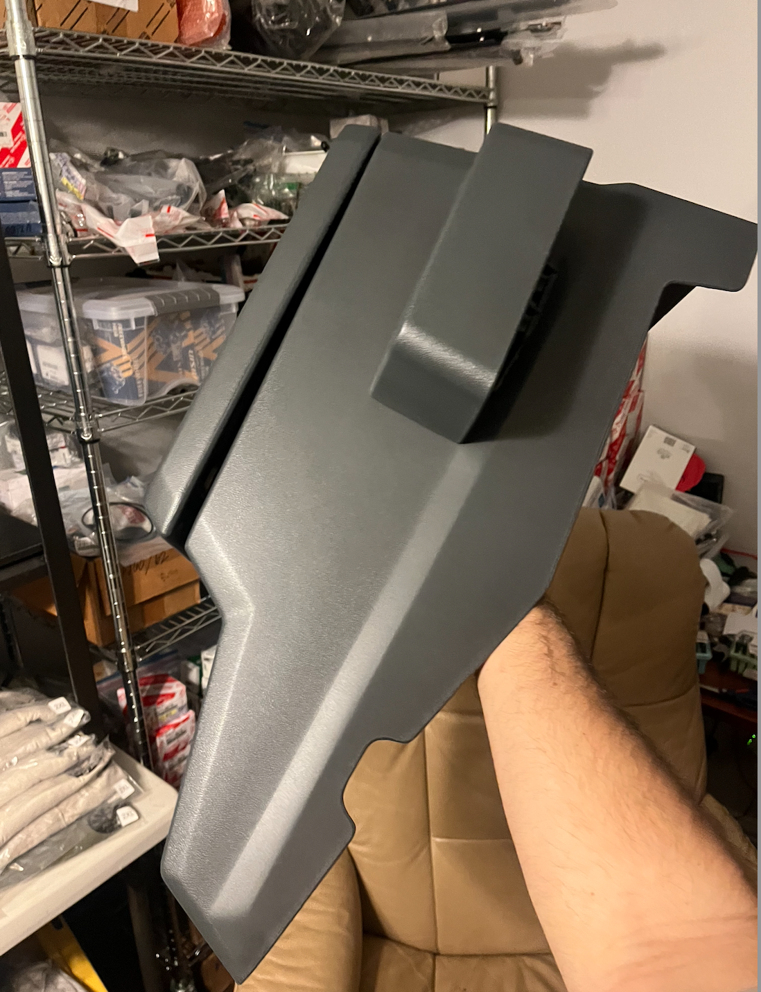

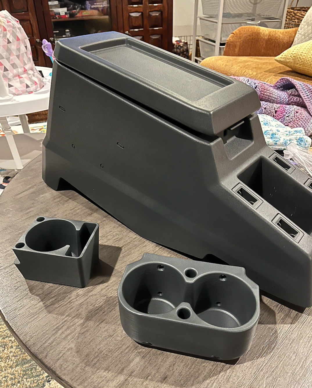

Pulled the center console and cleaned it up. SEM adhesive primer, SEM Grey, and then SEM clear. Then added 3D printed cup holders. Looking fantastic.
SEM Paint demo:
Cup holders:
Cup holders mounted:
