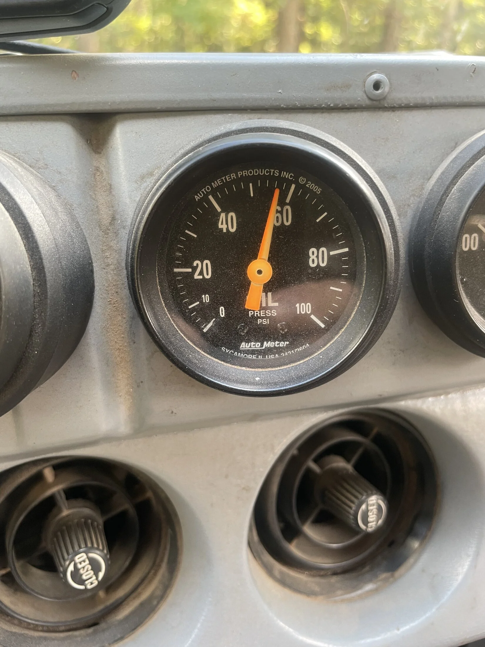

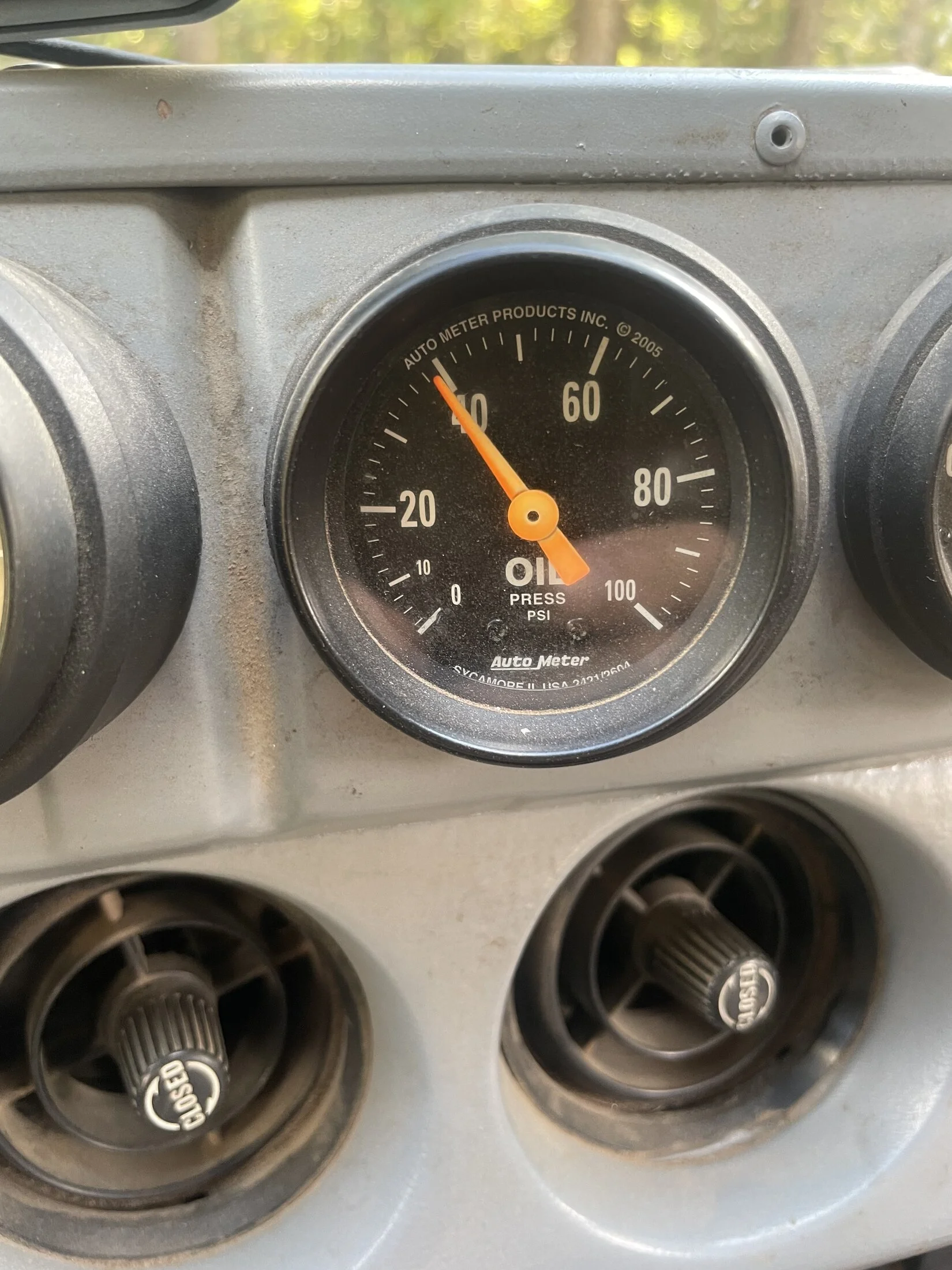

Update on Lou60. Drove her for about 20 miles today. Motor is “fine” as far as no knocking or horrendous noises. Oil pressure gauge indicates oil pressure has increased since the first drive after the bypass filter incident… are 2Fs self healing 😂? Did another oil change and oil still has glitter. Oil filter has about 1/4 the bearing matter as the previous filter removed.

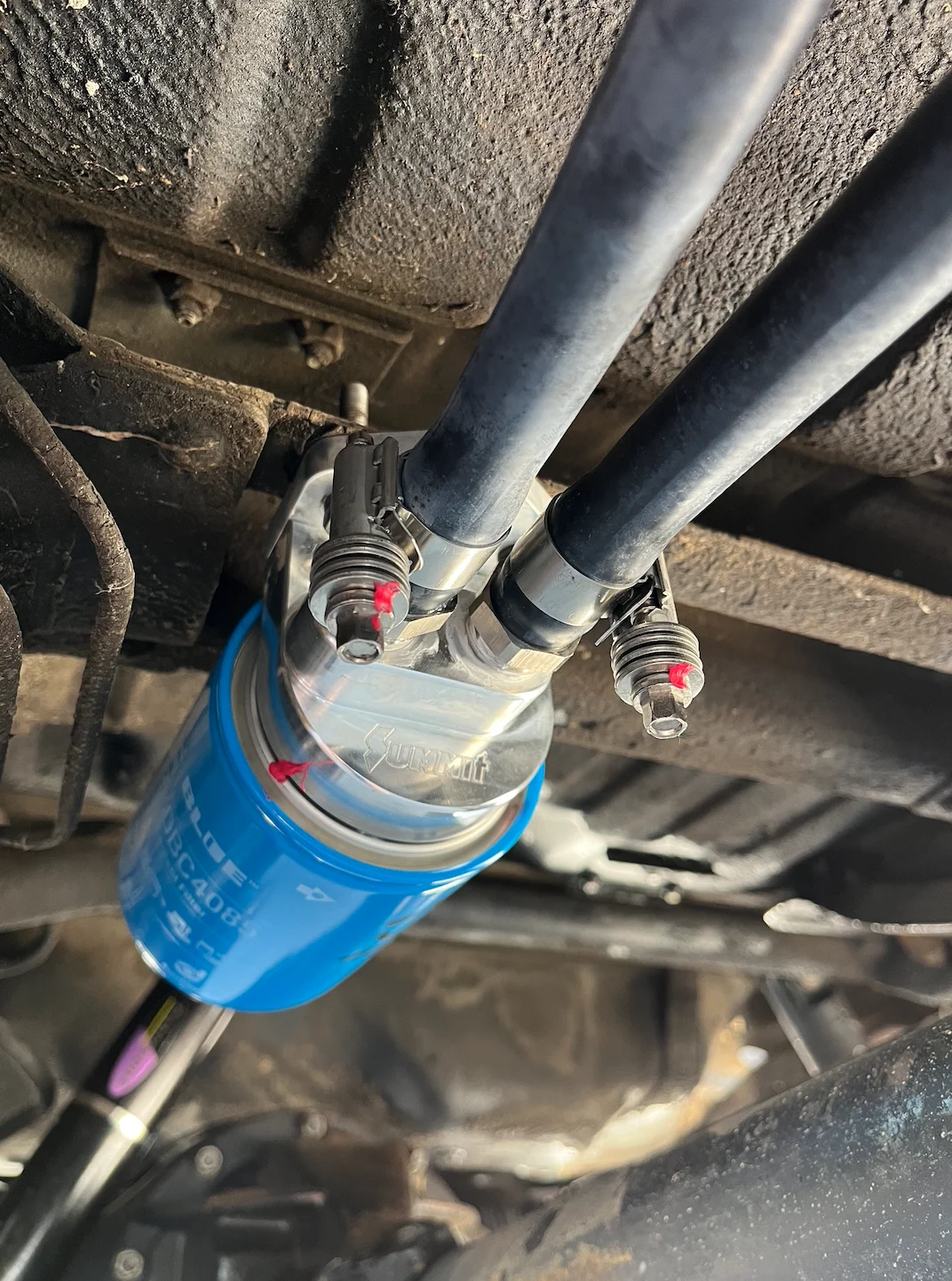

A side project I have been working on... coolant filtration. Testing currently before I offer these to customers and MUD. These will work on 60, 80, and 100 series.
This is hooked up to the rear heater circuit. New OEM coolant lines, Donaldson BLUE filter, breeze clamps, billet filter base, etc. I will create a separate thread on the topic and design.
Here it is mounted to Lou:

Jim, what is the typical oil pressure under various circumstances on a 2F? I haven't found a straight answer to that in the forums.
40 at idle, 60 at any rpm above idle, for example 1500+. This is from observations over a couple of decades and multiple hundreds of thousands of miles using Autometer Z series gauges in two 2Fs and one 3FE. Cold, fresh oil will see pressure up to ca. 70 psi at a higher rpm, let's say 3k, but as the oil warms and thins the higher pressure limit drops to ca. 60. Once oil has 500+ miles of use (kinda guessing on the mileage) that 70 psi high will no longer occur.
For the most part over this time and mileage I've used Rotella 10-40W, but prior to that the oil I tended to use was Castrol 20-50W. If a lower weight oil, for example 10-30 is used, that may reflect a different consistent oil pressure.

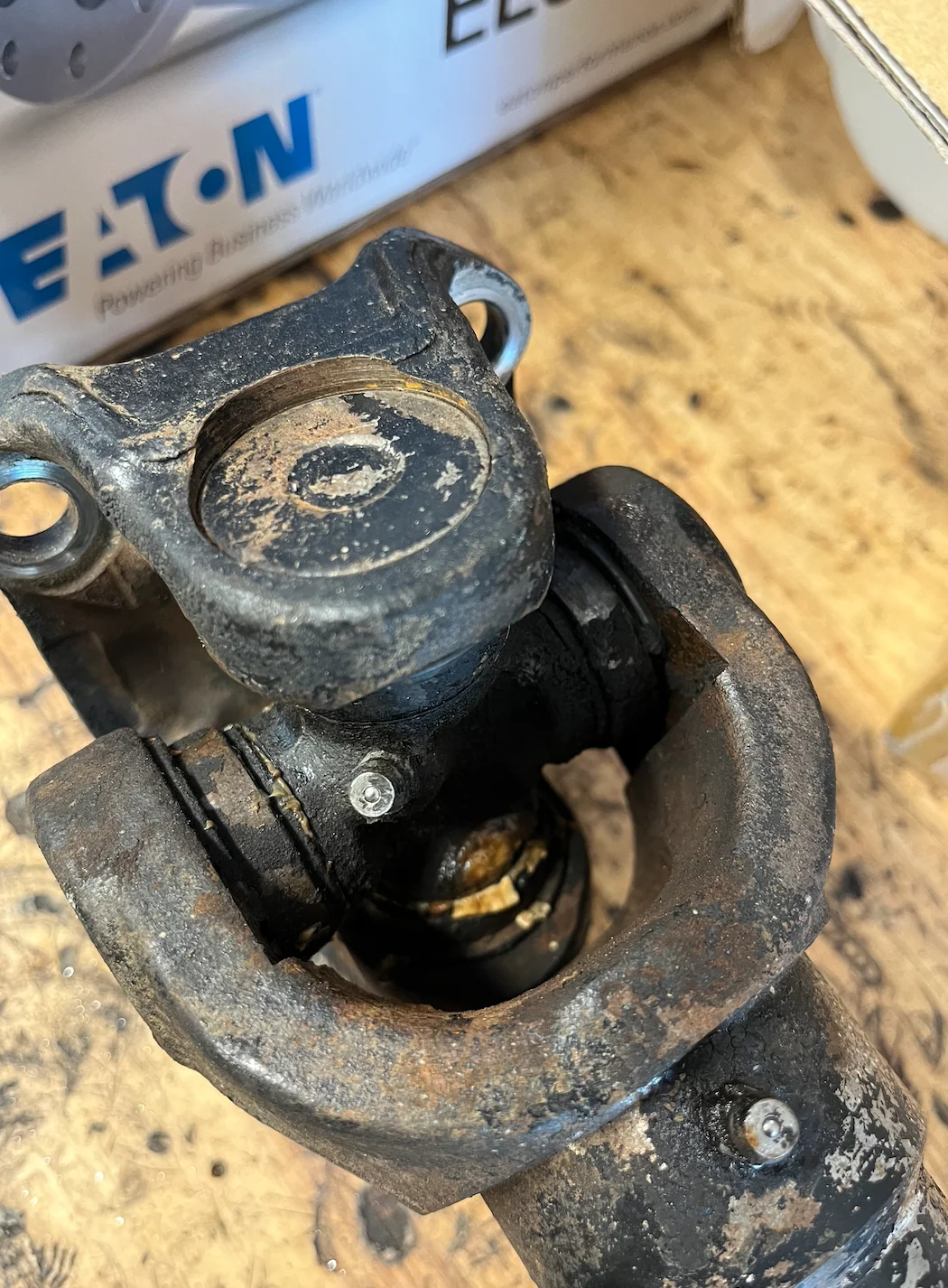

Also decided to pull the rear driveshaft for rebuild. Joints were tight but grabby. They were loaded with nasty water contaminated grease.

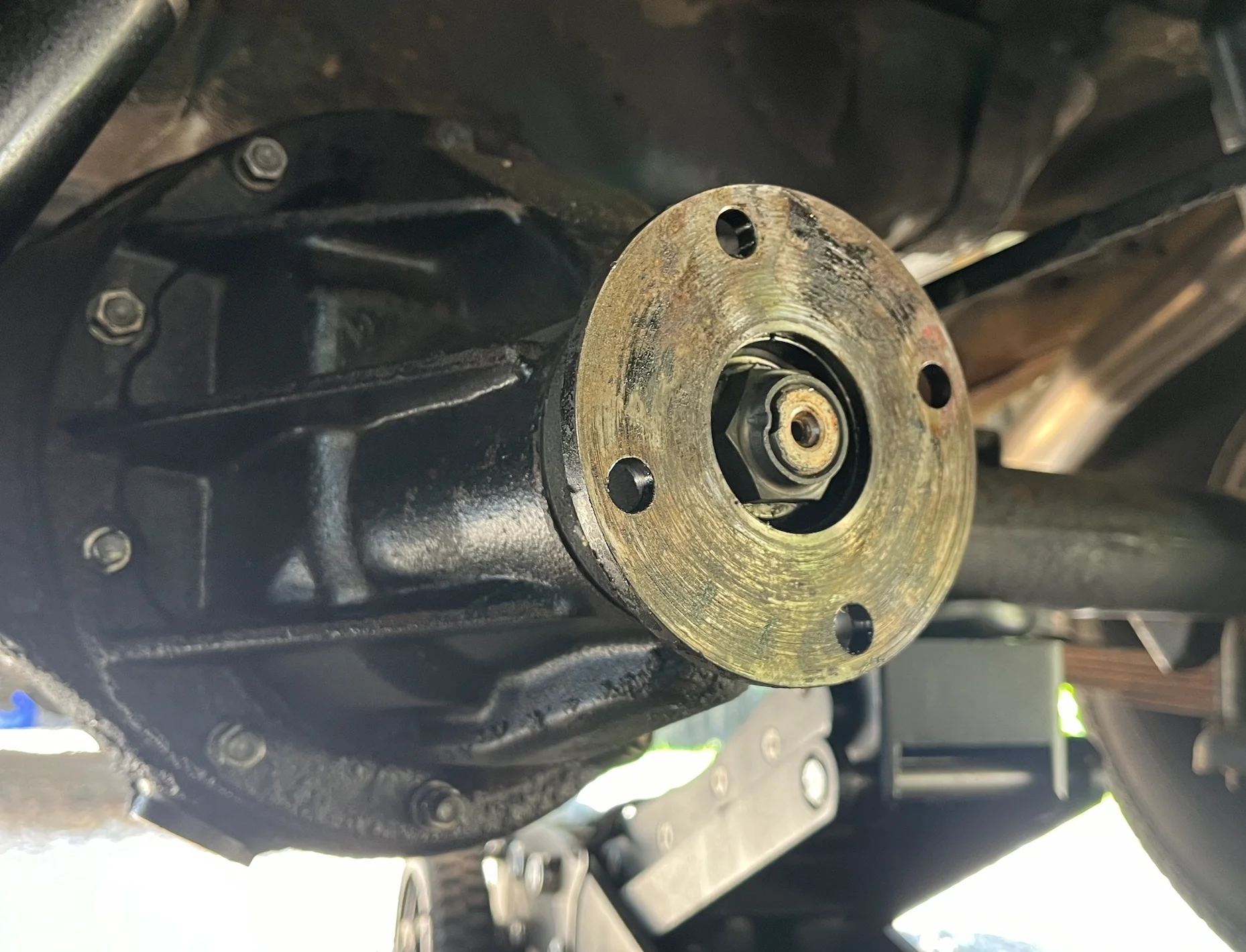

Found the transfer case stake nut was backing off and the rear pinion flange had play. T-case nut was tightened back to spec and re-staked. Rear pinion seal was replaced with the new and improved toyota seal and tightened up a smidge. Play went away.
T-case nut backing off:
Rear pinion. Stake still in place... so play due to wear.
Rear U-joints:
