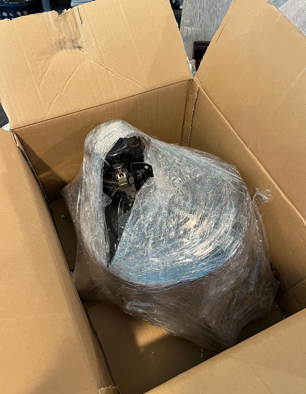

While on my search for the 2F head, I was taking care of other engine bay accessories. One being the air filter housing. This unit filter wont be used though. I found a NOS cyclonic unit from the Pakistan / AFG area.
Before:
After:
Between the fancy carb work, vapor honed valve cover, vapor honed intake, etc, I did not want to cover it up with the stock air filter housing. Instead, this will be used:
Filter housing. Good condition, but not perfect. If it was not NOS status, I would powder coat it:
Carb hat:
Carb hat, intake tube 2x OEM clamps:

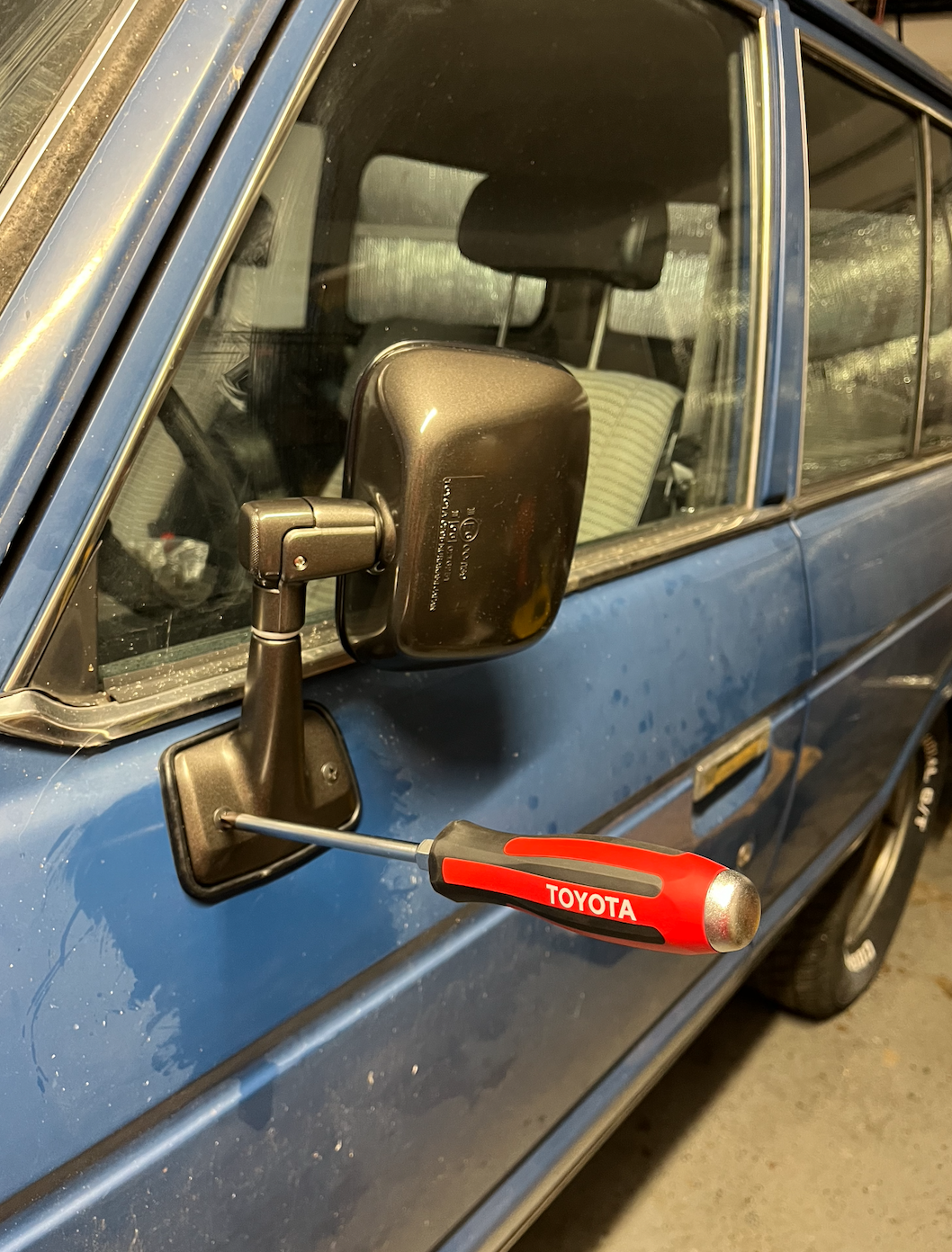

Euro Spec Mirrors (2x Euro-mirror: 87903-90A04), with City Racer reproduction gaskets:

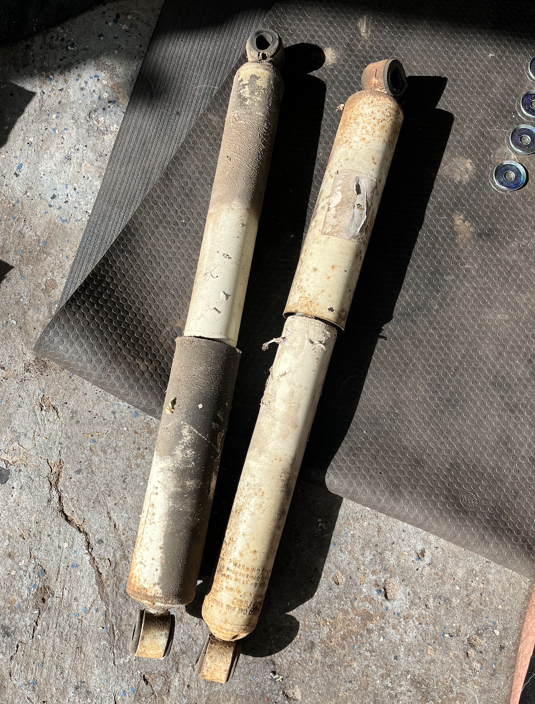

New suspension and hardware going in. Swapping to Dobinson IMS.
Suspension strut bolts:
  • 4x bolts: 91611-61020
  • 4x washers: 90948-03007
Dobinson IMS:
  • Rear: IMS59-50649
  • Front: IMS59-50701LC
Old stuff:
Old v New:
IMS close up:
Old hardware:
Old V new hardware:
