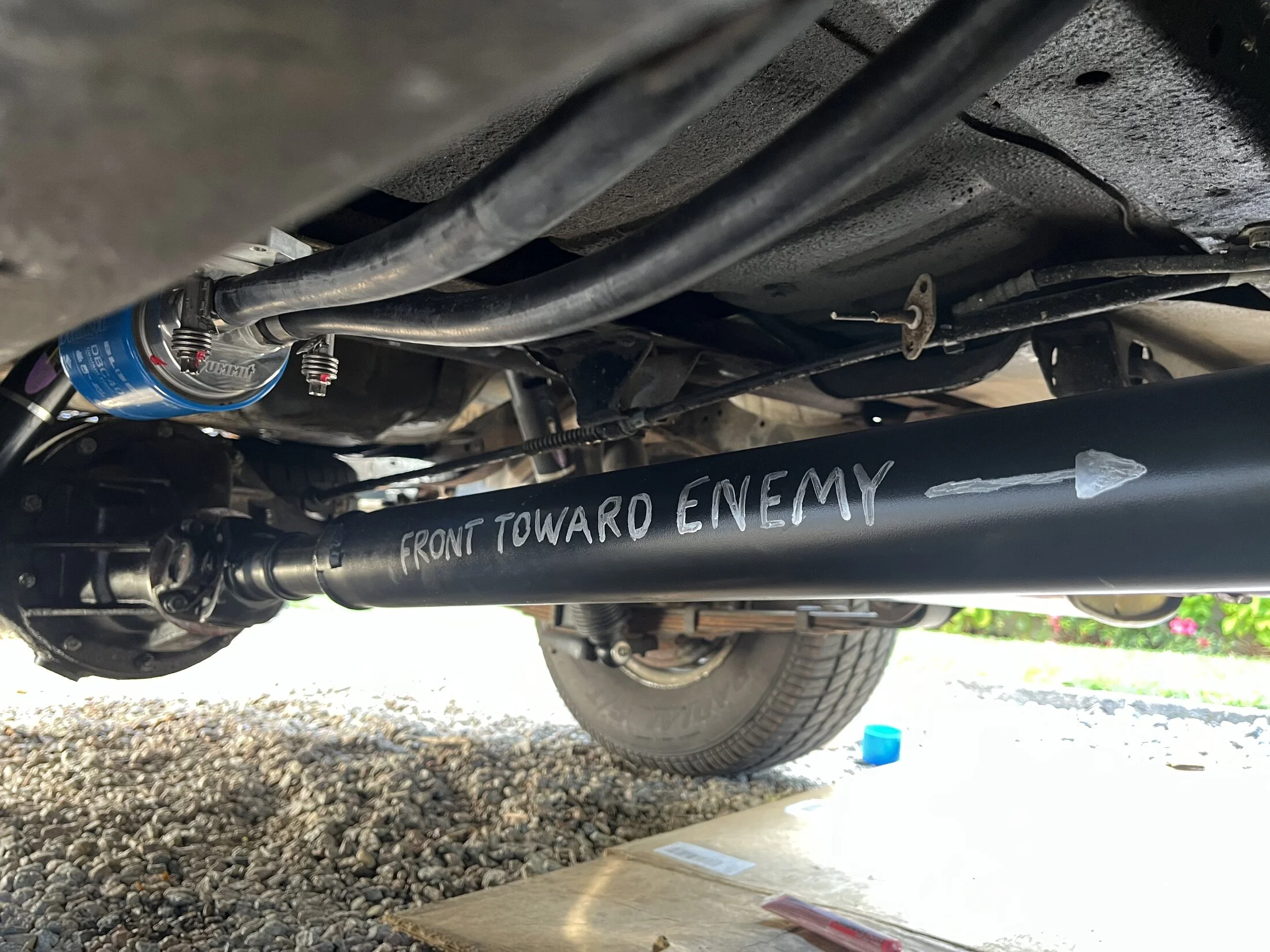

Fresh Rebuilt drive shaft in place. Japenese joints, painted, and rebalanced.

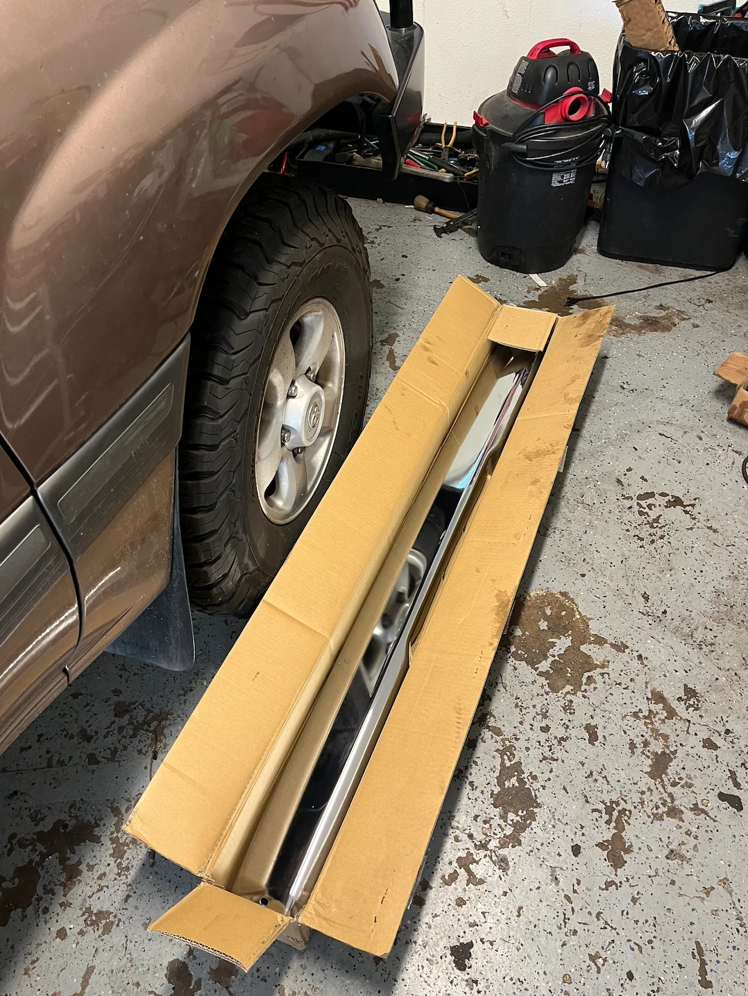

Lou also got a fresh OEM Bumper. Too many good sales going on awhile back... 25% off, free shipping, no sales tax, etc. Every carriage bolt had to be cut off. Fun grinder work.
Here is the parts list:
Bumper: 52151-60041
2x 12mm nuts: 90179-08146
2x: 12mm Bolt 91621-40816
6x 17mm headed bolts: 91659-61225
6x carriage bolts: 90112-12041
12x: 17mm head nuts: 90179-12058

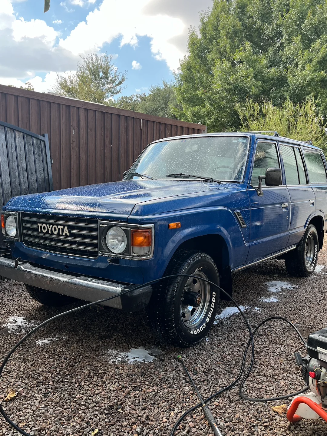

Bath time for Lou:

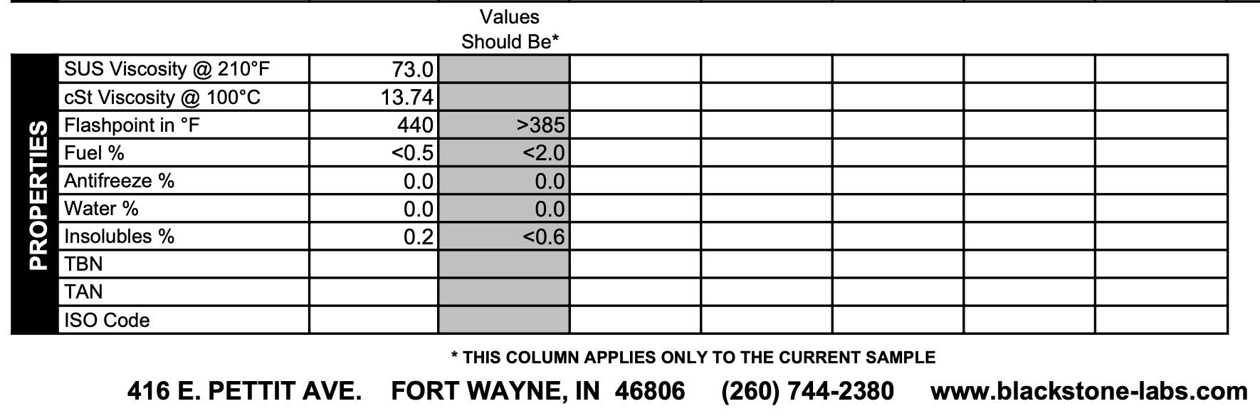

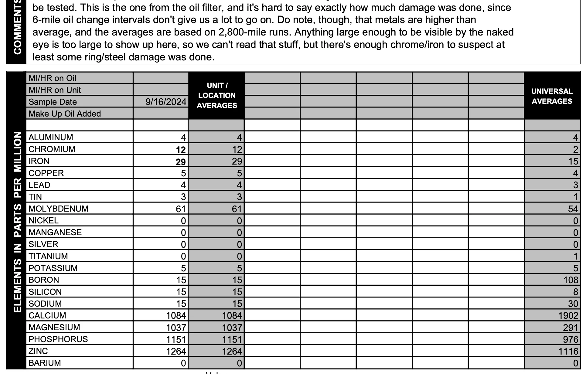

Got results back from Blackstone. Not much value added due to little mileage and run time on the oil.
Write up from Blackstone below. Any oil gurus feel free to chime in.

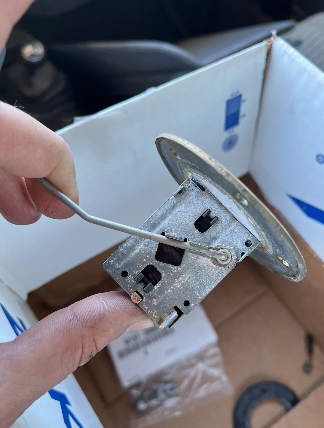

Lou has received a factory fresh fuel tank due to recall. This was a very difficult process, as the dealer tried to wiggle their way out of the job any chance they had. Had to get corporate involved to make it happen. About 6 months of back and forth. I had all associated fuel tank parts on hand for them to add in at time of the job. Fuel neck isolator, fuel neck screws, fuel neck grommet, fuel level gauge, etc.
The old tank they removed was in fantastic condition. No corrosion and the fuel gauge was in excellent condition. My theory is lou was getting ethanol free gas due to her being at a lake house. I dumped Biobore-EB stabilizer in the tank about 7 years ago too.

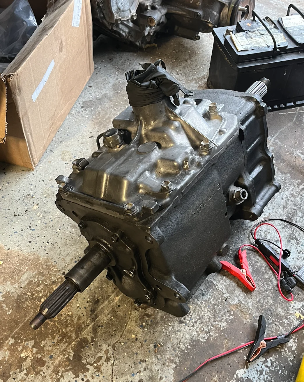

T-case is also getting a refresh as well. Case is getting vapor honed, upgraded long spline gears, TSB springs, upgraded breather tube, etc

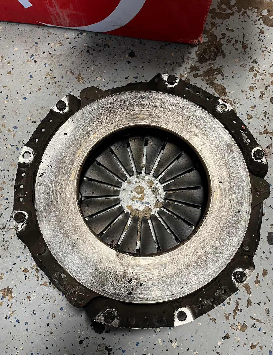

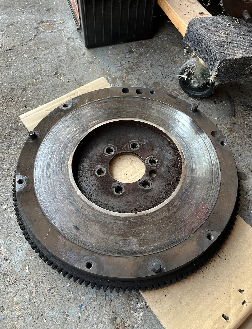

Old flywheel before resurfacing:

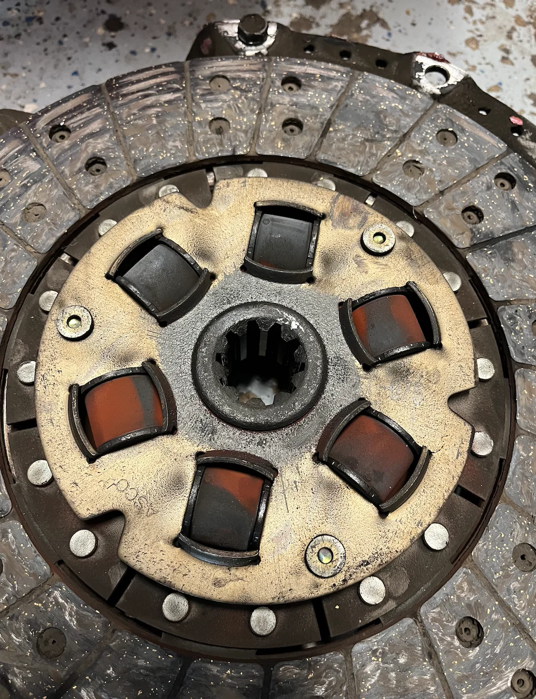

Old clutch items:

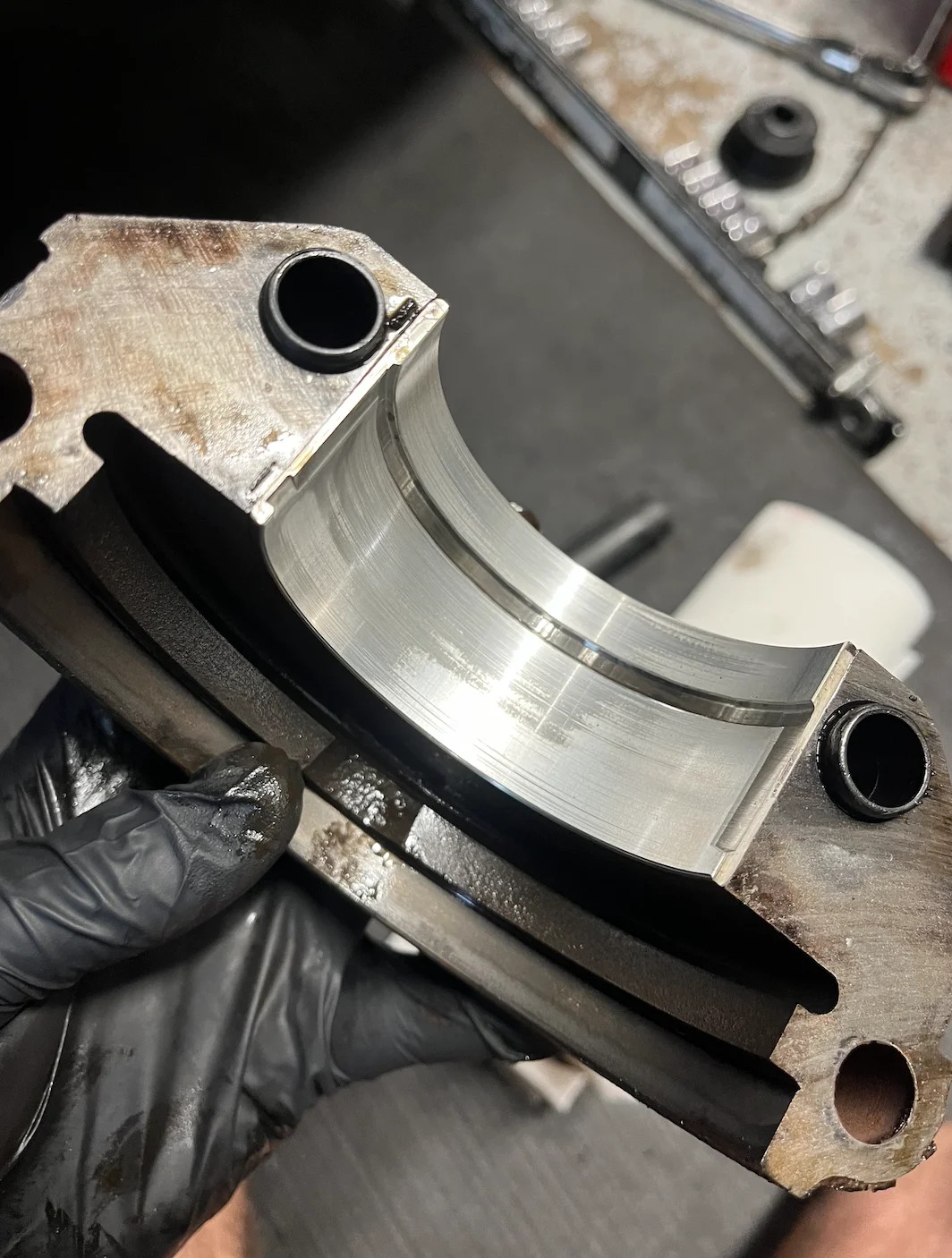

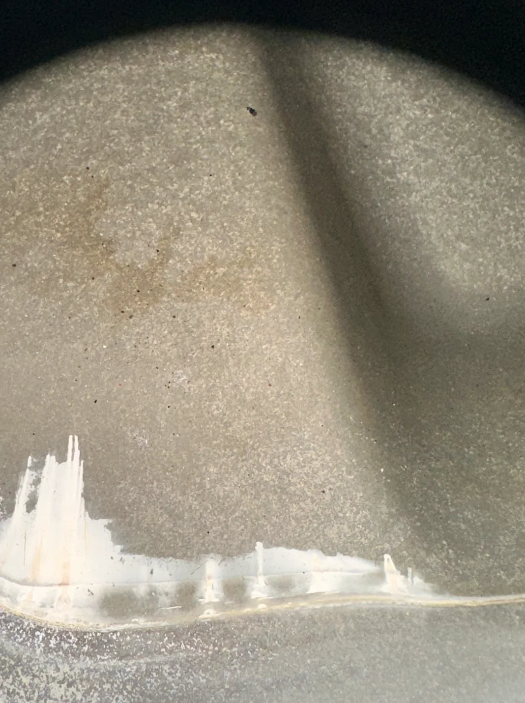

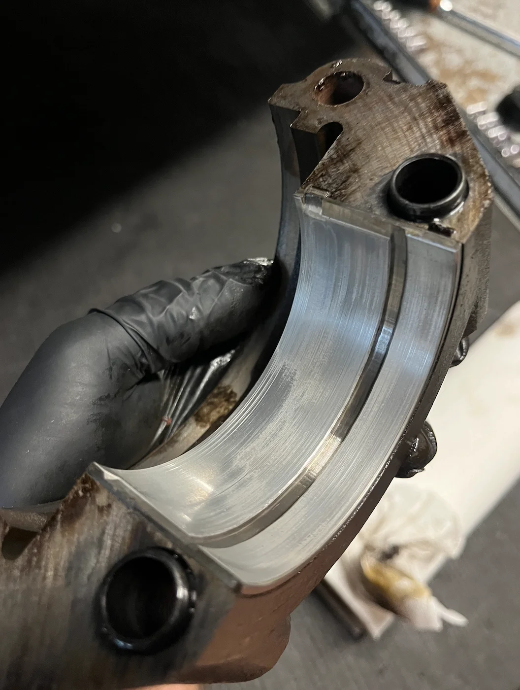

And for the big reveal... Bearing health is good. I am amazed at the condition. Some discoloration, but overall solid for being starved of oil due to the bypass oil filter failure. Motor will be left as in and driven.
@crtx That's a clean looking H42! I guess most everything on Lou was in good shape though.

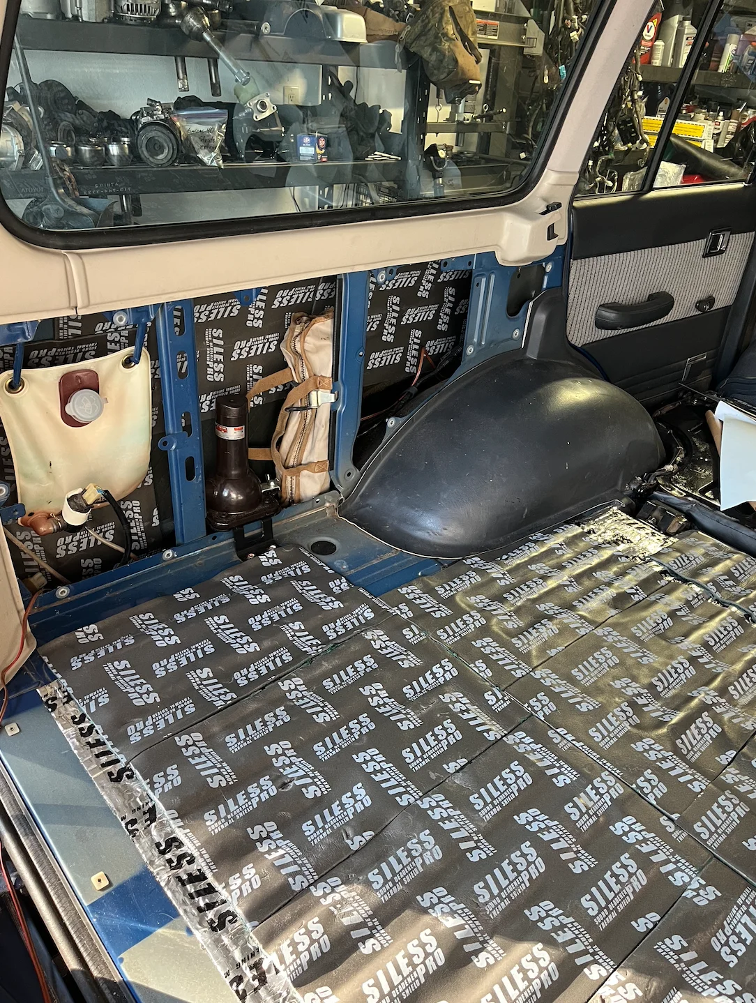

Interior of Lou is also getting refreshed. Stripped, cleaned, sound proofed, carpeted, and audio upgrade.
For sound proofing: Butyl for base, thermal/sound barrier over the top, then mass loaded vinyl, then the carpet. This combo has proven to be excellent combo on other personal and customer vehicles.

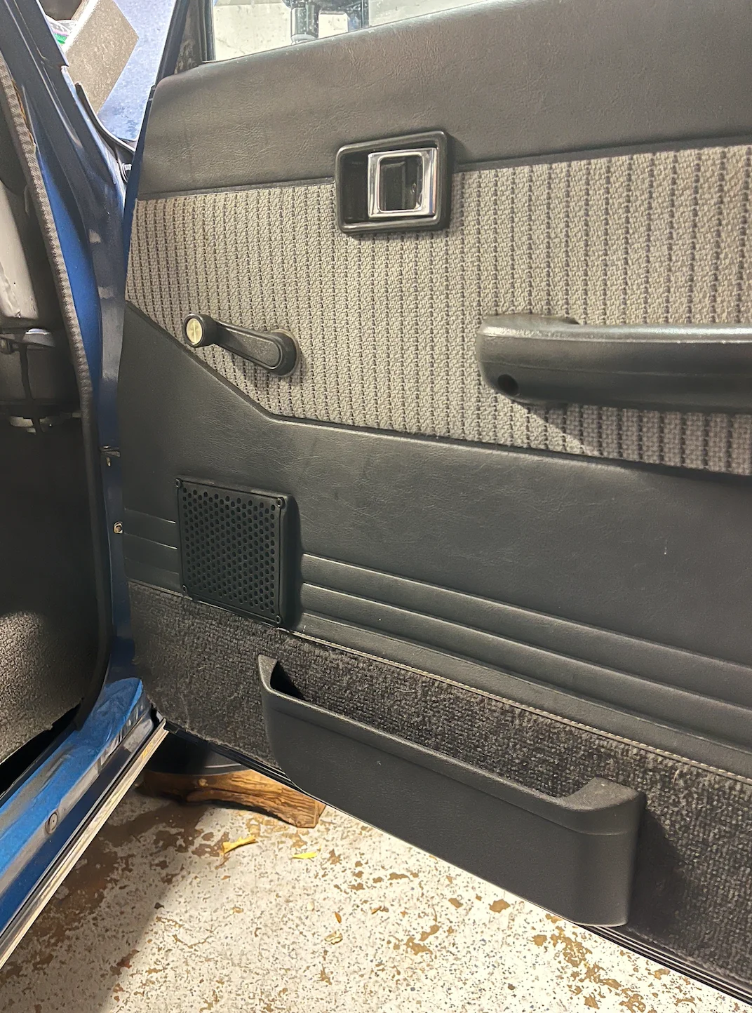

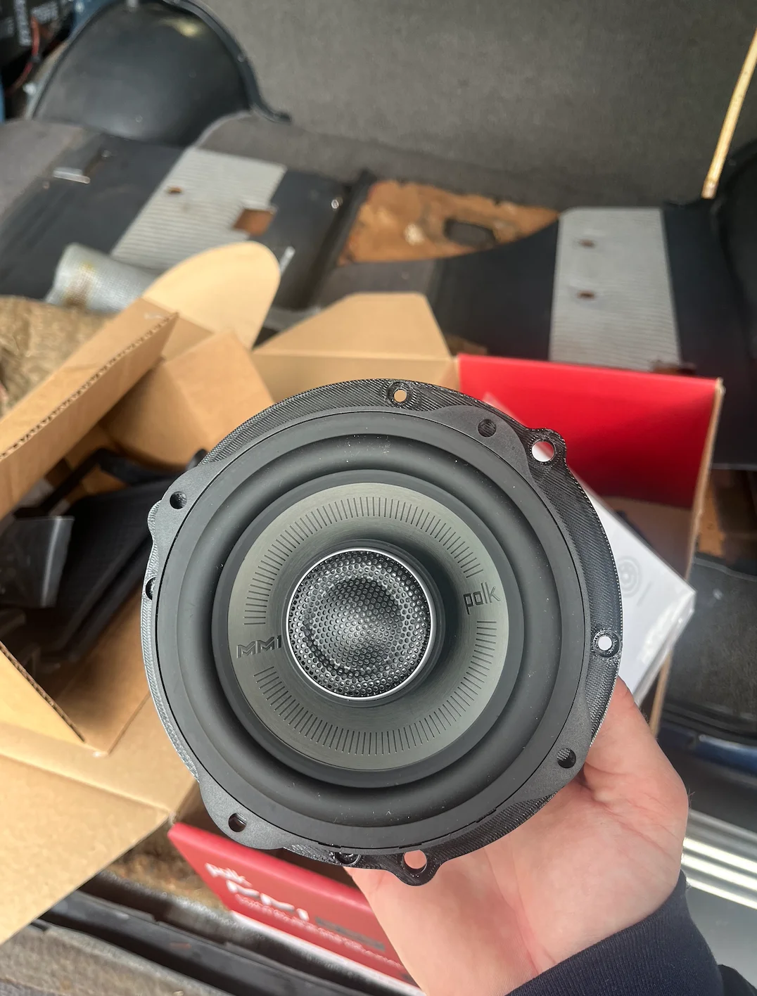

Next up is the doors and speakers. Vapor barriers redone and then doors sound proofed. New Polk MM1 Speakers going in. @TheNeek speaker spacers with Cruiser Cult speaker covers. All new front wiring. Cleaned up with fresh wires, wrapped with Tessa cloth tape, then Techflex f6, then wrapped again with Tessa tape. This should help keep the wiring protected for many years to come.

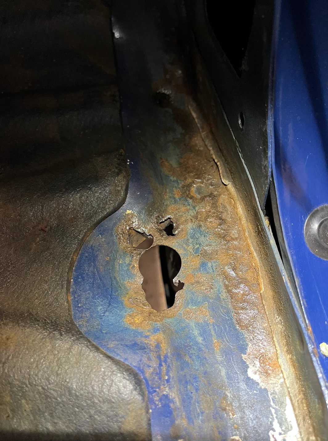

With interior stripped, 3 jelly bean sized rust spots were found. These will be treated, top coated with steelit paint, and welded.
