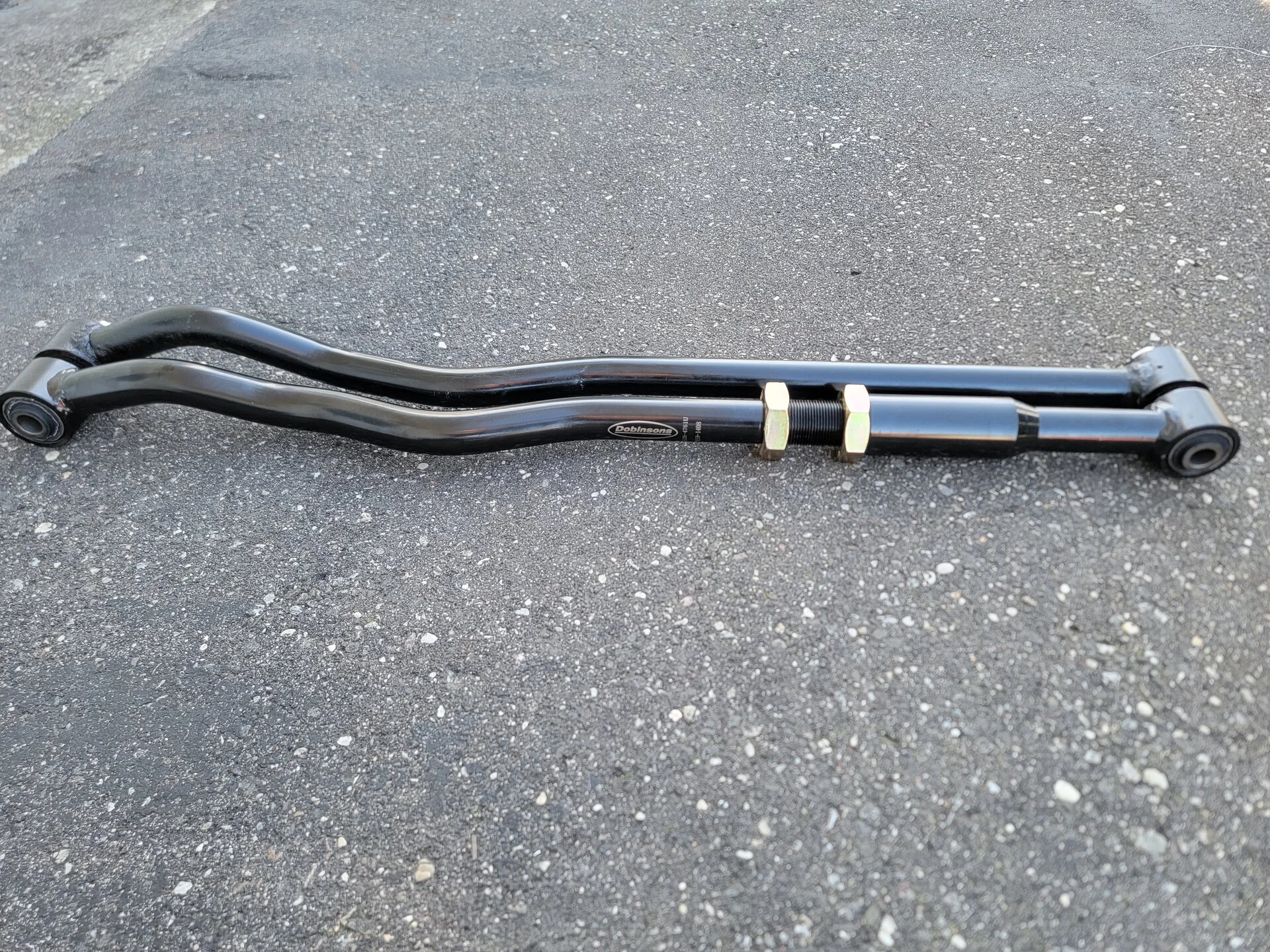

I just upgraded the original panhard bar and steering damper to Dobinsons before dropping it off to a new mechanic to get the leaky fuel tank diagnosed and repaired.

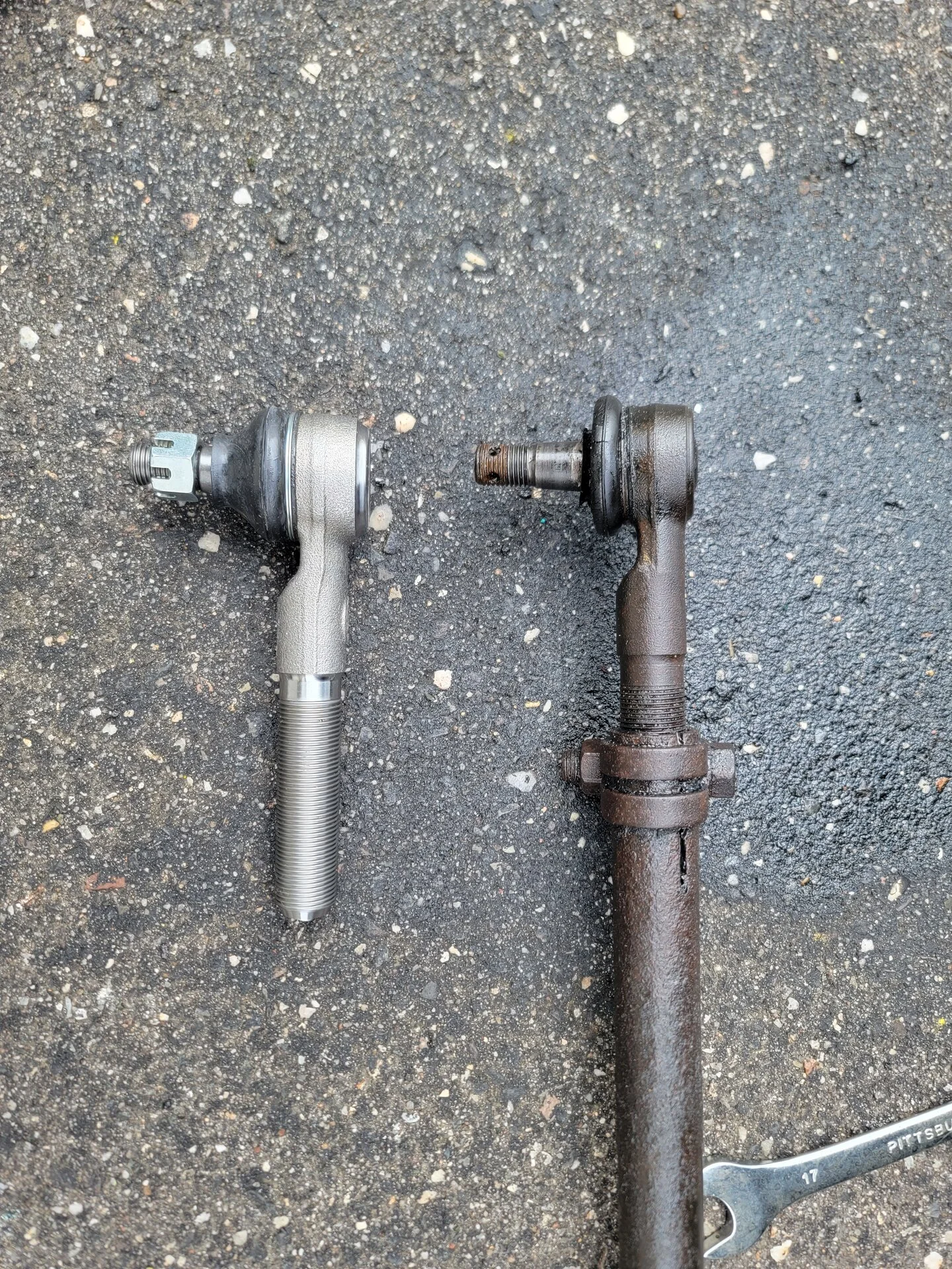

I diagnosed my relay and tie rod ends. How much resistance is there supposed to be when I twist the rods front and back? There doesn't seem to be any. Anyway, the 555 tie rod end kit I got from cruiserteq.com has arrived. I initially ordered the RHD kit by mistake but a week later they sent over the correct version.

Front SuspensionPanhard RodDobinsons Adjustable Panhard Rod3/31/2023

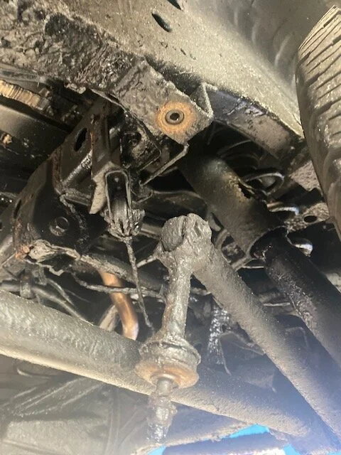

Sway bar is broken, or the rubber bushings are worn out, the mounts for the bushings has come loose, or the end links are broken/disconnected??
Photos would help if posted up.

I just got the message from the shop but once I get the images from their inspection, I'll post it over here. If the sway bar itself isn't broken then I'll return it.
Just got word from the shop and they informed me that it was the end link on the driver side that broke. I will return the sway bar as that's still in good condition.

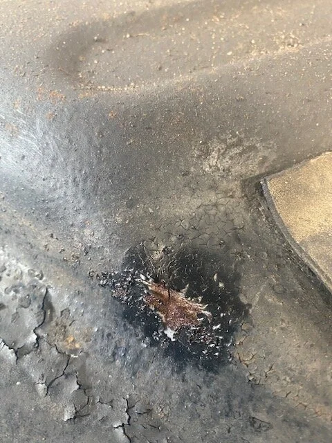

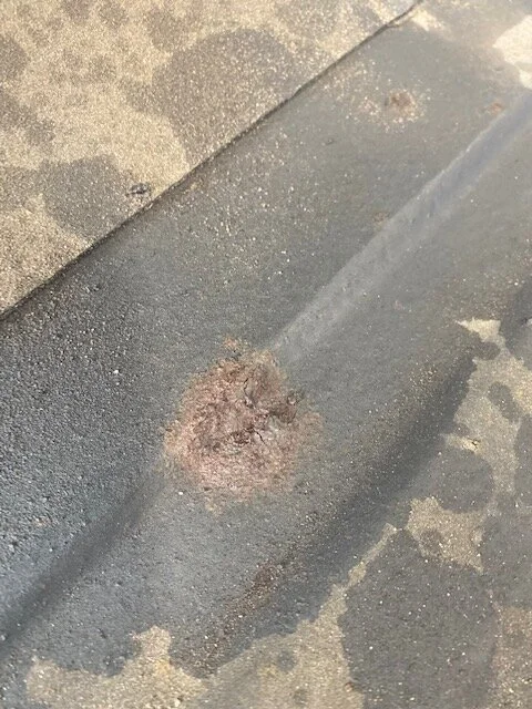

As far as the fuel leak goes, they found the rust holes on the forward part of the fuel tank towards the top. One of the insulation came off and collected debris.

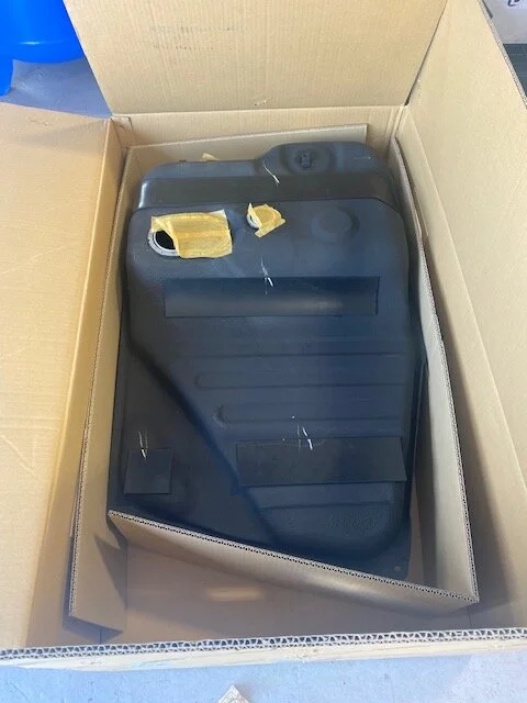

The shop ordered a new fuel tank from the dealer and will replace the old fuel pump as preventive measure since the old one will be removed anyway.

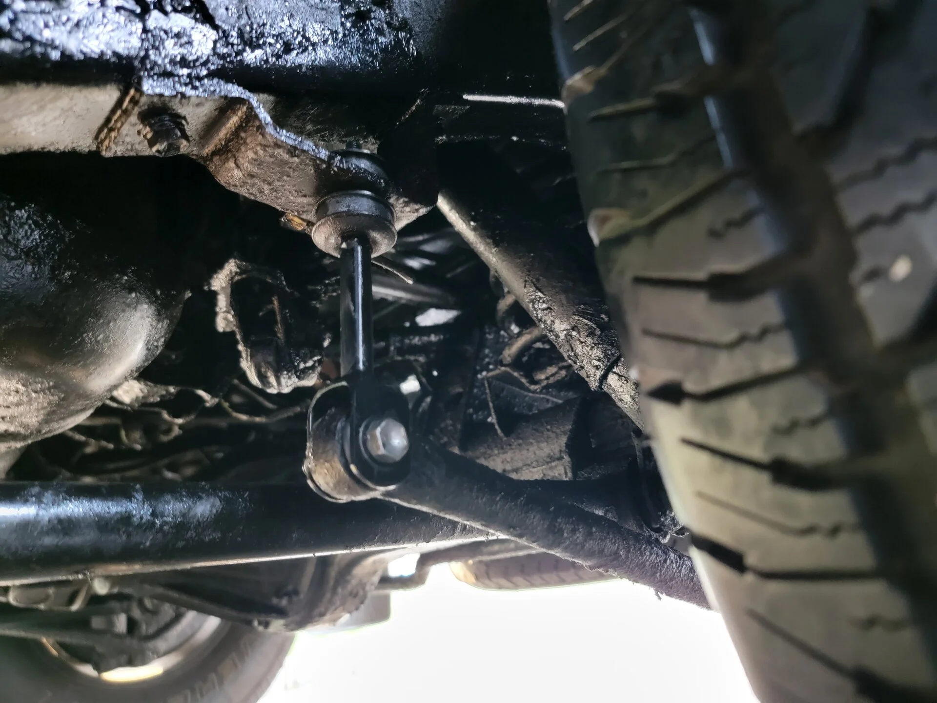

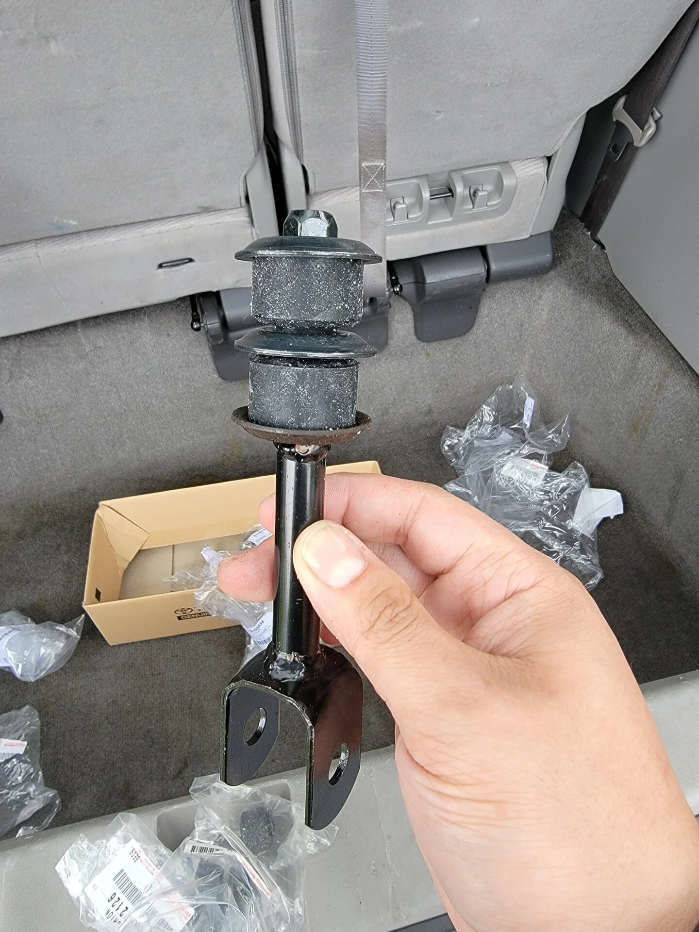

sway bar is intact. it was just the sway bar link. It looks like it was removed and not broken off. I took it to a shop that works on suspensions a while back and perhaps they didn't reinstall it after inspecting the suspensions and quoting me 6k for suspension refresh?
Anyway, I picked up a new set of bushings, bracket and sway bar links for both front and rear. The only thing I have left to do outside of replacing shocks and coil springs are the rear track bar, upper and lower control arms, and the front radius arm bushings.
here is the state of my old fuel tank and the new one from dealer. it was a leak from rusted out tank towards the front.

Sway bar link on driver side is now reconnected. I don't feel a difference with it. I have the parts for the other link and bushing and cover for the axle but I'm going to leave them alone for now and work on replacing the tie rod ends and drag link ends.

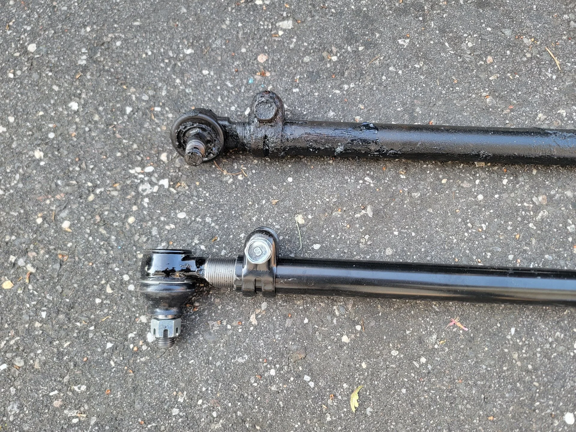

The steering seems to have some play, and when I installed the new steering damper, I was able to twist the relay rod very easily. That's not supposed to be the case, right? I followed the thread on how to inspect the front end on the FAQ and didn't find any looseness when checking for tie rod or relay rod though (9 and 3 on the wheels)

I just finished replacing my drag link ends and tie rod ends. I ended up ordering new sleeves and Clamps because my old ones were disgusting and rusty. it only took me 3 weeks to finish! most of the time it was waiting for my fuel tank to be replaced. then having to wait for a separate order for the sleeves. The job was actually not too bad.
