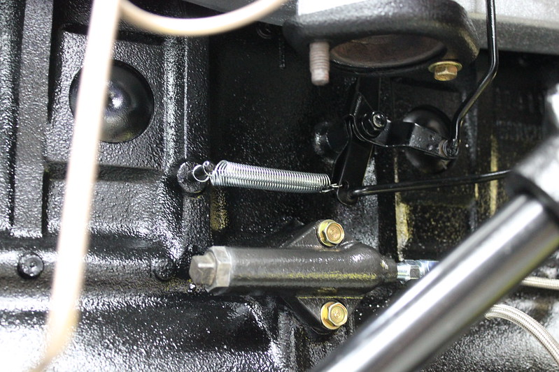

...and finished assembling the throttle linkage. Had to order an assortment of springs.

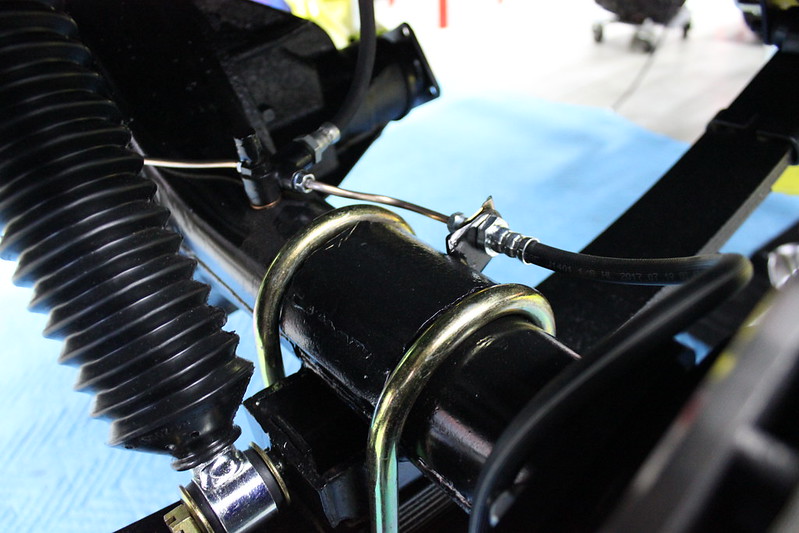

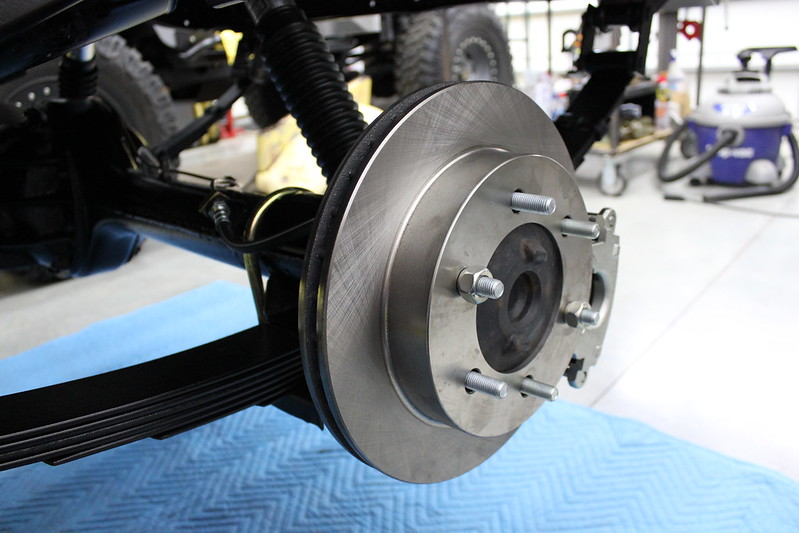

Got the rear axle rebuilt with new wheel studs and backing plates, rear discs from Poser, and bent up some brake lines. I had to swap another 3rd into the housing as the original one had tons of backlash. Upon close inspection when I removed the cover...the pinion had some wear on it.

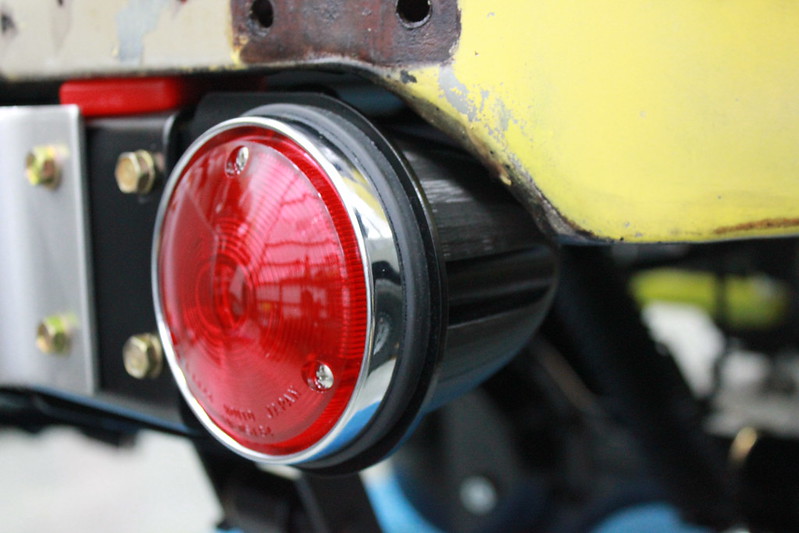

Thanks to @red66toy I was able to get a set of rear tail light cone covers from another cruiser guy that did some repops. Nicely finishes off the backside of the taillights.

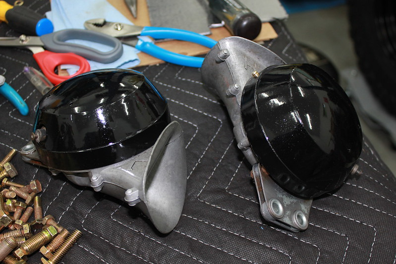

Almost finished refreshing my elephant horns. Had to make a couple gaskets, cleared the bodies after bead blasting and painted the plastic covers. Final touch is to add the repop aluminum label tags to them.

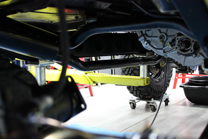

...and attempted to install the exhaust which is a NOS down pipe and new OEM muffler. For some reason the down pipe is too low...almost like the damn thing was bent wrong by Toyota. It needs to be 'up' about 2-3" for the stock skid plate to bolt up.
Am I doing something wrong here or is this just s***ty luck? Considering my options to either have an entire new down pipe bent of cut this one...??
Also finished up most of the wiring and brake lines...
