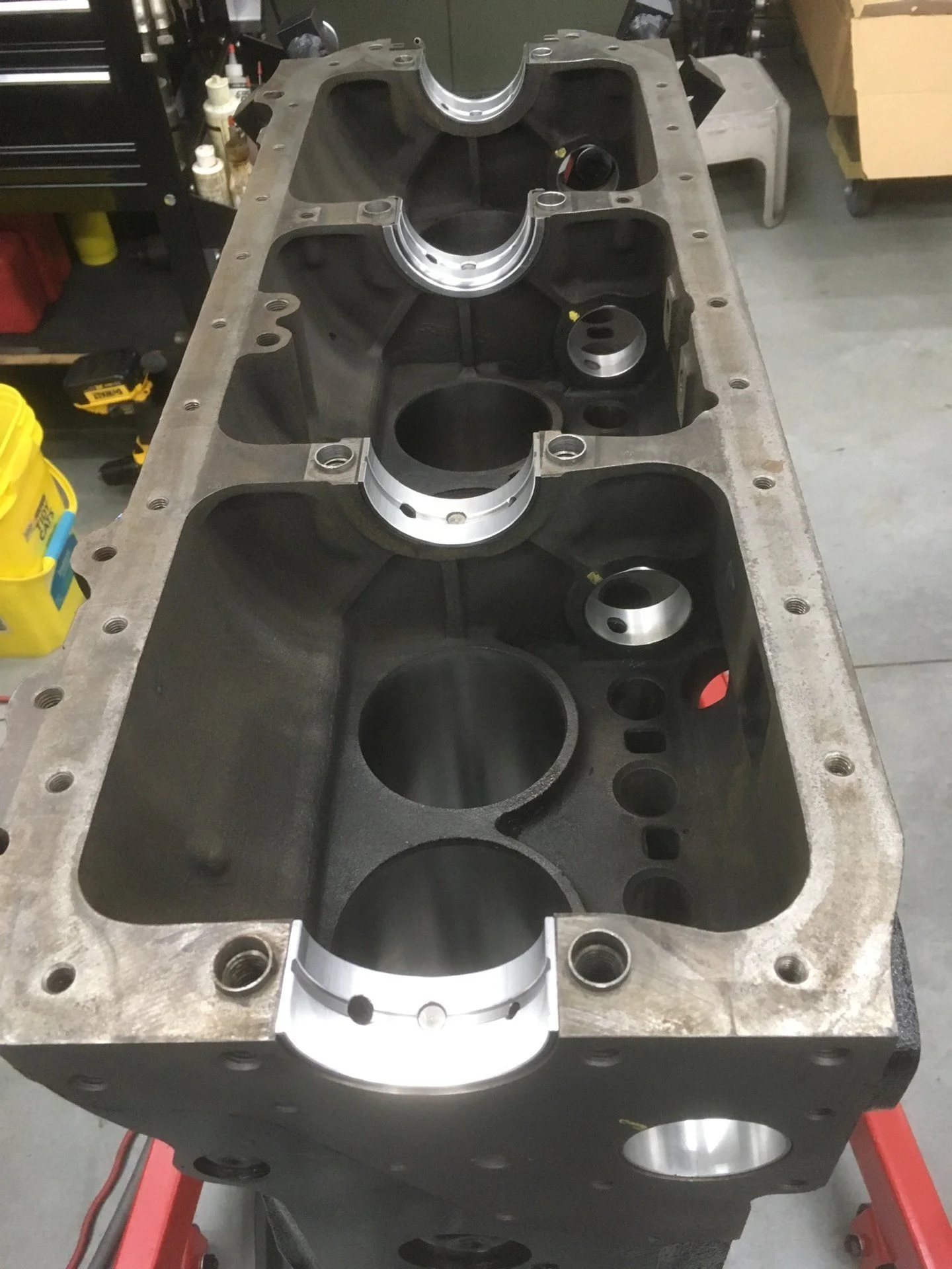

Started on the block. First up was getting me a clean and orderly work area setup with all my bearings, pistons, rings, etc.

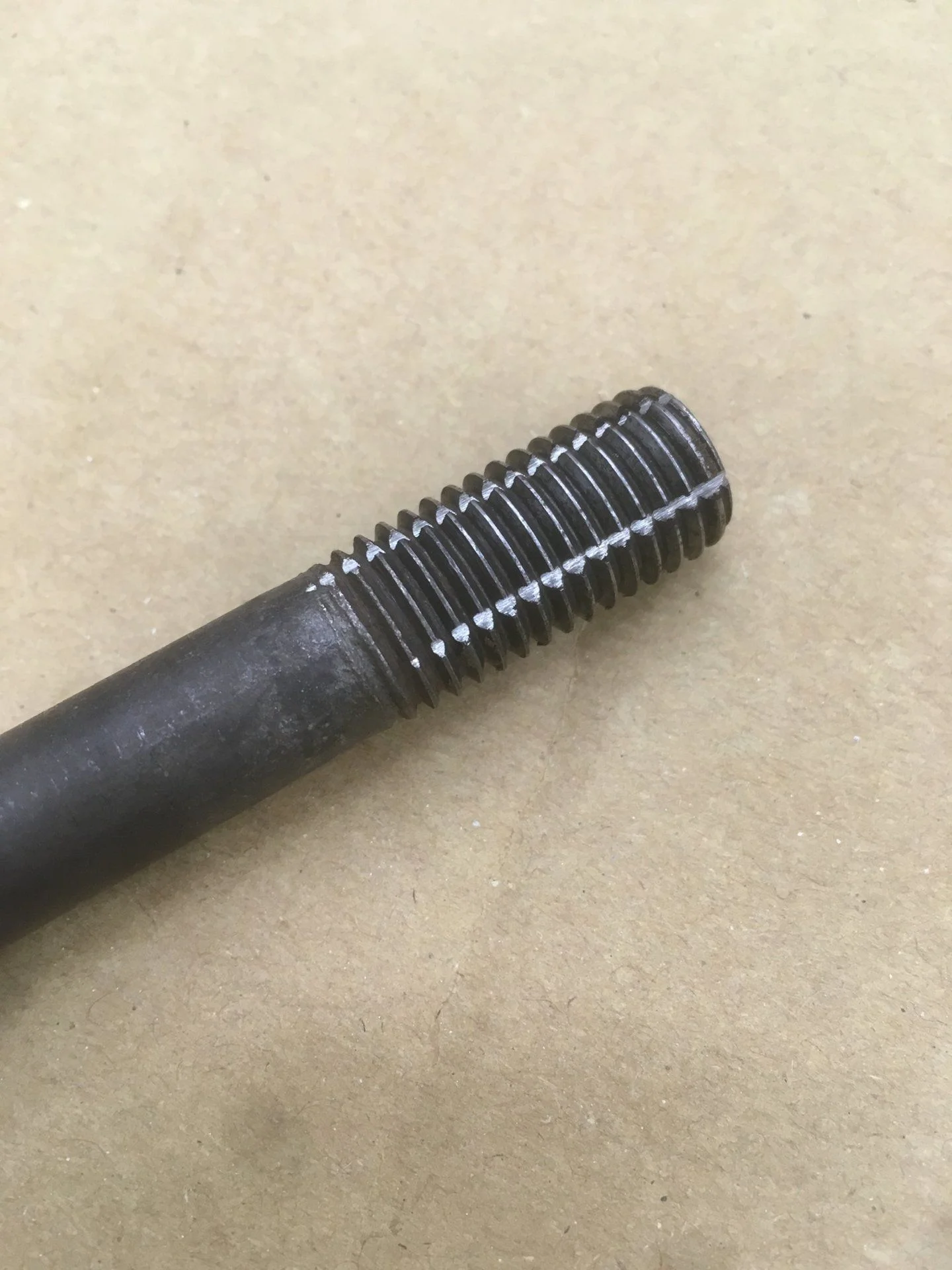

Then I decided to go ahead and chase the head bolt threads. I had previously purchased a m13x1.75 tap but it didn’t want to start ina way that felt normal...so instead of doing something stupid and forcing it I made my own thread chaser. Took an spare head bolt, cut 4 ‘slots’ out of the threads with a dremel cutoff wheel and used it. Ended up working great.
Then got the block side main bearings popped in. The rest will have to wait until tomorrow / the weekend...time to grill some steaks for vday dinner.

I also use a hand-fluted head bolt to chase the holes in the block. Flute provided by my Chinese cousin: Lo Tec.

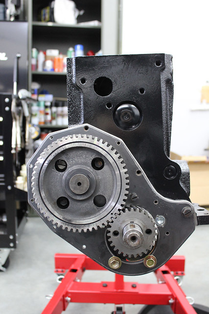

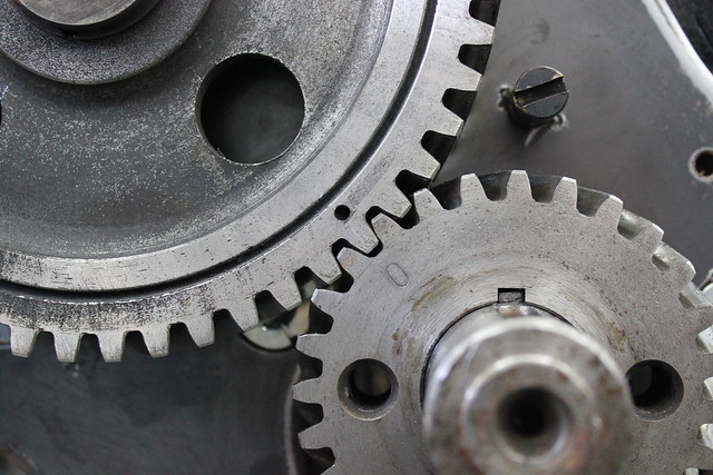

Cleaned up the timing plate, installed it’s oem gasket and added some very light Permatex to the back side, being careful to not obstruct the oil squirter pathway.
Mounted the plate with oem torx Screws vs the flat head style and staked them once tightened. Installed the oil squirter BEFORE mounting the plate to be sure it was not protruding past the backside.
Installed cam gear and aligned timing marks. Fine tuned the oil squirter point direction (pic below is before readjusting) then staked it too. Tightened down cam thrust plate per FSM torque (15lbs) - added blue thread locker to the bolts just in case.

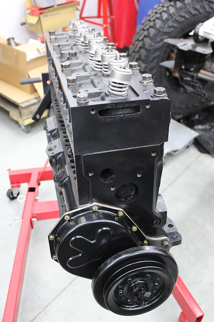

Rummaged through my 10k newly plated bolts to find the appropriate length hardware. Installed timing cover crank oil seal and verified the mounting side of the cover was flat ‘enough’. Installed keyway in the crank shaft and oil slinger on the crank, verifying it did not contact the cam gear.
Installed oem cork gasket and timing cover, attaching it loosely then banging on the crank pulley. Once the pulley was on (still not sure if it’s on far enough) then tightened down cover, adding blue thread locker to all the bolts minus the ones that are pass throughs to the lower end. Used Permatex high temp thread sealant on the ones that see oil.
Then worked on installing the head. The F135 doesn’t seem to use the head dowel locator sleeves like the F and 2Fs...so I cut the heads off a couple old head bolts. Placed the oem gasket orientated the correct way and gently (as gently as I could) dropped down the head. After oiling the threads of the head bolts, tightened them down per the FSM (in graduated torque increments).

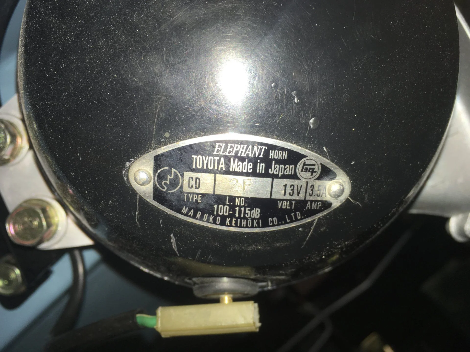

Couple pages back I shared pics of my elephant horns. The bodies are in decent shape and even the plastic covers ended up being decent enough after blasting...but the ‘tags’ were long gone. There was at least two layers of paint over the label and citri strip removed what may have been left underneath.
So after help from @wngrog for an image and @SMG for adobe illustrator magic, I ordered a metal print from bayphoto. Print arrived today and they look pretty good! Especially for the cost...23bucs shipped! The image is more clear then the photo shows as it was tough to get a pic with my phone from the metal glare.
I should be able to get at least 10 pairs out of these as a few images printed off page and the left side line might be too close to the edge to get the correct end portion where one of the mounting holes is located.
Getting these cut, routed and drilled so their ready to mount is a project a bit down my list but will hopefully happen in the next couple months!

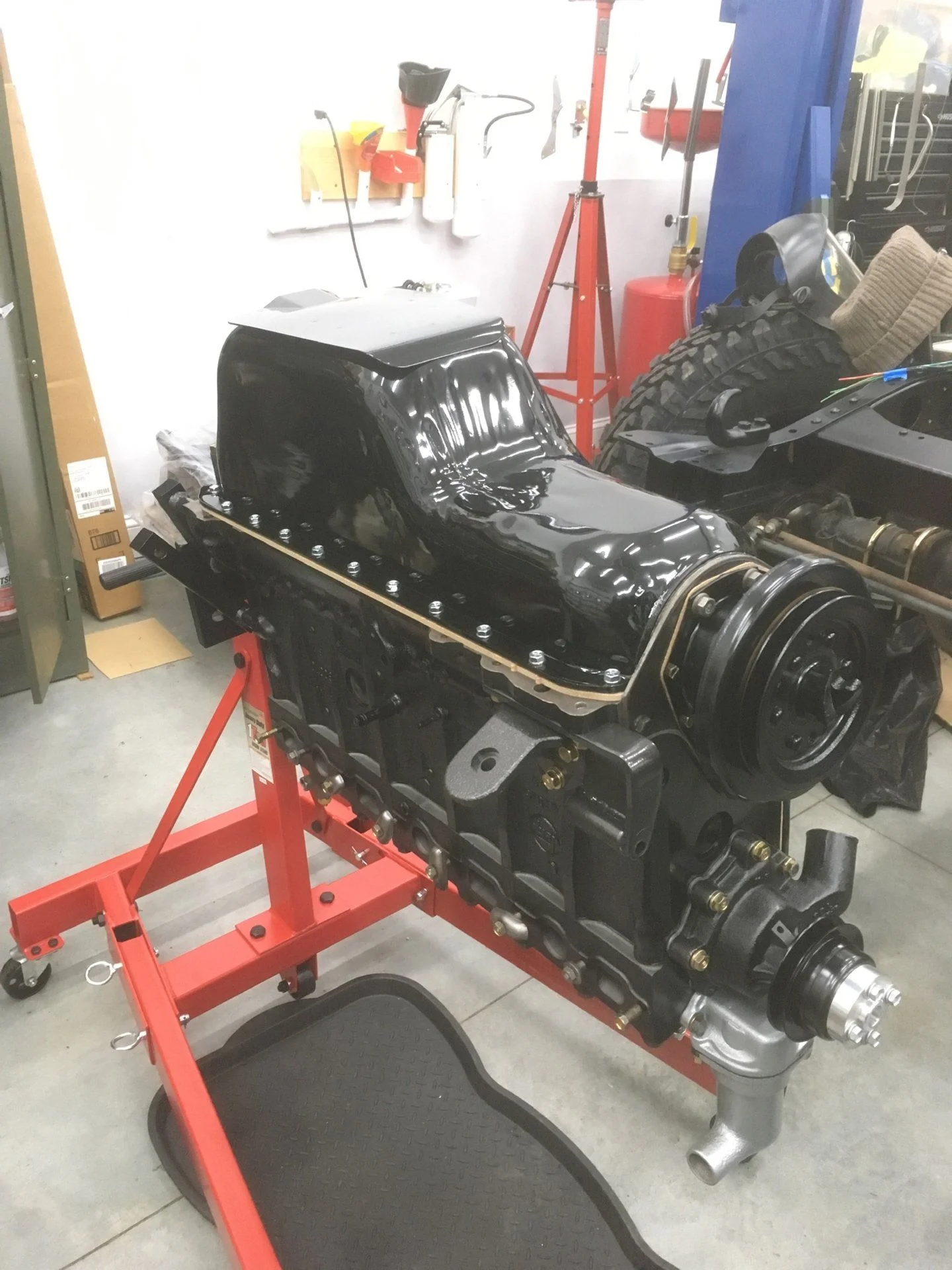

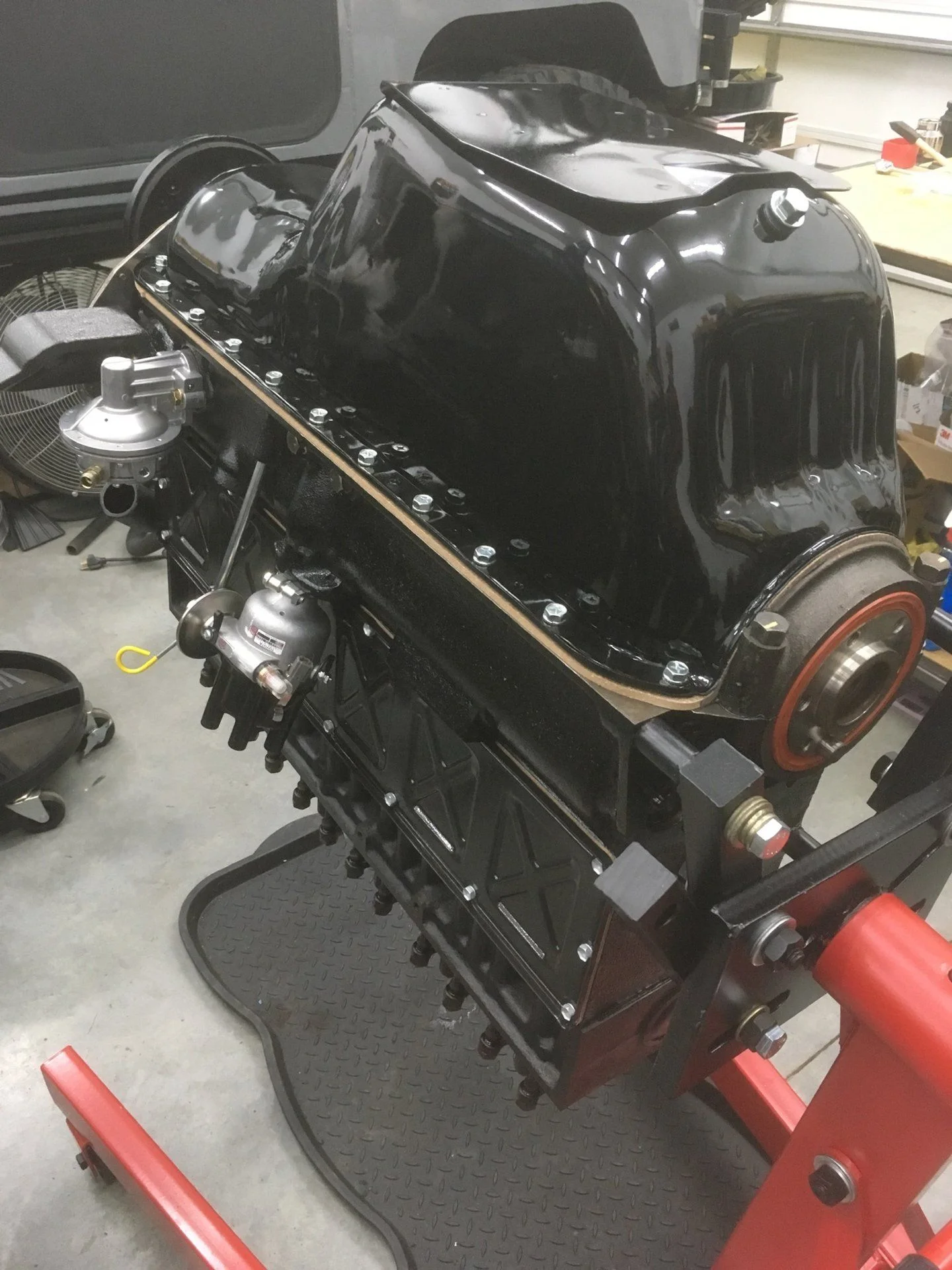

Weather finally cooperated today (9 days for rain) to paint the oil pan. While waiting for it to dry I got the lifters, pushrods, rockers, oil tub, fuel pump and then side cover installed and torqued down. Also got the thermostat and housing installed.
After a couple hours sitting in front of the heater, the oil pan was dry so got that installed and torqued.
Tomorrow I hope to get the oil fill tube installed, then cam plug. Maybe even the bellhousing/motor mounts and stabbthis in b/w the frame rails!

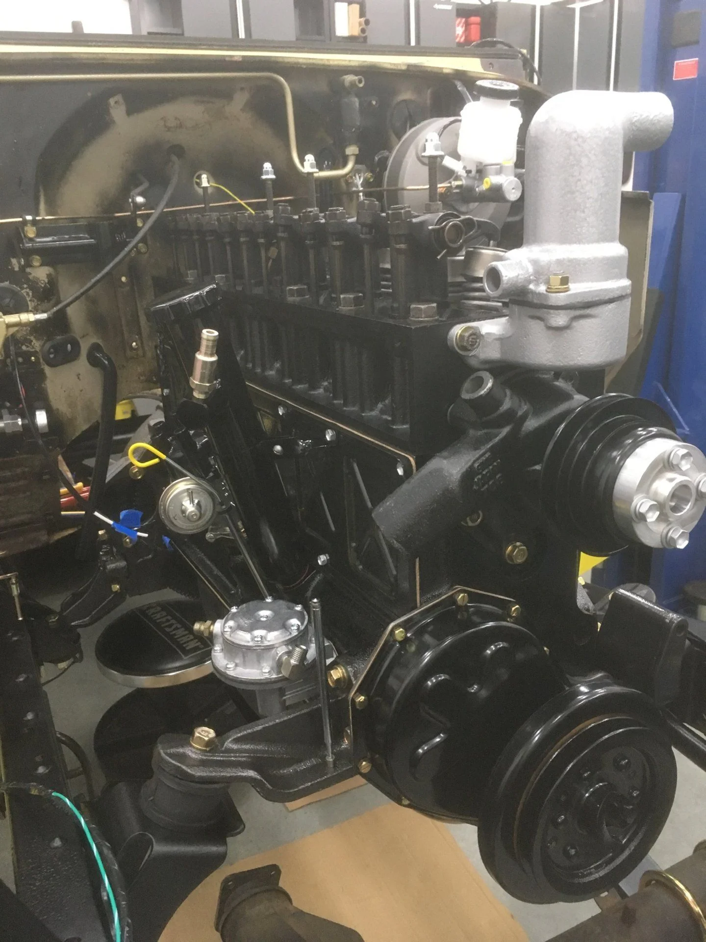

Stabbed the engine in this evening and got the pilot bearing and flywheel installed. Always be sure to pre-fit the pilot bearing onto the transmission input shaft...mine required significant sanding with an emory cloth. Probably since the previous pilot bearing was separated into two peices and a pile of balls with the inner race almost welded to the input snout.

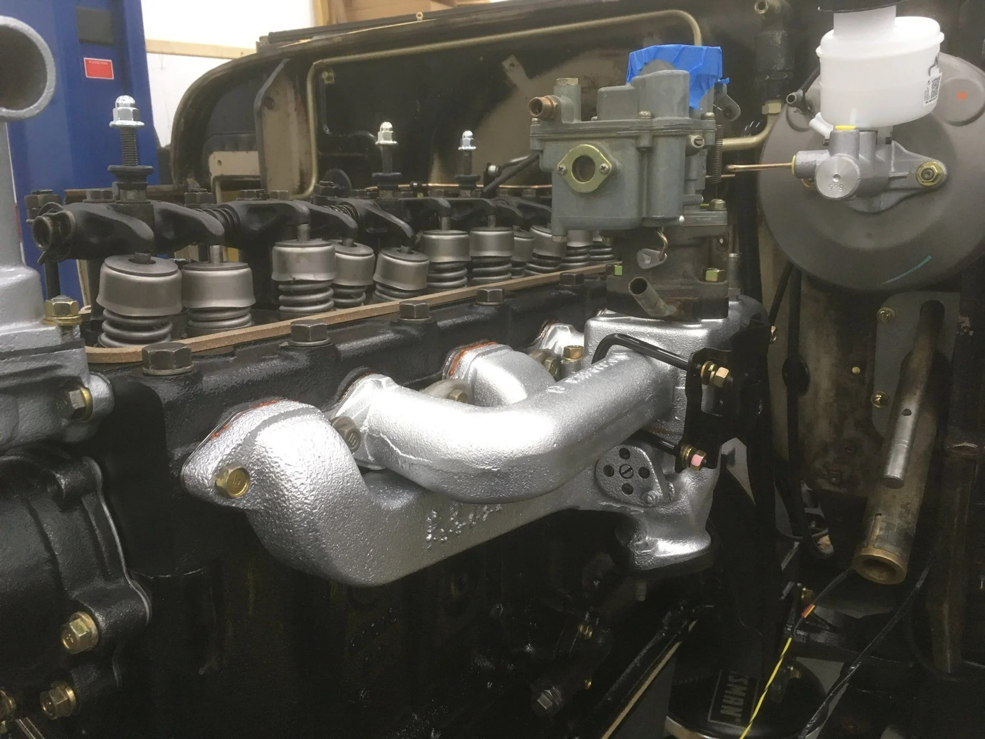

Chugging along but damn, sometimes it takes way longer then I anticipated to do some small task. Queue installing the intake/exhaust manifolds...required making a new gasket (spending 20 mins finding the sheet of gasket material), chasing threads (10 mins finding the m10x1.5 bolts), getting parts of the oil filter mount installed (finding and unwrapping them from my boxes of painted parts), some Permatex copper gasket maker...and bam done!
1919013

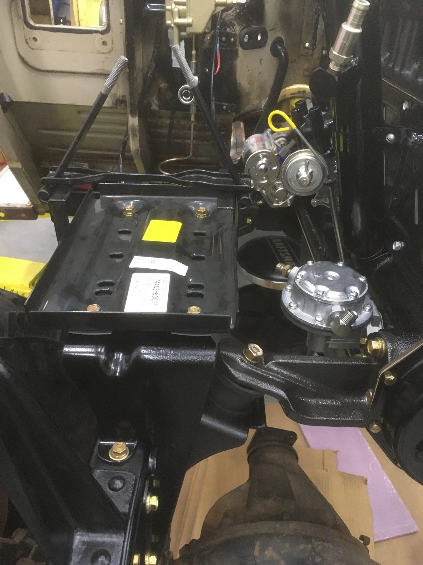

Also got the battery pedestal installed with a new tray and hold down. Then mounted a Toyota refurb gear reduction starter.
1919014
1919015

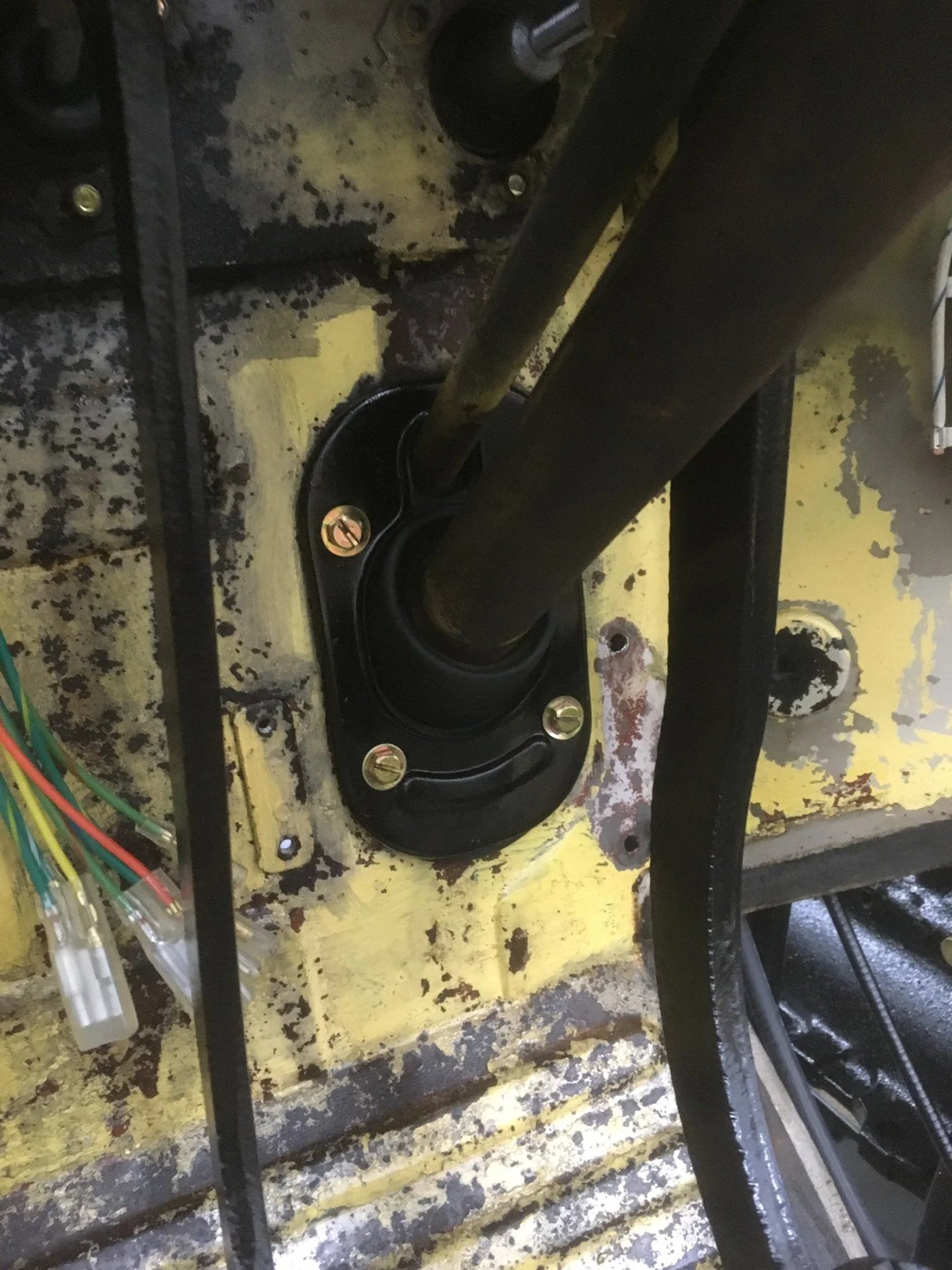

I’ve been procrastinating on assembling the steering and decided to dive into it today. Unfortunately the ujoints I ordered a while back were not the correct size :bang:. Small setback but still had other stuff I could work on.
At some point a PO installed one of Downey’s manual Saginaw steering kits (#oldschool). Same premise as the usual Saginaw power steering but with a manual box. I considered doing power steering but that requires making a custom mount for the pump as the F135 doesn’t have the same threaded holes in the block as the F and 2Fs.
Most of the install was done well, so my plan is to just redo it to new. Already rebuilt the manual Saginaw box and installed an new pillow block that supports a portion of the linkage. The other linkage is waiting on the new ujoints mentioned above. Seems straightforward, right?
As part of the conversion that was done, the stock steering pedestal was removed. The pedestal provided the support for the steering column and the kit included an attempt to replace this support with a bracket and ubolt attached to the column at the interior firewall. Since I’m keeping the 3 on the tree vs going floor shift, I wanted to figure out a better support solution.
I’m using one of the Cruiser Outfitters firewall plates, attaching it to the engine bay side of the firewall (keeping the interior side looking tidy), cutting a pass through for the column shifter and will ultimately weld the column to the plate. Should provide a more solid support and hopefully not introduce slop into the shifting.
Got the plate drilled and ground to fit the firewall flat. Still need to clearance the column shifter hole and then weld.
