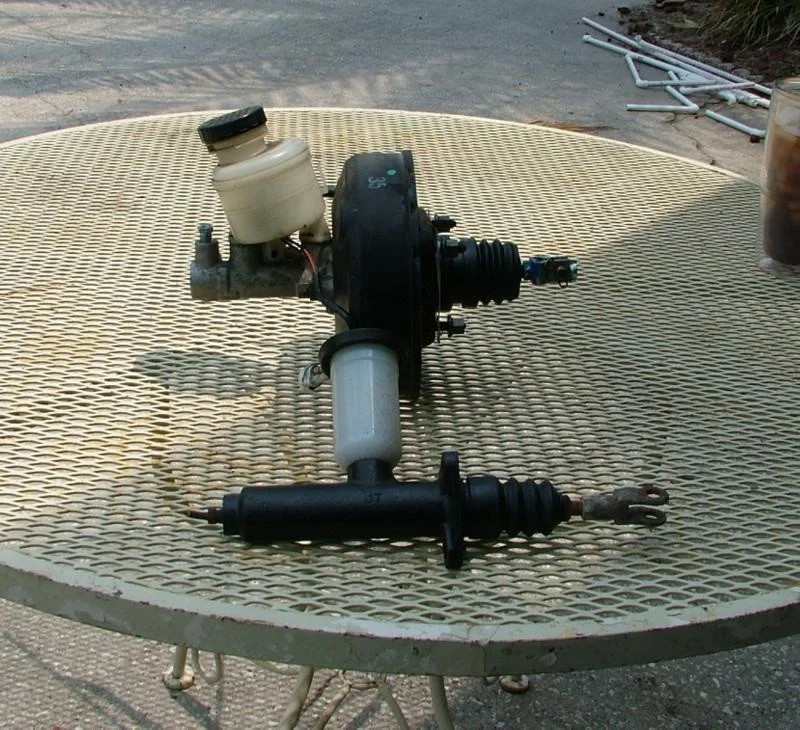

The booster and master from a geo metro is pretty small. I measured mine and scoped it out and with an adapter it would fit but was to close to the carb for comfort, so I ended up cutting the rib on the firewall.

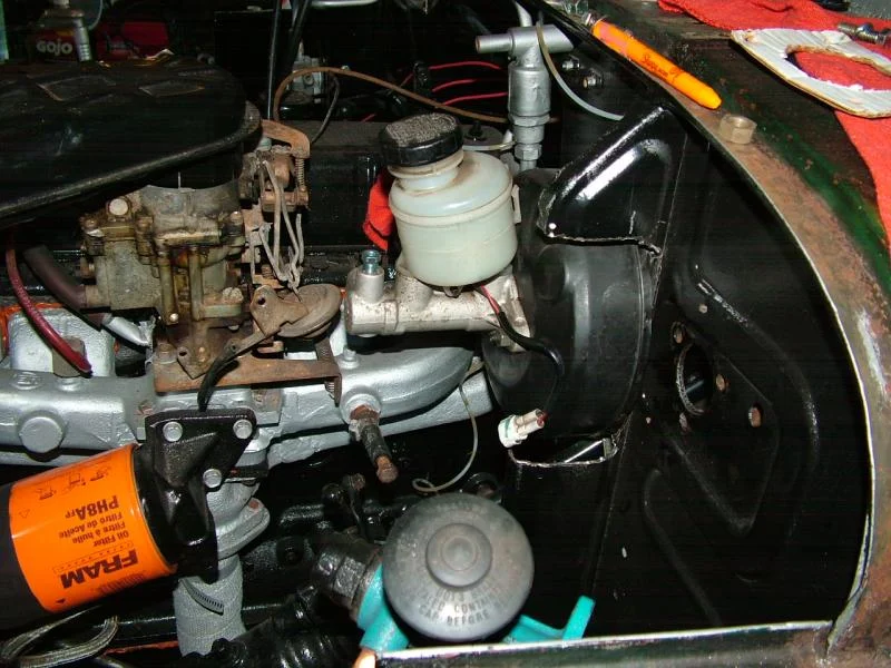

Here it was if I used an adapter, it actually would stick further out with an adapter, if the engine twisted a little under torque I felt it could hit the master. The geo metro has an outlet on the top and side for the front brakes so I could have had the line come out the top, but it was still to close for my comfort level.

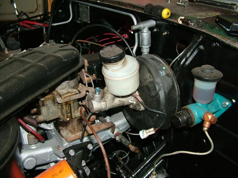

I ended up cutting the firewall rib for comfort level, I wish I had done it while I had the body off, someone had recommended doing it right after I painted it, but no plans at that time to do disc fronts.

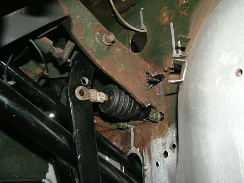

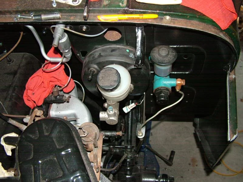

My biggest problem was I had to drill new holes through the firewall and I hit the support on the backside for the steering/brake brackets, and as you know on these older ones it is welded in and not removable. Wish I had a plasma cutter, but after a lot of work I got it bolted in. That steel behind the firewall is so thick and solid not sure that the rib on the other side does. If I had just rotated it a little or maybe made a real short adapter to convert the bolt pattern life would have been easier.
attachment.php
I have driven it around the block a few times without the vacuum and brakes worked real good, have 1977 axles all the way around, 1962 fj40, 1971 engine and drivetrain. I will hook up the vacuum but still have a lot of work to do. Was able to adjust and use the existing push rod, in the end worked out well.
