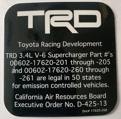

TRD (aka Magnuson) already did the heavy lifting on the Cali EO Cert. All that groundwork can be used for this product. If this supercharger had an EO, it would not only play nice with Cali smog laws, but also alleviate any future liability the manufacturer holds for violating the EPA Clean Air act - which has not statute of limitations and covers all 50 states. Food for thought.

I would think a CA smog tech would look at the part number and know it’s been modified.
yeah, I wonder about that, they are very strict here.....

”Technically”, not legal unless approved. One can Google the original EO# to read the description on CARB’s PDF regarding the component and install description an inspector would use. Google images and such would likely out you. Time will tell on how the final product looks.
