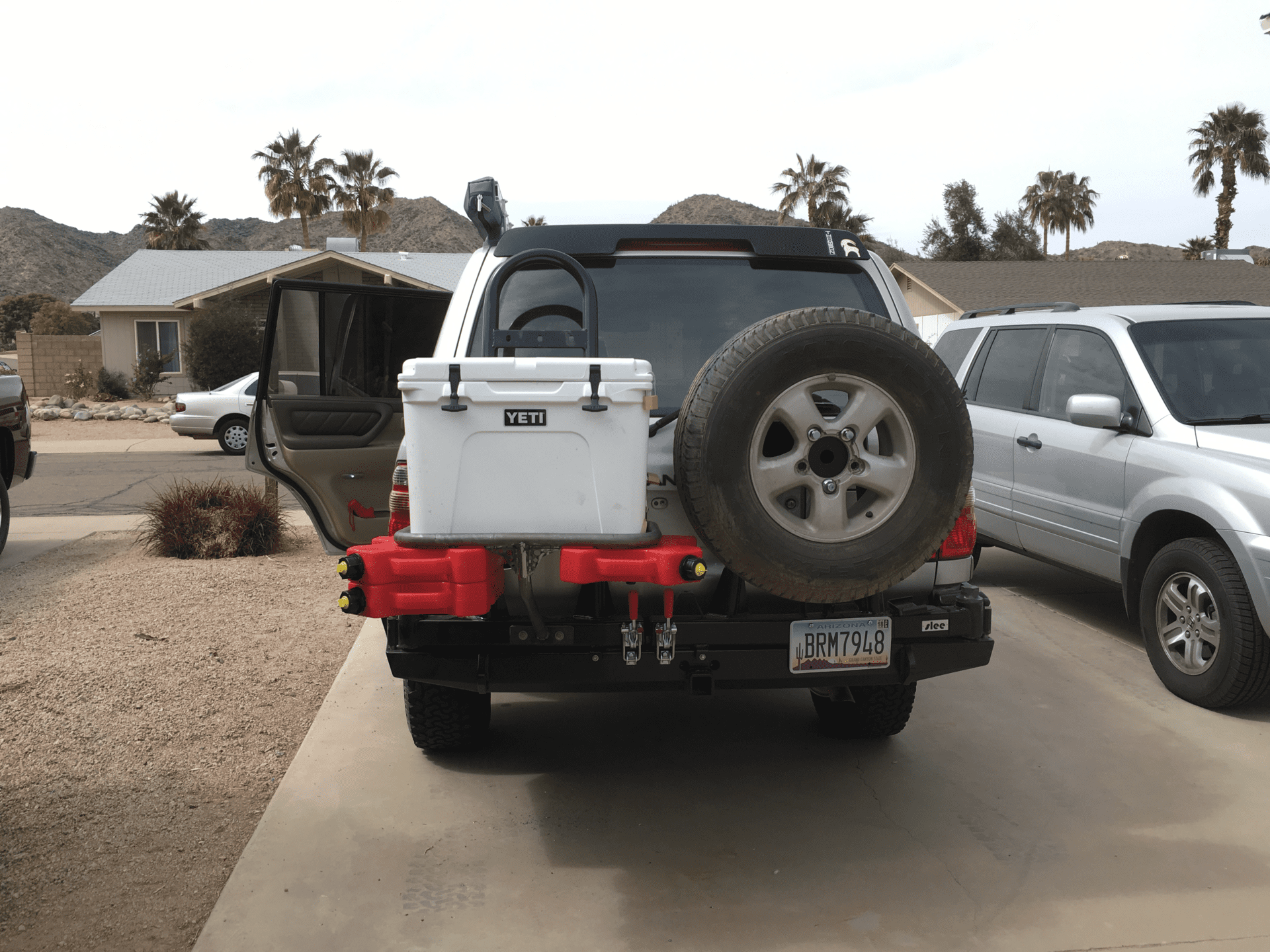

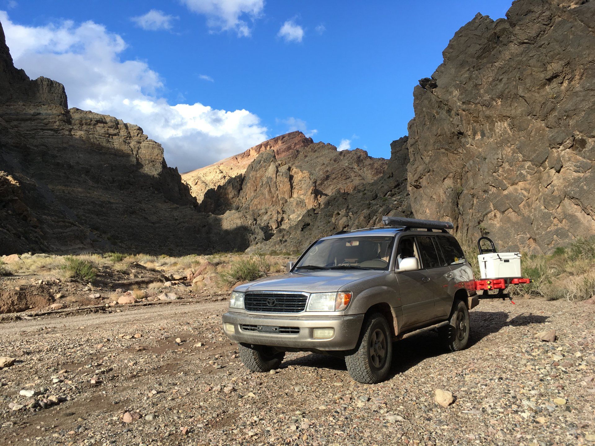

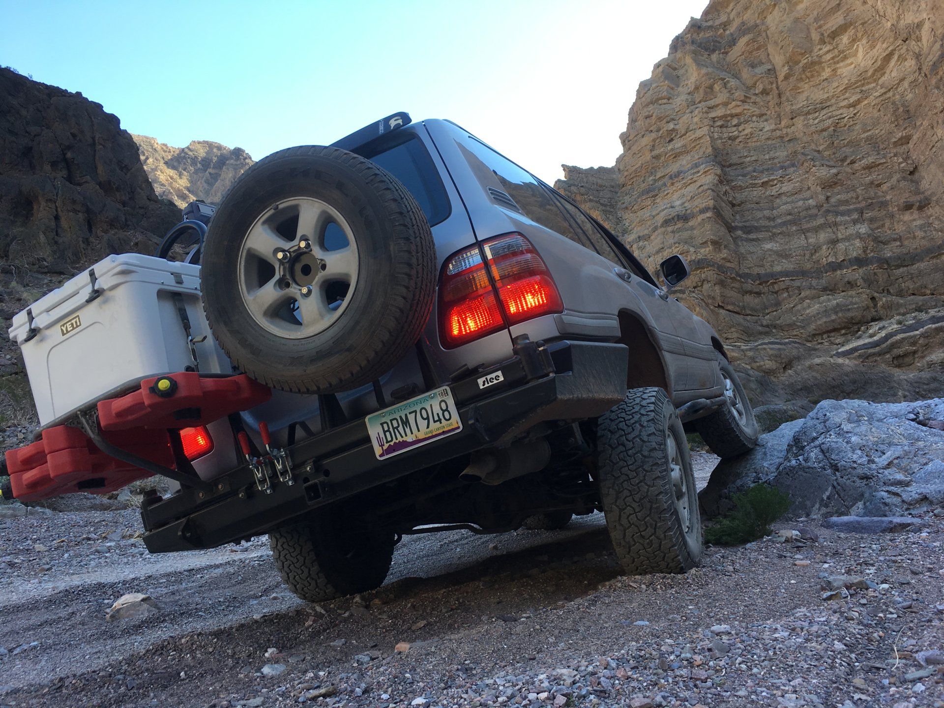

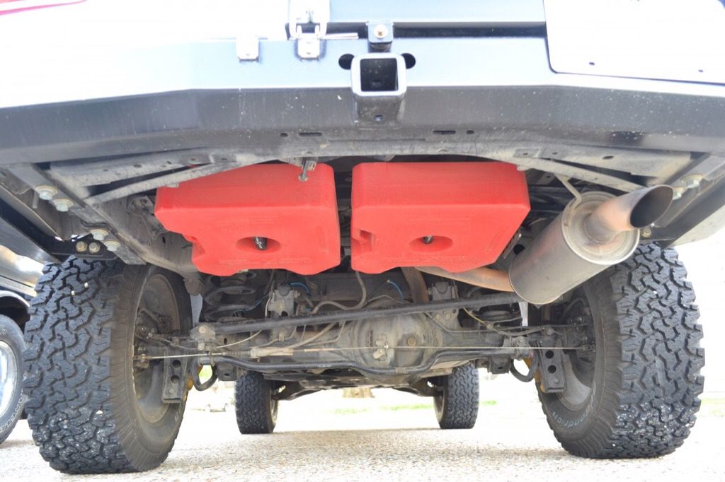

Might be the camera angle but it looks like the two outer gas cans would easily get lopped off on a tight trail. Plus, it blocks your tail light. If sticking with Rotopax's, I'd probably opt to mount it on the spare tire with the spout on top.
Below might be okay too...
Yeah, my location isn’t ideal for tight areas, but for this trip it worked ok. The 1gal pax fit in the space perfectly, and ultimately I’d like to have the 1gal water pax mounted there and the 2gal fuel somewhere else, spare tire probably.
They do not block enough of the brake light to be a concern though, the angle of the photo is a bit decieving.
