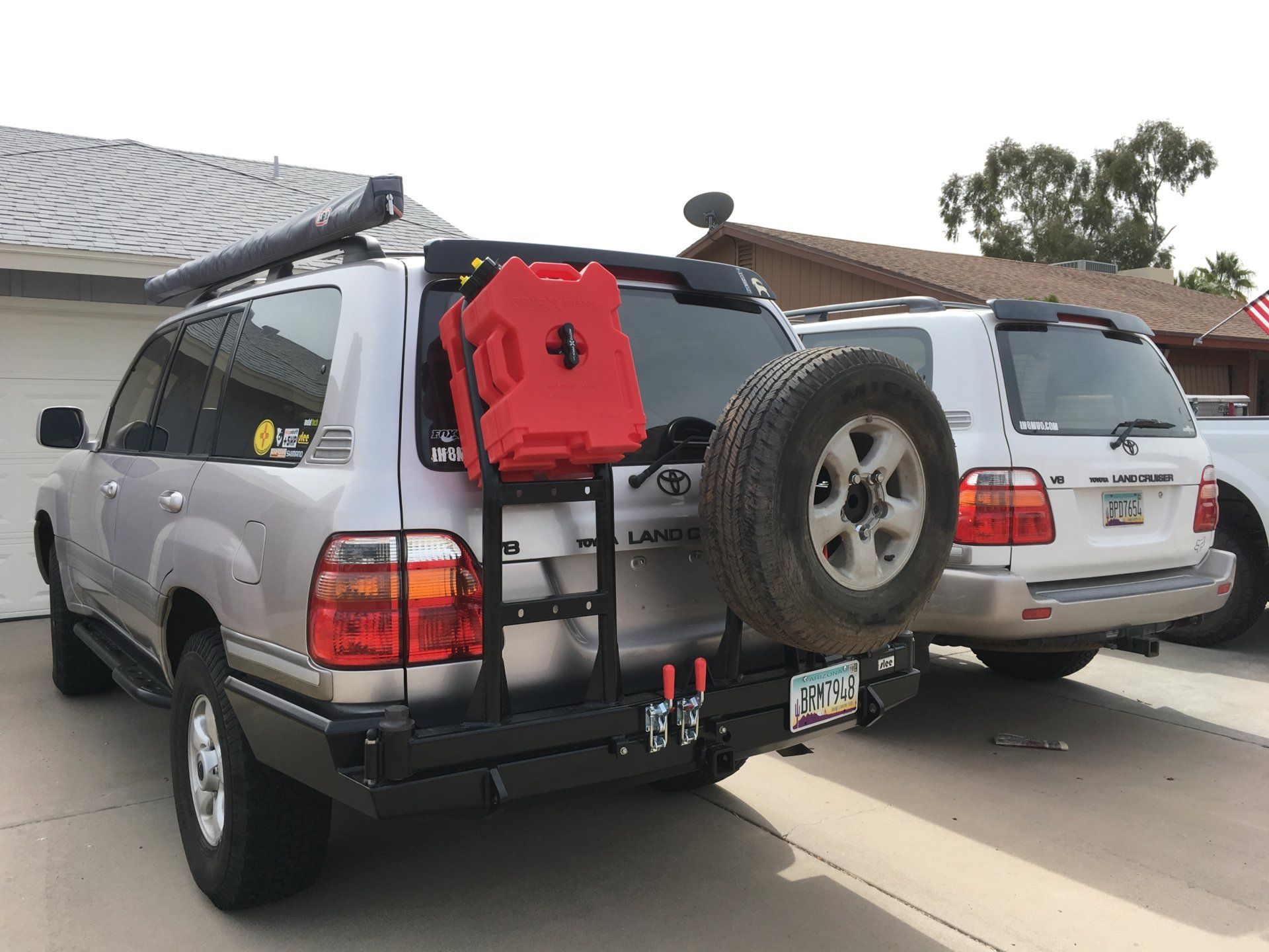

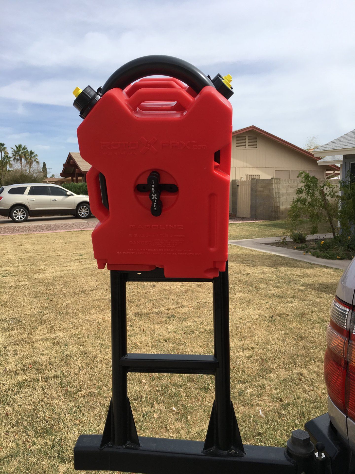

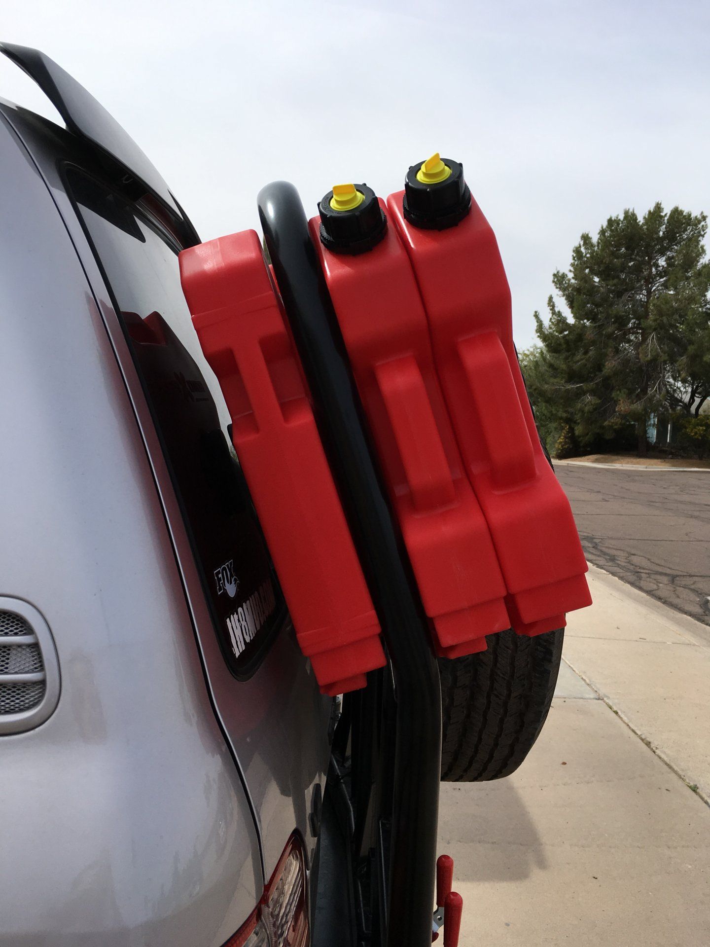

I mounted some rotopax for our upcoming trip to death valley, only 6gal, but it is better than nothing. The pack on the inside of the ladder is really close to the glass, so we will see how this pans out... I am going to put some sticky backed rubber on there to help lessen the blow in the event it rattles into itself. If anyone is interested, I can take pictures of the mounts. I basically opened up the two small holes, for 1/4 - 20 X 2" grade 8 bolts, made 1 5/8" standoffs out of some aluminum tube, and bolted them around the ladder rung.

View attachment 1653146 View attachment 1653147 View attachment 1653148
The inside tank officially hit’s the glass over bumpy sections. Have a few ideas to remedy, will report back

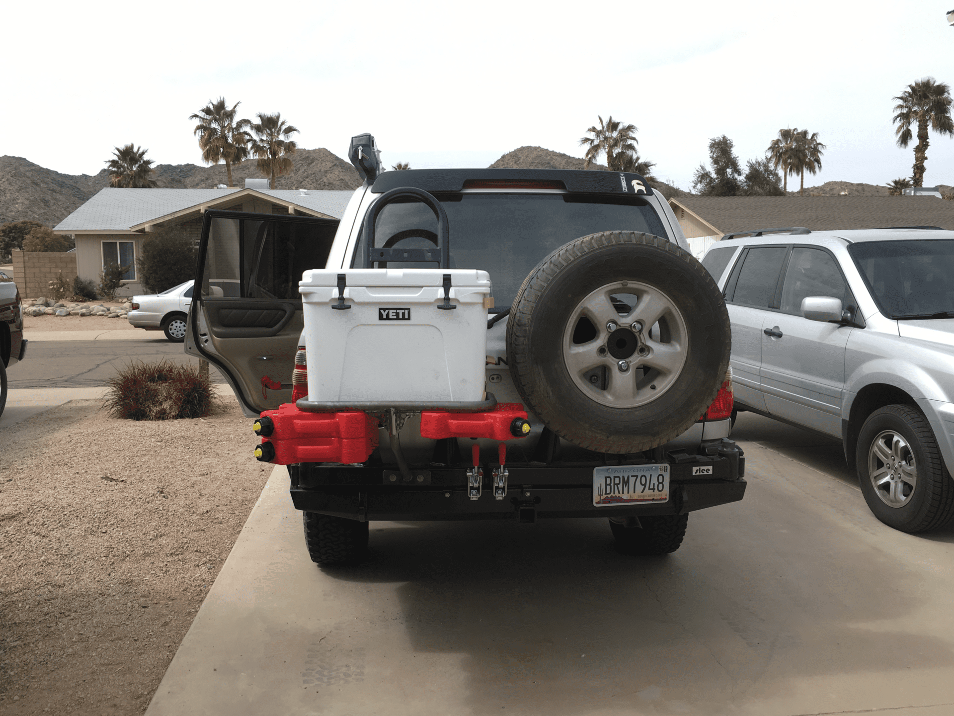

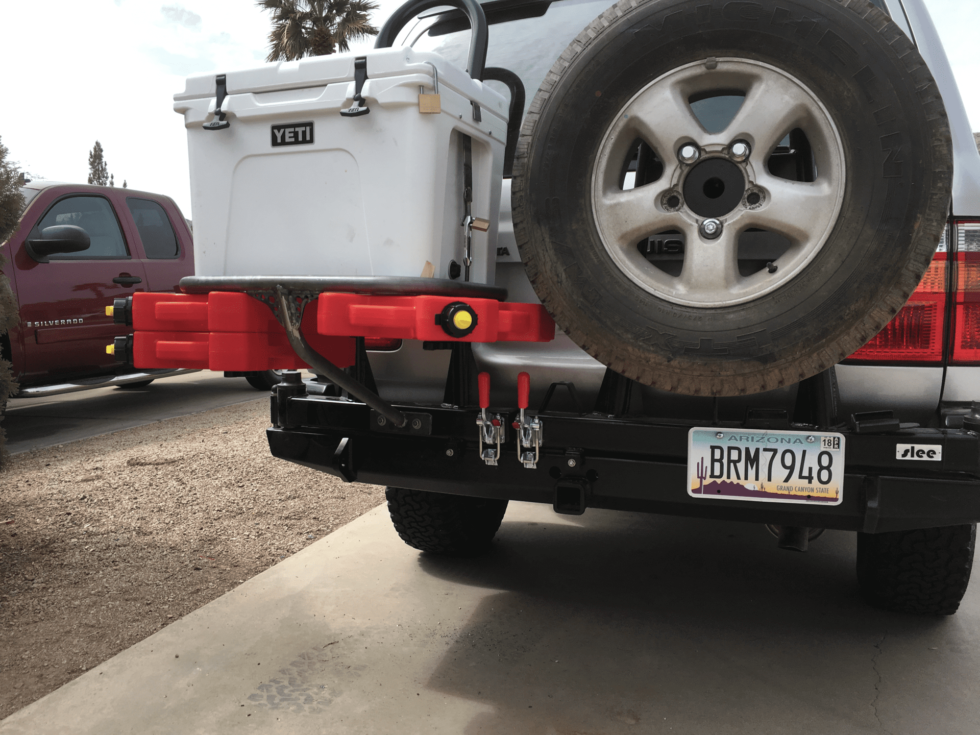

Progress... @ikarus what chu think? Still need to install rivnuts in the swingout for the lower mount and get the hold downs installed. I bent some 1.25 X 1/8" steel that will mount through the cooler, will weld some all thread to is and use a nut to keep the cooler locked down, will be able to mount a small padlock through the all thread
I think it's looking great. How's it going to be held on?
Here is what I'm currently working on.... I am thinking I'll put a peice of tubing over one of the turnbuckles with a lock through a hole in the flat bar to keep the turnbuckle covered, should do a decent job of securing it.

Thanks! I’m pretty happy with it so far. I think the tie down method needs some work, I’d like to use a toggle clamp, we’ll see.
Do you have any CAD software? I have a fusion360 model I can send you. I’d even be willing to bend up the tubes for you if you don’t have a bender :)
That's a good idea. Don't know if you've used those Rotopax before but they really swell up in the hot sun / weather.
First time with the rotopax, one of them is already leaking...
I use 3, 3 gallon ones flat on the roof. I had some leaking, however I made a fix. I put some 220 sandpaper on a flat hard sanding block and flattened the threaded face where the gasket makes contact. This provided a better sealing surface with less cap force. I also burp them as the temps move up. I pay close attention to them for the 1st hour after I fill them and put them on the roof. Good Luck.....
Might be the camera angle but it looks like the two outer gas cans would easily get lopped off on a tight trail. Plus, it blocks your tail light. If sticking with Rotopax's, I'd probably opt to mount it on the spare tire with the spout on top.
