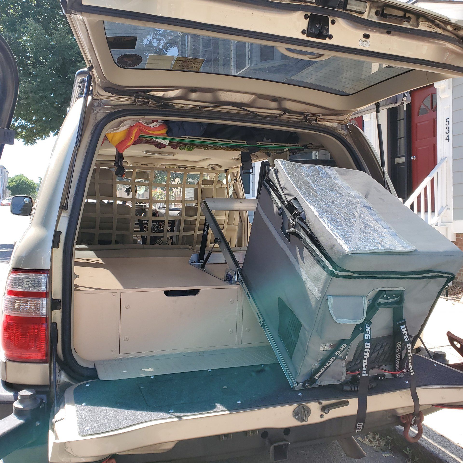

I don't really think that just tying down a fridge without it being on a slide is going to be effective when using the Reef (KISS) drawers, there just isn't enough room to open it and get in there without it being a giant PITA (IMHO). Honestly I think it's dicey with anything other than a tilt or drop down slide, especially on a lifted truck, but then again I'm under 6'. I used a DFG Offroad slide and really like it, it's screwed right into the top of the drawers.

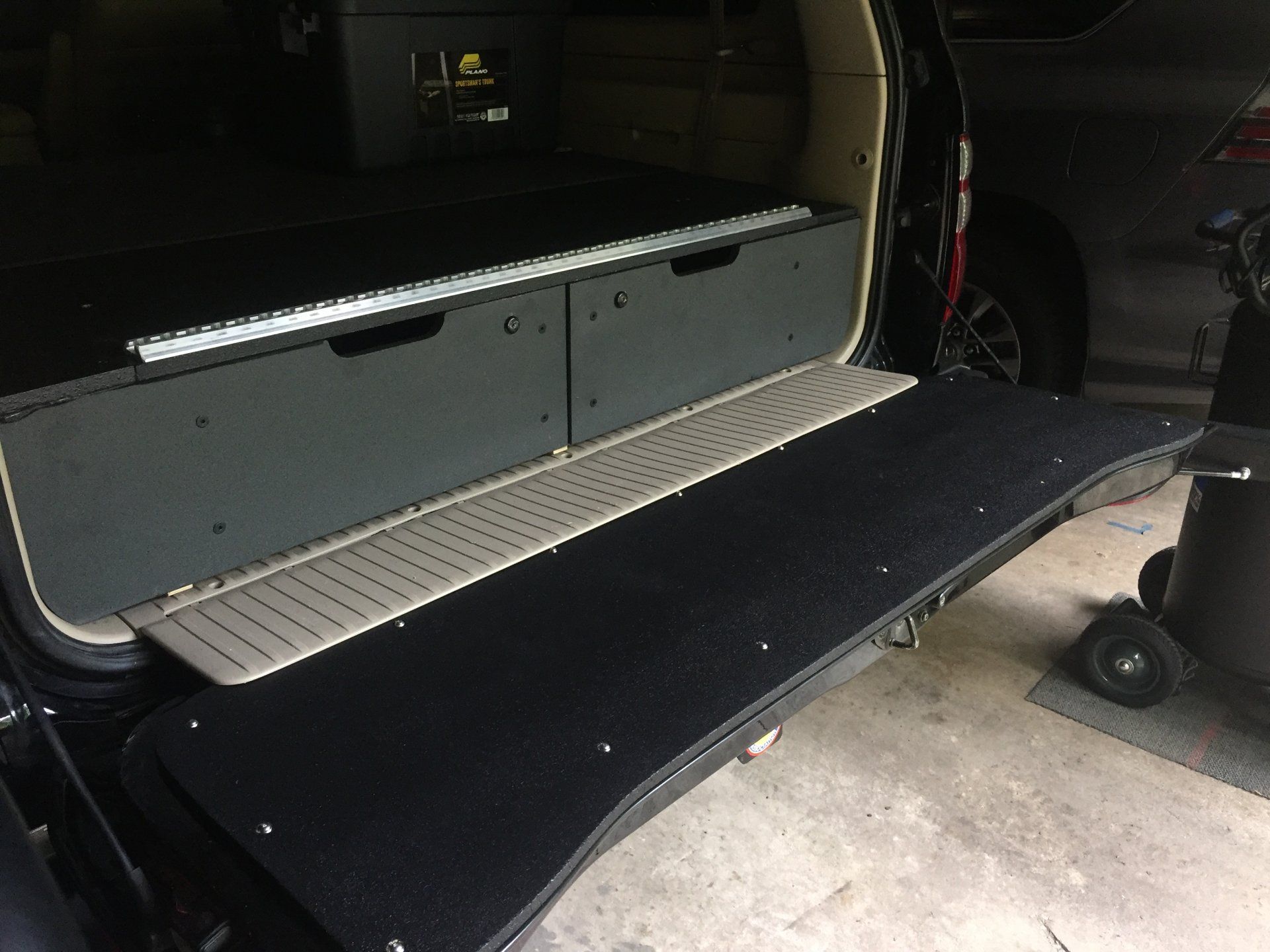

I used some beveled aircraft seat track on both ends of the top deck. Bolted down with 1/4- 20 Stainless Threaded Inserts and 1/4-20 Socket head cap screws.

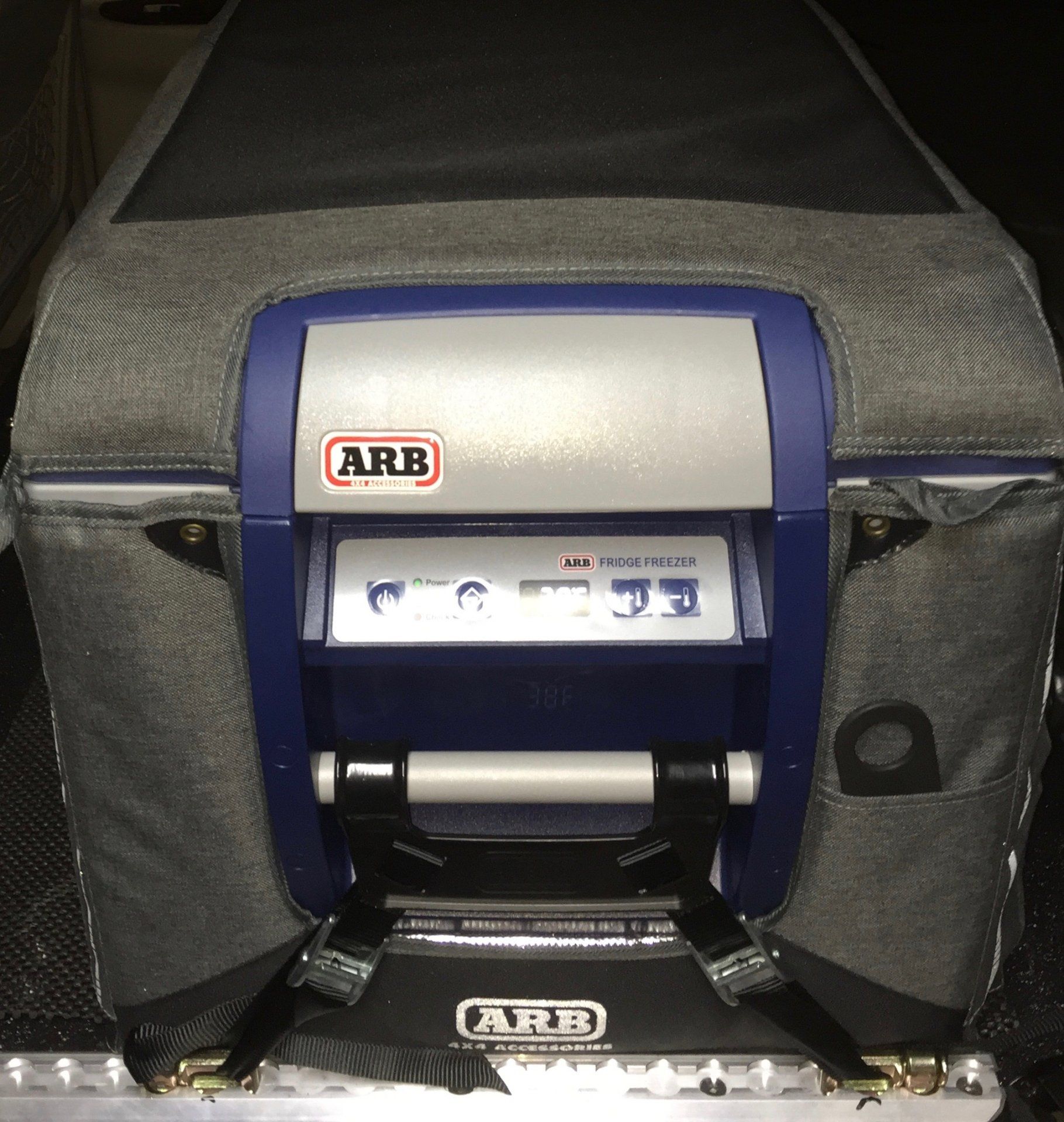

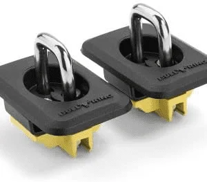

I have used Bull Ring retracting tie down rings. They are often used in truck bed rails - look like this and the hoop drops flush.

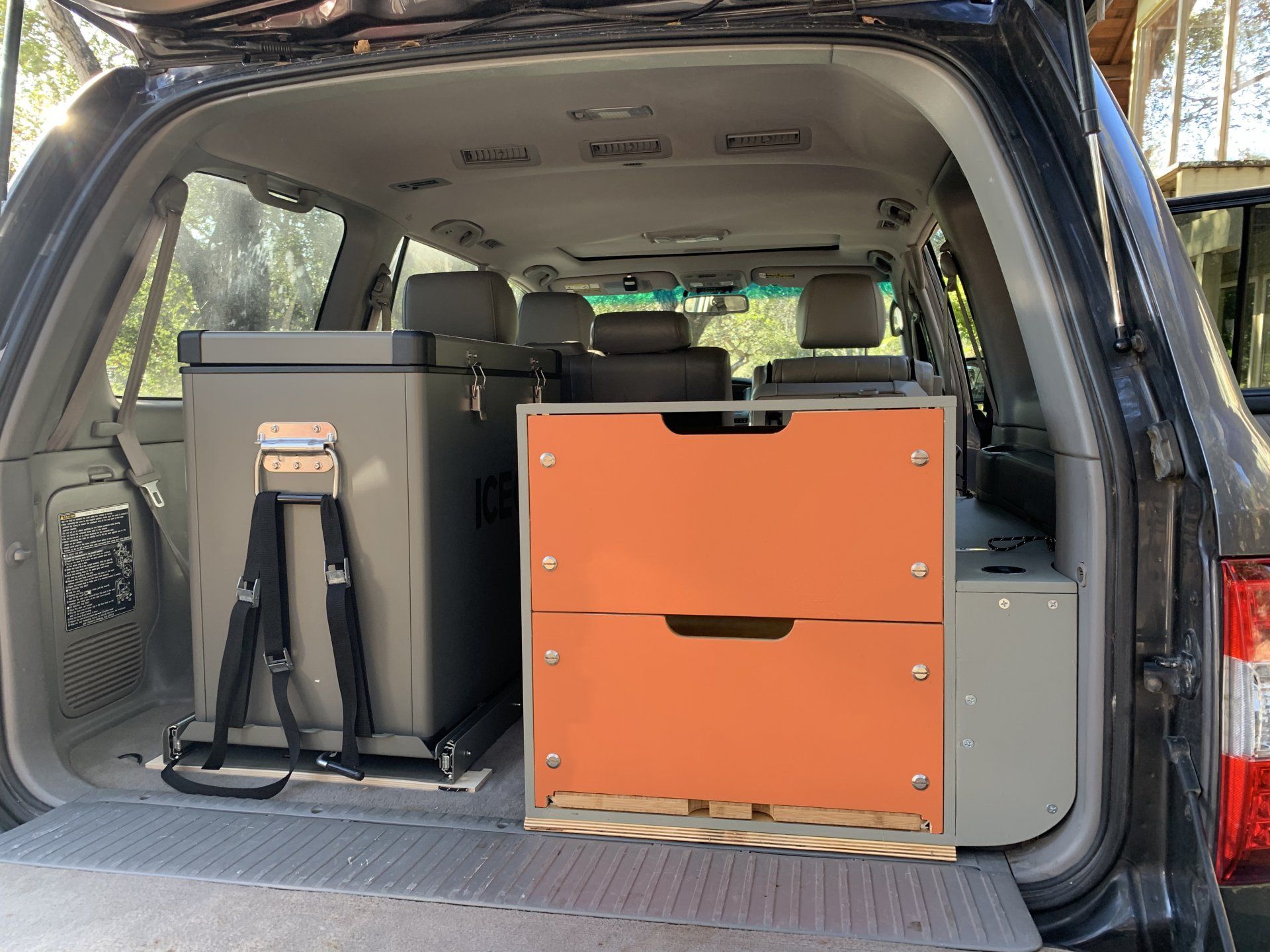

Fridge slide looks great, but we will be sleeping back there often so I don't know if i want to be removing the fridge slide hardware. Thus far I am able to reach in just fine from the rear when I set the fridge horizontally. It's a bit of beast to move but for now ok. We need to take the fridge out for sleeping inside.

Quick clip - rings allow for using ratchet straps or carabiner tie downs to hold boxes or large items. My 63qt Fridge normally lives in the second row, but will fit between the channel and strap in. I use a square woven cargo net over the top of the gear on top of the deck (in addition to the boxes being tied down strapped). Its a solid set up for highway and offroad travel.
View attachment 2477292View attachment 2477309
I like this set up, seems to offer good flexibility and ability to tie down multiple items.

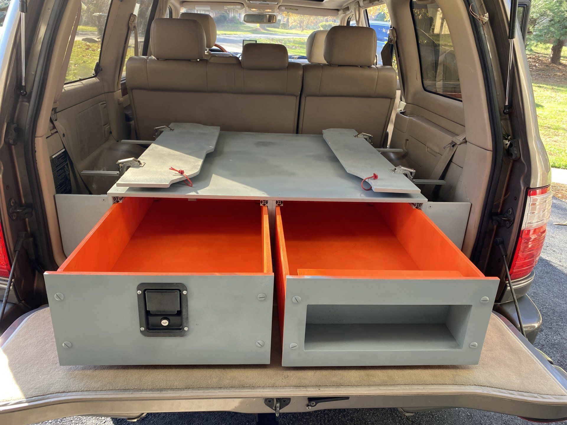

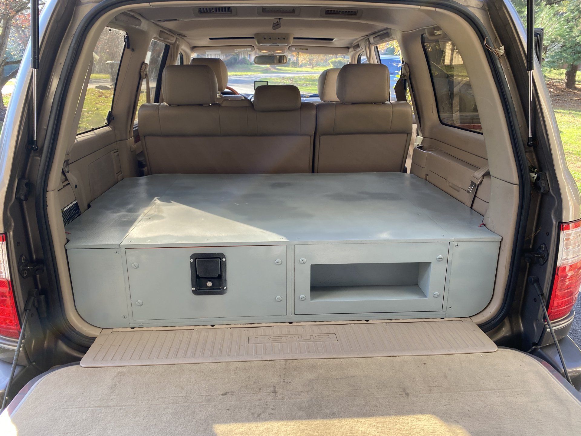

First time post here, placed order in Reef KISS drawer on my 2000 lx470 from land shark outfitters and waited 5 weeks. Installation is smooth and really like the drawers.
Daaaaaang that is SHARP! Love the orange, I've always been a fan of bright interiors for ease of finding stuff.
