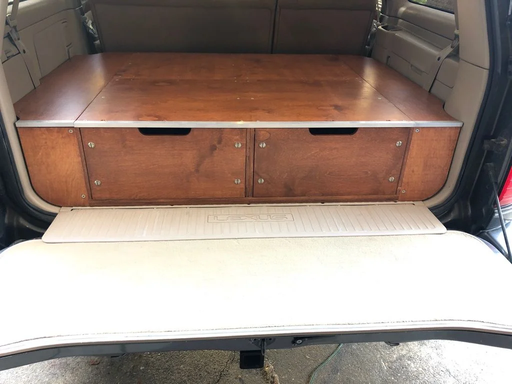

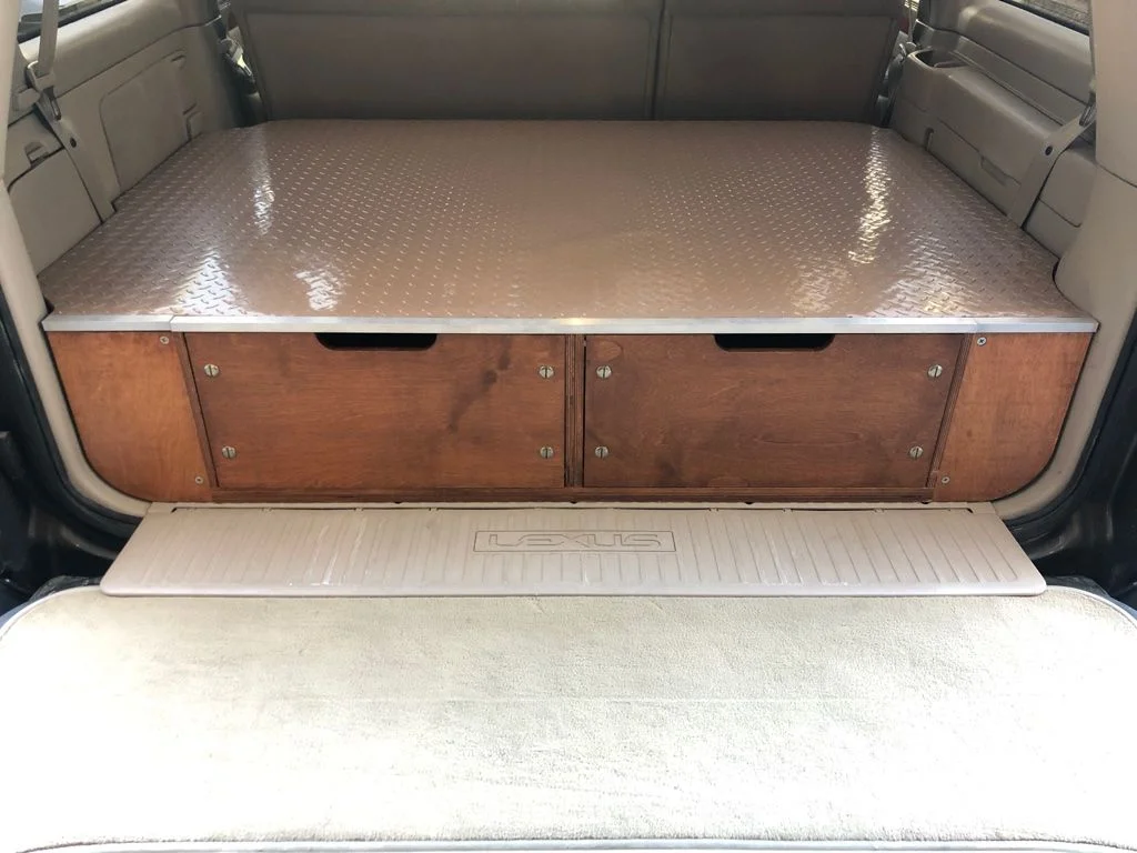

Finally got around to assembling mine! The fit and finish on the Reef setup is incredible. Less than mm precision on everything. It all just lines up and works. Truly a fantastic piece of engineering. I got the wing kit (excellent, really love the hinges) and the bolt down brackets which are ROCK SOLID. Got impatient wanting to use everything so bad and just went ahead and installed them after staining, will have to pull back out and put urethane coats on the exposed bits, add aluminum trim, a topper mat, and of course lots of stickers.
Props to Dave for designing all this! Can't wait to get a few more add-ons.

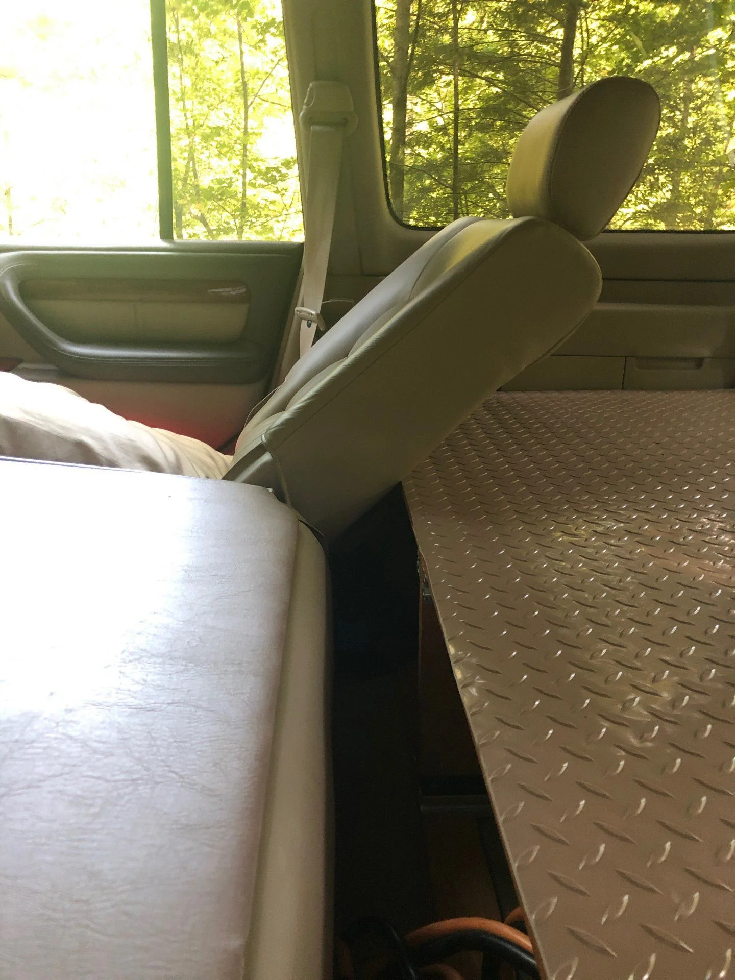

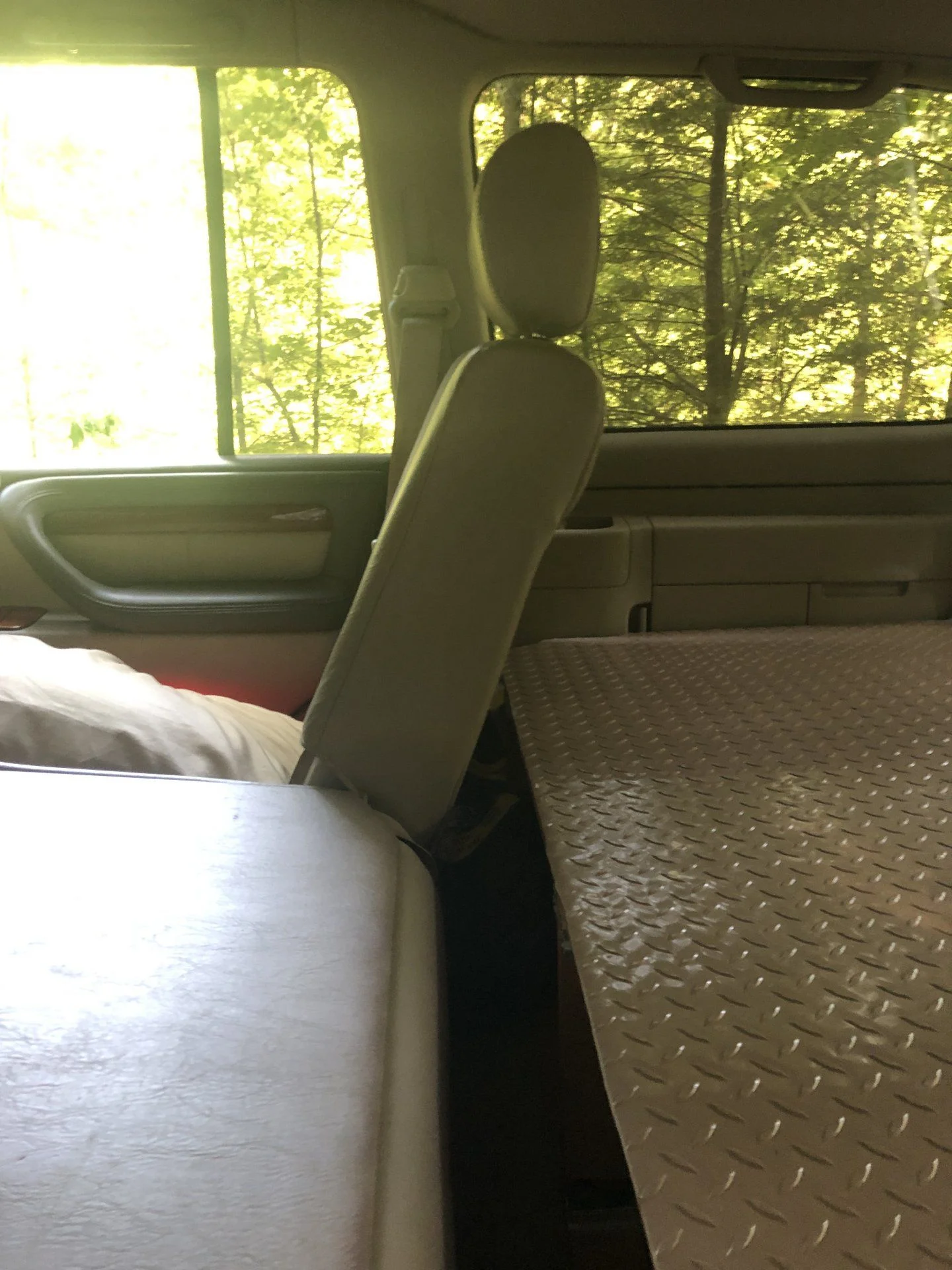

Can ypu please share a picture of how far the 2nd row seats can still recline?

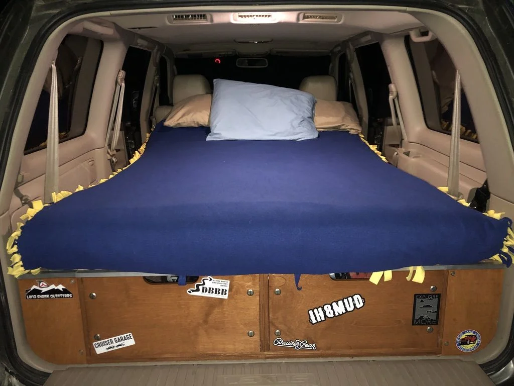

Does anyone have a picture of them sitting on a mattress of sorts on this system? Is that possible?

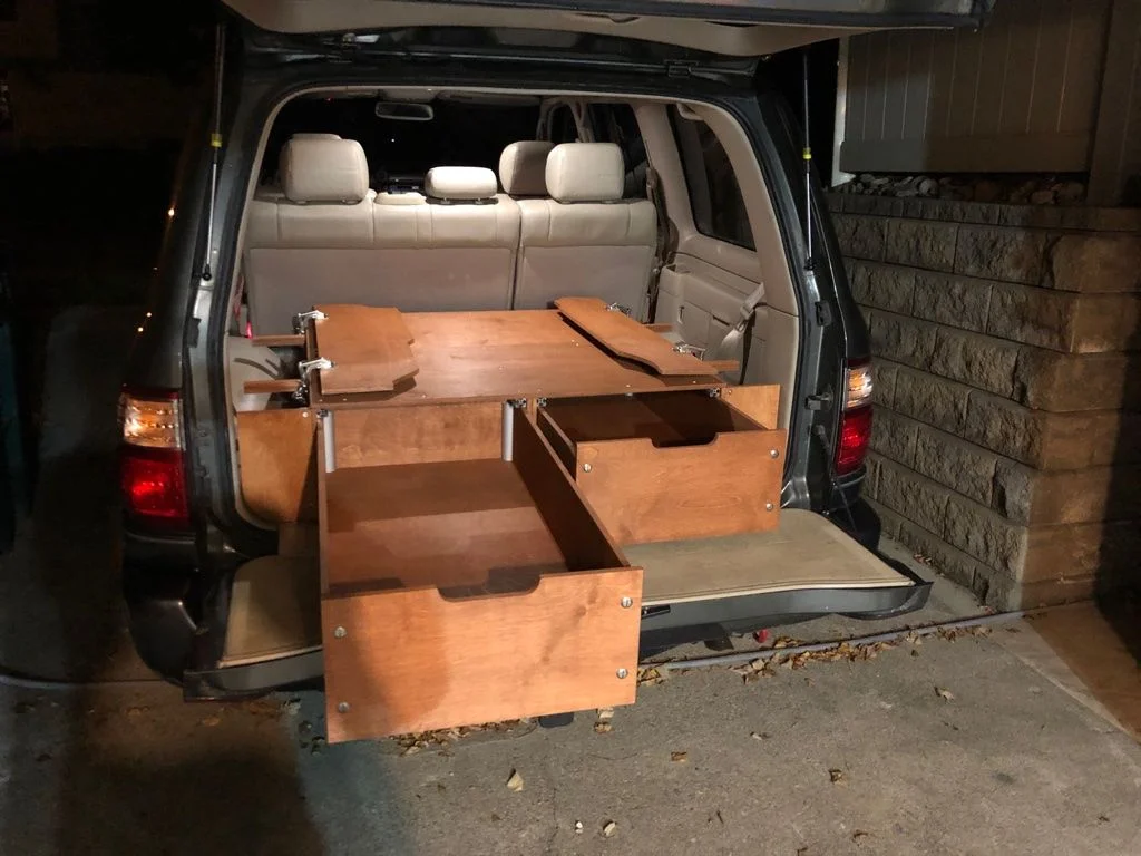

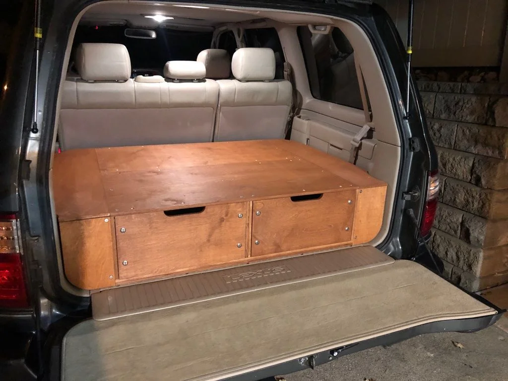

Yes and yes. Finalized drawers plus some reclining and bed pics. Hope these are helpful.
Fully upright and reclined as far as the drawers will allow:
Cheapo Intex camping air mattress (full-size bed equivalent). Can't even remotely feel the gap between the drawers and the seats.
Thanks, but that still doesn't show anyone sitting up on the bed. Also how thick a mattress you got there?
Oh, sitting on a mattress? No, it was just me camping. You can't sit bolt upright, that's for sure. If you want to know the headroom, it's the distance from the seats folded flat to the ceiling minus the height of any mattress you choose. The mattress in my pic is about 7" thick inflated.

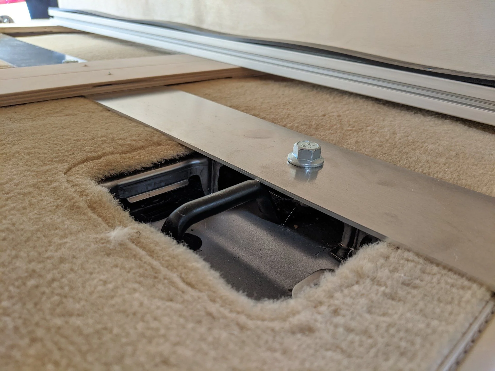

Has anyone installed the Reef anchor plates in their 100 series who might have some photos of how they connect or some advice? I’ve got the L1 plates and it seems like they should match up just about right with the third row seat anchor bars with four J-bolts and nuts, but what I have in my kit is two straight bolts and spacers. Any help?
In my 200 the longer bolt supplied replaces one of the seat anchor bolts. HTH
Thank you this helps a lot. It didn’t occur to me that I’d have to remove those trim pieces but now I look it’s obvious. There are side ones that I have to remove as well or the drawers won’t sit flat. I’ll get back into it tomorrow and report back here but hopefully this will work.
Yup, remove all the trim pieces. I put as many bolts back without their trim bits as possible to seal up the holes, except using new longer ones where the anchor brackets line up. I aligned the brackets to the truck first then slid the drawers in to mark where the brackets should be screwed to the drawers. Then removed everything, screwed the brackets to the drawers, then put back in and bolted down. Alignment went perfectly this way.
