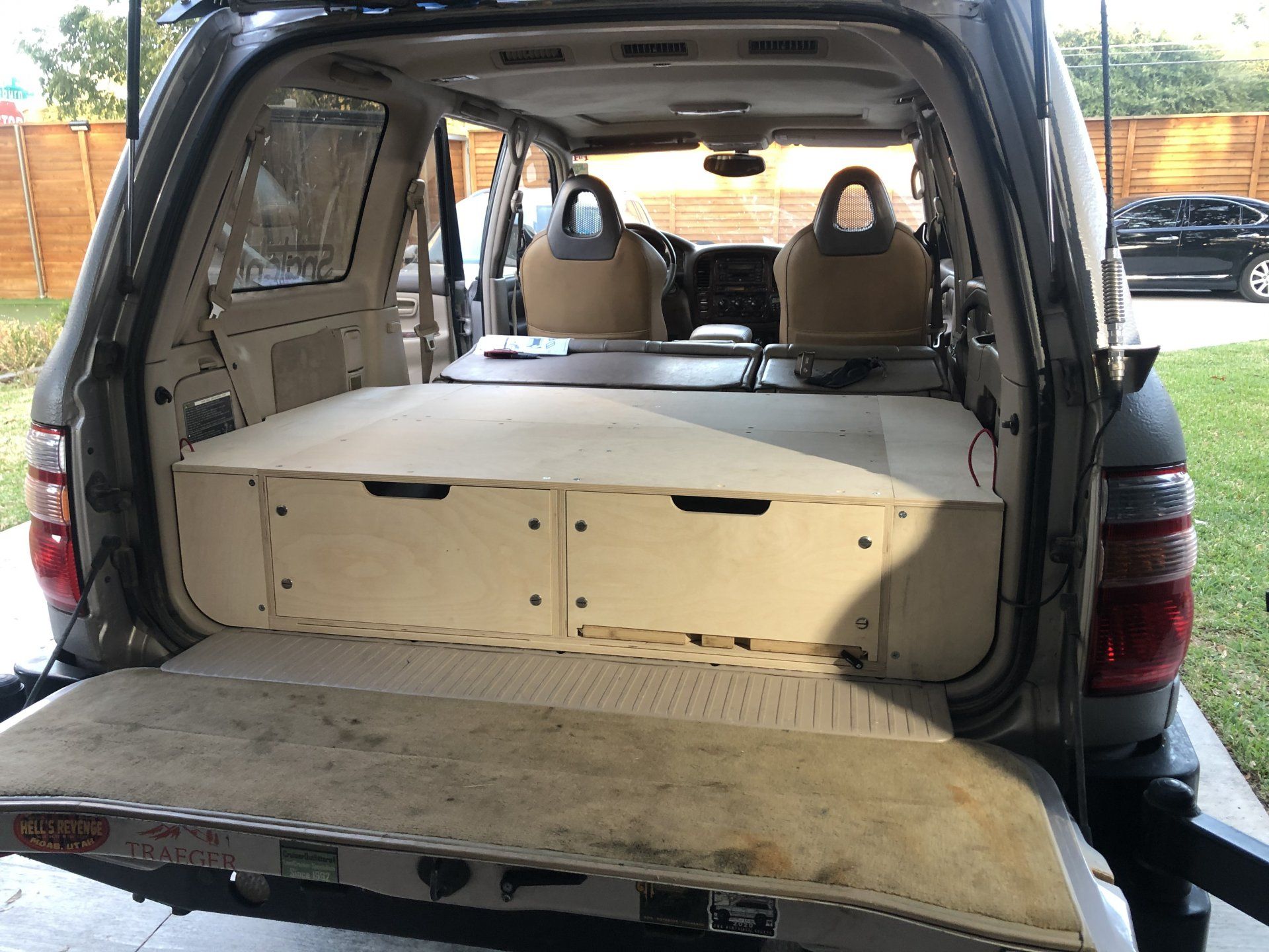

I've been staring at the assembled drawers in my garage for far too long, time to get em finished and mounted!
I used U-Pol Raptor Liner. No prep beyond wiping off dust, but I recommend sanding edges smooth for better adhesion. Its a messy process if you spray- and you need a good respirator for rolling or spraying to keep fumes from melting a hole in your brain.

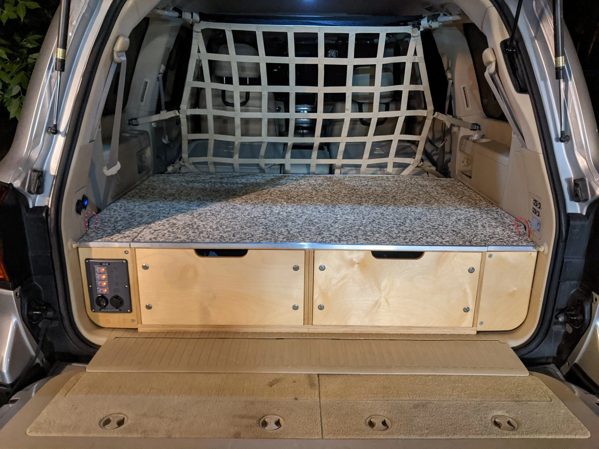

This is installed in my 200 but this thread gave me lots of ideas and inspiration so I thought I would share.
I sanded everything very smooth because I had the time. To finish the wood I used a mix of 1 part Minwax Helmsman spar urethane, satin sheen, 1 part boiled linseed oil and, 1 part odorless mineral spirits. Details here: Our Shop Finish Recipe
I applied 5 thin coats over a week and then let it sit in my shed for 4 weeks to finish drying and stop smelling. The odor was mostly gone after a week. It was easy to apply and work with but did take a while to fully cure.

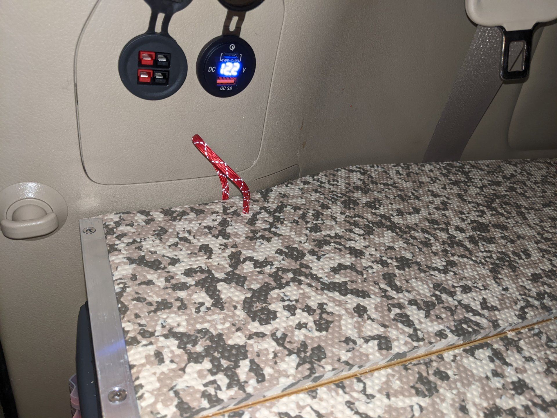

I went with the large SeaDek 40" x 80" Embossed Sheet in desert camo to cover the top. I'd recommend ordering their free sample kit to see all the colors and textures in person. https://www.seadek.com/SampleRequestForm The Desert Camo color matched my interior the best and hides dirt well. It was very easy to cut with a razor blade. My only wish is that I applied the full sheet to the top and wings and then made a cut for the wings, That would have made a perfect no gap seam. One thing to be aware of is that heavy sharp items such as a toolbox won't slide around. I think this is a good thing but can make loading items toward the front of the vehicle a little more difficult.
close up of texture and seam.
I also used the reef anchor ratchet straps, anchor plates, 200 series wing kit, and upgraded wing supports. The BlueSea systems switch panels controls power to my USB ports, power pole plugs, and some cheap led light stips I put in the drawers and wings. Very happy with how it all turned out and enjoyed the building.
I may eventually add tie-downs to secure a fridge or other cargo but right now I am enjoying the clean top.

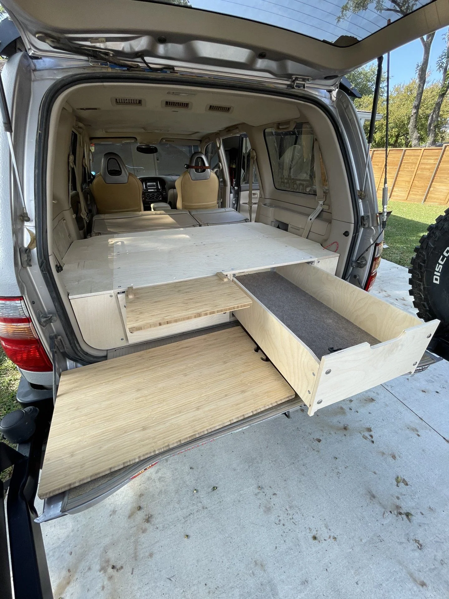

Making some progress, carpeted the inside bottoms of the drawers to make them a little less “hollow” sounding. Ordered some peel and stick carpet tile for the tops of the drawers and wings. Will finish the front edge with some aluminum angle. Really coming together. I ordered a bunch of tool pouches and things to start getting these drawers filled up.
