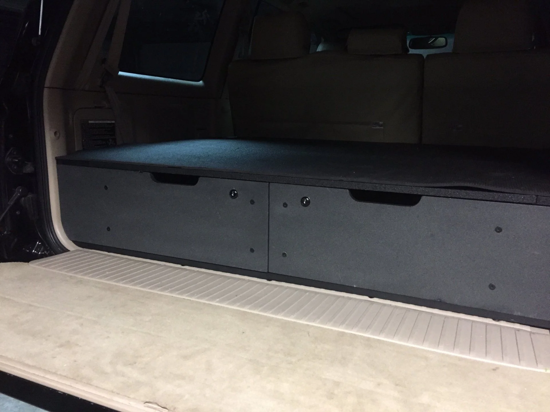

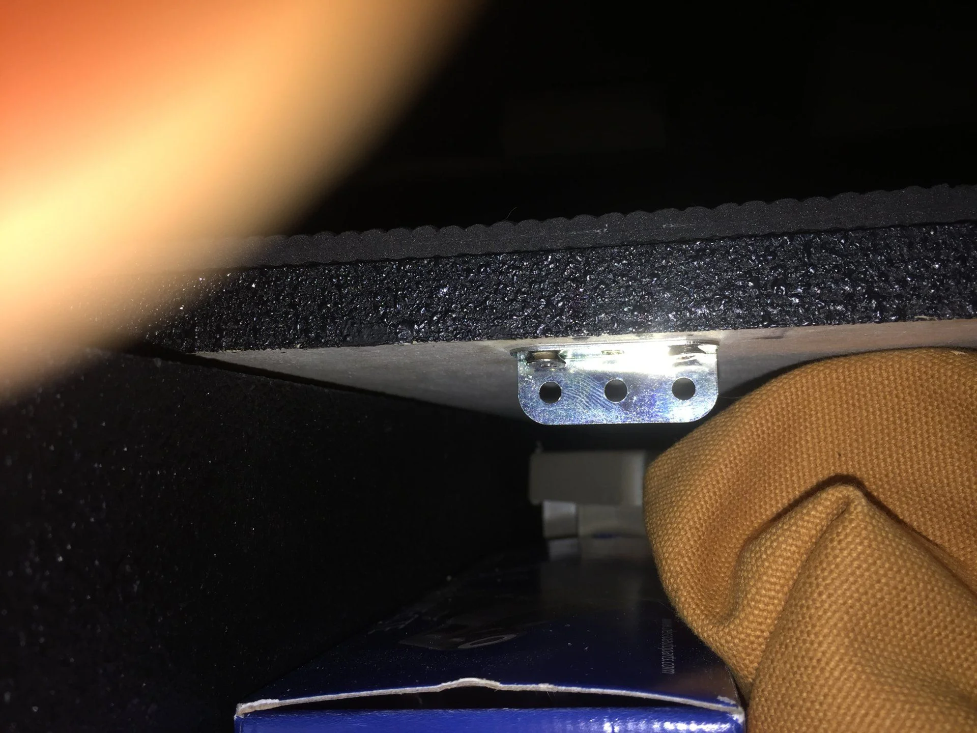

I had been pondering a solution to be able to lock my drawers and found a reasonable low cost option that can be sourced at Lowes or HD. Two locks keyed alike, total investment was just shy of $15
It required drilling two 3/4” holes and adding a small latch plate to the underside of the top deck. Its secure but if you really wanted in I suppose a few substantial pulls would compromise the latch (unless through bolted). But it keeps the drawers in place and lazy thieves honest.

My drawers are due to arrive today or tomorrow. I had a tough time making a decision between "cutouts" or "blanks". I went with "cutouts" and was thinking of doing something similar.
Im sure there are better and more secure solutions but this was quick and simple.

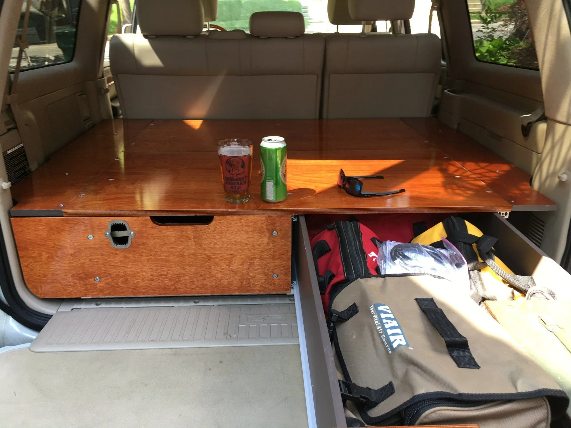

How do you plan to finish your drawer set up?

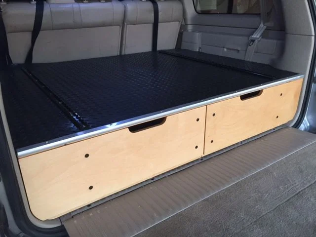

Also I noticed somewhere in this thread, somone put a piece of aluminum 1/4 round on the facing edge of the top deck. Anyone have a clue what or where that material can be sourced?
I'm not sure what was used but I've sourced aluminum from Onlinemetals.com many times with excellent results. Also, 8020.net is a trusted site too.

Well, even if you went for fancy high security high dollar locks, you would still have exposed screws and a nice big slot for a crowbar. The cabinet/drawer locks seem like a nice balance.
Have 2 sets arriving, I'm leaning towards staining my kit, my son is still undecided on his.
I like the look of these:
Yes, I've done this as well as a couple others I believe. Here's what I used and it came out great:
TrafficMASTER Silver 1/2 in. x 72 in. Bar Step Transition Strip-H5144 M 6 - The Home Depot
Put aluminum trim on the leading edge to protect it from dings. I’m going to hinge the sides, so not planning on trimming there.
