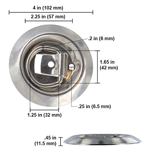

And if you want single, removable tie-down points like those:
https://www.amazon.com/Round-Anchor-Point-Tie-Down/dp/B00SLTRAE6/?tag=ihco-20
