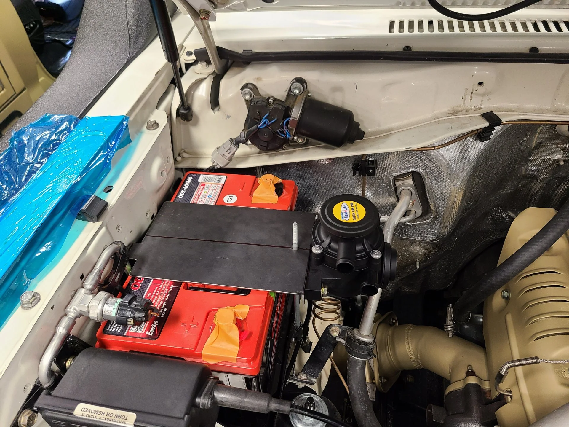

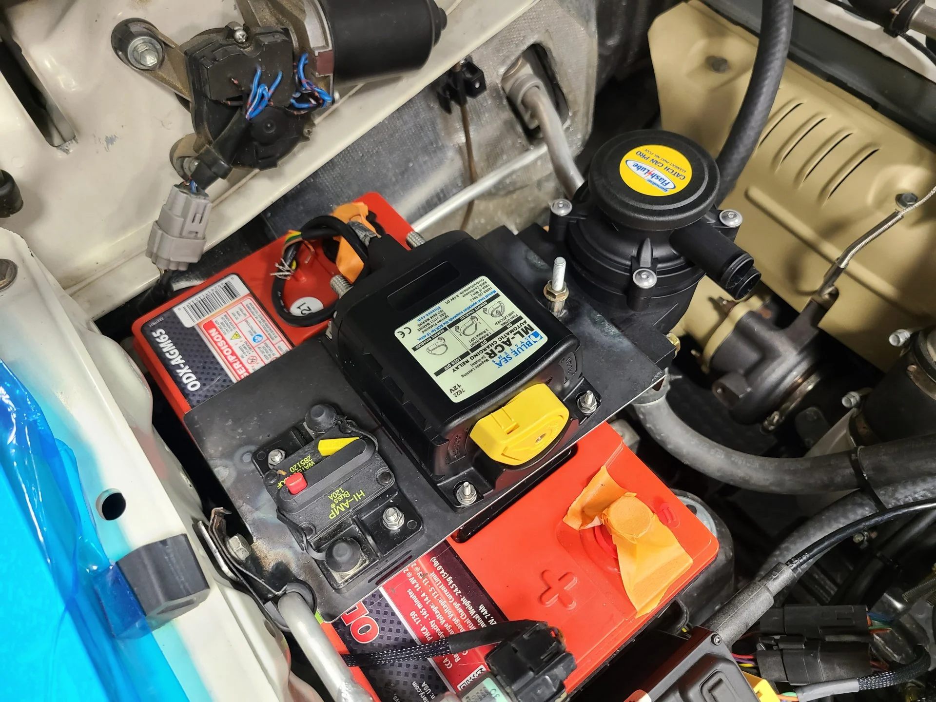

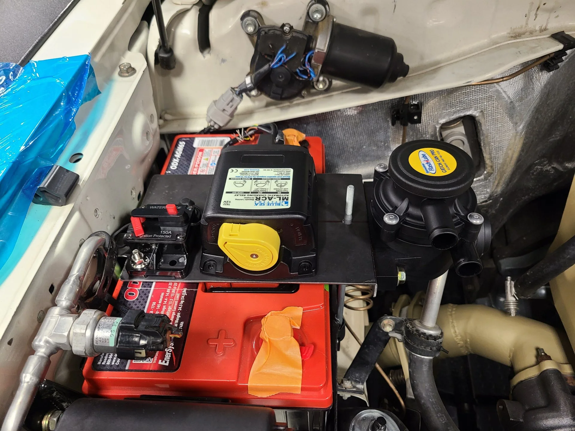

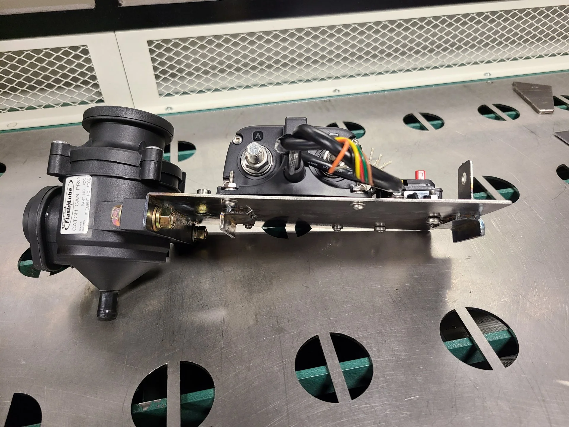

Kind of running out of room for things on the sides of the fenders, so for this one, we're going to mount the Blue Seas ACR and the breaker for the Switch Pros on top of the secondary battery....AND we're going to hang the Flashlube catch can off the side....a multifunction battery hold down for sure.
Started with some cardboard templates to come up with this....
Welded on some 90* angle pieces to lock the battery in...
Bolted stuff down....
Everything fits nice and tight....hood strut clears the breaker....all good. Powdercoat tomorrow hopefully. We'll plumb the catch can once we get it all bolted down.
