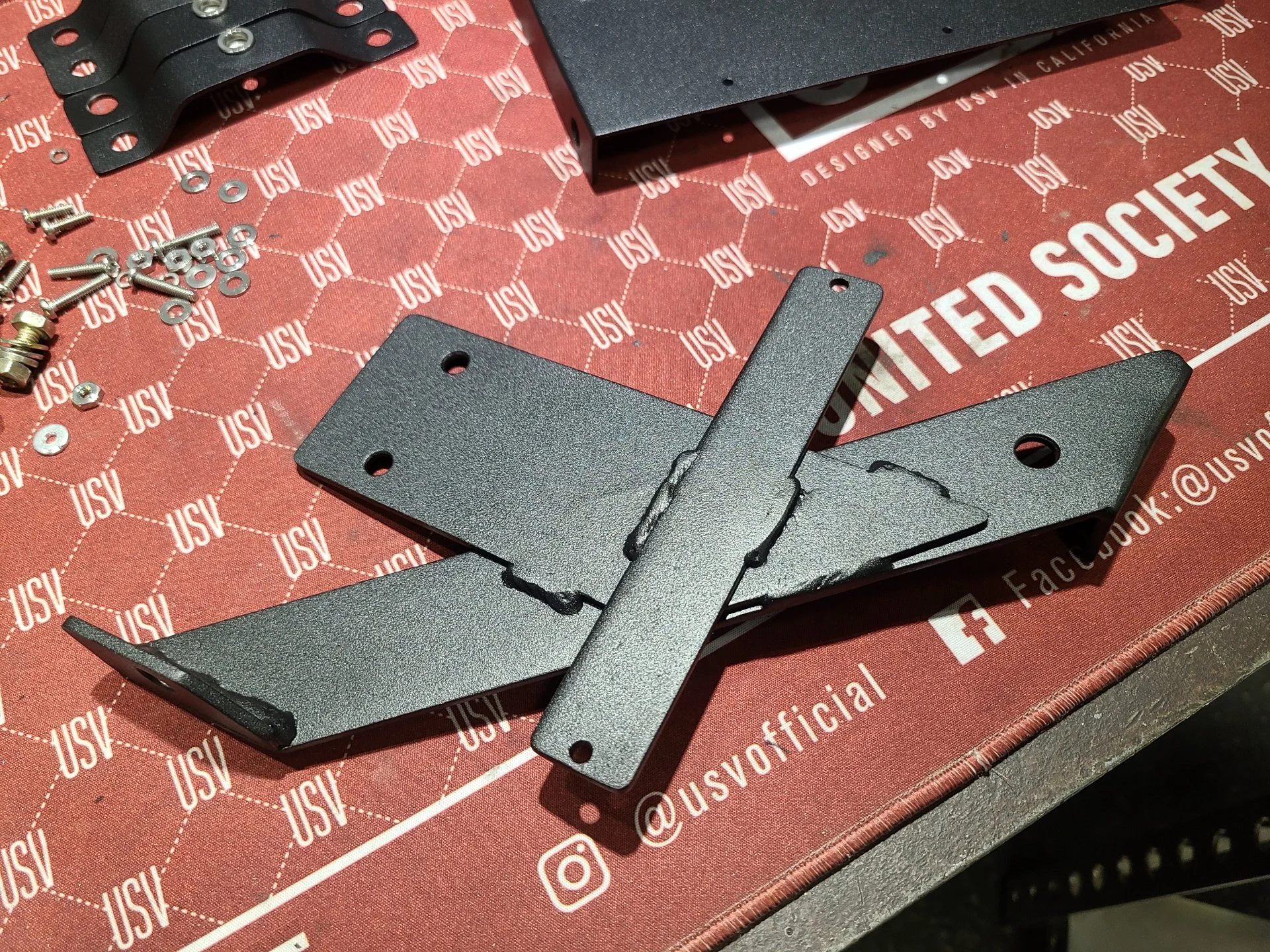

Got the Switch Pros module in today......had to alter our battery tray support bracket to make it fit. Built it, powder coated it, installed it in the same day......really nice to not have to wait for powdercoat. Our 21 year old has become really good at powder coating too.
Battery hold down/isolator mount done and powder coated. All the electronic stuff mounted. Even got the Flash Cube catch can plumbed......I see we used heater hose.....we'll swap that for something else I think. Silicone maybe.

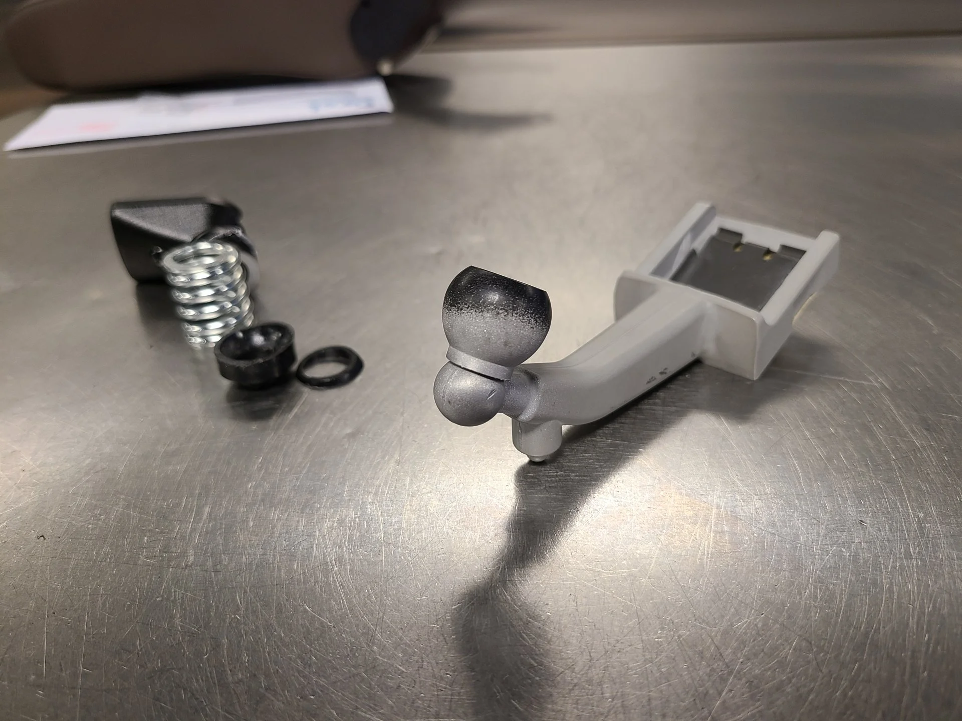

After some not so careful thought, we tore into the mirror. Just in case you were wondering what is inside a 70 series mirror....here you go.
I wanted to try and make an adapter to where the OEM mirror mounts to support the new mirror mount but the angles are all wrong...with a larger mirror(10" long), I needed to move the mirror down and away from the windshield a bit to clear the sun visors.

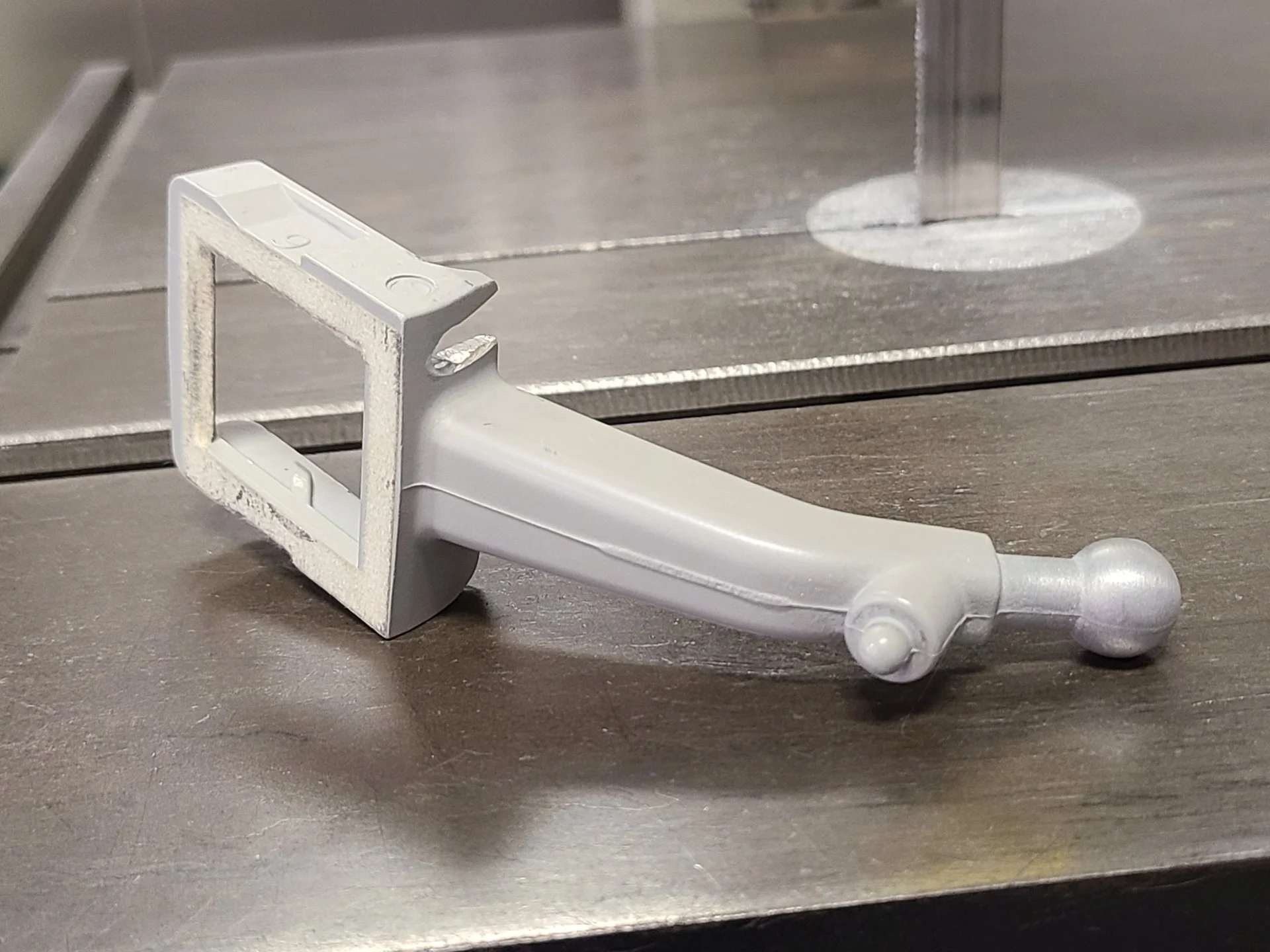

Started by introducing this to the band saw....
I salvaged just the pivot ball so I could get the angle right. We weren't too sure about the type of aluminum(cast or something weird) and how it would respond to the TIG machine.....so I figured screwing the pivot ball to the OEM arm would be best. I think I'll lock it all down with some JB Weld once we powder coat the pieces. Since the mirror won't really need to be adjusted as it's a monitor.... Adjust it once and all good.....the mirror pivot ball should hold up. It's all very tight so there won't be any shaking or vibration. Not sure how much twisting it will take though.
Looks pretty decent and when it's all black, it should blend in pretty nice. Certainly looks better than the strapped on mirror......not as good as the OEM mirror though.

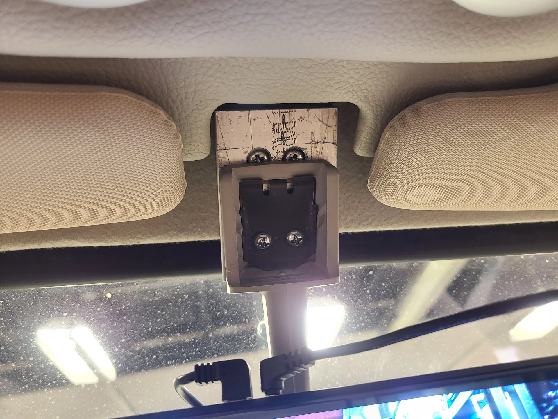

I'll have to make a 3/4" adapter to space the mirror's mount out from the roof for clearance.....the mounting holes will change so we'll have to do some creative hole drilling to make things work. I don't think from either the inside or outside you'll see the adapter block since I run an overhead console that kind of goes around the mirror mount.

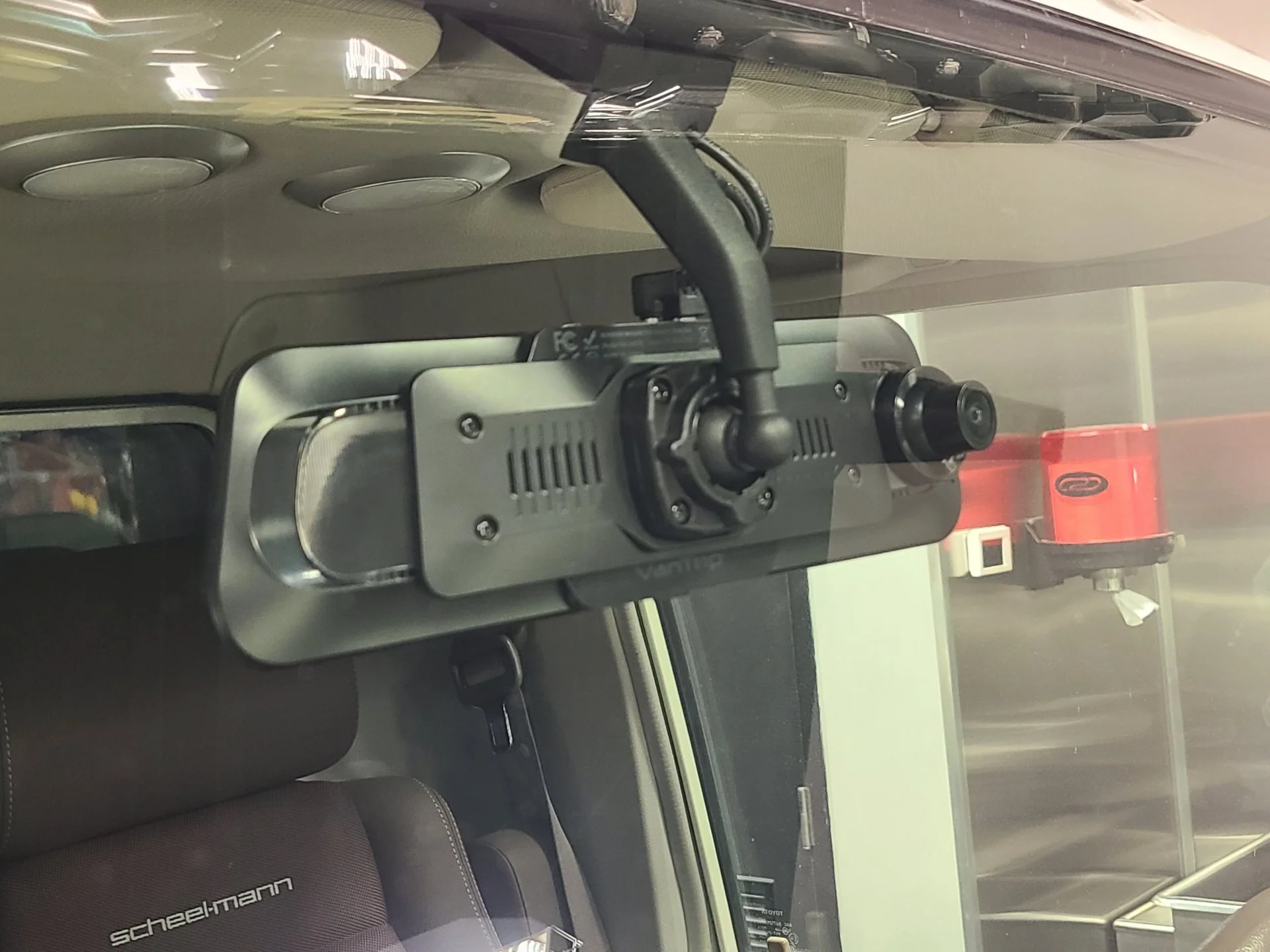

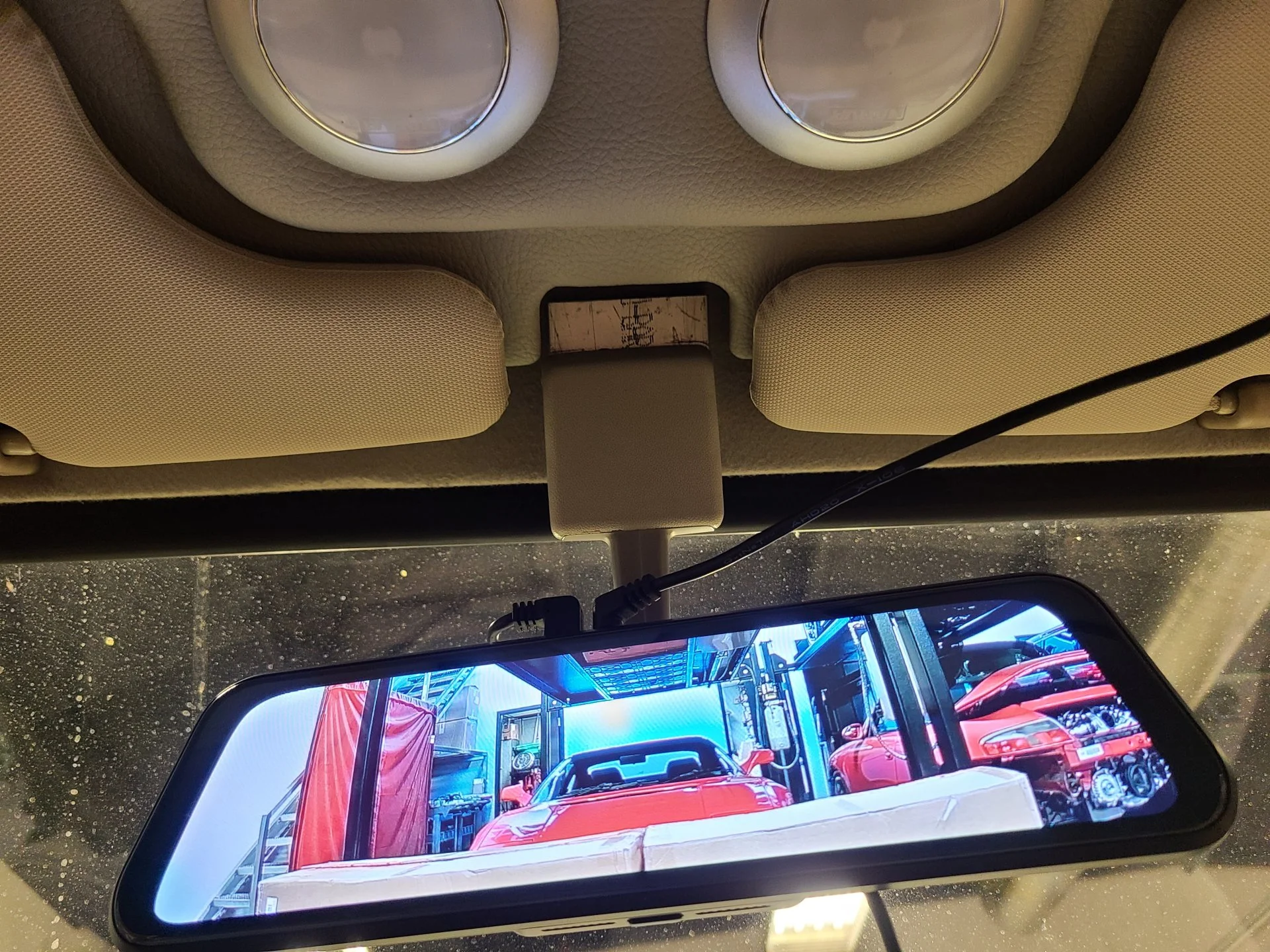

Made some headway on my mirror project today....made a cool little adapter to space the mirror out and down....simple piece of 1/2 aluminum...drilled and tapped for the mirror to mount, drilled for the OEM mirror screws to mount it to the body.
Looks a little crooked in the pics....pretty sure it's centered. We'll have to work the aluminum down to a little better shape I think although the majority is covered by the mirror cap. Need to decide on color too.....black probably....will hide it.

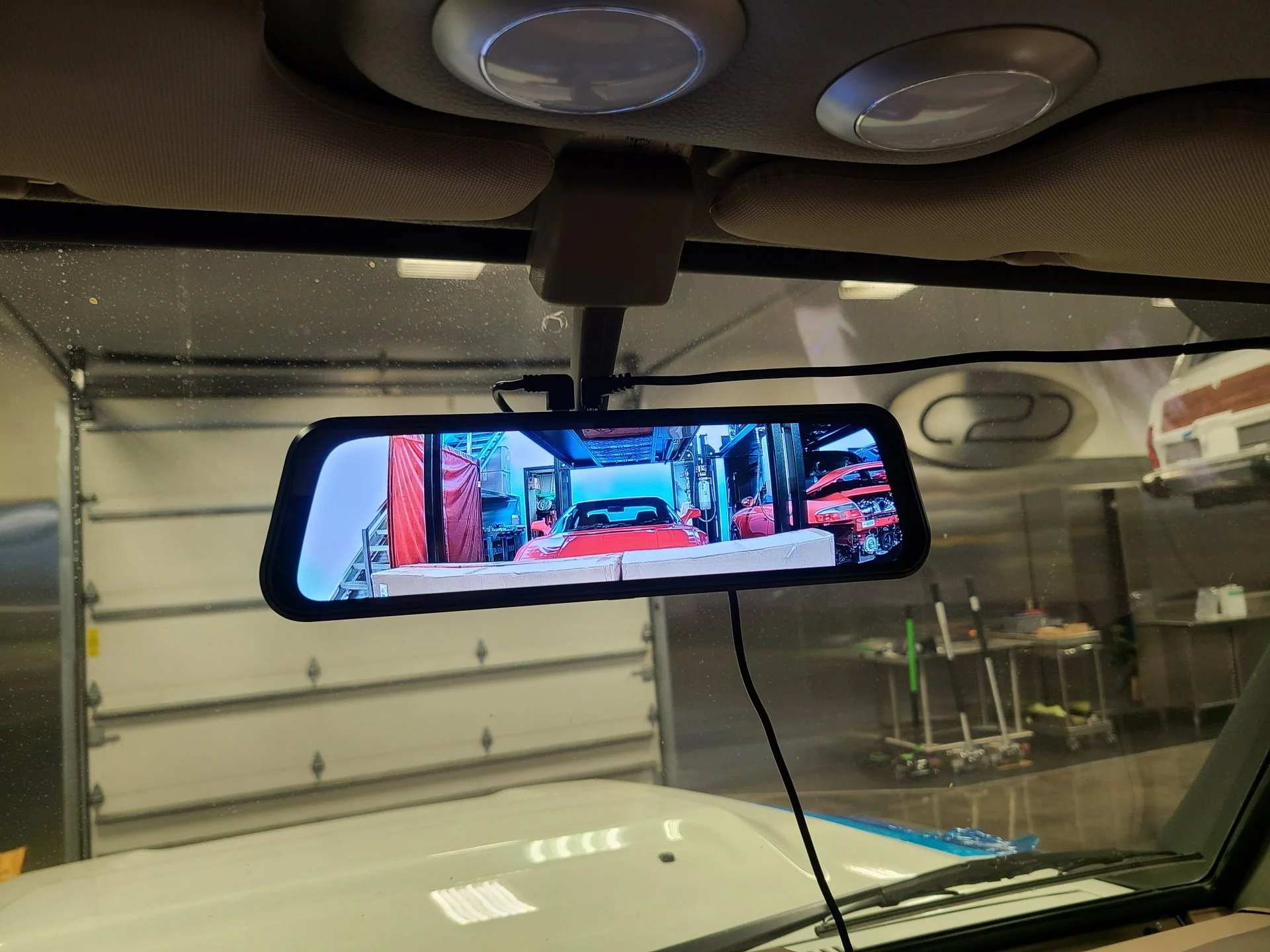

And here it is in all its glory.....fired it up for testing.
Unfortunately, there are 2 wires that come out of the top of the mirror.....mini USB and the jack for the camera. Kind of sucks as it looks a bit stupid. I'll hide them and tie them down the best I can when we finalize things.
Mirror cap looks pretty good. I think blacking all this out will be the way I go the more I look at these pics.

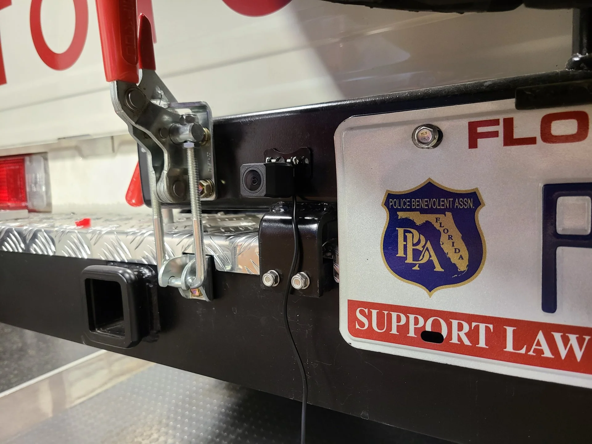

Here's the rear view camera....a little bigger than a normal reverse camera. Contemplating some kind of mount/shroud to protect it a little bit.
View attachment 2691835View attachment 2691834View attachment 2691833
It would be a ton of work but insetting it into the swing arm would be neat.
We could do it but I think making a little shroud and gluing the camera into the shroud will be cool. I'll make the shroud something we can remove with a couple of bolts. I kind of have an idea in mind but need to lay it out with some poster board.
The wire will run inside the arm like the tag light does. Really clean like that.

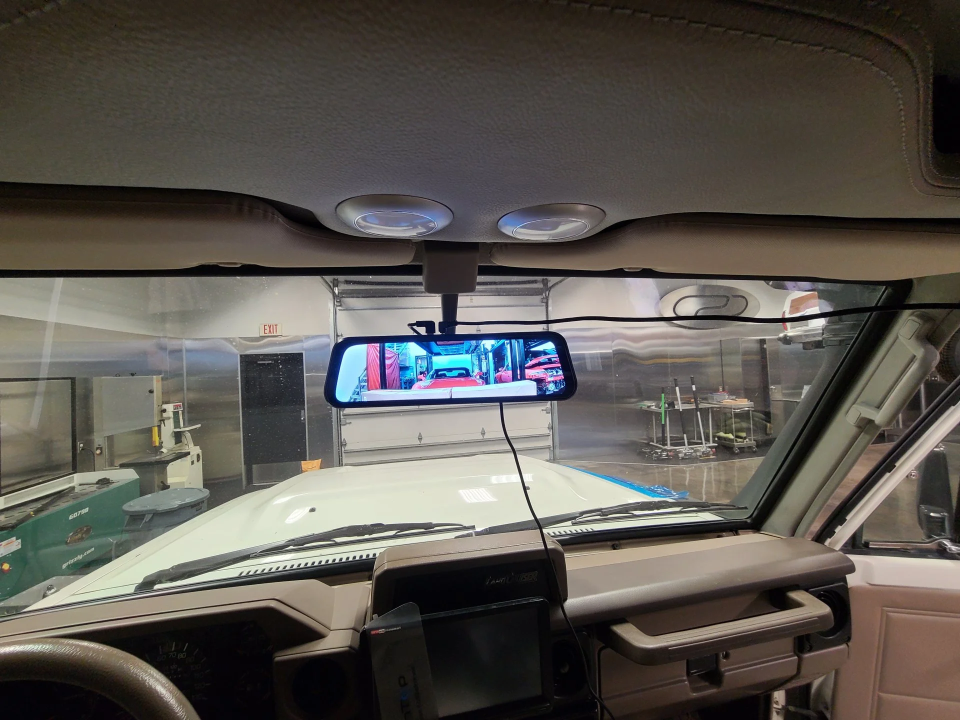

Wrapped up the interior side of things today...need to get on that rear camera mount tomorrow. Still undecided on how I want to do it. Waiting for some inspiration I guess.
Modded the already modded mirror arm. Pretty cool that we had this thing cleaned up and powdercoated in 1 hour. Wish I had a bigger oven....
Pretty sophisticated looking mirror for a 79.
Like something straight out of the future...
