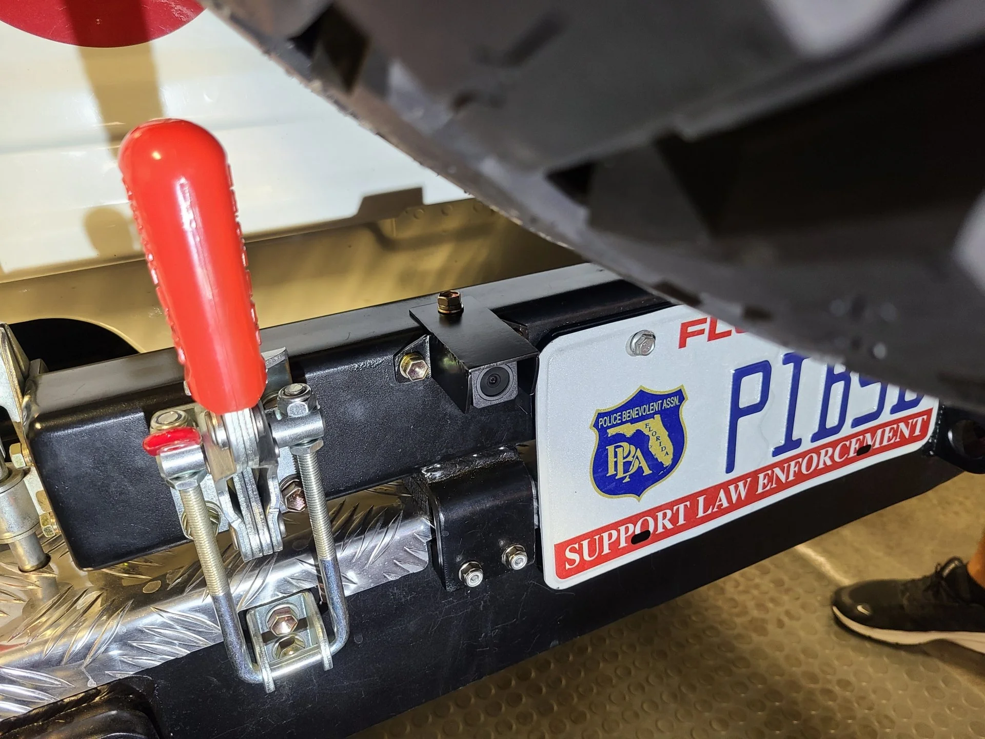

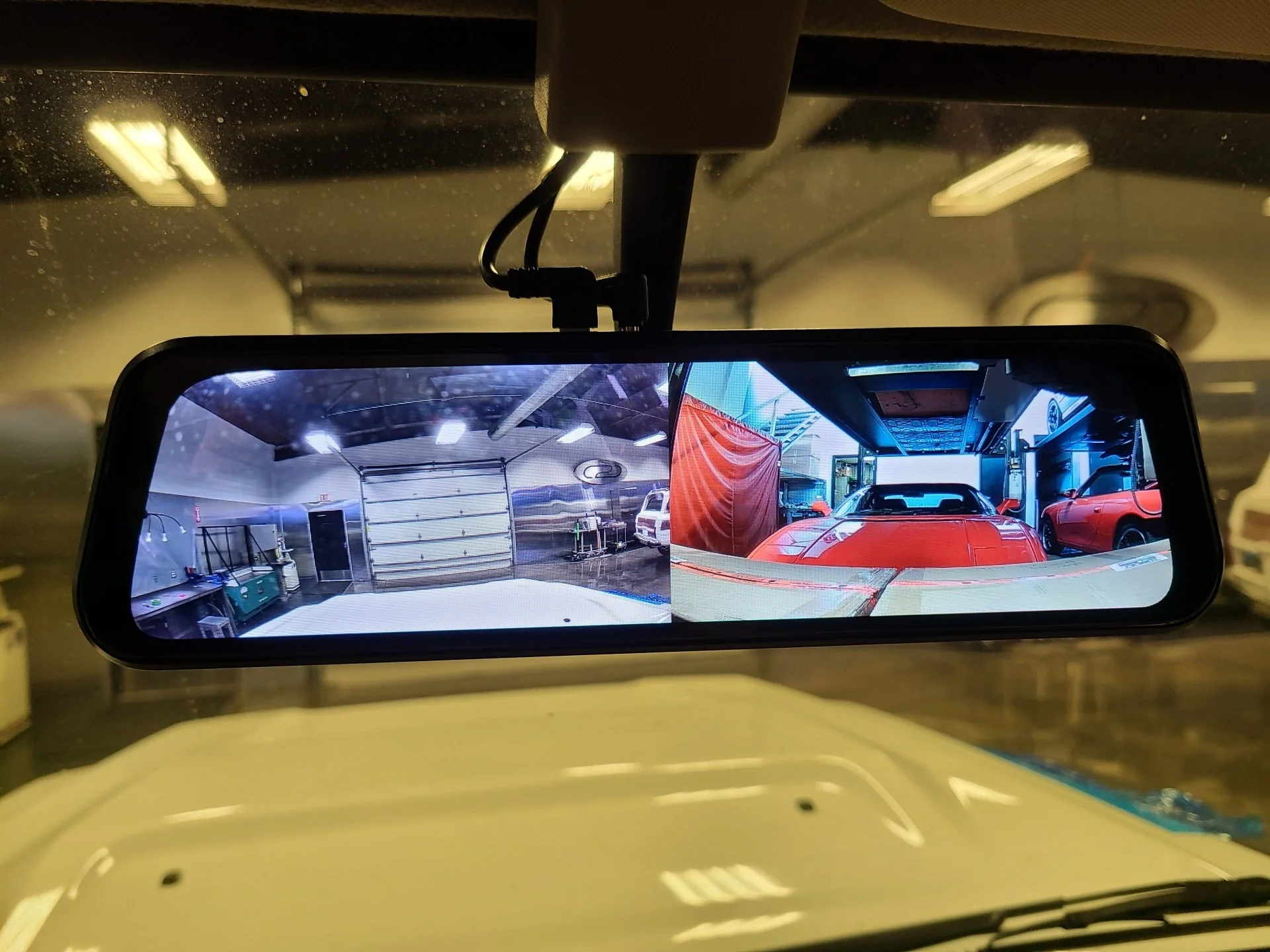

Routed the wires for power and the camera thru the body of the mirror....as clean as I could get them. I'll zip tie the cables together. I lucked out with the wiring.....I was able to snake the power wire for the mirror thru the left A-pillar....my fuse box is on this side so easy to tap into it. The camera goes on the passenger side....above the headliner, down the back corner of the cab thru the floor and back along the frame.
Rear view....
Front view....this is always recording....the rear does not record.
There's a split screen for front and rear....
This screen allows you to play back and delete recordings....

Camera cable got routed thru the swingarm last week. Turned out to be a challenge due to the size of the plug and the angles we had to get it to go to get out of the arm. I should have run it on the outside of the swingarm but it sure is clean looking with it inside.

Did you ever find a anti-glare cover? Have you tried the new mirror while driving?
I've driven the truck a couple of times.....the glare wasn't really a problem for me. The rear window is where the problem is coming from....I think it has something to do with how vertical that window is in these trucks. If it's a problem, I'll play around with blacking out the back cab windows....I think that would solve the issue. That will be low on my priority list.

In the Maltec 200 truck we had here, the mirror was super crisp.....zero reflection or glare. I realized that it had a black headliner and there was no rear window/glass...just the rear open camper area that was dark.

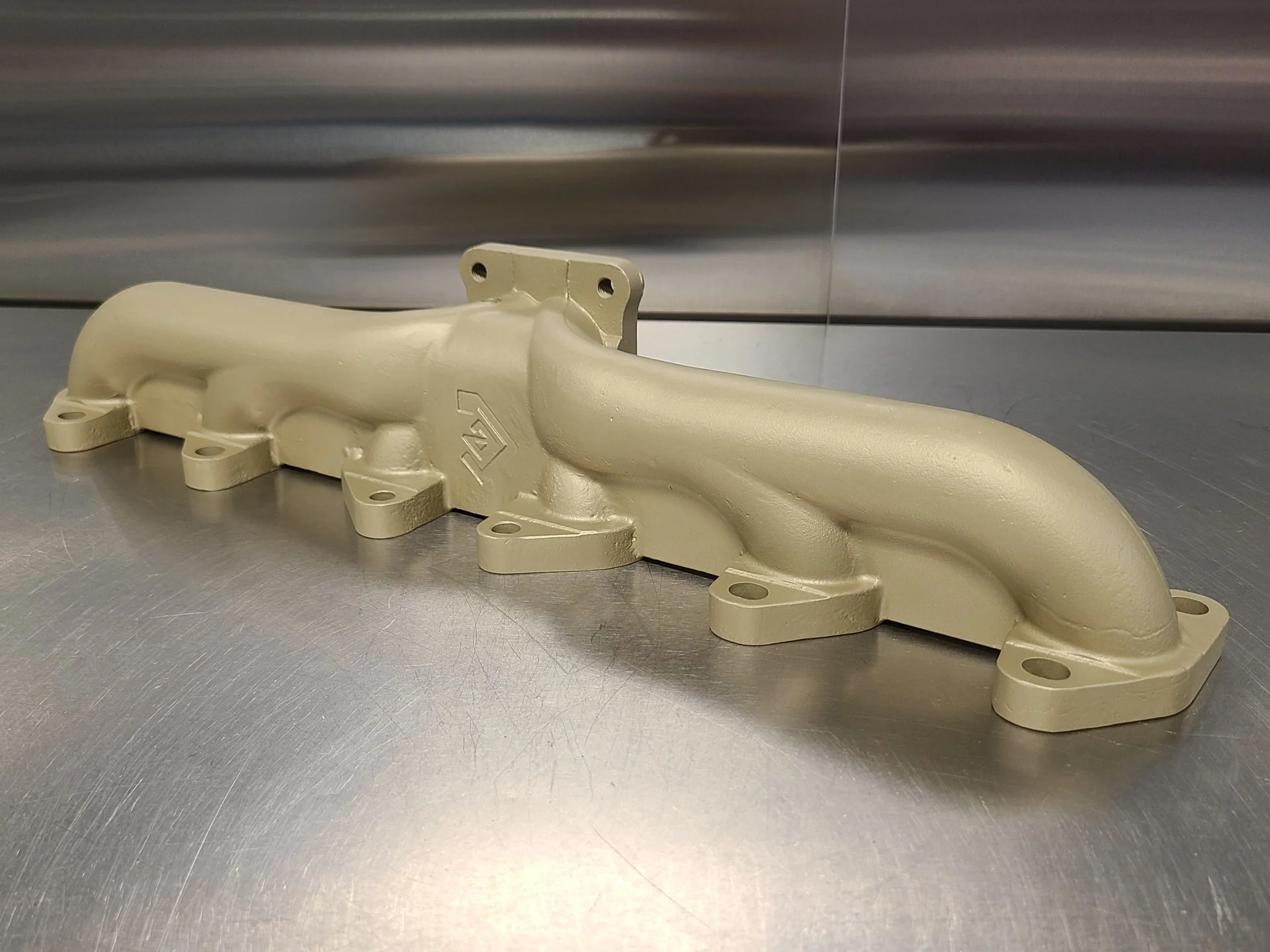

I had bought an Eclipse Turbo split pulse intake that was for sale on Mud. Had it thermal coated to match the other stuff we had done.....Glacier Gold Titanium is the color. Learning a lot about the coatings that the place we're using offers. Pretty impressive.
Cast stainless....this thing is HEAVY.
Cast stainless?!?! Nutty
Apparently it's very good at containing the heat. I had asked them if I could make provisions to reuse the factory heat shielding......they said no need to due to the properties of cast stainless. Guess we'll see once it's bolted on.
