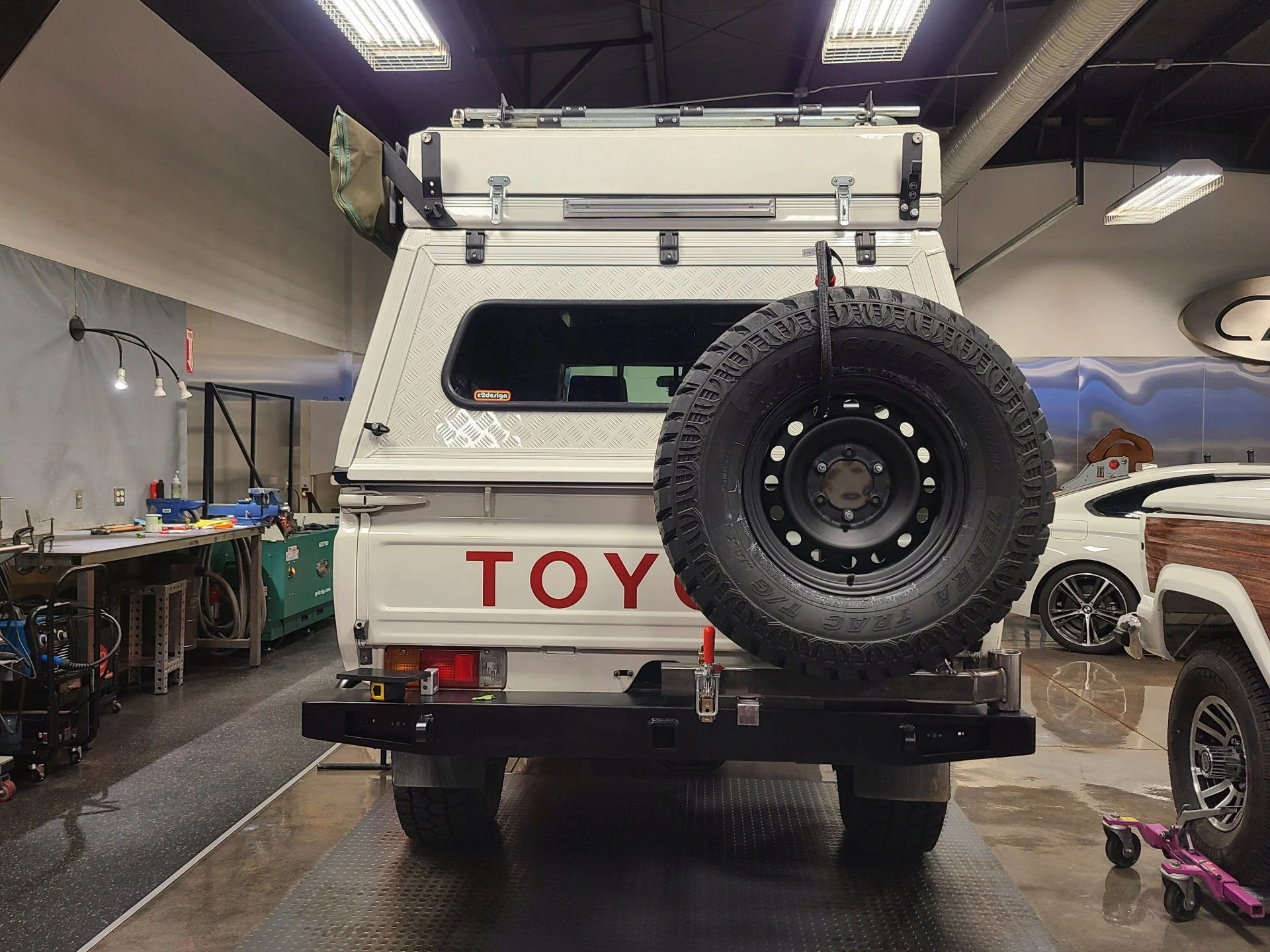

That down tube is pretty close to the tail gate. A fairly light tap to that tire may put the tube into the tail gate. :hmm:
Yep....could see that being an issue. Could also imagine the amount of tears that would come out of my face if that happened :)

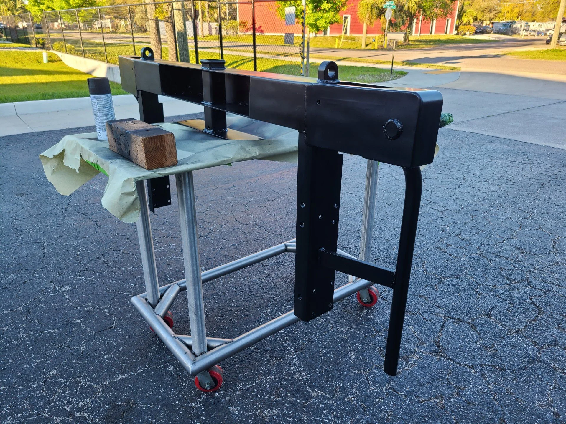

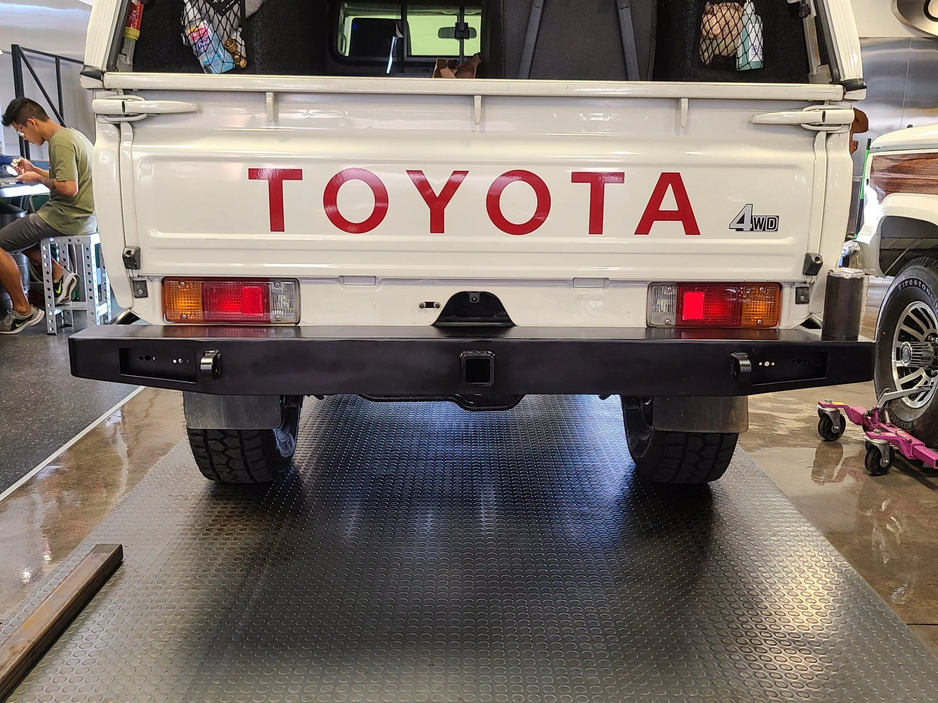

Painted this thing rattle can satin black and bolted her on.....not to come off again for a little bit.
Fun thing with black paint....you get to see all your flaws. I've got a little more grinding to do in a few areas I'm not super happy with but for the most part, it's pretty well sorted.View attachment 2604536View attachment 2604537View attachment 2604538View attachment 2604539View attachment 2604540

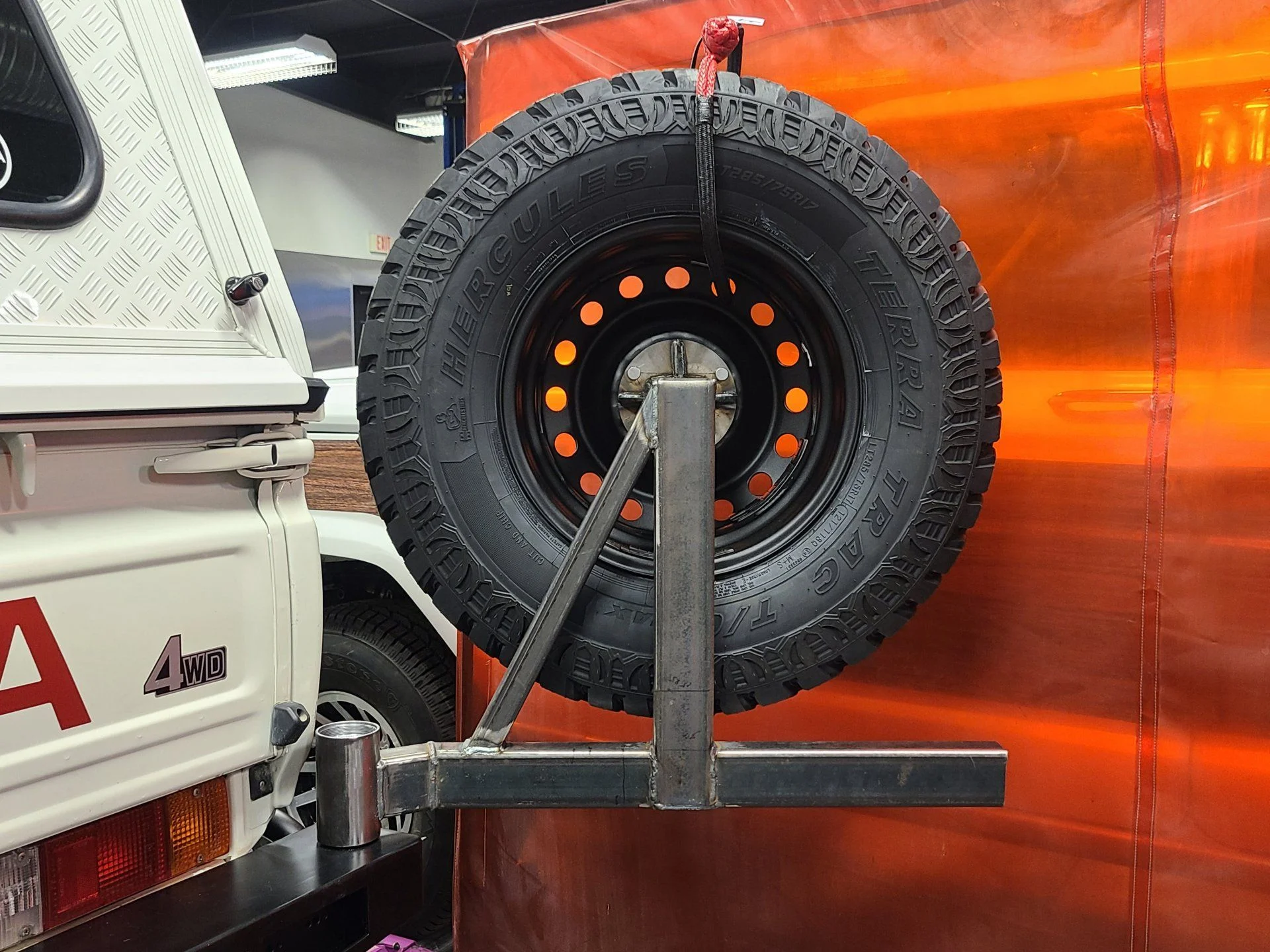

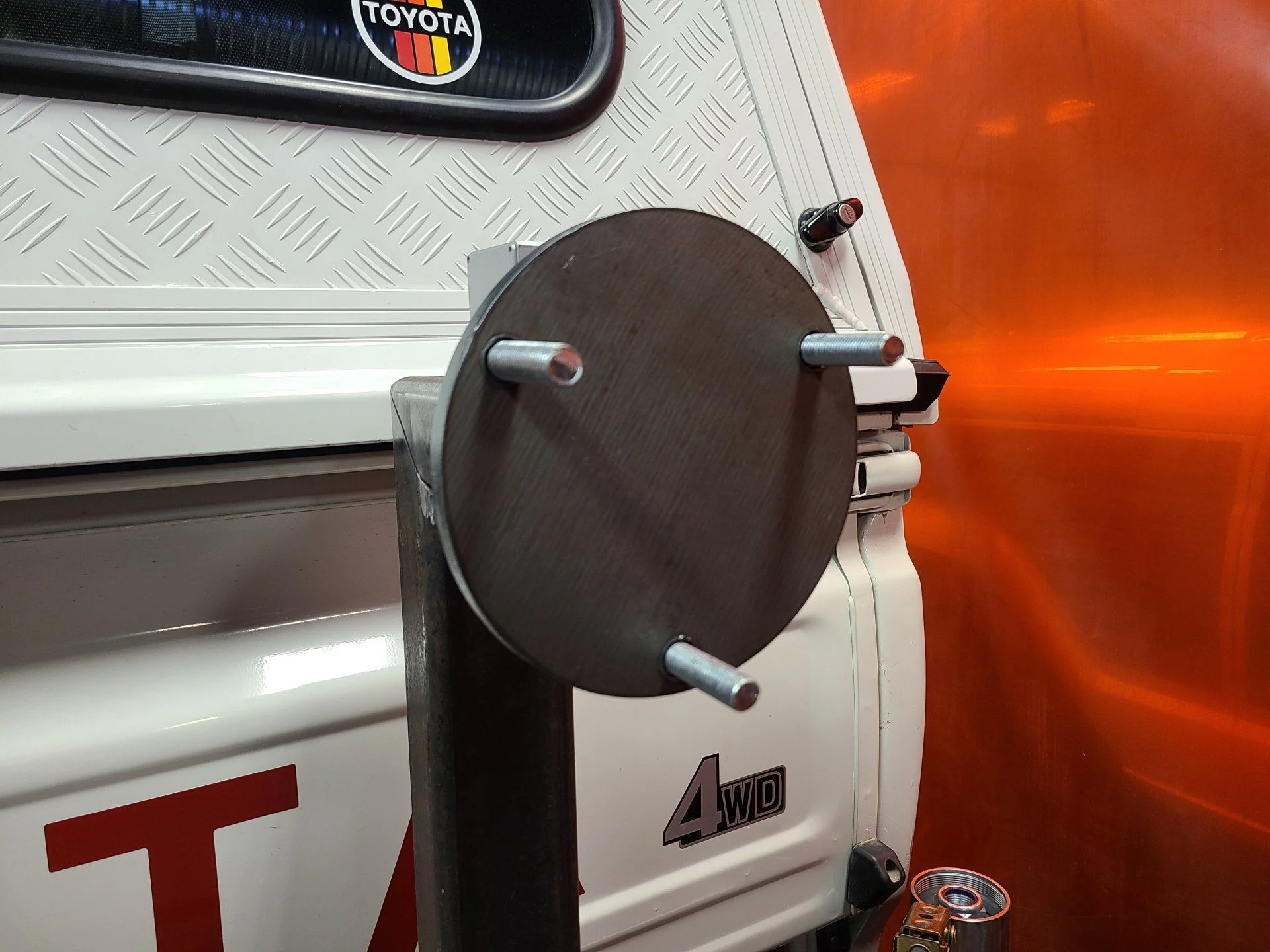

All started with this as the upright and a big old notch cut out. I didn't do a curved upright....straight was easier and I think I will put a fold down table on it at some point which will be easy to stow behind it. Seems like a good place for one. Plus it will be one more thing to shop for :)
After fiddling around with cutting and measuring, this is what I ended up with.
I was smart and bought a tire mount which saved a bunch of time.

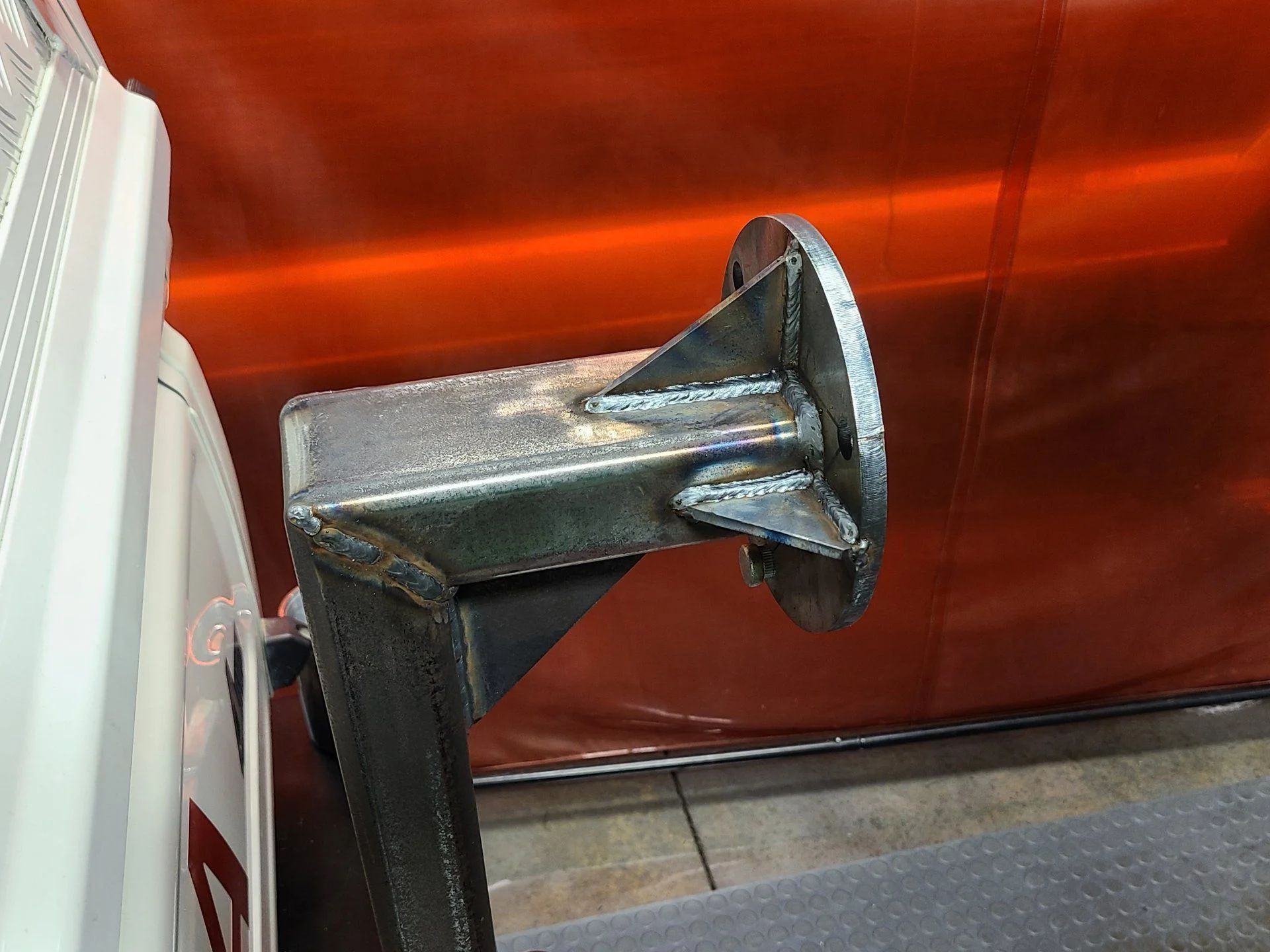

Did a bunch of gussets...kind of getting the hang of my new welder.....I have to move much faster with this one vs. my old one.
Finished almost all the welding today on it.....I have a couple more to do tomorrow when it comes off. I don't think it will go anywhere....very solid.

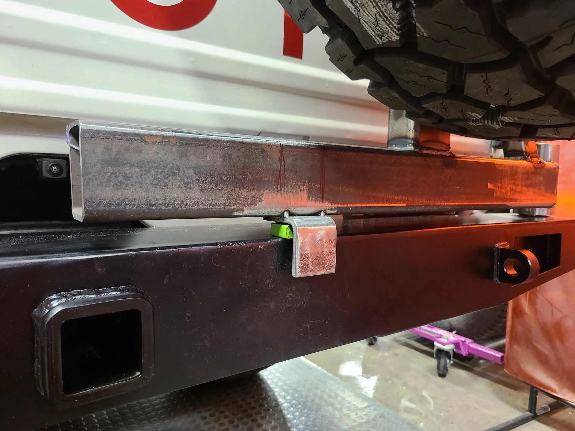

Happy with the rear clearance.....I think keeping the upright straight bumped the tire out about a 2" or so. Not the end of the world.
My brain still needs to accept this look.....very different.

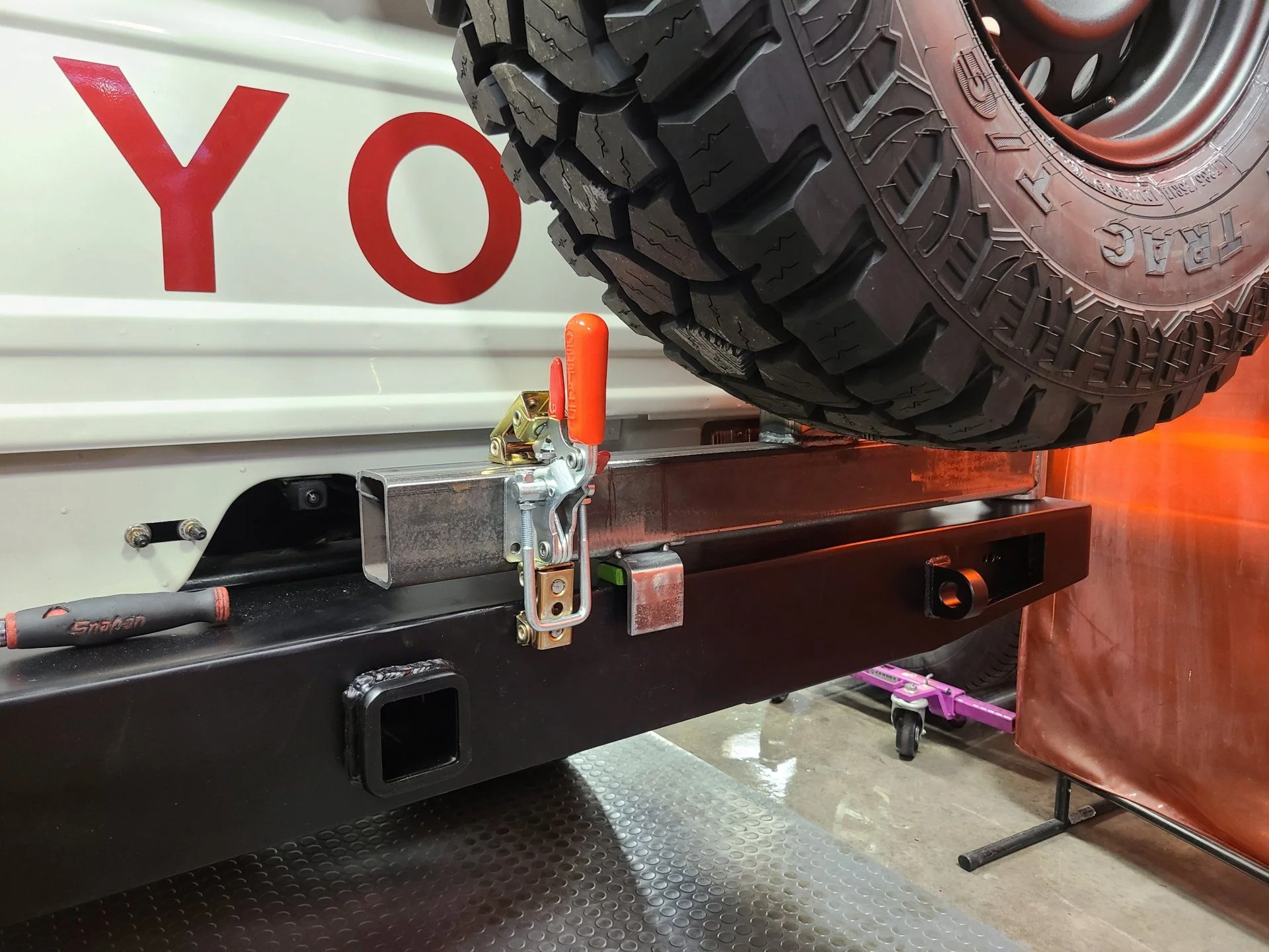

Welded on the stop.....I have some 1/2" HDPE material that we'll make some plastic 'cushions' for the stopper.
Realized that the Detasco 341 needs a longer U bolt which is a bummer. Should have one that is an inch longer on Wed. I'll drill this one in and get it all mounted. Going to do a lock pin as well but a little different than most.....using a Detasco retractable pin deal. Neat piece. Not sure where it will go.
I'll cut the end of the swing out off tomorrow and plate it....should have the locking pin on Wed so we can mount it.

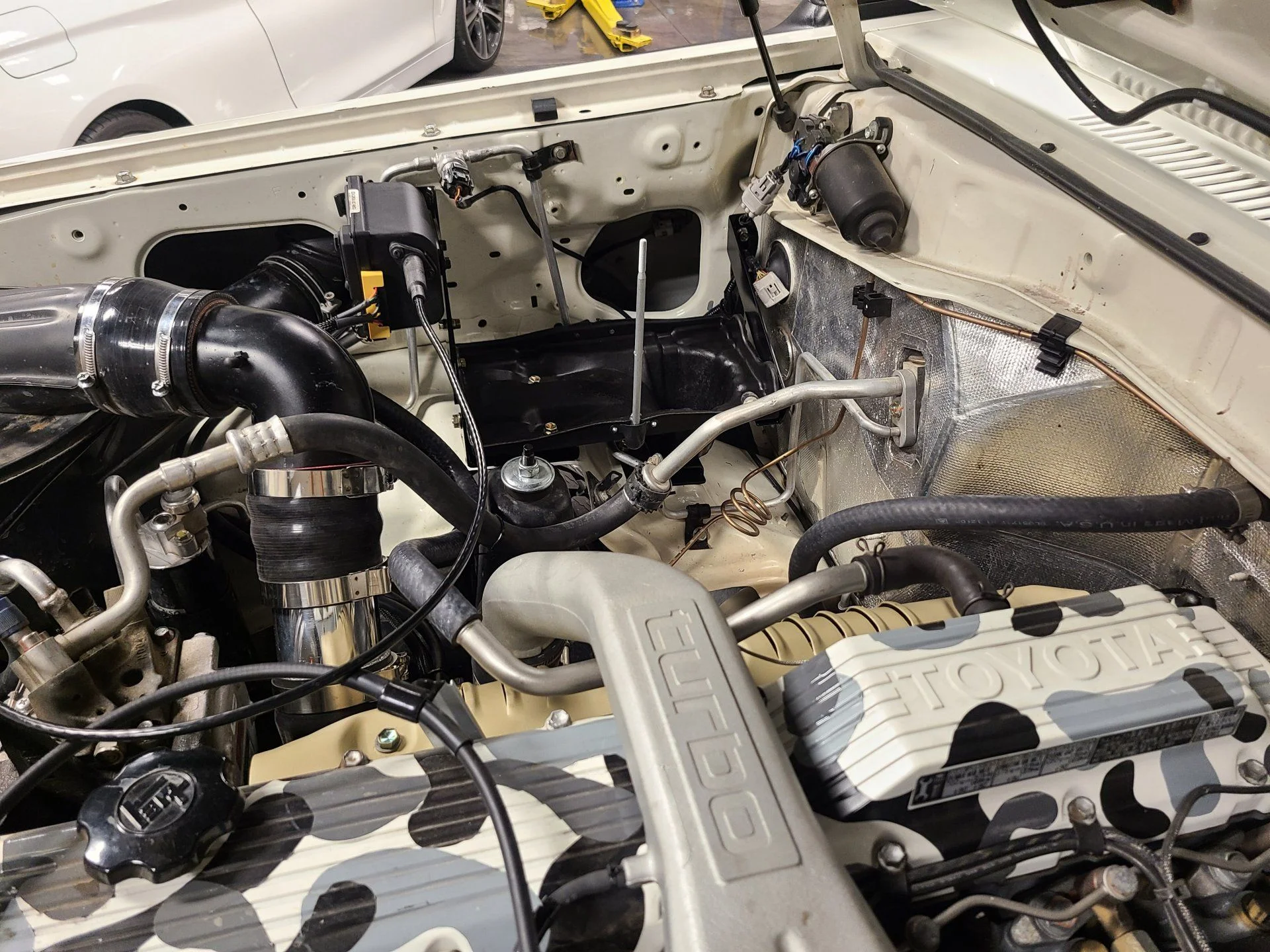

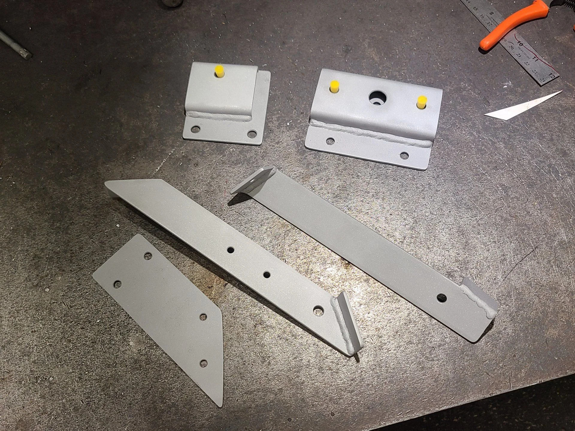

Finished the battery tray and mounts.....hope to get the cruise control wired on Wed before I head north. Need me some cruise control for that drive....

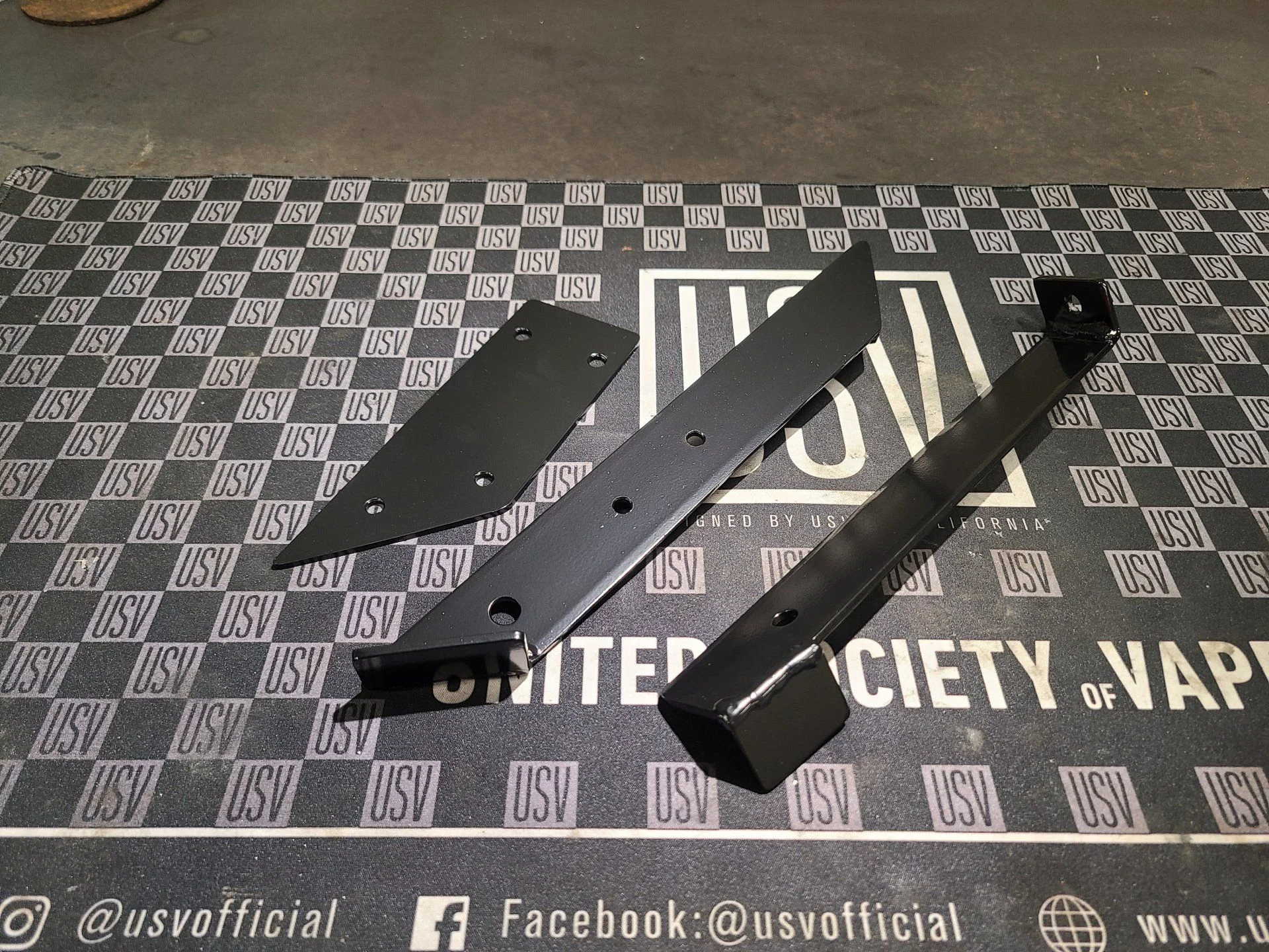

Blasted
Powdercoated.....a little thick on the smaller mount. Using a 70/30 satin finish.....very forgiving to spray. We're getting pretty good at it....today we had to do a mirror for a customers build. Turned out perfect.
Installed the bases
Tray in....cruise control mounted to the forward support. Pretty tidy mount.
