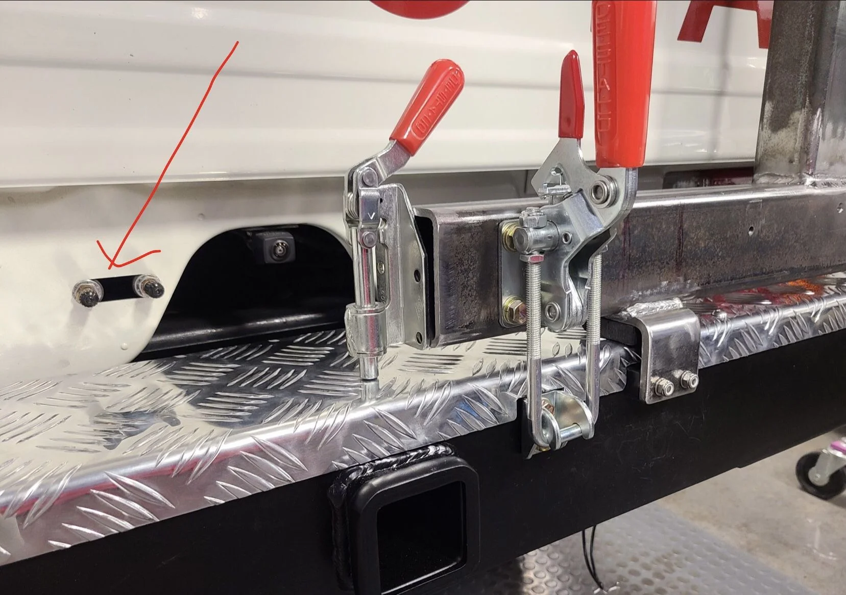

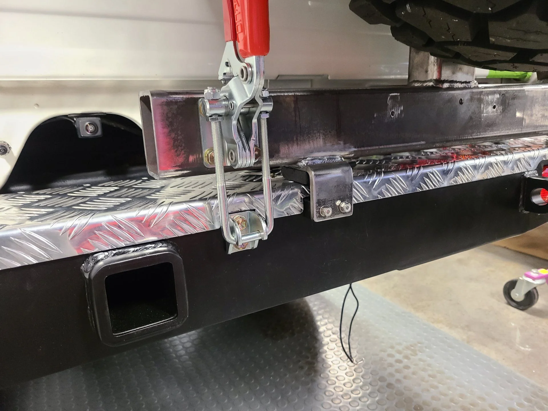

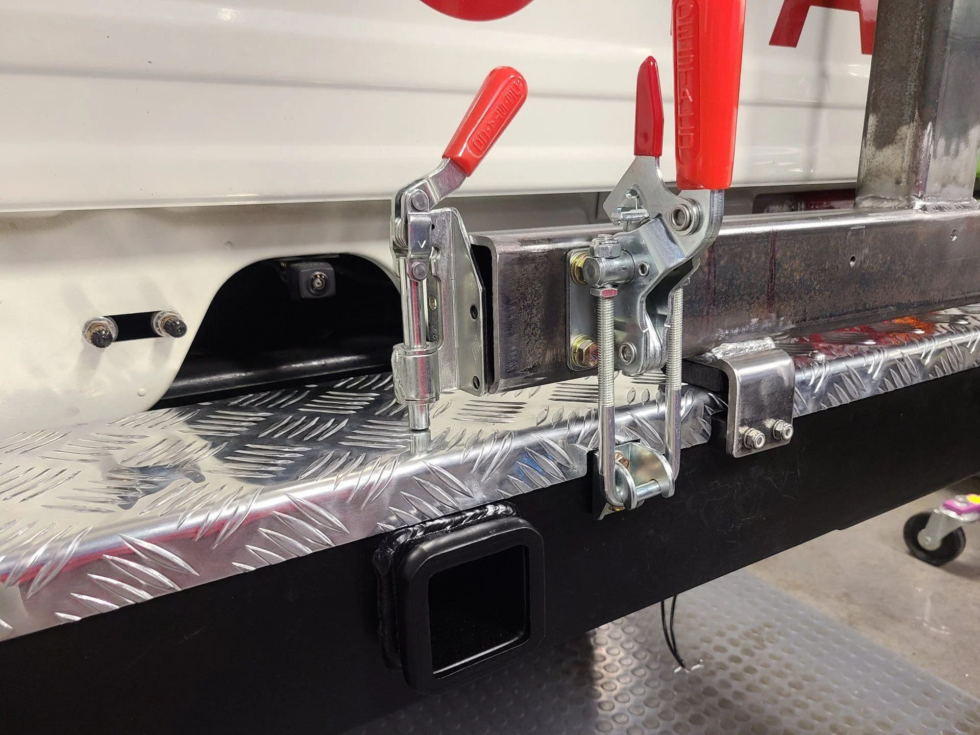

We almost finished up today but ran into a snag with the support for the swingout.....had to make a quick adjustment there. I bought a strut that is WAY too strong...so I had to order another one. More on that tomorrow when it's done.
Got the longer U-bolt for the clamp.
This is the safety pin.....we will drill a hole in the bumper for this to go thru. Super easy to operate and it stays in position...raised or lowered. Obviously need to make a mount plate to close in the end of the swing out.
Pretty small swing out now that it's all said and done.
This may have already been explained in your thread, but what’s going on here and does your swing out limit the effectiveness of the backup camera? 😊
This may have already explained in your thread, but what’s going on here and does your swing out limit the effectiveness of the backup camera? 😊View attachment 2610373
Those are the fills for the rear air bags that got transferred over from the first build....haven't needed them for this suspension so I probably need to delete them. Seemed like a good place to put them for the time being.
Rear view camera needs to find a new home with this setup for sure.

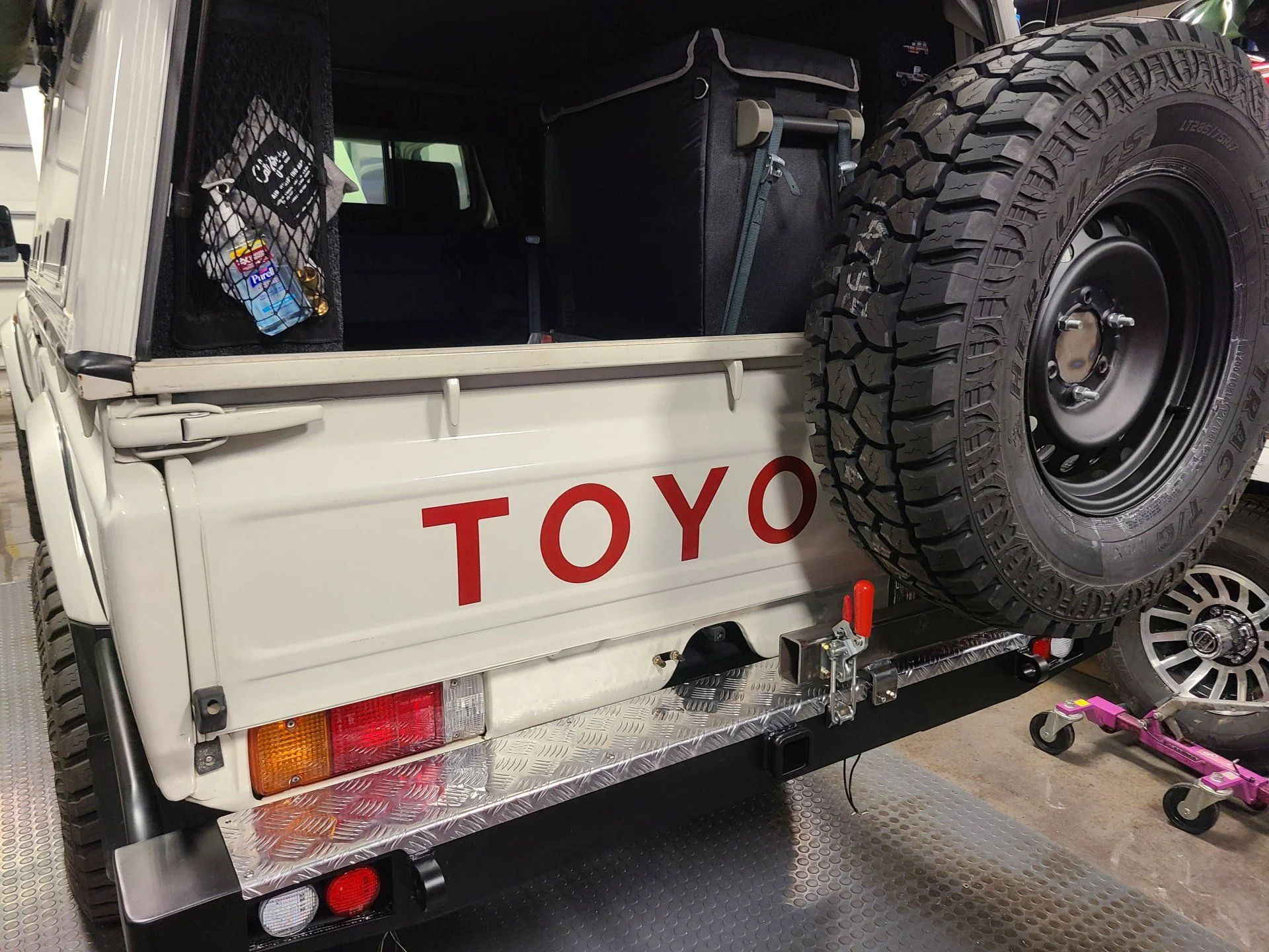

Covered a lot of ground today.....started with the strut. Getting this strut in the right spot was challenging.....we missed the mark by about 1/2" the first time.....got it right the 2nd time. I will reduce it from a 120# support to maybe a 20 or 40 pounder....it REALLY opens fast with a 120# strut.

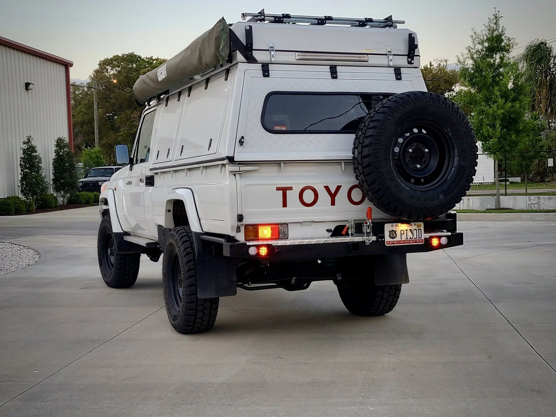

And finally.....after WAY too much money and time......here she is. It turned out 100% better than I imagined....and I have high expectations.
#2 making an appearance....
The 5 bar aluminum cap pulled it all together.
Lights do their jobs....tag light got wired up....ran it's wire thru the swing arm.
Will take a little time to adjust to having a tire right next to the fridge area....seems to be the congregation area.
All this work to get that spare off the roof......now I've got room to add something else.....need to start looking.

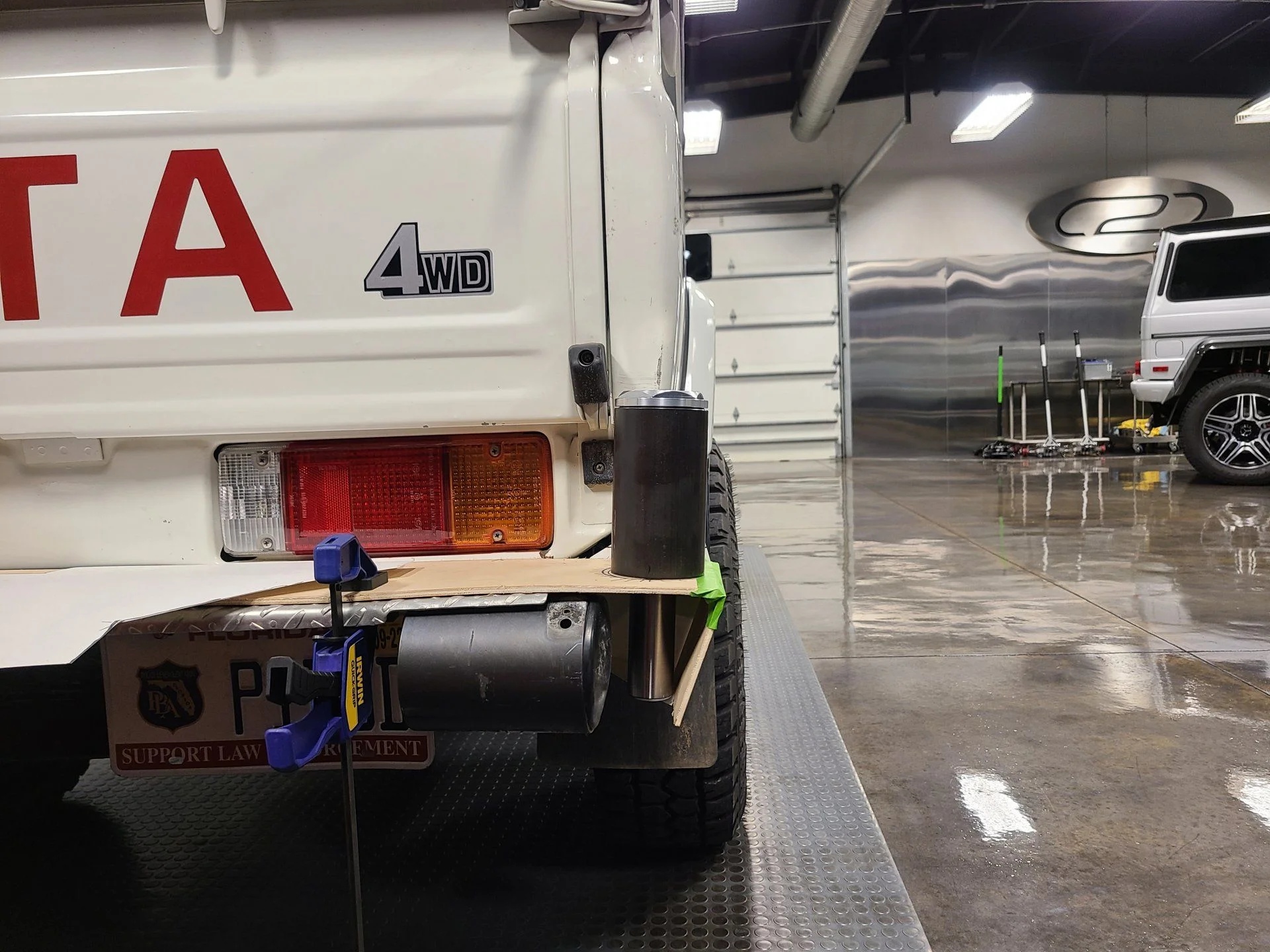

After a careful study of the completed bumper one thing really jumps out at me.
She's a beaut!
:rofl:
