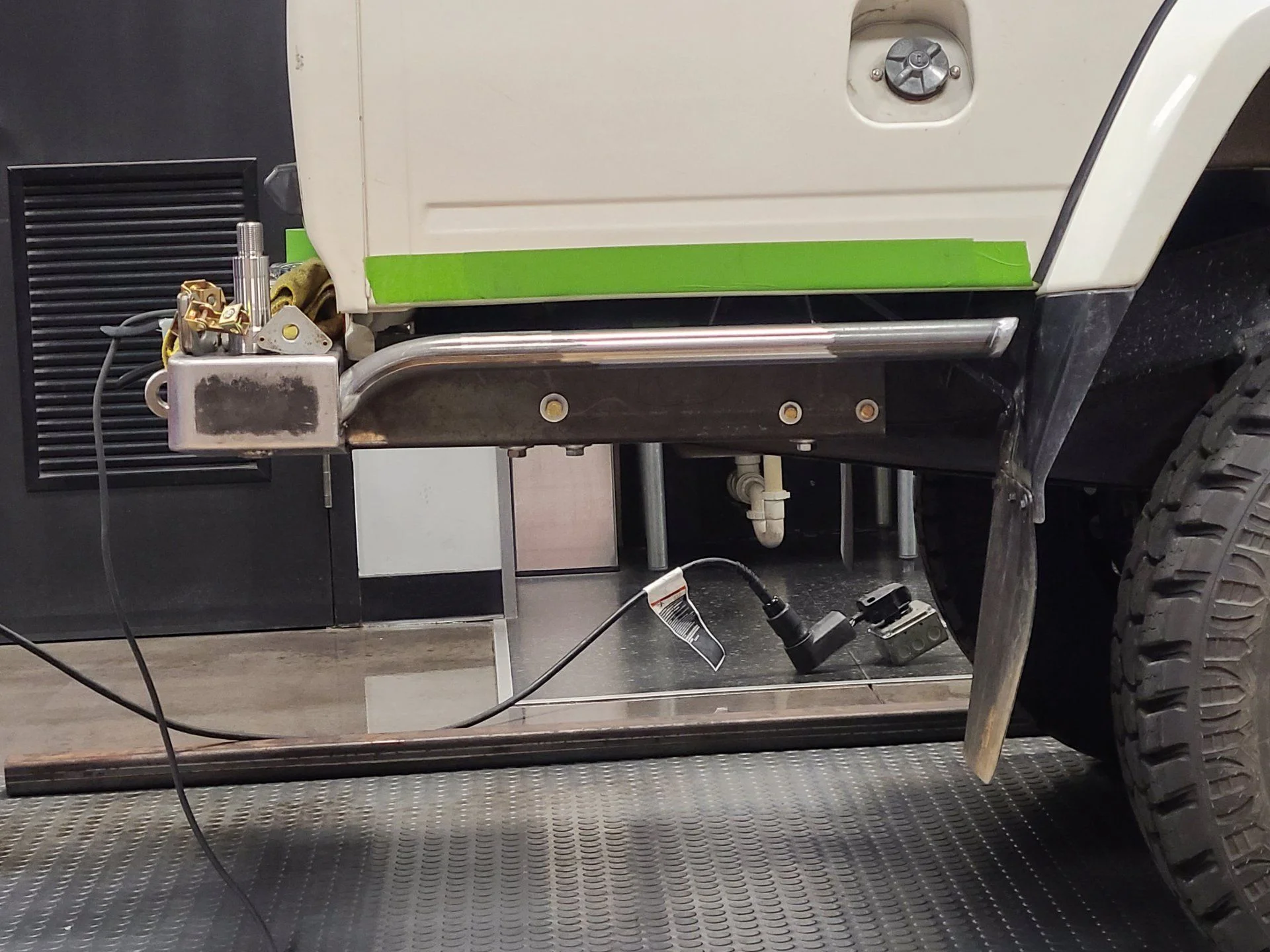

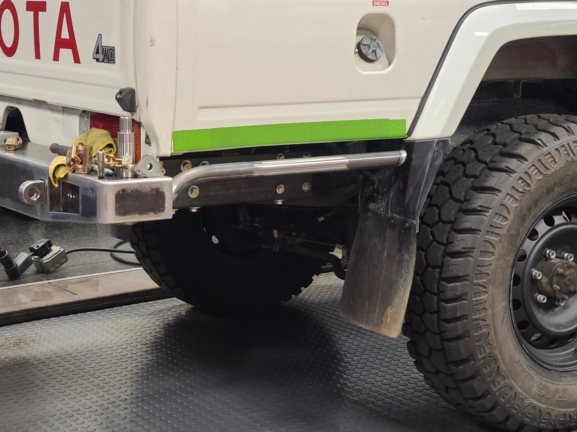

We had time to use the world's fanciest tubing bender to bend up some 1.5" tubing for our side pieces....fit them, tacked them.
Tomorrow we make the side supports and burn it all in. Then it's time for a swing out. We're on a roll.

It really looks like someone is finally solving the conundrum of how to make a 70 Series Ute rear bumper look like it was designed for the truck!

The rear bumpers with tire carriers were all really bad for the 79s. Either too blocky, too low, too long, too high......this one is just right I think :) if only it hadn't consumed 3 weeks of my life :(
