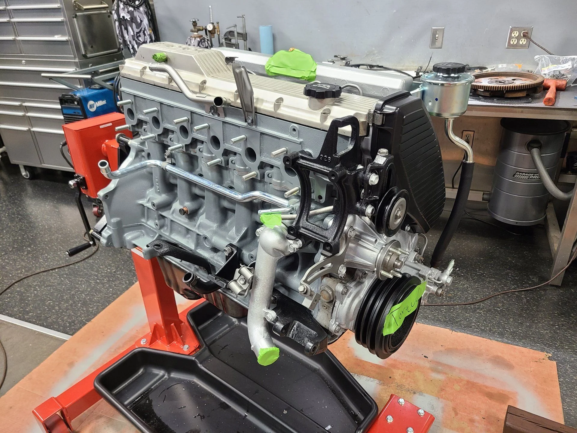

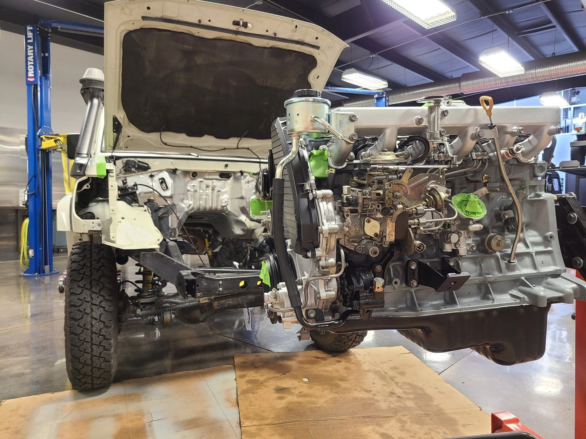

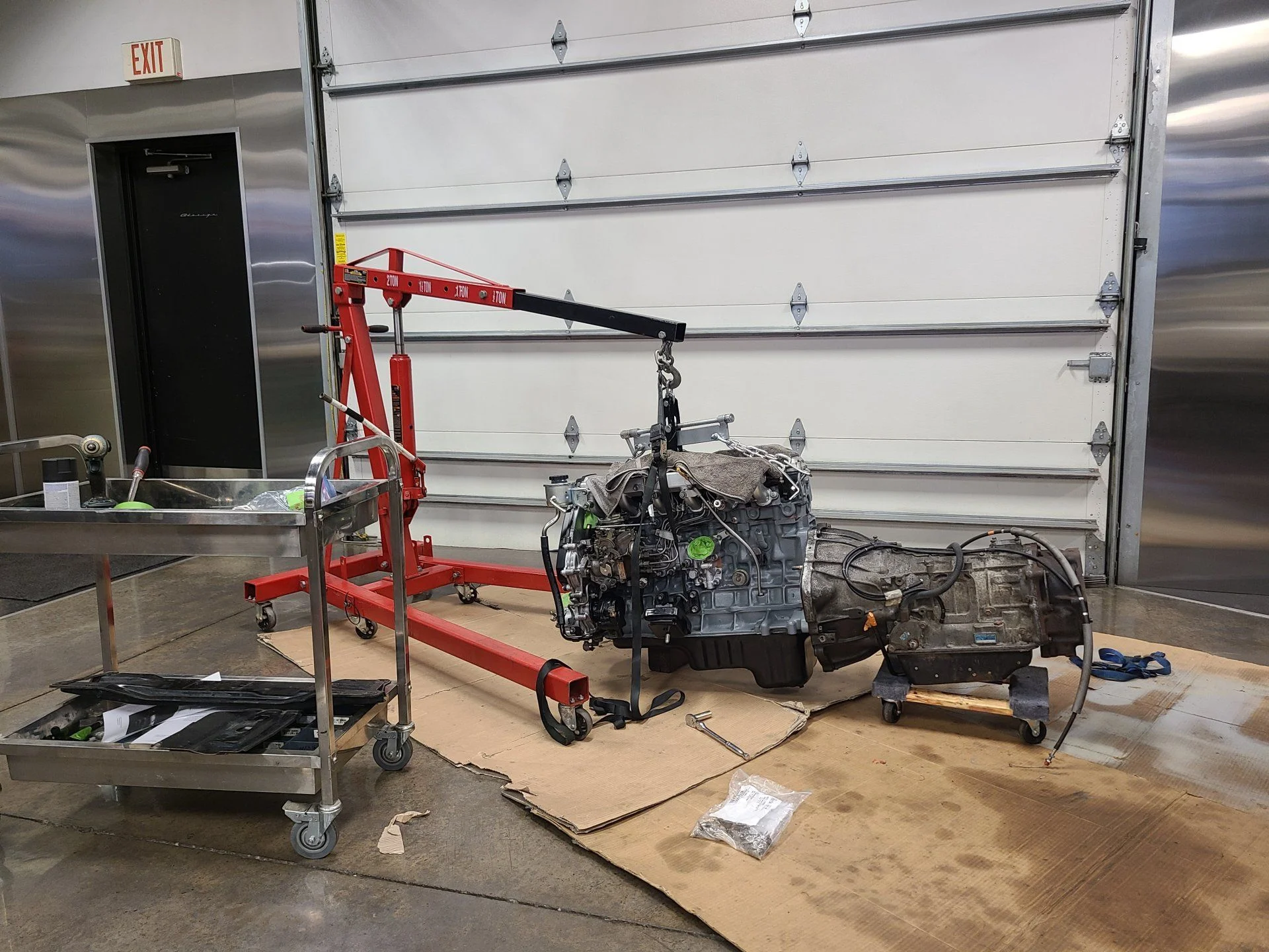

1HDT mostly assembled...easy enough to add the missing parts in the truck.

I feel bad about the dirty old trans. I'm betting this trans will be out at some point for a total go-thru and a Wholesale Transmission Extreme valve body.
Annnnnnnnnnddddddddd............you're in.
Stoked to see a diesel in the engine bay. It's what it should have had all along. Time to think about a color for that valve cover....not going to go black I don't think. Will have to pick something a little different......

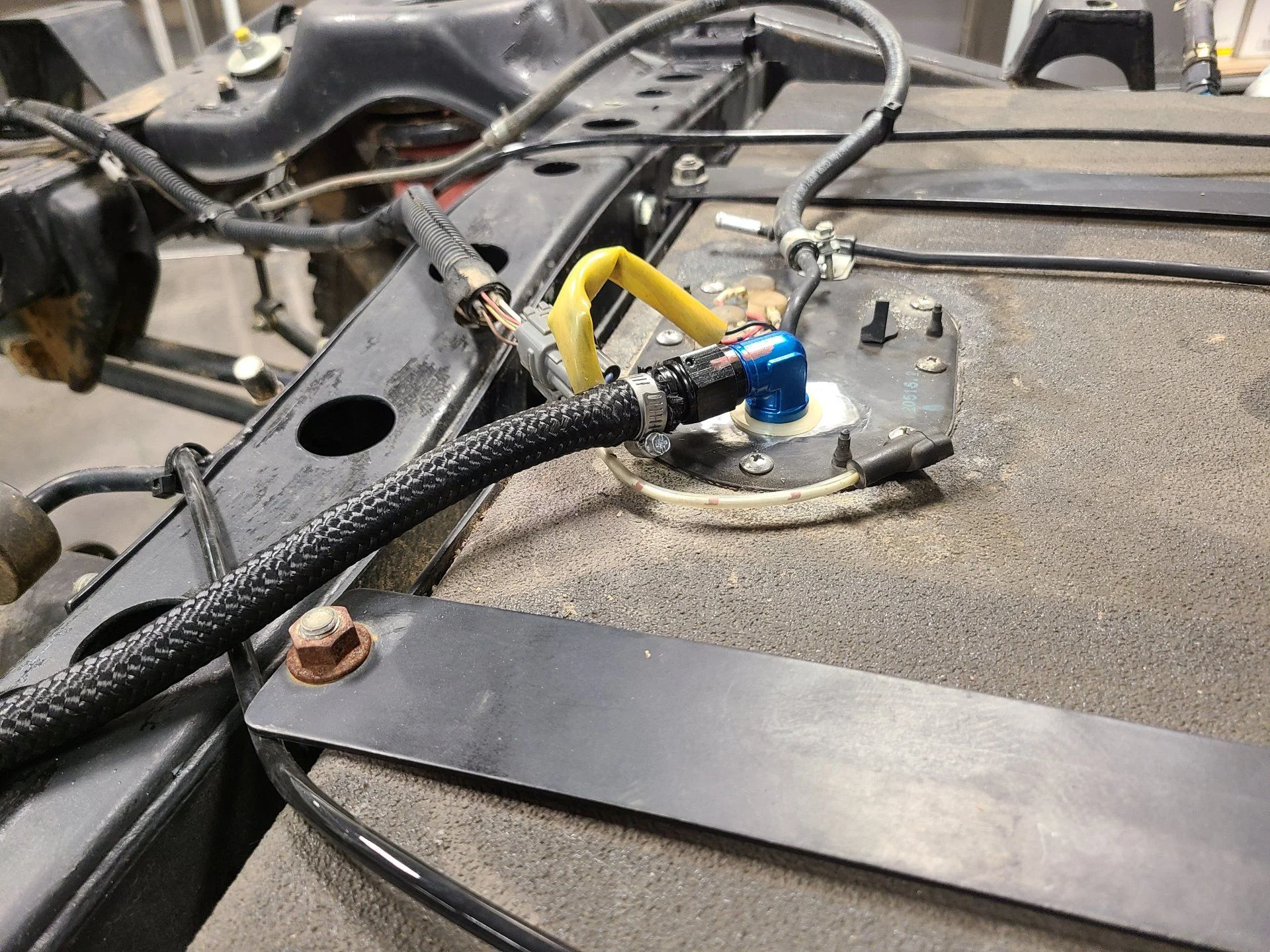

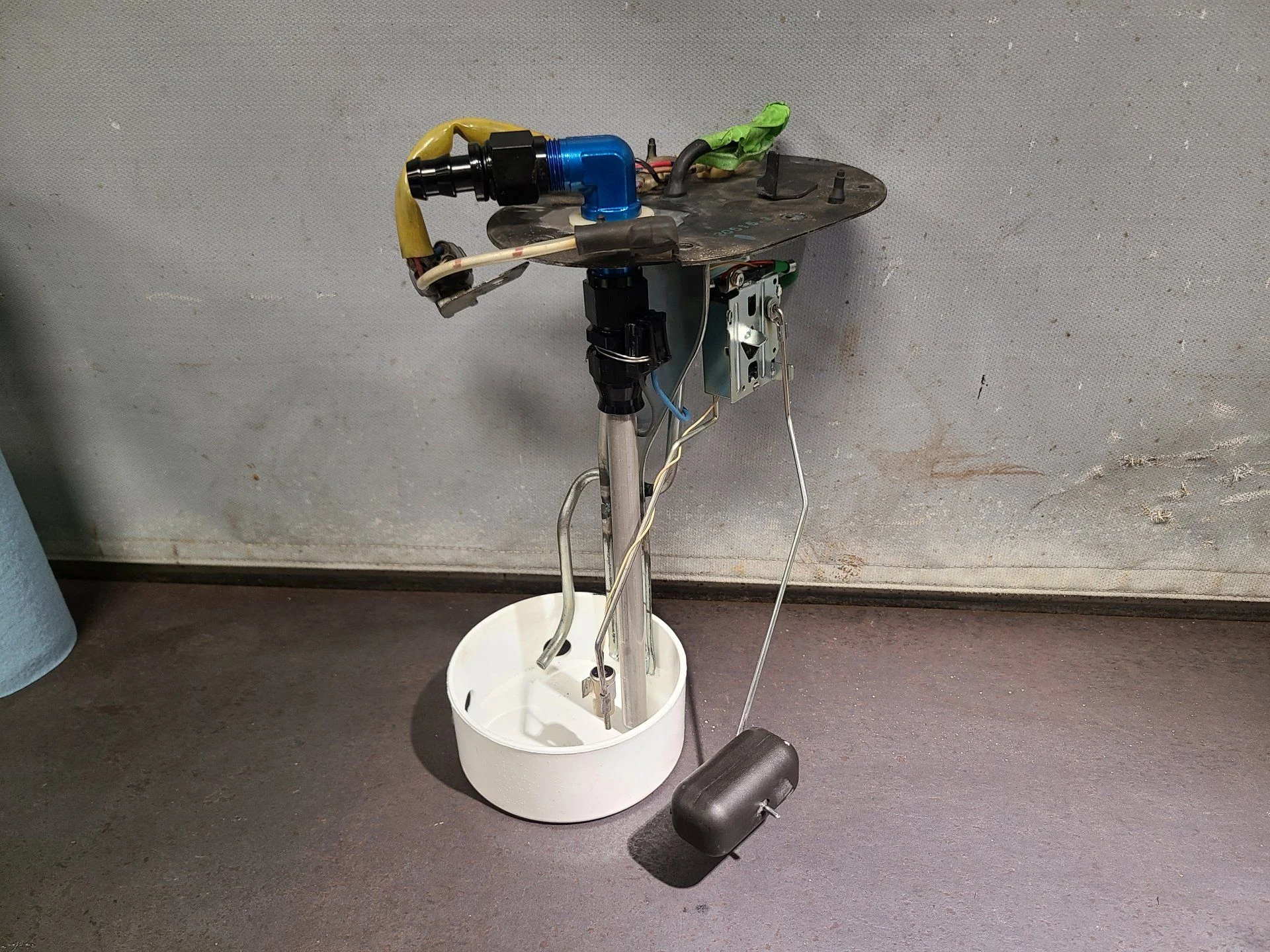

I had to rethink the fuel line size.....the gasser took 5/16" line. Not going to work for the 1HDT. We're running 8AN line which is 10mm ID which is what the 1HDT had. Hope I got that right....kind of going off the inlet port of my injection pump. I think in the 93/94 they changed back to 8mm line(ID). Going to do a braided soft line from the rear tank(just one tank on this truck) to the filter assembly. Going to use the 1/4" gasser return line since it's there and the same size as what the injection pump has.

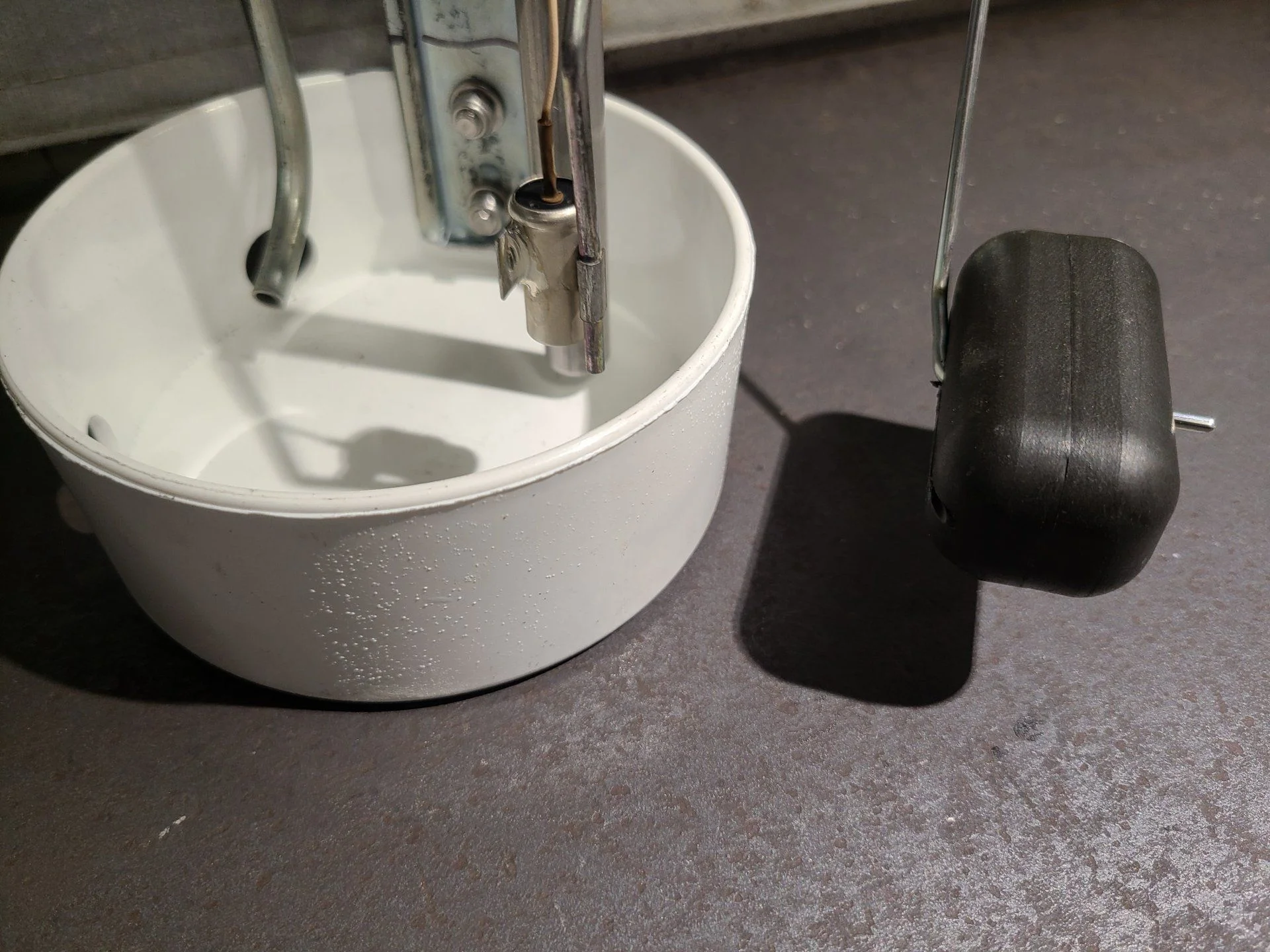

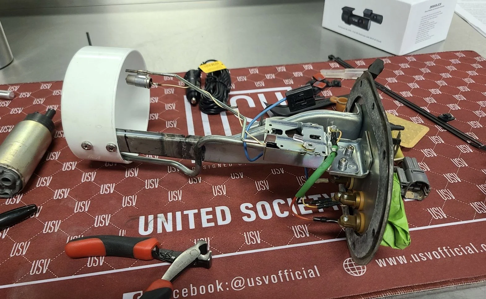

4" PVC cap mounted to what's left of the fuel pump for the 1FZ. We'll drop a pickup tube down into it.
This will get the fuel from the bottom of our PVC cap up thru the fuel tank mount and on its way to that injection pump.
First I first saw this photo, I was wondering why you would take the shop’s coffee maker apart. :)

Semi productive day today.....lots of stuff being put together. Finished the fuel pickup assembly....can't really call it a fuel pump any longer.....need to get my head out of the gasser realm.
Fuel pickup tube is about 1/4" off the bottom of our cup
Got the line on and ran her forward.....

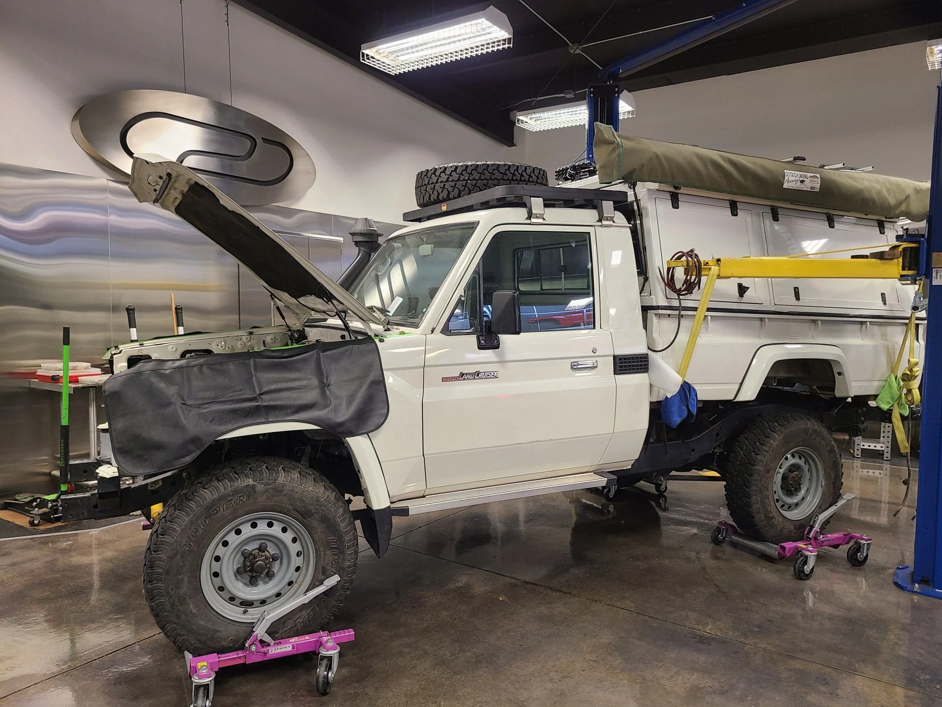

With the dog out from under the truck and the fuel pickup in.....it was time to put the canopy and bed back on.
All back together and on the mat....now we start all the final assembly stuff.
