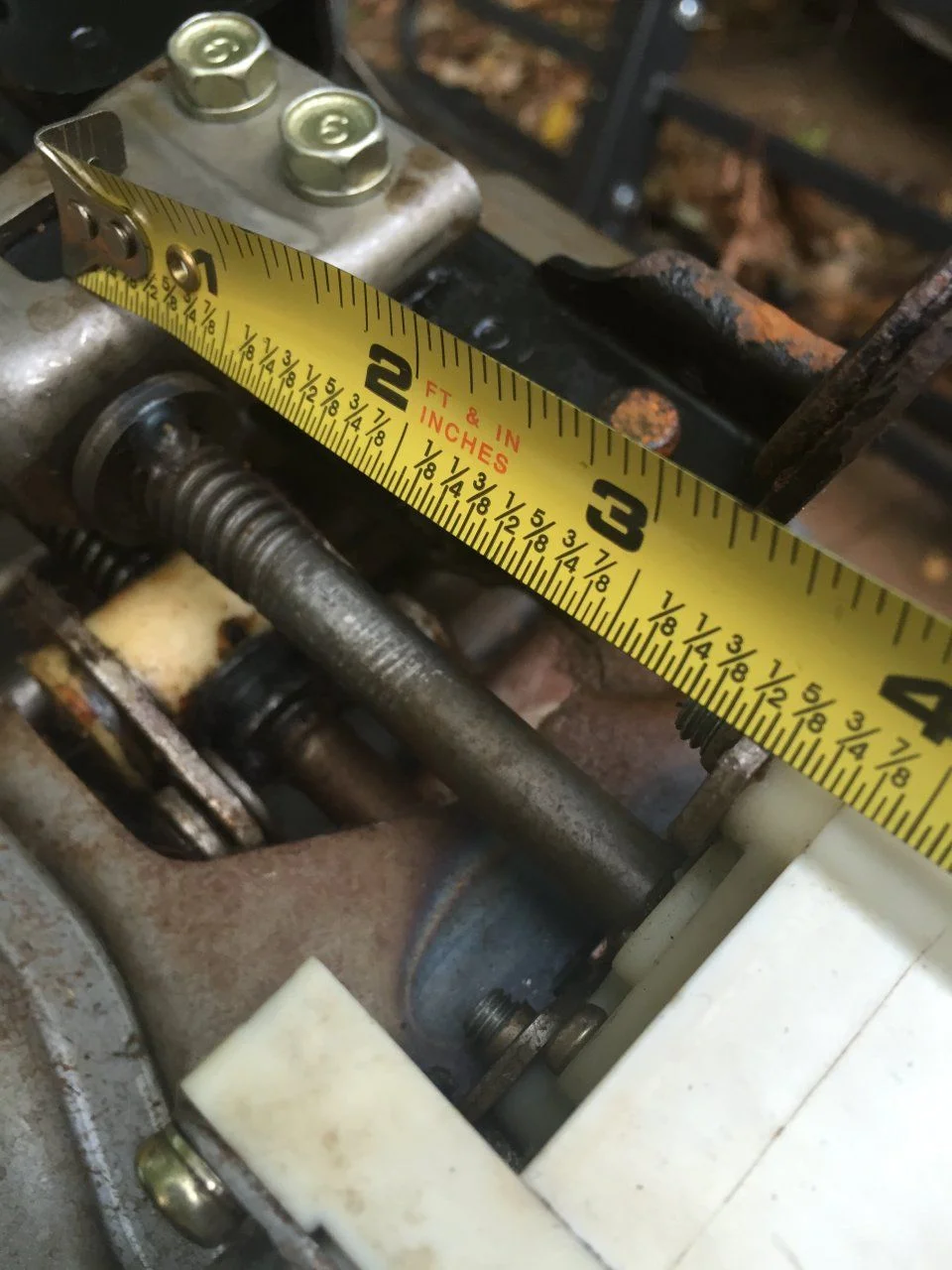

I also finally got my replacement seat gears completely finished on the DS. I had done this repair last month but one cracked as soon as I used it. Had to make another Gamiviti order for extras. I put the gear in hot water for awhile to soften this time AND heated the shaft. A 13mm deep well socket in the vise pressed it on nicely and naturally stopped the pressing when it reached the shaft knurls. This time I rotated the shaft 1/2-turn for every 1/2-turn of the vise handle to ensure the gear went on straight. Just follow Gamiviti's instructions and you'll do fine. The only thing he fails to mention is to raise the forward section of the seat before disconnecting power and removing the seat. You'll never be able to access the front valence panel screws if you don't.
When reinstalling the gear rods, you need to make sure that both of them are lined up equally so the seat moves straight back and forth. You'll want to measure from a fixed point on the track bracket to the gear housing. Unbolt one side to adjust and equalize if you're off at all......
...Don't rely on butting the track bracket all the way down to the shaft stop because the stops might not be in the same places on both shafts. Mine were off by almost 1/4". Screwdriver tip points to where the other on was tacked on. The seat would never run if I used that as the reference point.
